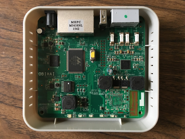

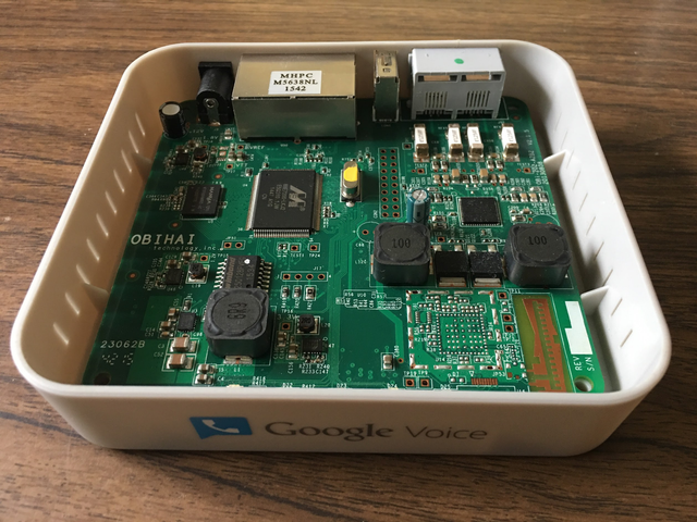

    I have a Polycom formerly Obihai Obi202 VoIP Adapter which has the following 2 capacitors:
    1 x ChengX 100uF 25V 0.25"Wx0.3125"H
    1 x YST 10uF 50V 0.1875"Wx0.4375"H
    What are suitable replacements that are long life and rated 105C or higher? Am I correct that the uF has to match but the voltage can be the same or higher? Are there any advantages and disadvantages if it's higher than the original voltage?
    Thanks!

                • Almighty1
                  • Apr 2014
                  • 222
                  Re: Polycom formerly Obihai Obi202 VoIP Adapter - Capacitor Replacement Recommendatio
                  Looks like I can fit up to 15mm in height as that is the tallest component being the RJ-11/RJ-45 jacks which still leaves a bit of room.

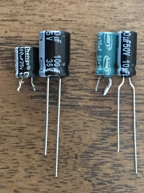

                    Just a update, I went with the following as replacements:
                    For the Chengx® 100uF 25V 0.25"/6.35mm Wx0.3125"/7.9375mm H:
                    Panasonic FR EEU-FR1V101 35VDC Tolerance: -+20%, 6000Hrs@105C, Ripple Current 950mA@100kHz, Impedance 0.056@20C 100kHz
                    For the YST 10uF 50V 0.1875"/4.7625mm Wx0.4375"/11.1125mm H:
                    Panasonic FR EEU-FR1H100 50V Tolerance: -+20%, 5000Hrs@105C, Ripple Current 250mA@100kHz, Impedance 0.340@20C 100kHz
                    Photos:
                    (Before)
                    Capacitors - original on the left, replacement on the right next to it:
                    (After)
