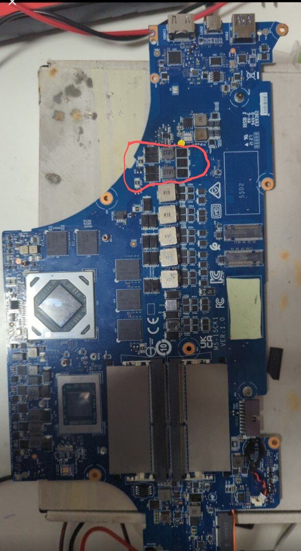

    Hello everyone, I'm looking for the schematic or boardview for the MSI Delta 15 (MS-15CK1) laptop motherboard. If anyone has either of them or knows where to find them, I would really appreciate the help.
    Thanks in advance!

      It doesn't seem to match my board, mine is AMD and that's Intel. Thanks

        Yeah that's what is available...you can take reference from it.

          Si para algunas cosas puede ser útil, pero lo necesito para identificar dos bobinas que no tienen voltaje, te mando captura de pantalla.
          En el resto tengo todos los voltajes, pero en estos no consigo ni un pico inicial al arrancar. Luego las trazas pasan por el medio de la placa y no logro identificar por donde van.
          The two next to them are 3.3V and 5V, the large ones and the two smaller ones together are 0.91V for the GPU, and the rest are power supplies of 1.8V and others."

              Sorry, it might be useful for some things, but I need it to identify two coils that have no voltage. I'll send you a screenshot.
              I have all the voltages in the rest, but in these, I can't even get an initial peak when powering on. Then, the traces go through the middle of the board, and I can't identify where they lead.
