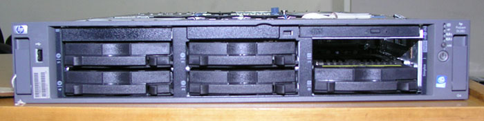

HP uses what caps in their servers?
  • willawake
    Super Modulator
    • Nov 2003
    • 8457
    • Greece
    HP uses what caps in their servers?
    just got a DL380 G4 and it uses OS-CON caps and tantalums on the board and in the psu uses Nichicon for the big ones and also rubycons. Nice. Excellent server and very easy to install using the smart start cds.
    The only problem is the bastard noise from the fan whine. it has 5 delta fans in it. drowns out all other machines, forget about hearing a hdd failure on the other machines.
    you can see some more pics here
    http://www.broadbandreports.com/foru...0890~mode=flat
    here are 2 pics from the above link
    Last edited by willawake; 09-09-2005, 11:22 AM.
    by momaka
    03-12-2025, 03:42 PM
  • eryjus
    by eryjus
    05-10-2023, 11:21 AM
  • Paxman_Swede
    Identifying caps on an old Zoom 9000
    by Paxman_Swede
    Hello!
    I have two projects on my work bench. One is a friends dead JBL Xtreme speaker with a blown voltage regulator and corresponding bulged and shorted cap. That cap has clear markings so I know what replacement I need for it.
    The other project however is a whole different deal. It's a Zoom 9000 guitar effect from the 90th that has developed a devil hound howl when there is no input from the guitar. I'm guessing caps problem. So, since I don't really use this effect anymore I thought it would be a perfect project to learn on.
    I have studied the board and...
    01-14-2025, 09:51 AM
  • captain150
    Help with switching power supply caps
    by captain150
    I'm trying to repair two old VCRs, they both have bad caps. One has leaky ones, the other would barely run until I subbed in some caps from another power supply I had laying around (though they are the wrong values). This vcr works for an hour or two, but then the power supply starts whining and the picture gets lines in it. I didn't replace all the secondary caps, so another voltage might still be problematic, or the values I used are too far off.
    I've been on mouser and digikey but the options are a bit overwhelming. I just need some new ones that will work. They don't need to be top quality,...
    03-16-2025, 07:34 PM
  • Foetuss
    Gigabyte GA-6OXT :: caps question
    by Foetuss
    Good evening
    I recently aquired a rev 1.1 Gigabyte 60XT, and was suprised of the amount of leaking caps for a motherboard of the P3 era. Especially the way the 330µf caps seems like the housing discolored even.
    Now, there are some 3300µF 6.3V KZG series around the CPU. Would it be OK to replace them with something like EEUFR1A332 ? (Panasonic FR 3300µF 10V). Or was this board designed around very low ESR caps?
    But I was also suprised about the bigger boys, which are 330µF 25V.
    Could it be they used 25V caps because they were cheaper / available at that time?...
    02-11-2025, 12:22 PM
