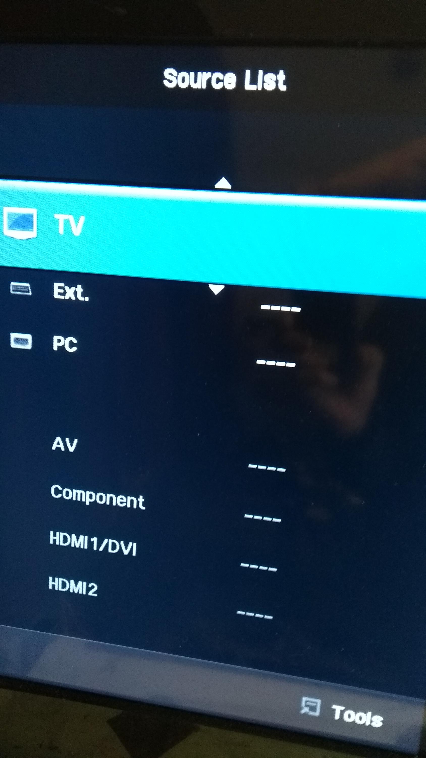

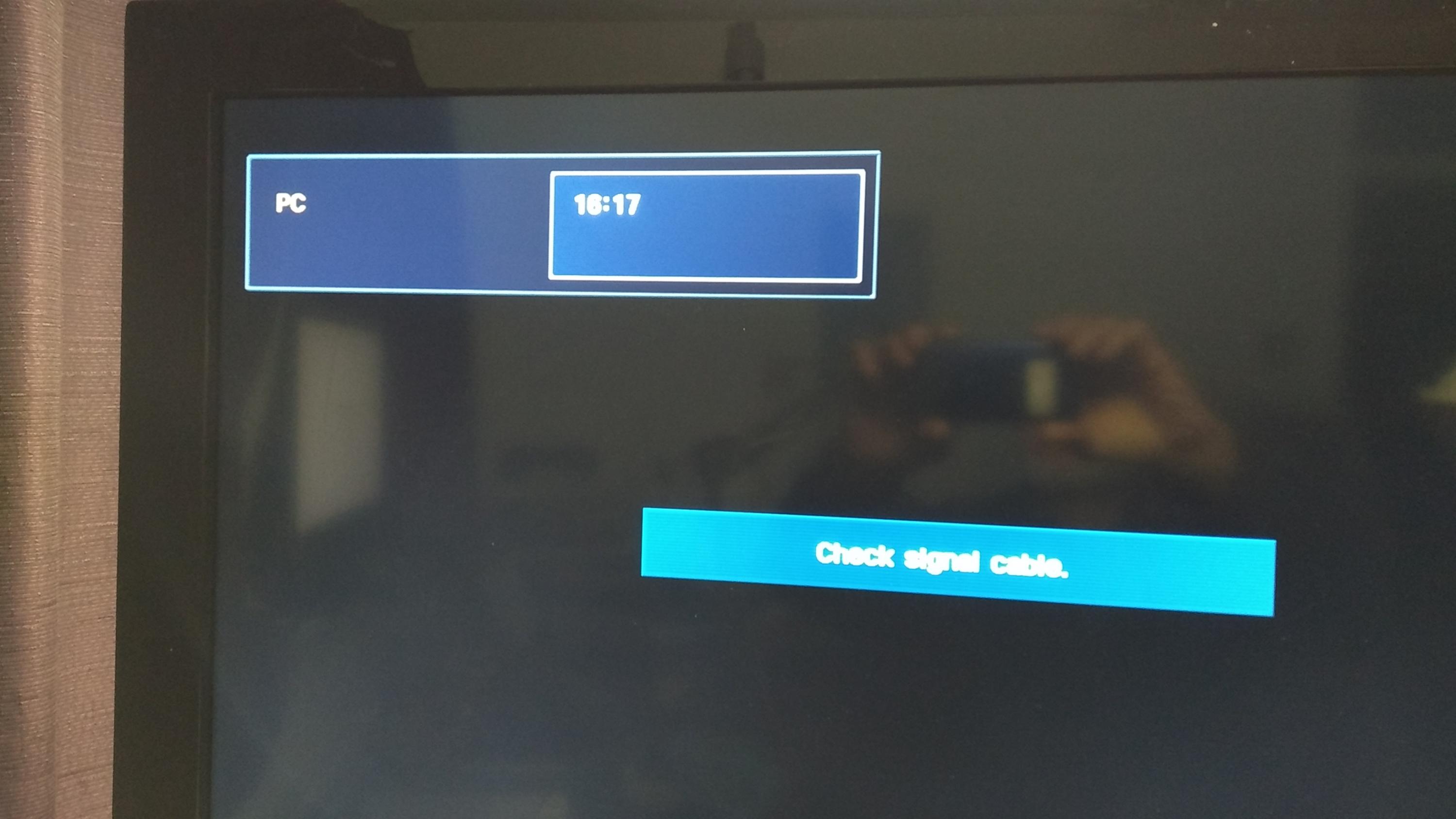

    This set changes source without being asked. Turn the set on and tv channel comes on for up to 20mins then set changes to ext1 for a couple of secs then PC for a couple of secs then back to tv for the same same. Then the cycle starts again. I turned on today and there were no channels saved so I had to rescan.

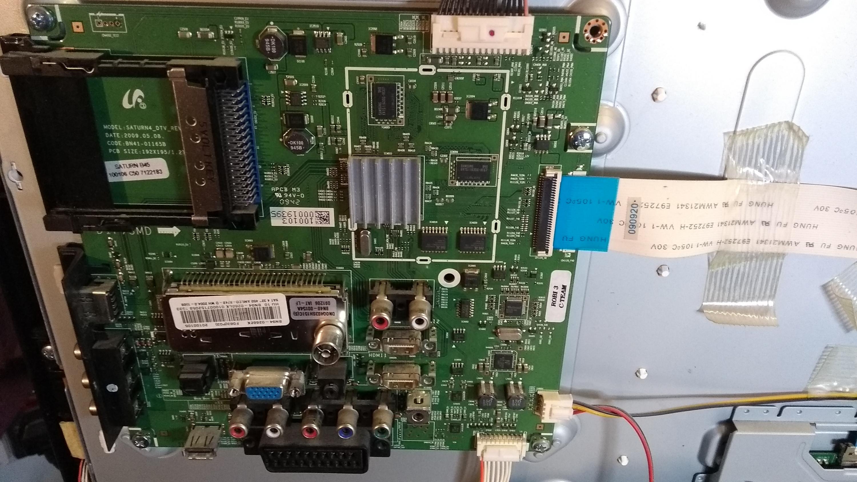

    I'm guessing the faults on the main board so have included a photo.
    Any thoughts or ideas would be welcome.

    is the input button on the tv sticking? maybe try unhook the button board and see what you get just using the remote if possible.

      Tired worn output caps on the power supply maybe not filtering as they should causing issues perhaps.
