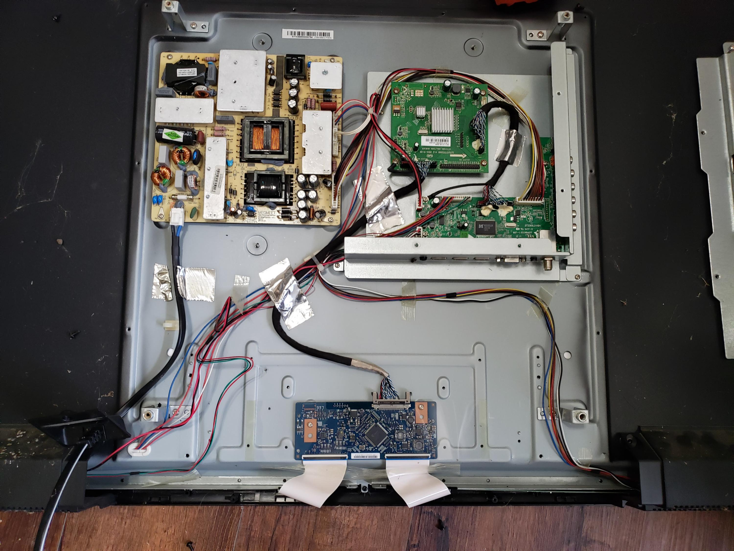

        Re: westinghouse tv dwm55f2y1 no display standby light on
        can you post a picture of the whole back as to see how everything is connected.
        • Xphoidz
          • Nov 2022
          • 7
          • Usa
          Okay. Here it is.

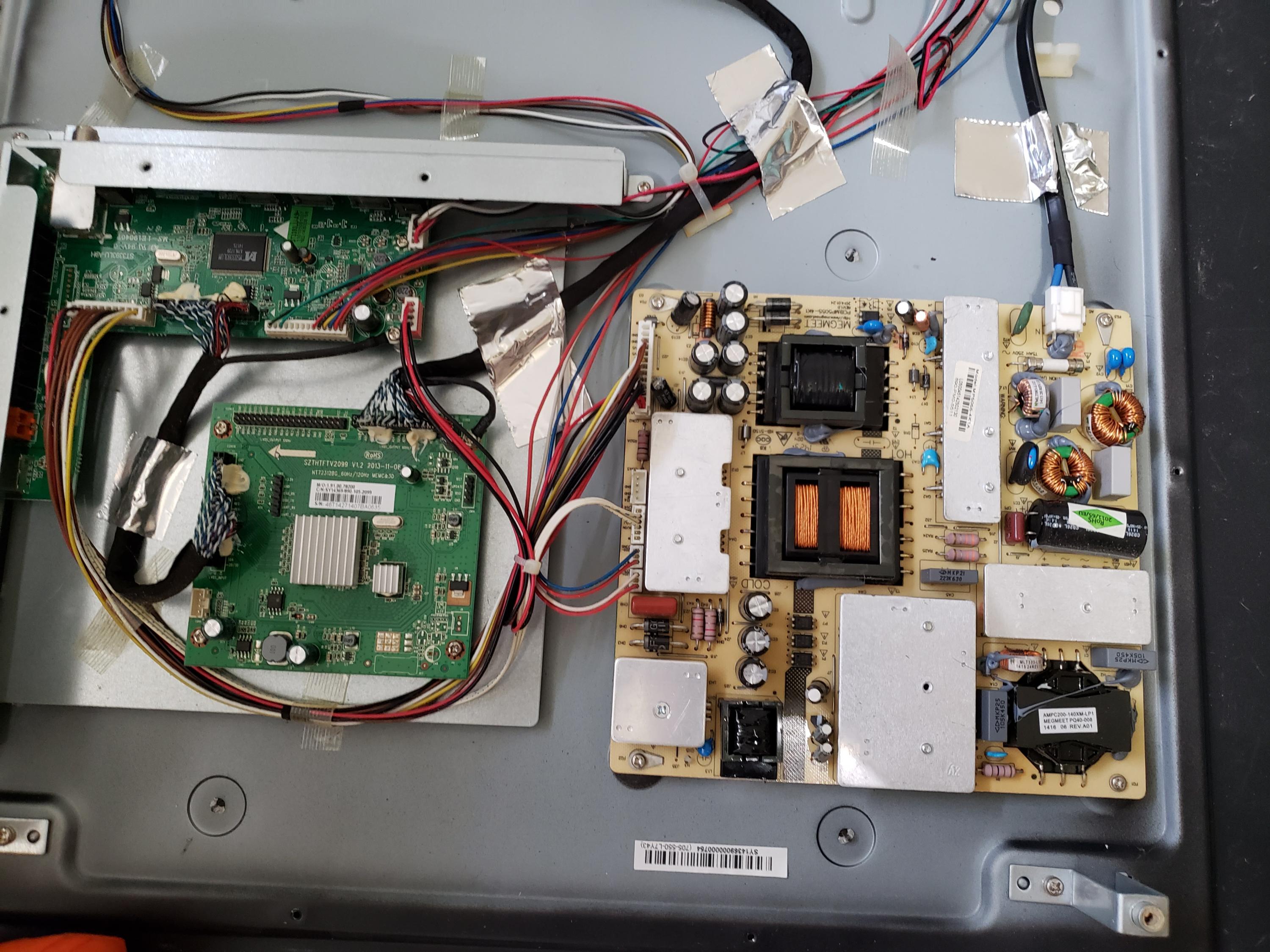

            usually its the 2 flat wide cables going from tcon to panel driver boards but not seeing it in this picture.

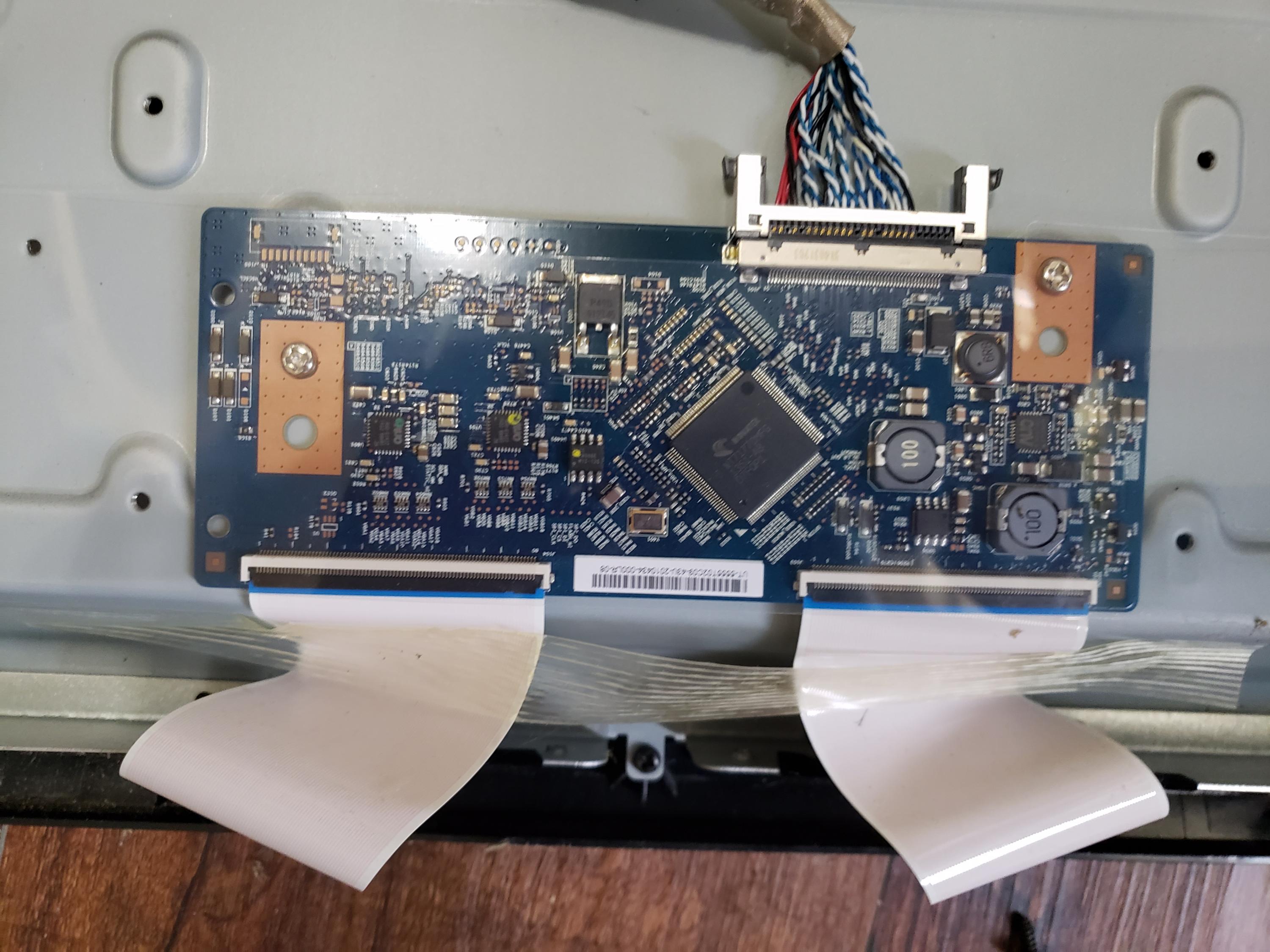

              thinking you should have a tcon, it may be hidden under a shield or somewhere.
              • Xphoidz
                • Nov 2022
                • 7
                • Usa
                Found it.
                • lotas
                  • Jan 2016
                  • 4648
                  • Russia
                  And here are T-con and cables, if the TV does not go into operating mode, you most likely have lost the firmware or processor or dc / dc regulators on the motherboard.
                    Okay. I unplugged one ribbon cable, plugged in ac power. Standby light came on, pressed the power button, nothing except the standby light was on. Unplugged ac power, plugged in first ribbon, unplugged second, plugged ac power in and standby light came on and the power button didn't do anything else.

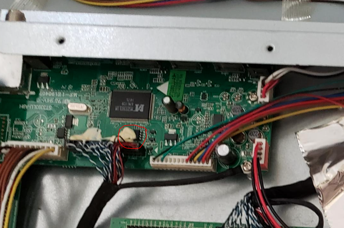

                      Consider Firmware Dump as a programmer and post it here, I'll see if it works or not.
                      • Xphoidz
                        • Nov 2022
                        • 7
                        • Usa
                        I'm a little confused. Do you need a picture of that chip showing the numbers?
                        • lotas
                          • Jan 2016
                          • 4648
                          • Russia
                          No, you must unsolder it and read its contents (firmware) on the programmer and put this file with the firmware here. If you have a programmer RT809f (H), then you can not solder, but read through the VGA connector.
