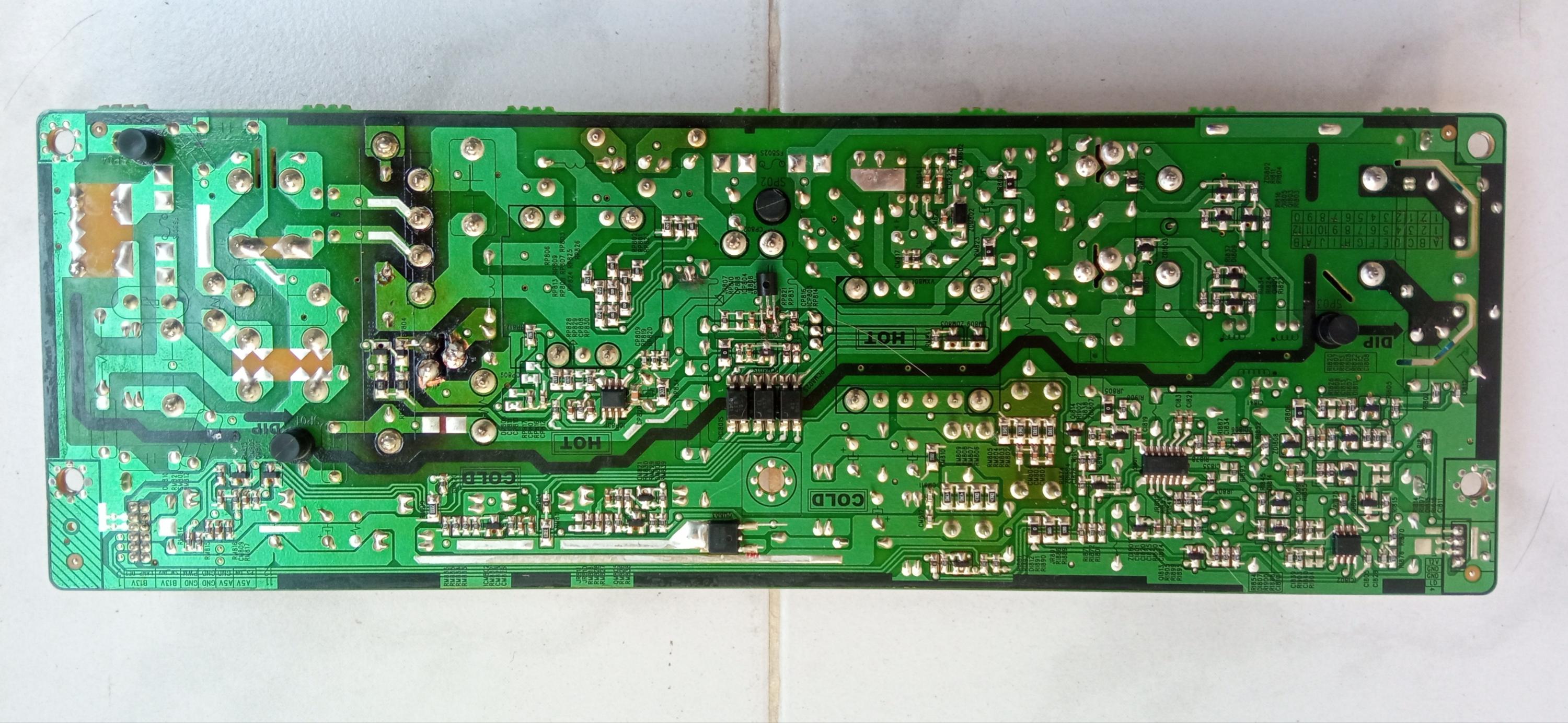

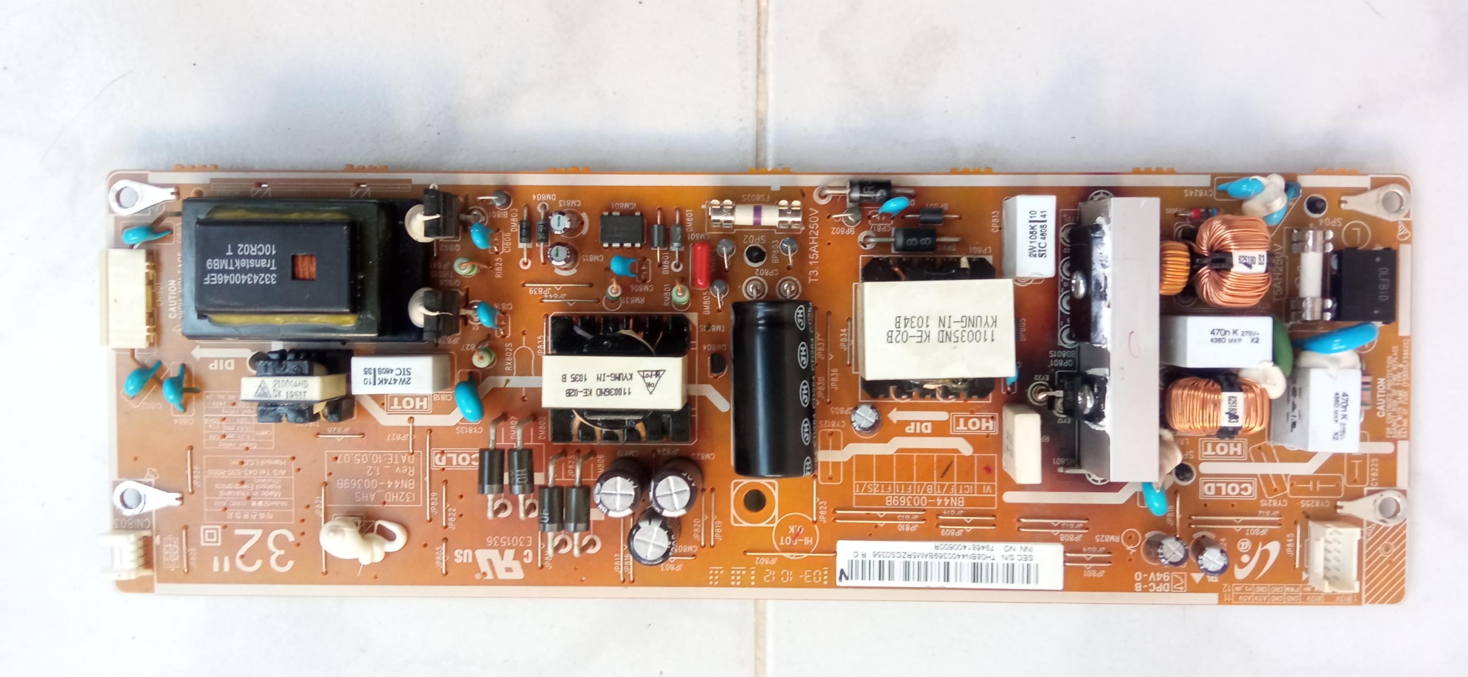

                      can we get a good clear picture of this board? working in the blind here.
                      • stoian_93
                        • Oct 2022
                        • 13
                        • Bulgaria
                        Re: Samsung BN44-00369B
                        Sure. Here they are.

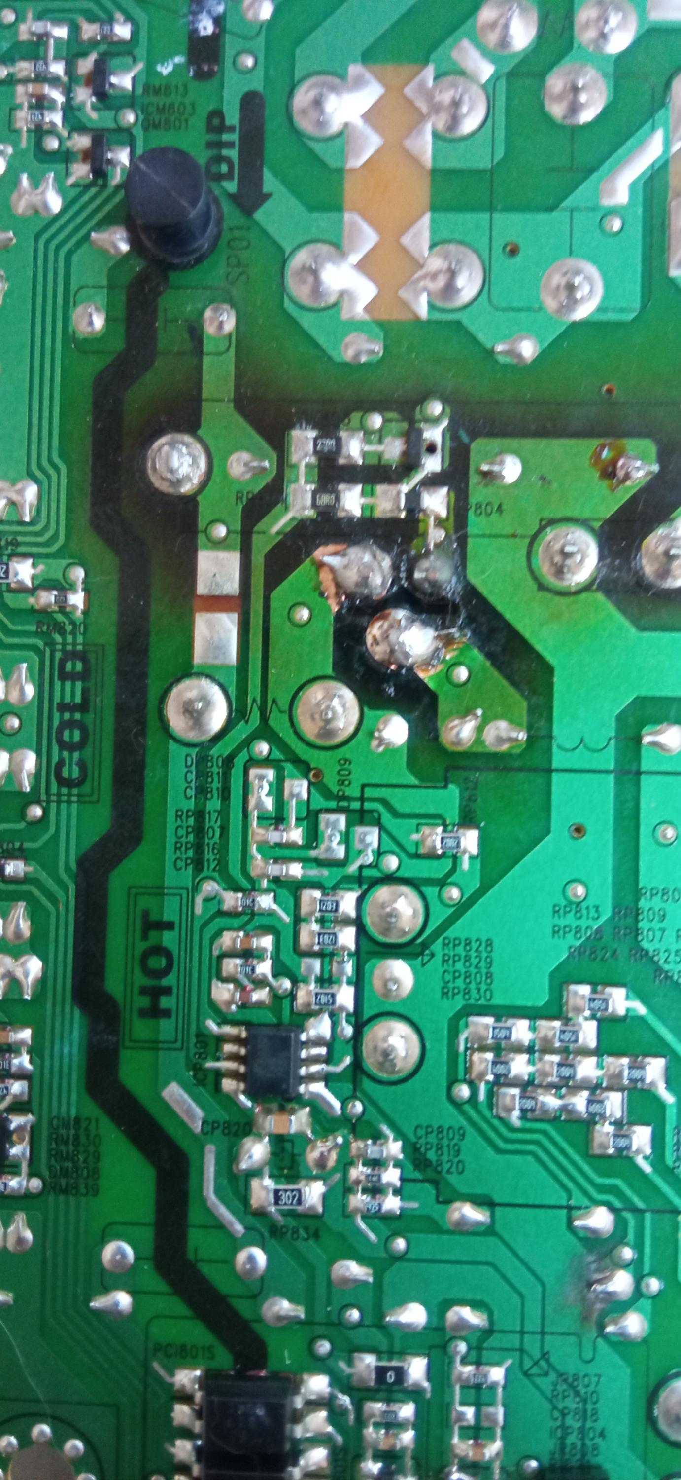

                          for good measure make sure Q802 and the other one near it are not shorted.
                          • nomoresonys
                            • Jan 2013
                            • 12332
                            • U.S.
                            some of those solder joints don't look too good, examples of bad joints there: https://www.google.com/search?q=bad+...ih=607&dpr=1.5
                            • stoian_93
                              • Oct 2022
                              • 13
                              • Bulgaria
                              If you're talking about the transistor joints, they're like this because the paths were cutted when father tried to replace it, so I joined the paths this way after him.
                              • nomoresonys
                                • Jan 2013
                                • 12332
                                • U.S.
                                ok, theres some other suspect joints look them over carefully, make sure none are cracked or loose etc. refer to the images if needed.
                                  I checked both, not shorted. Found FAN7530 (ICP801), RP804, RP805, DP803 in stock, purchased and gonna replace and see what happen.
