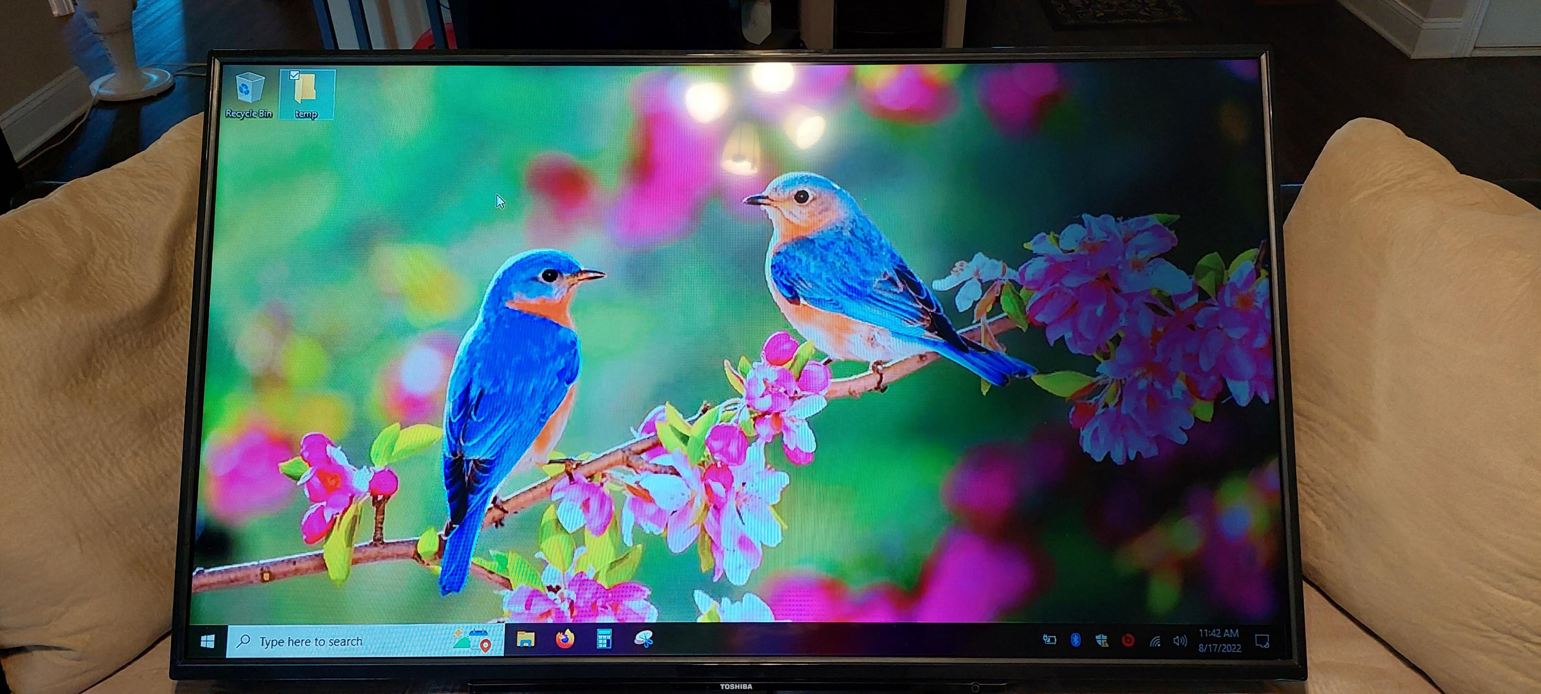

    Right 1/3 of LCD screen is dim. Picture is good otherwise. Research suggests LED strips, but thought I would see what you pros think before I fix it until it is broke. Thanks for help/suggestions.

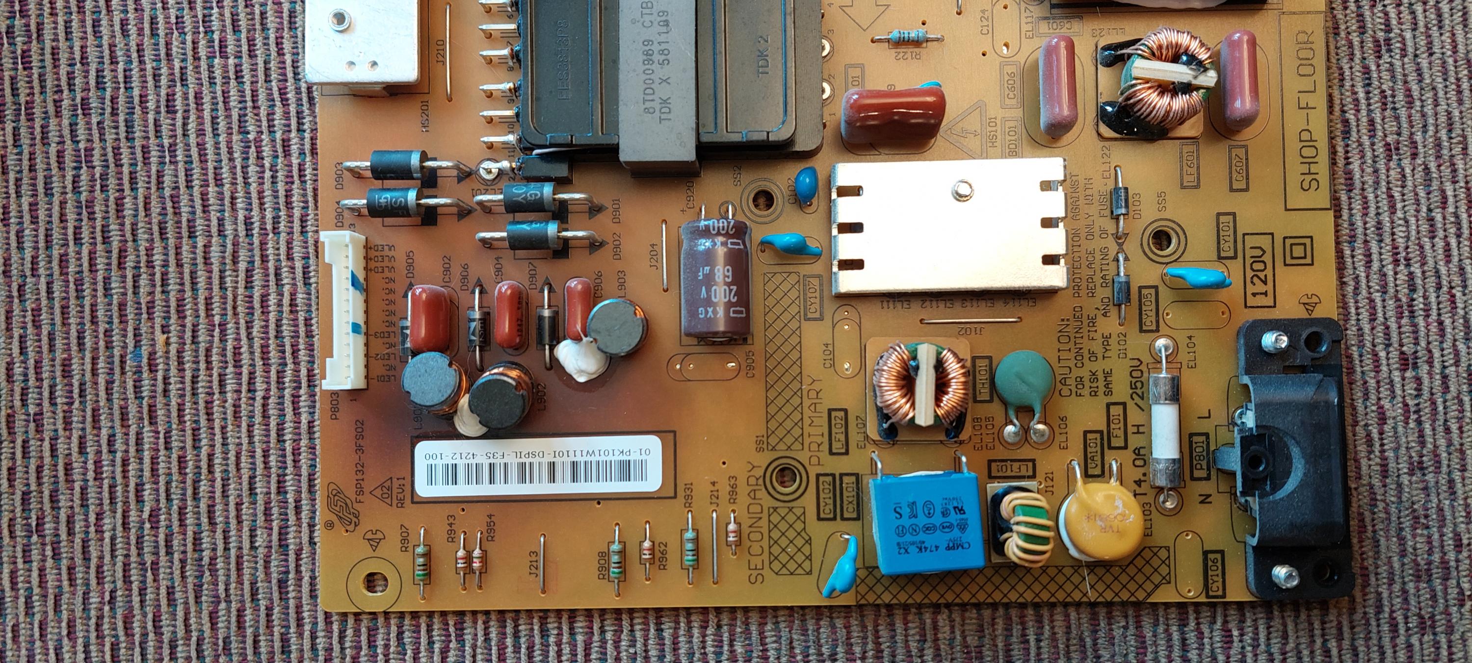

        Found this hot spot on secondary side of power supply board.
        EDIT:
        Did some more testing.
        LEDs connected at 13-pin:
        LED 1-: 56vdc
        LED 2-: 58vdc
        LED 3-: 92vdc
        LEDs disconnected at 13-pin:
        All are 113vdc.

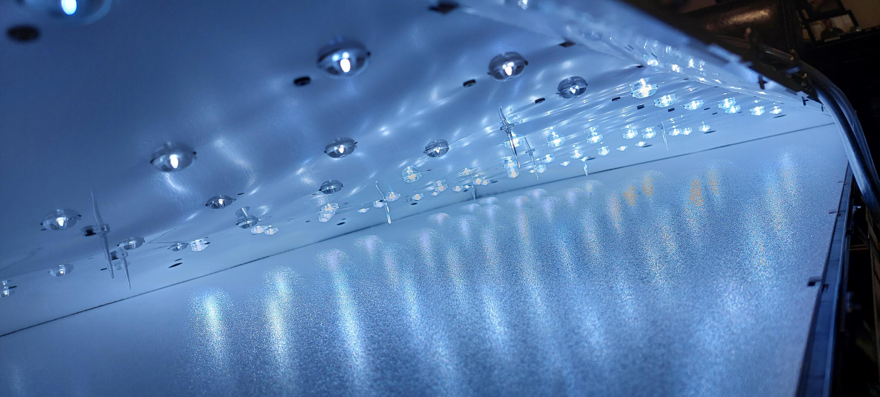

            Dim side-closest to camera lense-is the darker side. LEDs glowing but very poorly and must be the LED3 circuit lotas suggested. Looks like 12 strips total. So it must be 12 vertical strips. Could I get away with just replacing 4 strips instead of all 12? Amazing this TV is almost not worth fixing.
            EDIT: Pulled led strips and found one bad bulb on far right (fourth from bottom) and another on fourth strip from right bulb (upper-most).
            • ShortCircuited
              • Jan 2020
              • 101
              Re: Toshiba 55L310U
              Can we buy just the diodes and replace individually on the strips? I pulled the faulty LEDs and jumped with wire and now all LEDs work, except the two missing of course. I only need two diodes then epoxy the diffusers back to the strip.
              P.S.: This is not a resell TV.
              • lotas
                • Jan 2016
                • 4850
                • Russia
                Re: Toshiba 55L310U
                It is better to replace everything at once with new ones (they have begun to degrade the crystal), if you change only two leds, then wait for a repeat, others will start to burn and each time you will have to change them.
