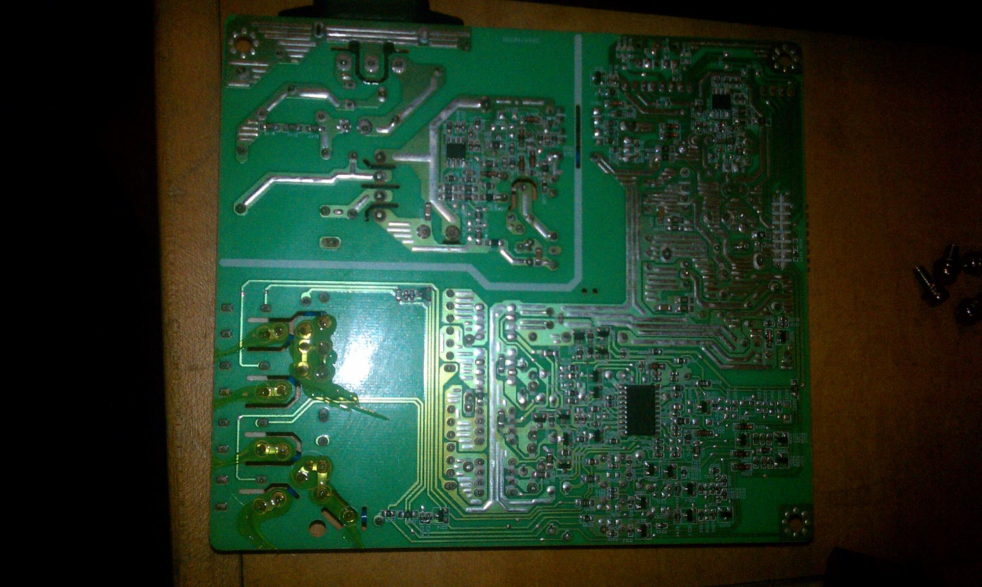

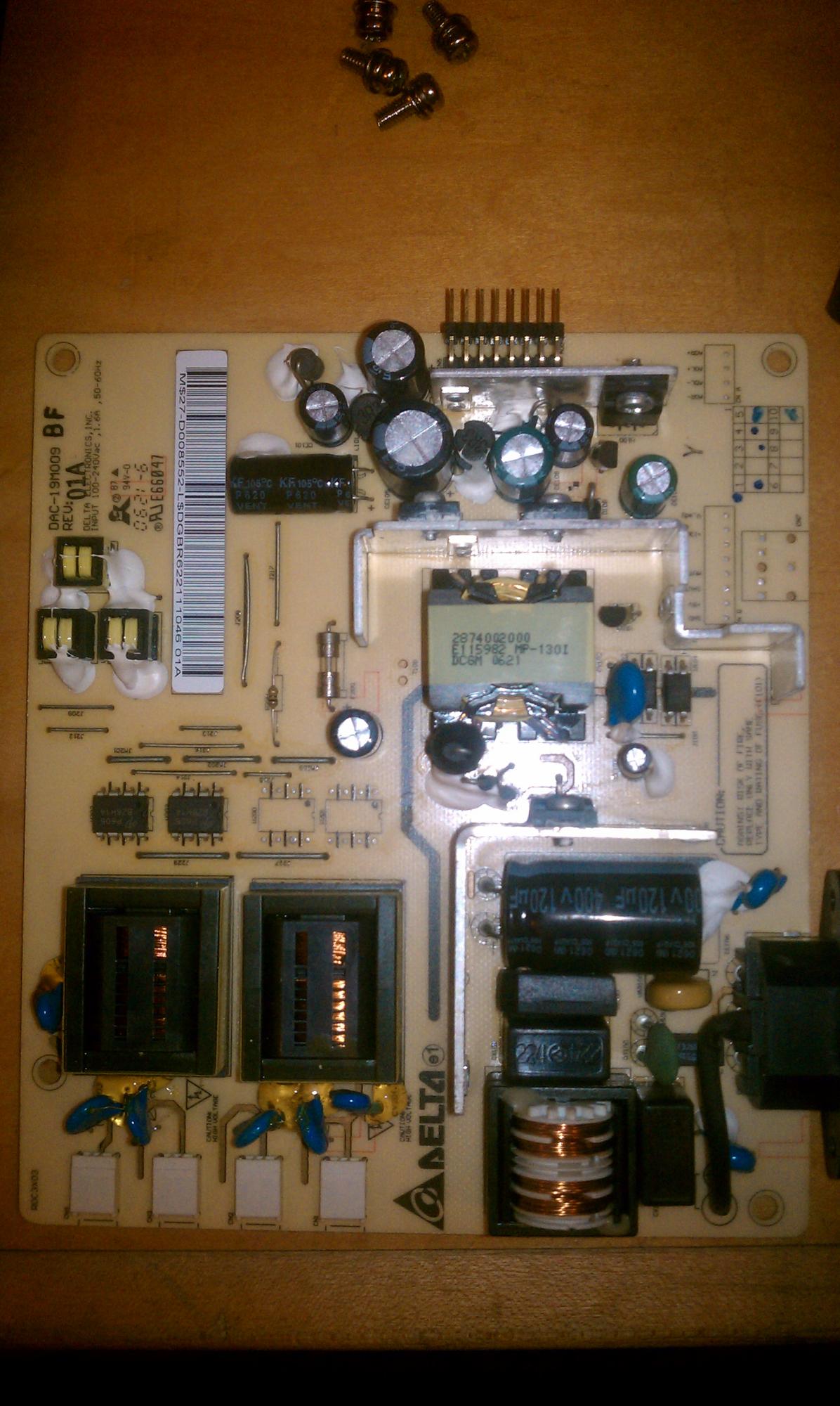

    Strange problem I've not come across before:
    From completely cold (no power hooked up) I can run DVI or D-sub (using this as a monitor) and it will work great for 3-5 minutes.
    Once the monitor 'gets warm' the brightness starts to flutter, as in rapidly dimming and brightening perhaps 30 times per second.
    I disassembled the monitor, and inspected the caps. They are the Crapxon capacitors, but none are bulging. I have not read voltage on any of them just yet.
    I'm inclined to believe I have a lamp going bad, but I have been unable to locate exactly what kind of lamps I have.
    Would it be a good idea for me to replace the Crapxon capacitors anyway?

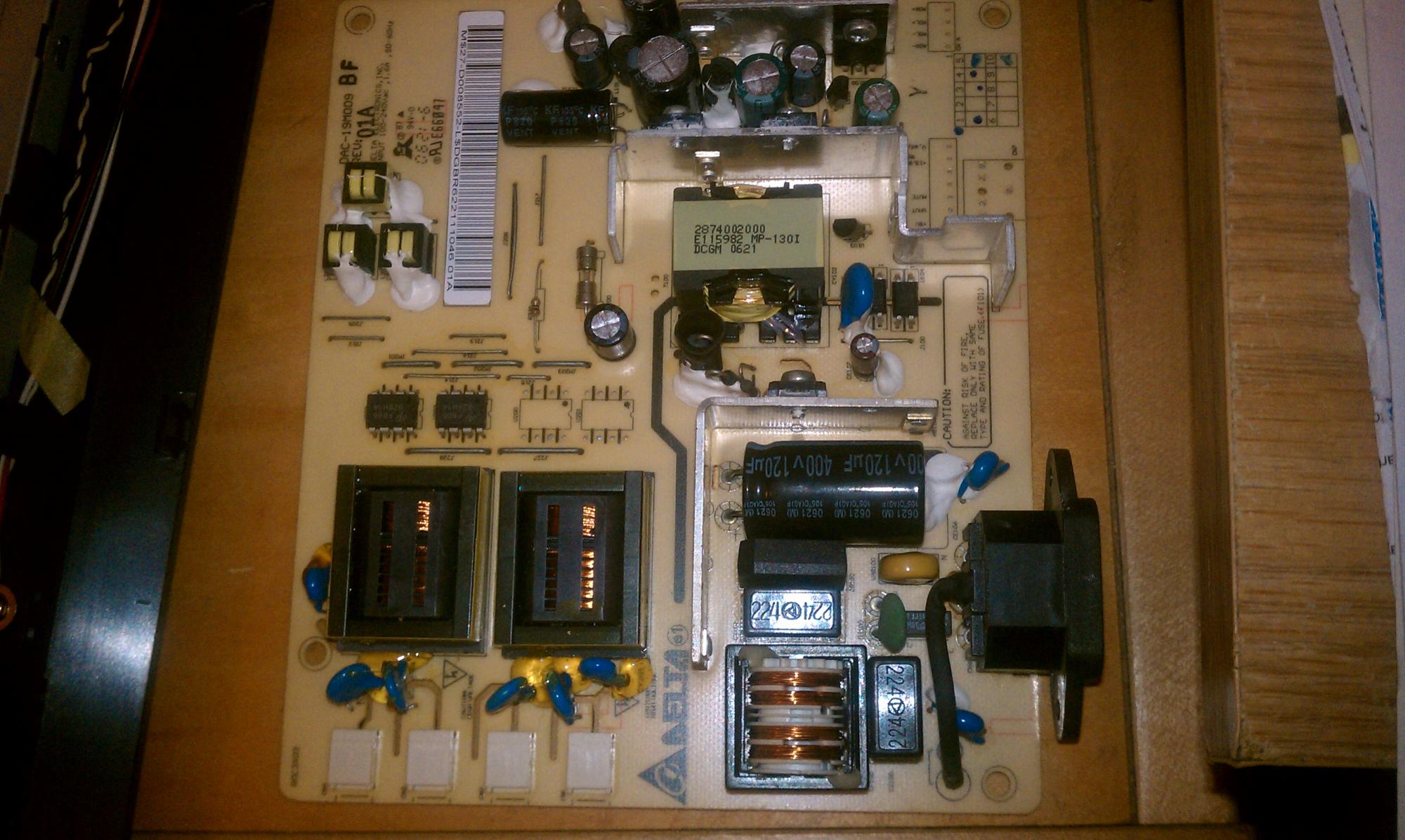

    I have the following on the board:
    (1) 400v 120uF on its side
    (3) 25v 220uF
    (1) 25v 330uF
    (1) 10v 2200uF
    (1) 50v 22uF
    (1) 10v 1000uF
    (2) 25v 1000uF ( one is also on its side)
    I apologize if the pics are of low quality (taken via cell phone)
    Appreciate any information you can give!

      Caps do NOT HAVE TO BULGE to be bad. Either read their ESR or replace them. The fact that it goes off after a few minutes points to something failing, likely due to heat, and caps are a prime suspect, so yes, replace them anyway if you don't have an ESR meter to verify if they are good or not. Being this is an LCD screen and the backlight is what is causing the problem, it seems obvious the problem area is the backlight inverter circuit area. Furthermore, the issue could be caused by failure of the PWM regulators on the inverter, or a short in the high voltage output of the inverter, though I suspect the caps or regulators first.
      Another step is to use a cooling fan to isolate the area that is failing. Try to cool an area and see if it works longer. If not, move to another area. Find the area causing the problem and report back.

              its a switchmode PSU, so yes.
              i see C(r)apxon KF and some green Taicons.. i'd replace all of them except the primary filter cap (the big fat 400+V one ..those rarely fail..)
              would be easier to suggest replacement caps if you specified the size (dia x length).
              plus the series for the taicon's and if there are other capxon series than KF, those too..

                (1) 400v 120uF - 31.3mm tall x 18.2mm diameter / 0621(M) 105C - (AQ)P
                (3) 25v 220uF - 12.6mm tall x 8.25mm diameter / CapXon KF P620 Vent
                (1) 25v 330uF - 15mm tall x 8.31mm diameter / 0613(M) 105C - (HD)P
                (1) 10v 2200uF - 20.4mm tall x 13.2mm diameter / CapXon KF P608 Vent
                (1) 50v 22uF - 11.95mm tall x 5.22mm diameter / GL 105C P616
                (2) 25v 1000uF ( one is also on its side) - 20.78mm tall x 10.58mm diameter / CapXon KF P620 Vent
                (1) 10v 1000uF - 17.11mm tall x 10.28mm diameter / 0619 (M) - the rest is behind the cap next to it, so I can't tell what else it may read.
                If I can locate a replacement, I'd like to replace the primary filter cap as well, just to eliminate it being a problem - unless there's more going on there than I know about!

                                  yeah.. that big fat cap is the primary filter. cleans up the DC coming from the rectifier right next to it (the black box without text on top)..
                                  closest i found on digikey is 565-1469-ND (United Chemi-Con KXG)
                                  but that's a 100uF cap.. not 120uF.. :|

                                      It should match exactly or it can be roughly 20% higher. In terms of size, it is hard to tell from the initial picture, but you can go a bit taller and *maybe* a bit wider.
                                      You can also go up in voltage, but higher voltage caps are usually bigger.

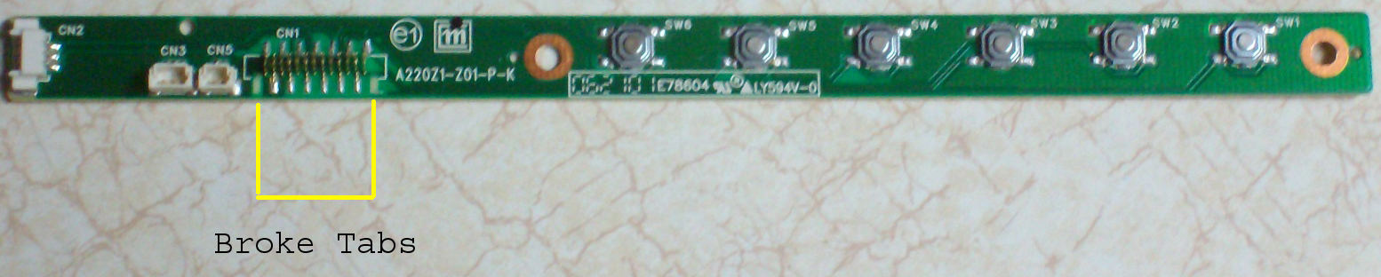

                                        I am working on the motherboard of the same monitor and all this info is really helping. I have 3 bulging caps. I am hoping this forum will help me figure out what I need exactly and how to replace it. However, my main problem is that my button set is messed up. Does anyone know where I can order a new one? Google search has produced nothing.
                                        #s on button set:
                                        A220Z1-Z01-P-K
                                        E78604
                                        LY594V
