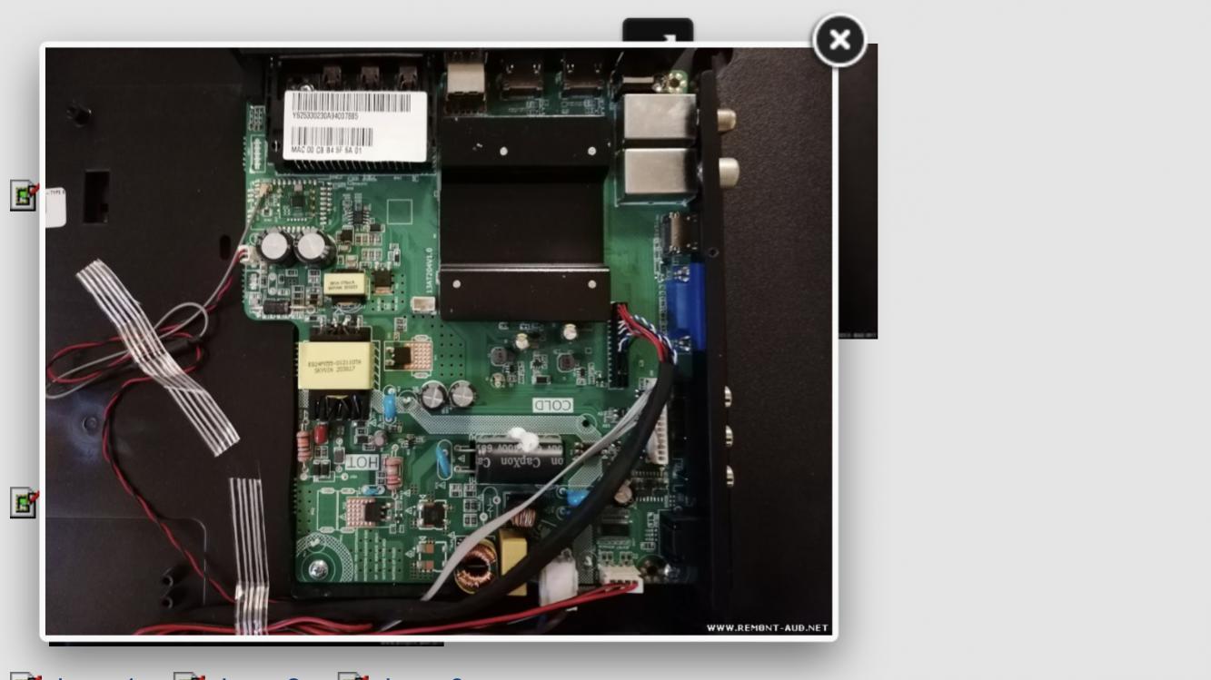

    Good day everyone. I have to restore the firmware of this android tv. My procedure is this: after inserting the usb key with the file in img format, I hold down the on button on the front panel and insert the power socket. turns on but does not go into fastboot the initial logo always appears and remains here. Isn't this the right procedure?
    Thank you for your help

    Re: Restore tv ALL STAR ASSTV3220HDS
    Does it look like yours ?
      Yes, this is it

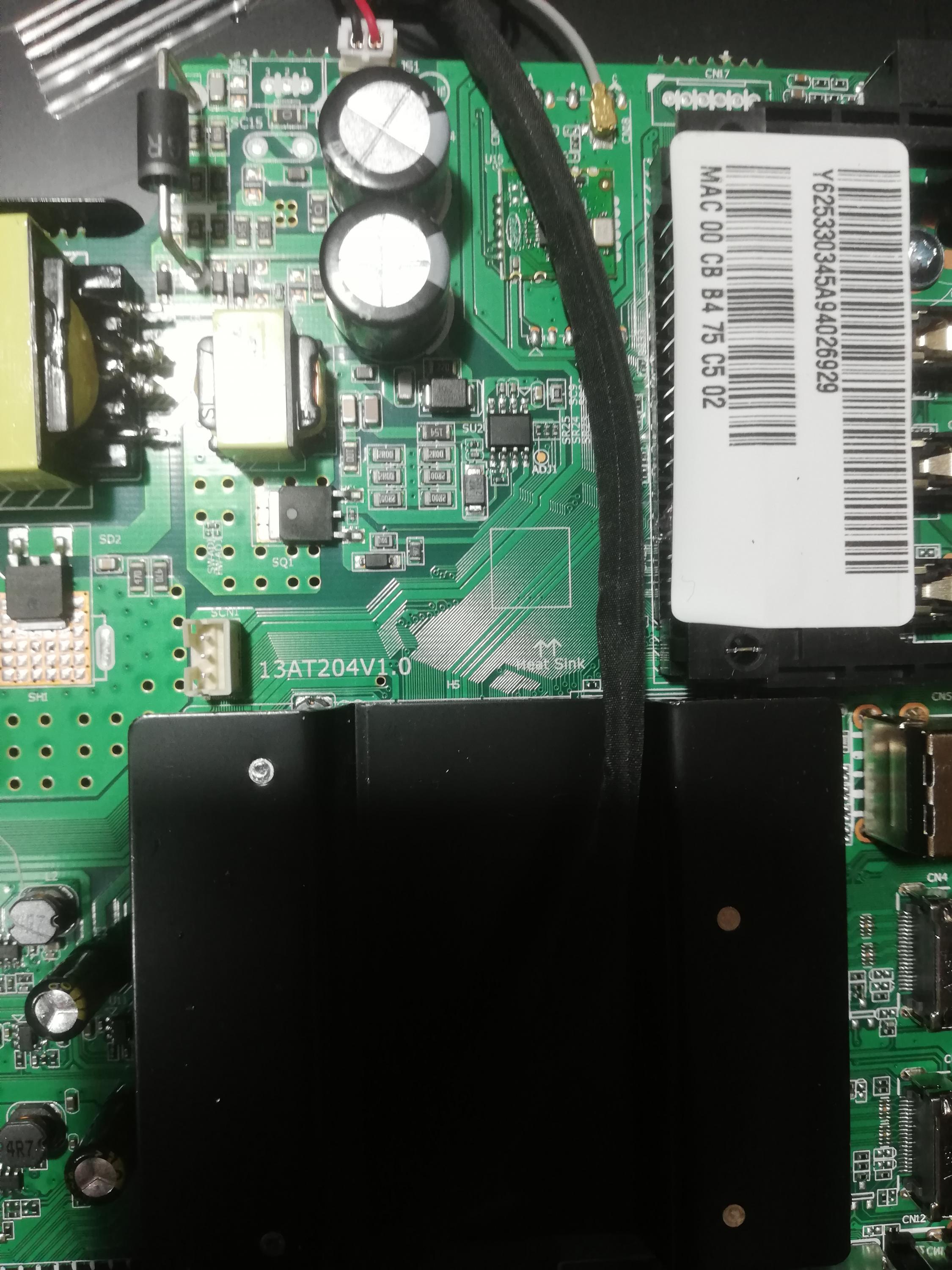

          I have removed the mainboard but I have not found any spy flash. I have a programmer mod.EZP2019 + which supports chips series 24 25 26 93. I have not found any chip with this abbreviation.
            Did you remove the big black radiator from the processor ? Maybe spi flash is under it

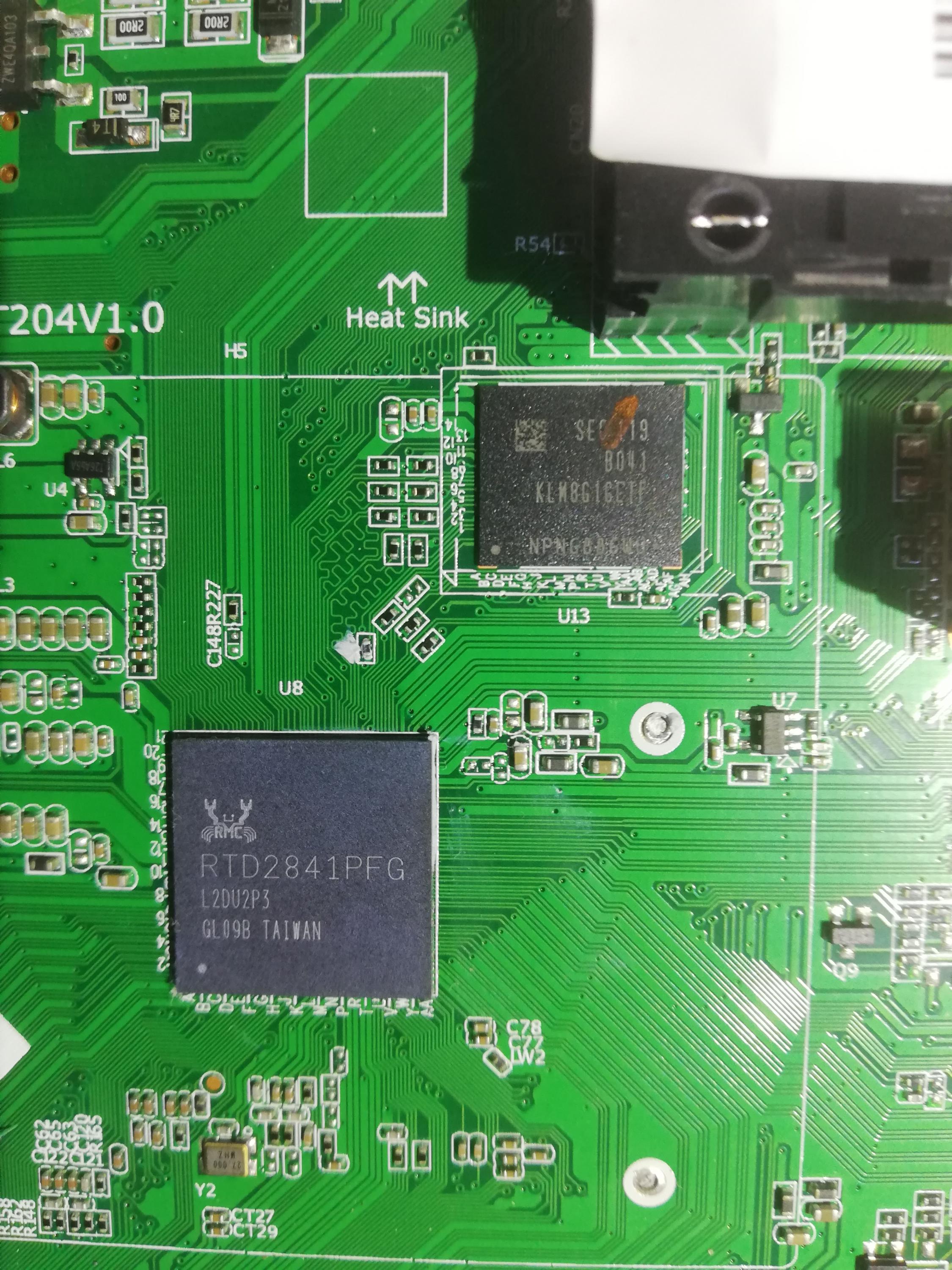

              I removed the black heatsink and couldn't find any flashes ... maybe it's not the right firmware
                There is no SPI Flash, it has eMMC.
                  Show a photo of this part of the board under the radiator
                    eMMC : KLM8G1GETF-B041
                      Yes - eMMC
