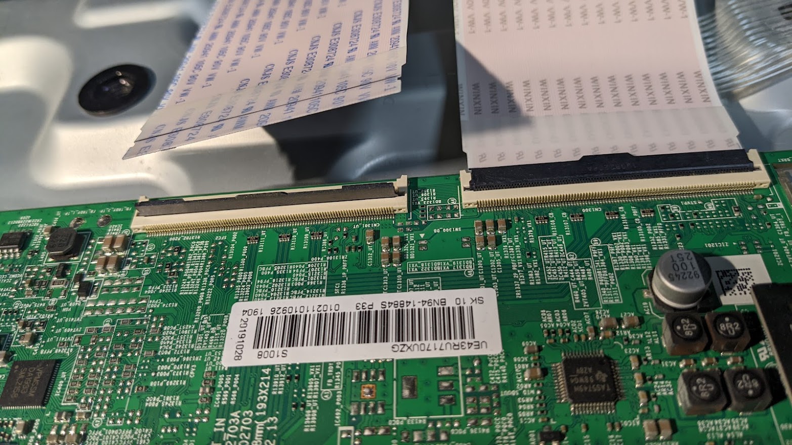

Samsung UE43RU7092U restarting with no video
  • thesame
    • Mar 2018
    • 141
    • Romania

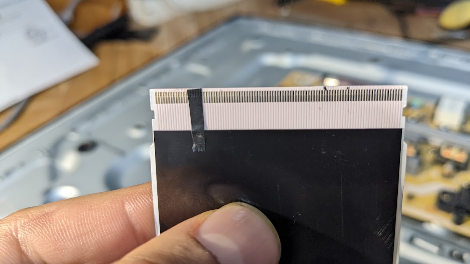

    The tv is restarting every 5 seconds with no image , i have tryed to remove each of the flex cables separatelly , then the tv stays on , i can hear the sound starting, but no video, i have found a some pins to cover with tape and i get video but after a few seconds a few vertical lines fade in the image, has anyone any idea what should i check or do next?

    Check for shorts on the panel board on side you put the tape.
    • captainKKK
      • Sep 2018
      • 287
      Re: Samsung UE43RU7092U restarting with no video
      What are those other two little black spots on the cable you taped?
      • dskall
        • Oct 2016
        • 2905
        • usa
        You are probably blocking to many lines. If you are using electrical tape instead of thinner scotch tape, then contacts on either side will have problems.
