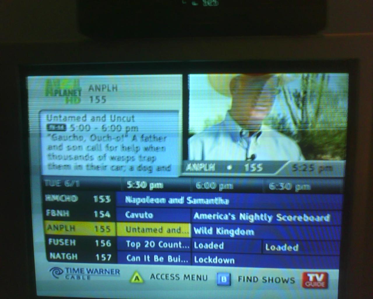

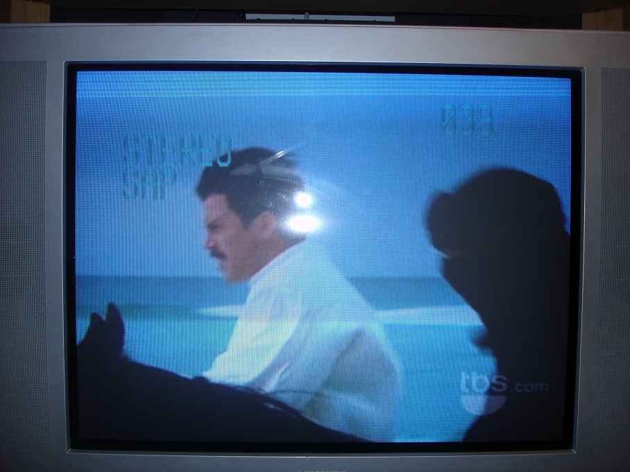

    Hi, I am having trouble with small white lines at the top of my Toshiba 24af44 and have been told that it is probably a filter cap in the vertical deflection circuit? I do not have this problem when watching hd tv on letterbox, only when the commercials come on or the guide comes up. I would like to replace these capacitor/s myself, but do not know how to go about doing this or what to buy. I do have about 8 years doing desktop and laptop support so if someone would be able to help show me what to do I would appreciate it! thank you.

        Yes you have bad pump capacitor in vertical circuit. Replace it with 100uF 35V, standard ESR. No point in low ESR.

            Find the one diode with cathode end connected to the positive side of this small capacitor. This power goes through this diode on anode side and also to the vertical IC.
            The capacitor is wired to the vertical IC that "stacks" both stored voltage of this cap plus supply power of vertical IC to around 48V or so for kicking beam up from bottom to top. Hence the pump capacitor.

                    Usually on borderline caps the lines will slowly migrate up as the cap heats up and the ESR goes down.
                    Screen voltage too high would wash out the picture in white and show lines all the way down the screen. I had the chance to mess with screen when replacing some flybacks .

                    Oh yes and get this cap business in the vertical circuit sorted out if left too long it can kill the vertical IC. As Wizard said general purpose is fine here but make sure its 105C rated.

                      Re: White Scan lines on top of toshiba 24AF44
                      before i actually go in and start soldering though, this is what the picture looks like. Once i exit out of the guide and back to letterbox, the lines go away. [/IMG]

                        This look familiar?
                        100uf 35V cap near the vertical IC.
                        My case wasn't as severe as yours it seems your cap is in worse shape.

                            Yes, that is called vertical fold over.
                            Do it now as this is stressing out the vertical IC.
                            Cheers, Wizard
