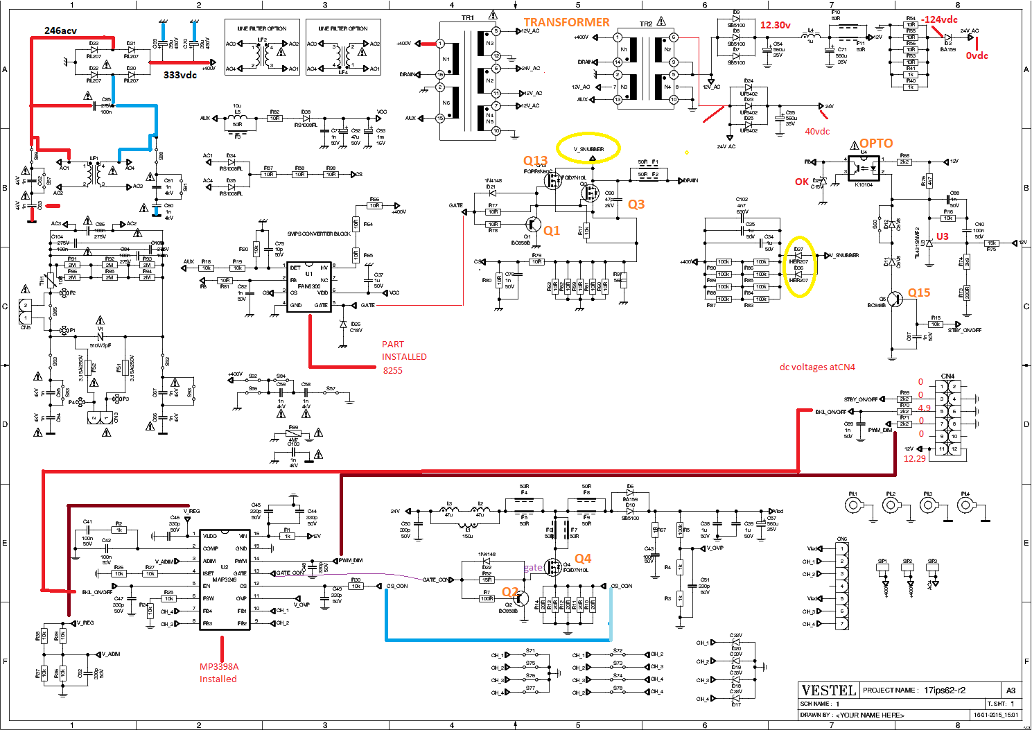

    I know the pins what do I measure.

      Disconnect mainboard. Looking for the stby pin on the power supply. Between the stby pin and the POWER / ON pin put a resistance of 4.7-10k. Power supply starts. Put a resistor between the stby and the BL / ON pin. The backlight PWM controller starts and the LED voltage appears. For the correct operation of the backlight, place the resistor between the stby and the DIM pin.
      Or most easily join the power / on, bl / on and dim pins and put them all together with a stby resistance.
      If you have done the right thing and all is well, the backlight should come on. This is called "table testing".

        Please find attached schematic.

          See attached schematic cn4 can you please make a quick sketch of connections.

            Connect 3 with 5 and 7. Then through a 10k resistor to pin 11. With mainboard disconnected from power supply. When plugged in, the source should turn on automatically and the backlight should turn on.

              Hi yokoono, backlights came on progress at last thank you.
              Does this mean main board at fault?

                more than likely mainboard fault, that stand alone test you just did, means the backlights and powerboard are ok.

                  The motherboard is defective and does not command DIM. You can short circuit between BL / ON and DIM and use that. It's just that you can't adjust the backlight from the MENU anymore. If the voltage on the LEDs is too high, put a resistance between bl / on and dim.
                  L.E.
                  An NPN smd transistor may have burned out on the motherboard. The repair is for a specialist, not for you.
                  If the fault is in the processor, the TV will not work or will work without a picture.
                  I recommend that in this case you cut the dim wire that is between the power supply and the main.

                    Hi yokoono, you were right again motherboard fault new one arrived today fitted and TV came on awaiting arrival of remote.
