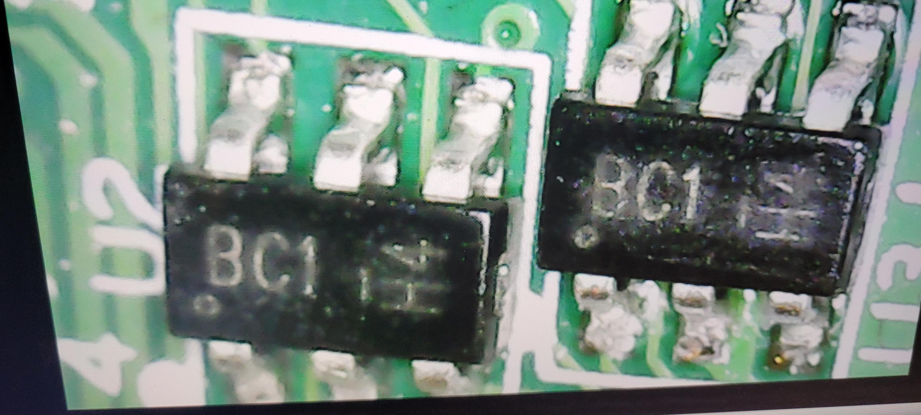

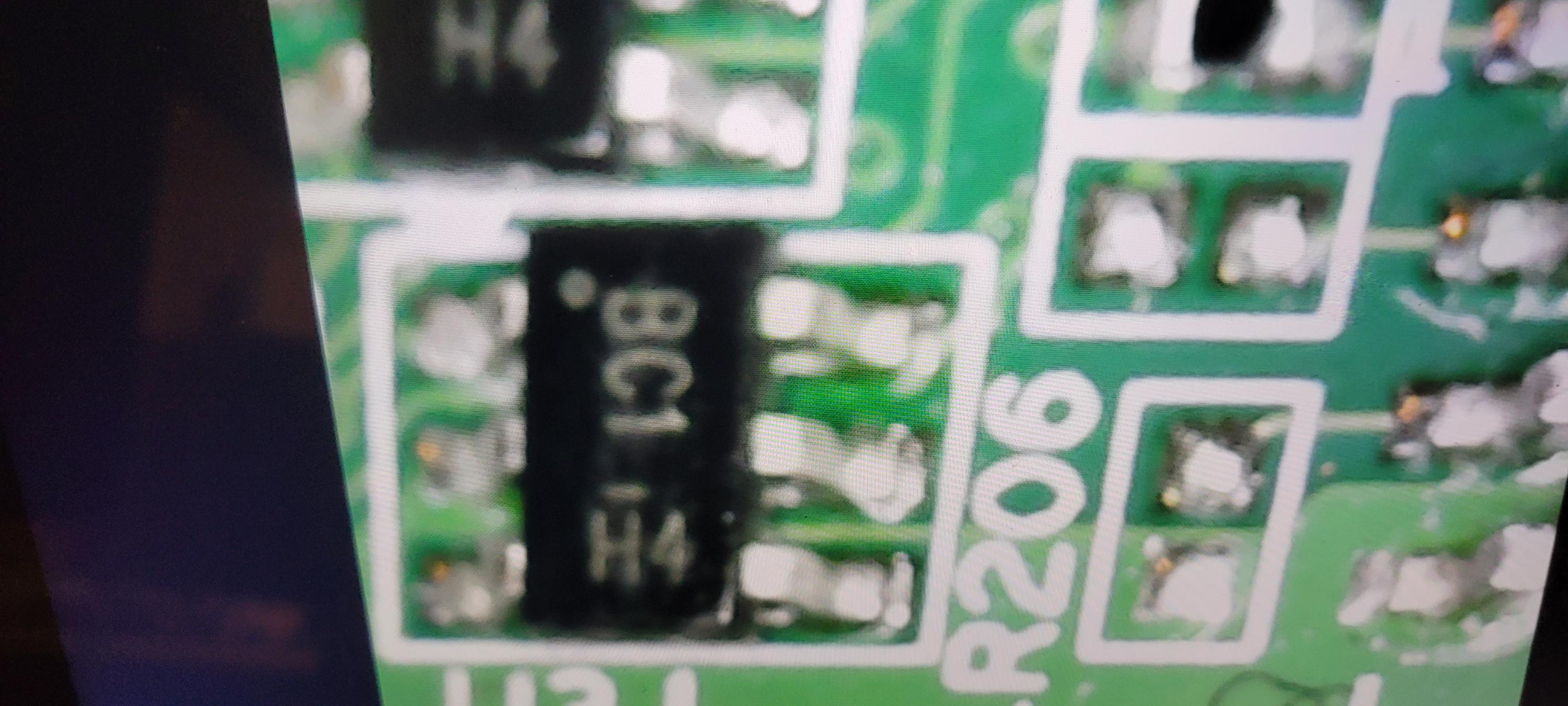

    Can anyone identify these diodes on the buffer board and tell me where I can get replacements , also has anyone got a service manual for this tv as can't find one anywhere.
    What sequence on the remote works for the service menu ?
    The tv reboots when been switched on for a while and want to check these diodes out as they seem to be a problem as I've read up on here .
    Tried 4xpsu,t-con,led and mainboards and seems to stop happening when I disconnect any ribbon cable from t-con to buffer boards.
    Display has no lines or defects from what I can see .
    Any advice is much appreciated.
    Thanks in advance the knowledge on here is a great help and learned soo much already.

    Is that an 8 or a B
    • Fridaycider
      • Feb 2022
      • 16
      • United Kingdom
      Re: Samsung QE55Q700T
      Looks like a B
      • R_J
        • Jun 2012
        • 9624
        It should be DT1042-04SO-7
        • lotas
          • Jan 2016
          • 4892
          • Russia
          Dt1042-04so
            Thank you
            • Fridaycider
              • Feb 2022
              • 16
              • United Kingdom
              Wow , really hard to find any in the u.k.?
              • Fridaycider
                • Feb 2022
                • 16
                • United Kingdom
                D1213A-04SO-7 rs components say this is the alternative as DT1042-04SO-7 is discontinued?
                • Fridaycider
                  • Feb 2022
                  • 16
                  • United Kingdom
                  https://uk.rs-online.com/web/p/tvs-diodes/8270437
                  • Fridaycider
                    • Feb 2022
                    • 16
                    • United Kingdom
                    Originally posted by Fridaycider
                    Can this be used ?
                    • R_J
                      • Jun 2012
                      • 9624
                      Yes the D1213A-04SO should be fine to use.

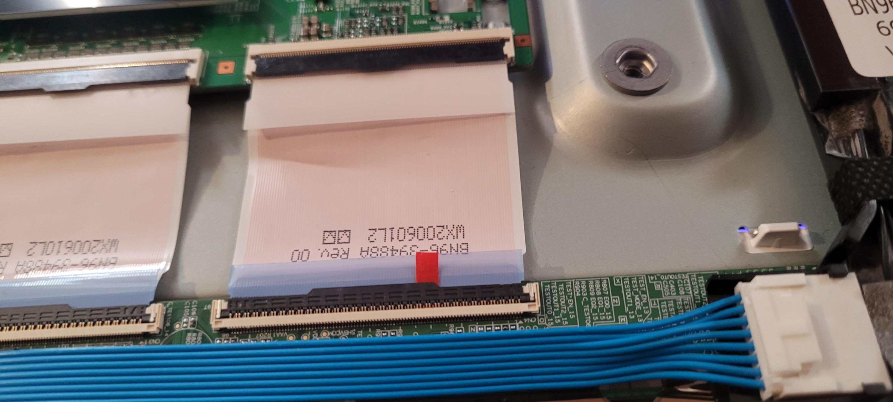

                        Thanks for the help but not sure if needed now . Did the tape method and narrowed it down to the right hand connector and at the moment very slight temporary line in screen so need to look a bit further into it .

                                      Has anyone any information on removing the backlight panel on this model as the display is part of the frame and either the panel needs to be removed from frame or the backlight panel unclips from the rear leaving the panel on the frame . Not sure how to go about it ?
                                      • Fridaycider
                                        • Feb 2022
                                        • 16
                                        • United Kingdom
                                        I've unplugged the upper backlights and it's stopped rebooting on another set
                                        . The backlights are all working but can one be shorting causing this
