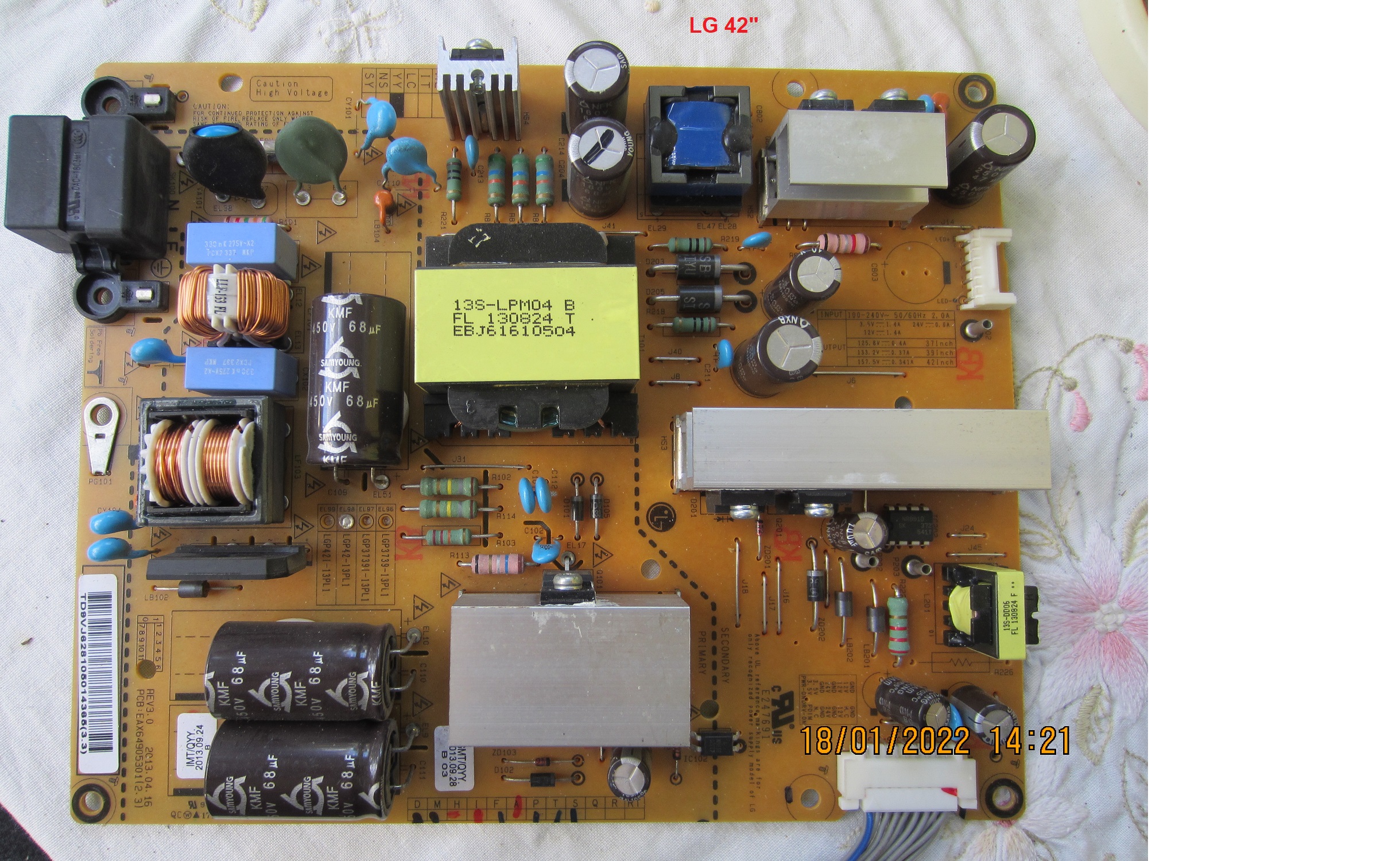

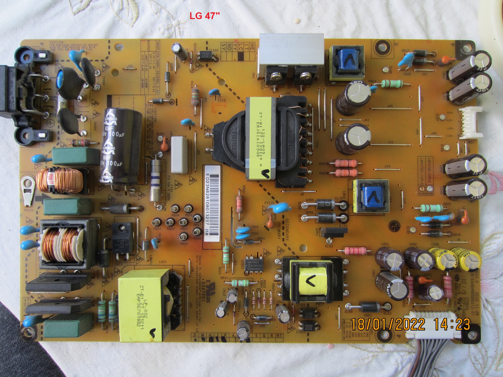

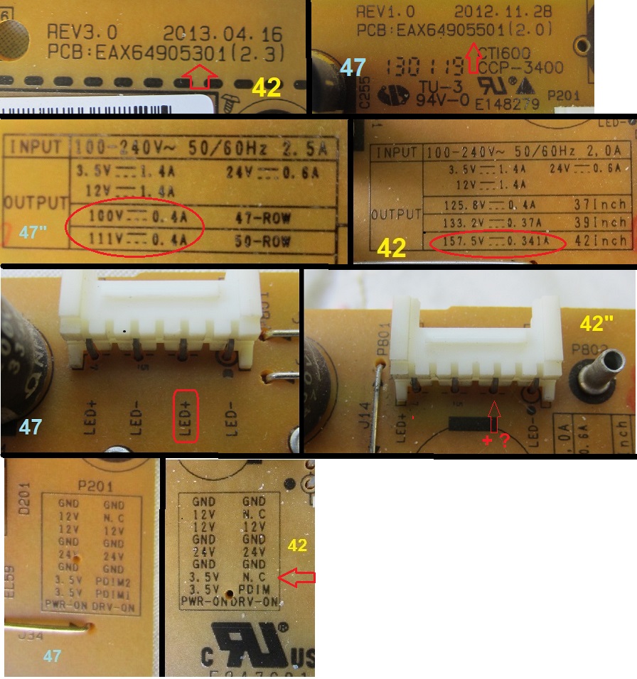

    2nd : I got PSU of 42LN570Y , it is smaller. Main's connector identical EAX64905(3)501 ( 42 has 3 not 5) : I upload photo of the important info with them. Do you think it can be used instead? ( I will repair the board of the 47" later)

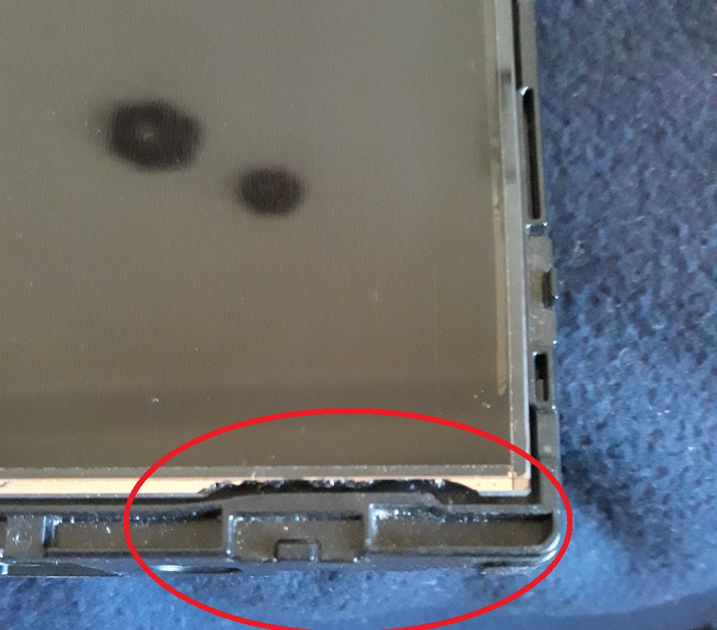

                    Re: LG 47" 47LN570Y Can I switch PSUs of same Series ?
                    I received the new LED Strip set
                    But discovered the Panel got broken. Looks like it slipped out of place since I didn't fasten it in its place as I should have
                      So easy for lcd panels to get damaged like this, i did the same on my first backlight repair job. Luckily as you know all the boards work you could sell them on if you wanted.
                        Sadly its my 2nd panel I break.
                        I was extremely careful with this one, but what I've learned from this is that they are not designed the same. In this TV , you can see the little bump in the plastic near the edge ? It would look well seated if you look at the middle of the frame. AND, it slipped a bit , since I should have used , and screwed, the metal frames around as they are meant to keep it in place.
                        Lesson : Always reassemble the Panel in Frame properly , even if you know you'll reopen later on. don't be lazy !
