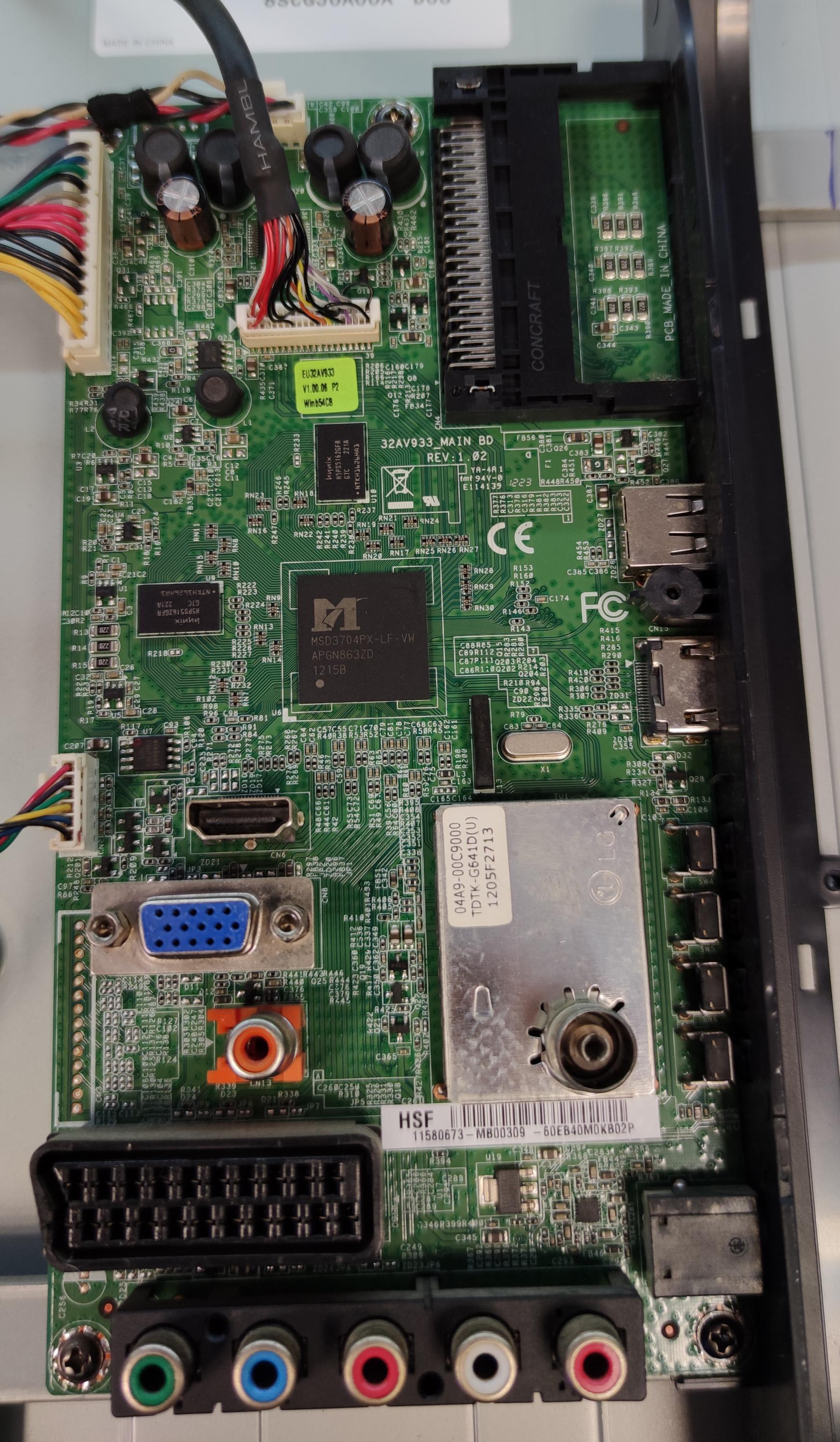

    Hello, I have this TOSHIBA 32AV933G and it is stuck on standby LED (red). It doesn't turn on and the 12V is missing. Anyone has any experience with these PSUs and what to check? (DPS-140SP A)

      Are you getting a change at your PS_on terminal?
      • WhiteWolfHellas
        • Jun 2019
        • 95
        • Greece
        Re: Toshiba 32AV933G stuck on stby
        Nope, 0,0V at PS_ON. Any other idea?
          Originally posted by lotas
          Maybe the firmware has crashed.
          I thought about this too. Do you think the 25Q64 needs programming?
            What is your motherboard number and panel number?
                Panel: LTA320AP05
                MB: 32AV933_MAIN BD 11580673-MB00309-60EB40M0KB02P
                  I just injected 3,3V with my bench PSU to PS_ON and 12V and 24V appeared, so my PSU is OK. The problem is the main board?
                      Try under your panel.
                      I just removed it, programmed it then resoldered it back to the main board, still the same unfortunately.
                        Check all the voltages on the motherboard inductors, maybe there is no voltage or the voltage on them is too low.
                          Check your power on and ir for voltage and change when you press buttons. Try heating up main chip and see if it comes on, BGA problem. 3.3v on pin8 of eeprom. 1.2v for processor core. Voltage at oscillator.
                              I see voltage change when I press buttons on the remote and there are 3,3V on pin 8 of eeprom.
