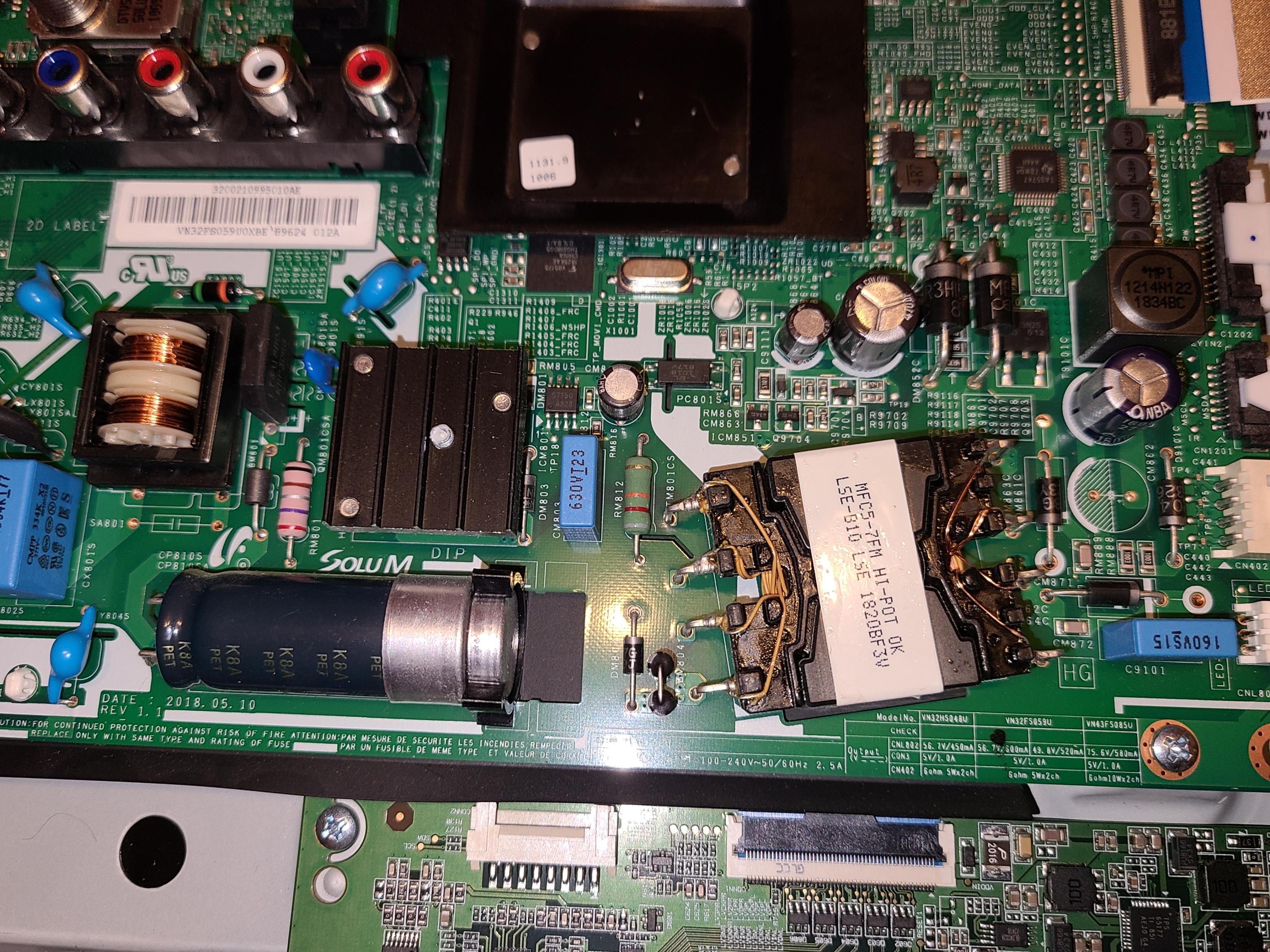

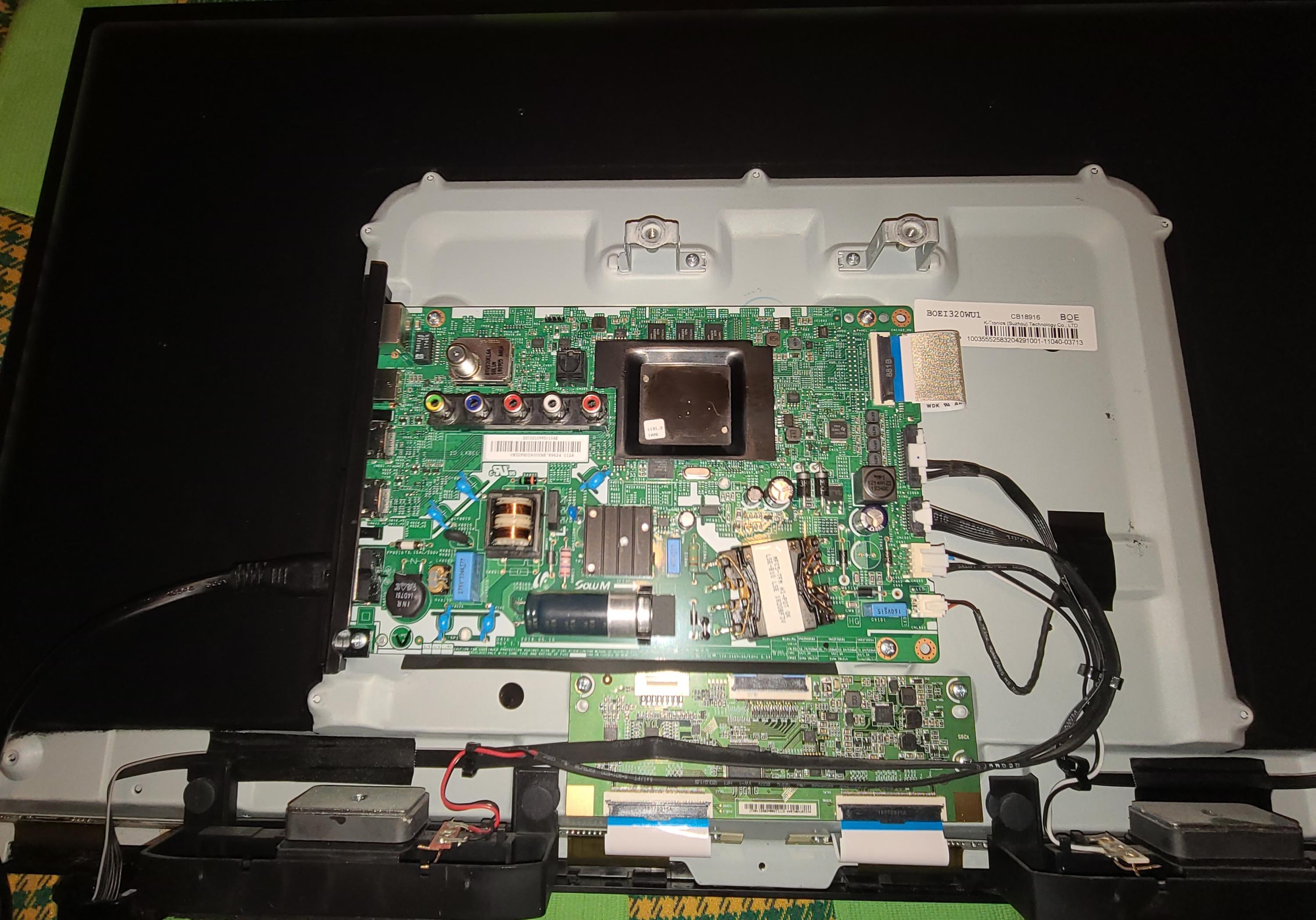

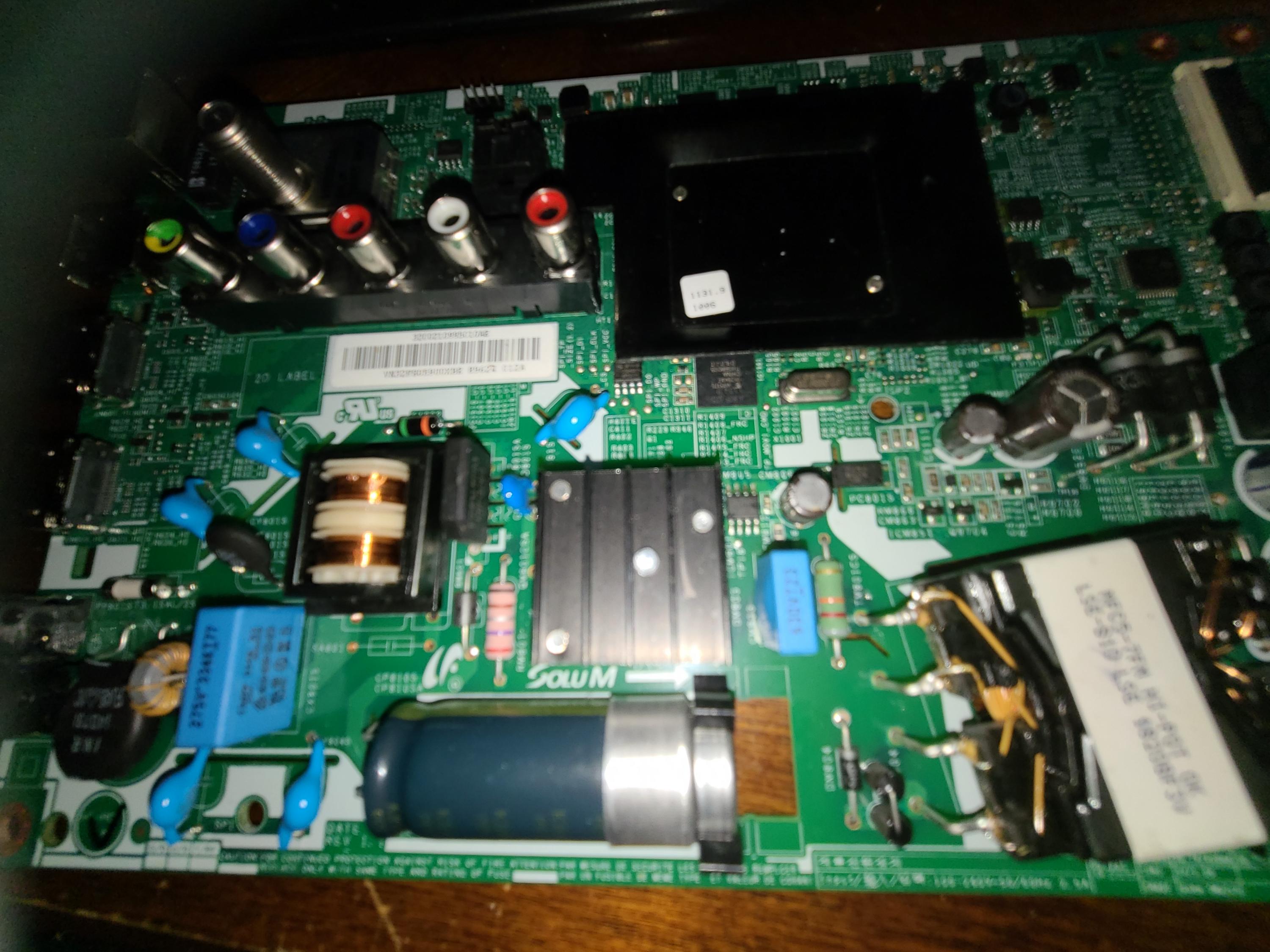

    Hi Folks,
    Got this TV, with power / main combo board. The TV has the front LED indicator on. Indicator Seems responsive to remote and push button activity.
    No Backlight or image with flashlight at all. Optical Audio doesn't come on. First check was backlight. Checks out with tester, but still i opened it up and each LED checks out. 3 strips, 6 LEDs each.
    Second check the large cap. It never goes into full voltage (running at 160 VDC), but PFC doesn't seem to kick in. when I press power button, momentarily goes to 163, then back to 160. Any suggestion where to look?

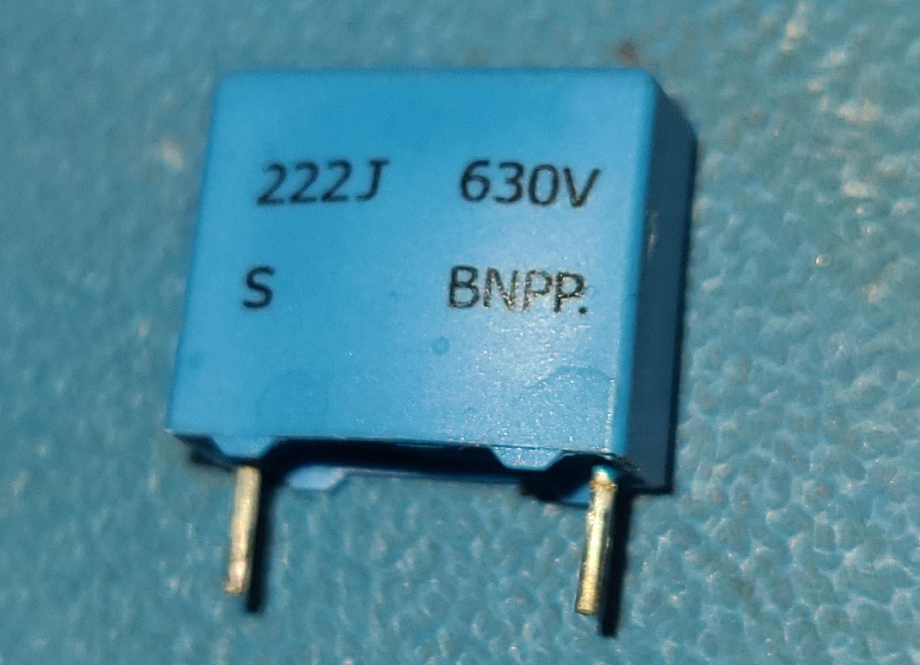

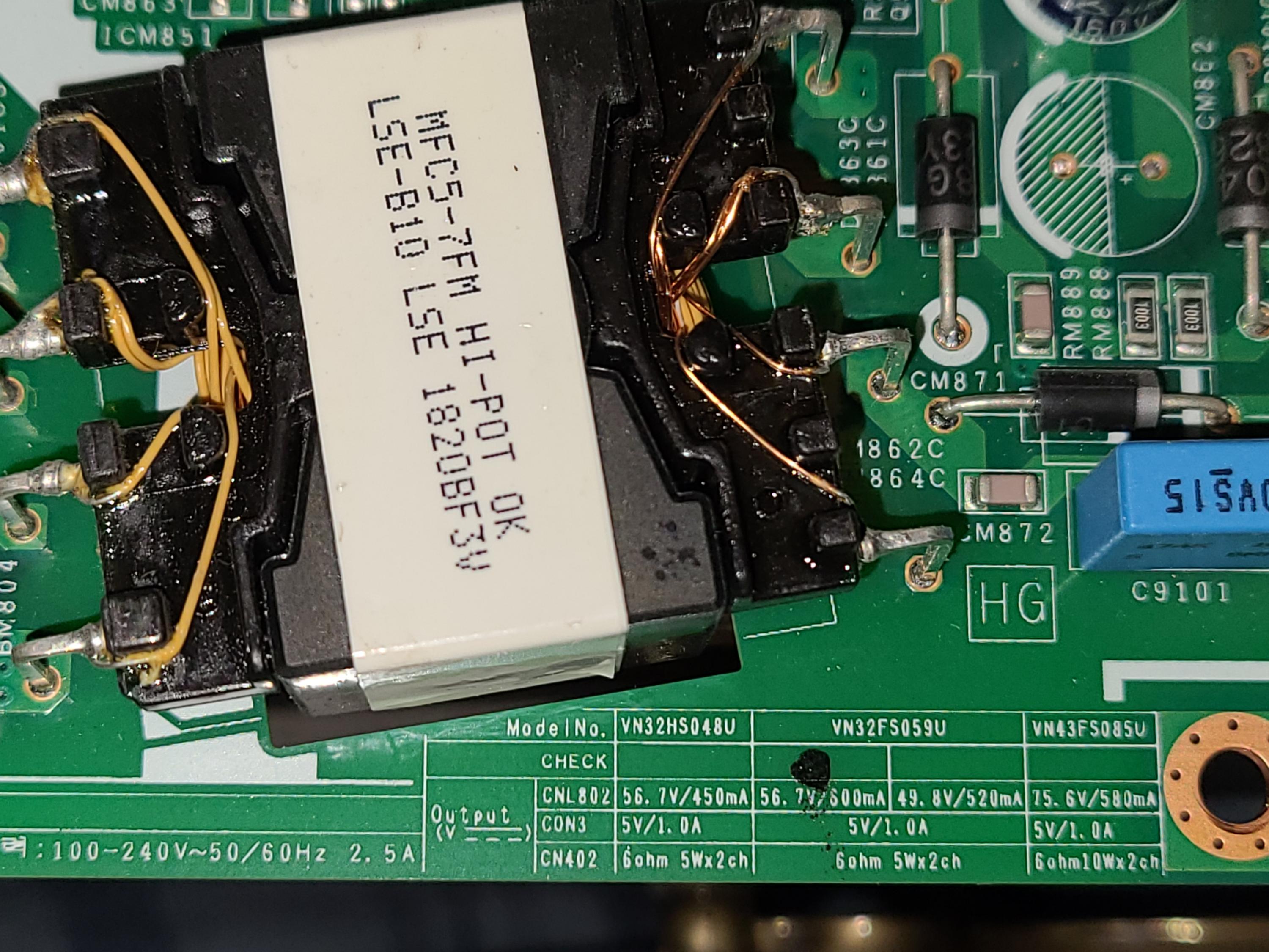

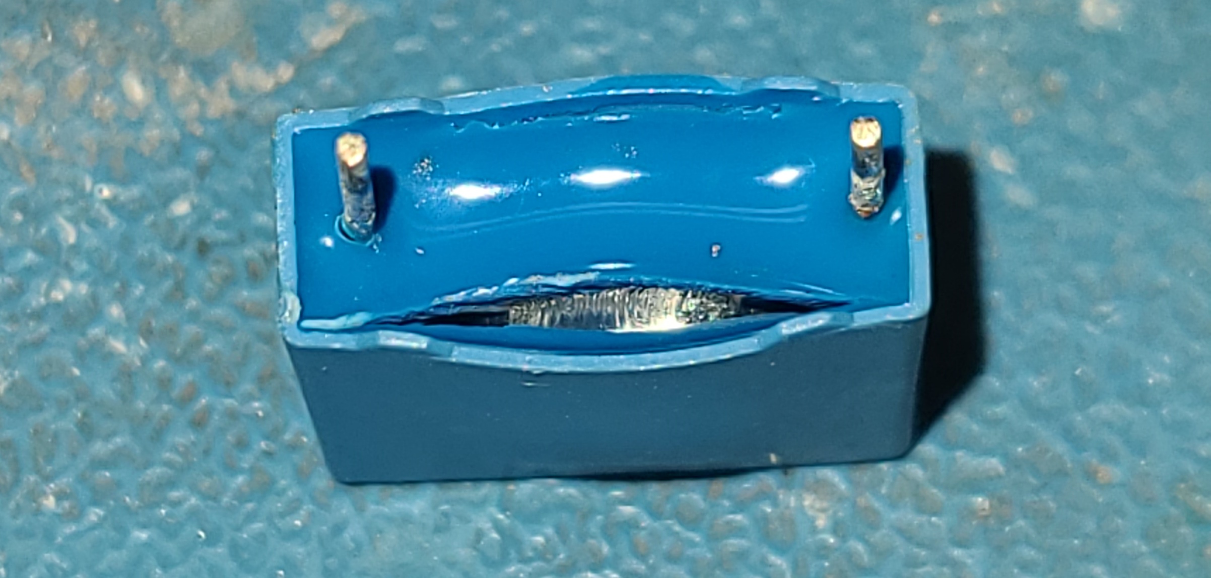

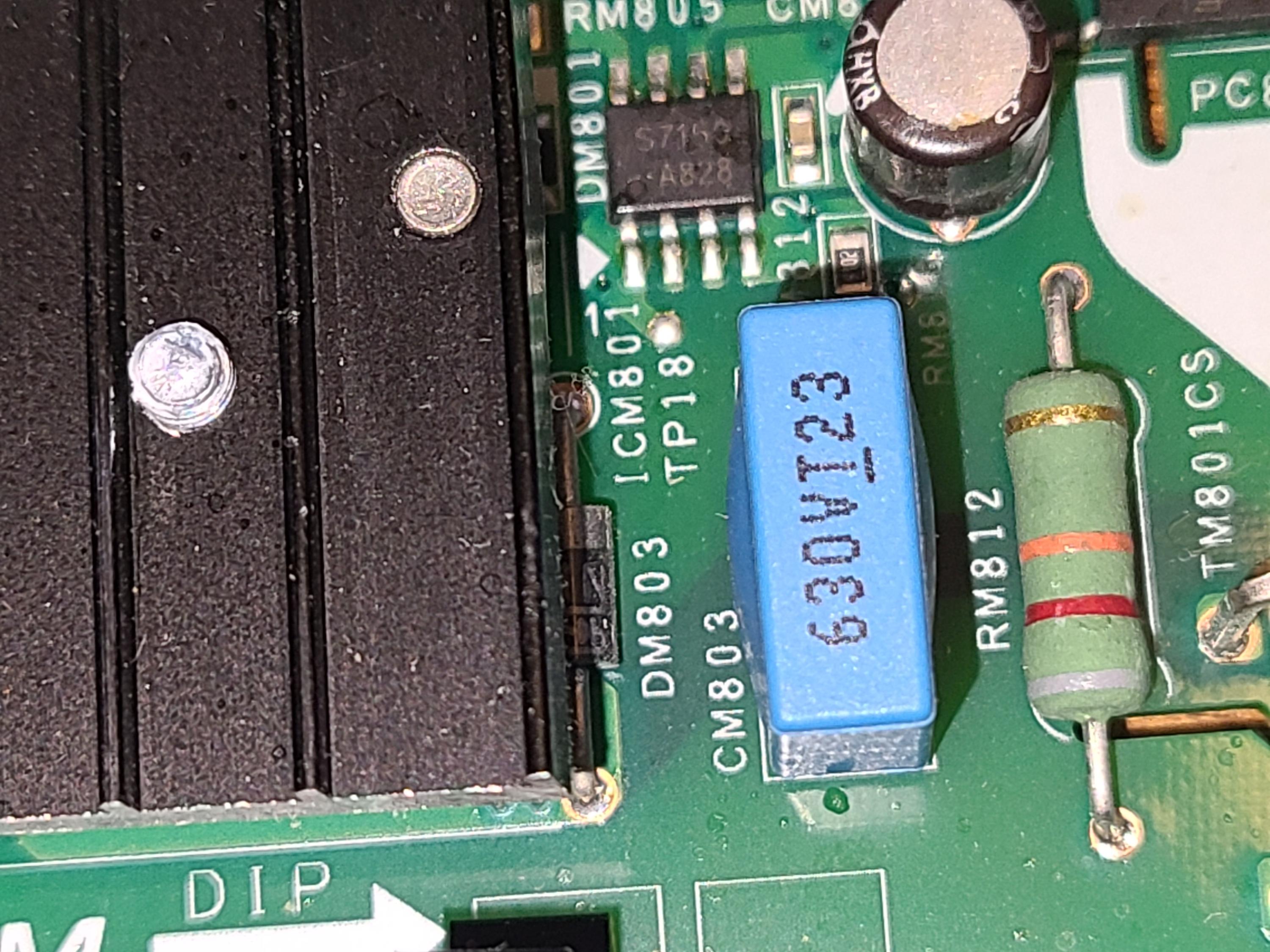

                                    Re: Samsung UN32N5300 SmarTV -2018
                                    The only thing that I could find suspicious about the board, is this 630V Cap that is swollen and the epoxy cracked as shown in photos. It's not shorted, and it has about 2.2 nF measured capacitance. Any idea where I can get a replacement if you think it might be the culprit?
                                    I do have a board installed in the TV and it's fine.. Would be nice to fix this one.
                                    • R_J
                                      • Jun 2012
                                      • 9576
                                      The cap is usually used to connect the transformer winding to ground. digikey should have them
                                      • dskall
                                        • Oct 2016
                                        • 2905
                                        • usa
                                        Funny it didn't look bulged in first pictures. Now you have a board that you could compare voltages on. Suspect maybe bad processor or firmware.
