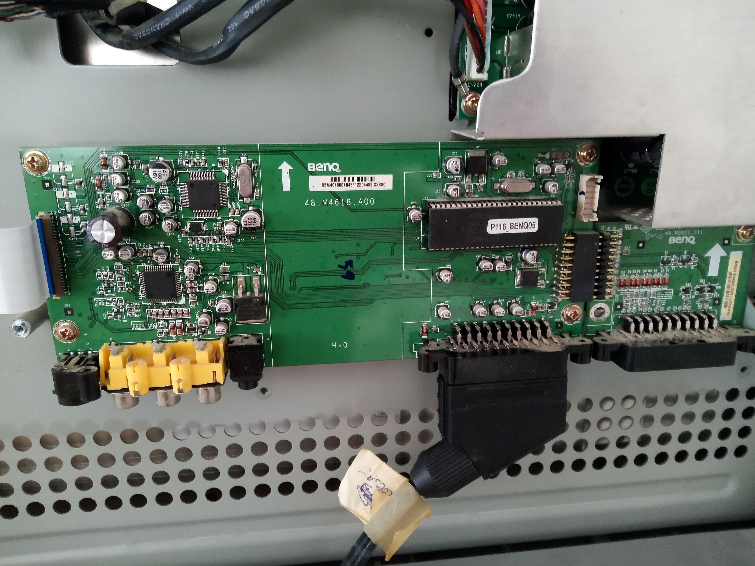

    Hi can anyone help please with cct diagram ,ive looked for hours
    this tv has no sound but the o/p stage is fine ,so suspect main board ,poss corrupt f/w?

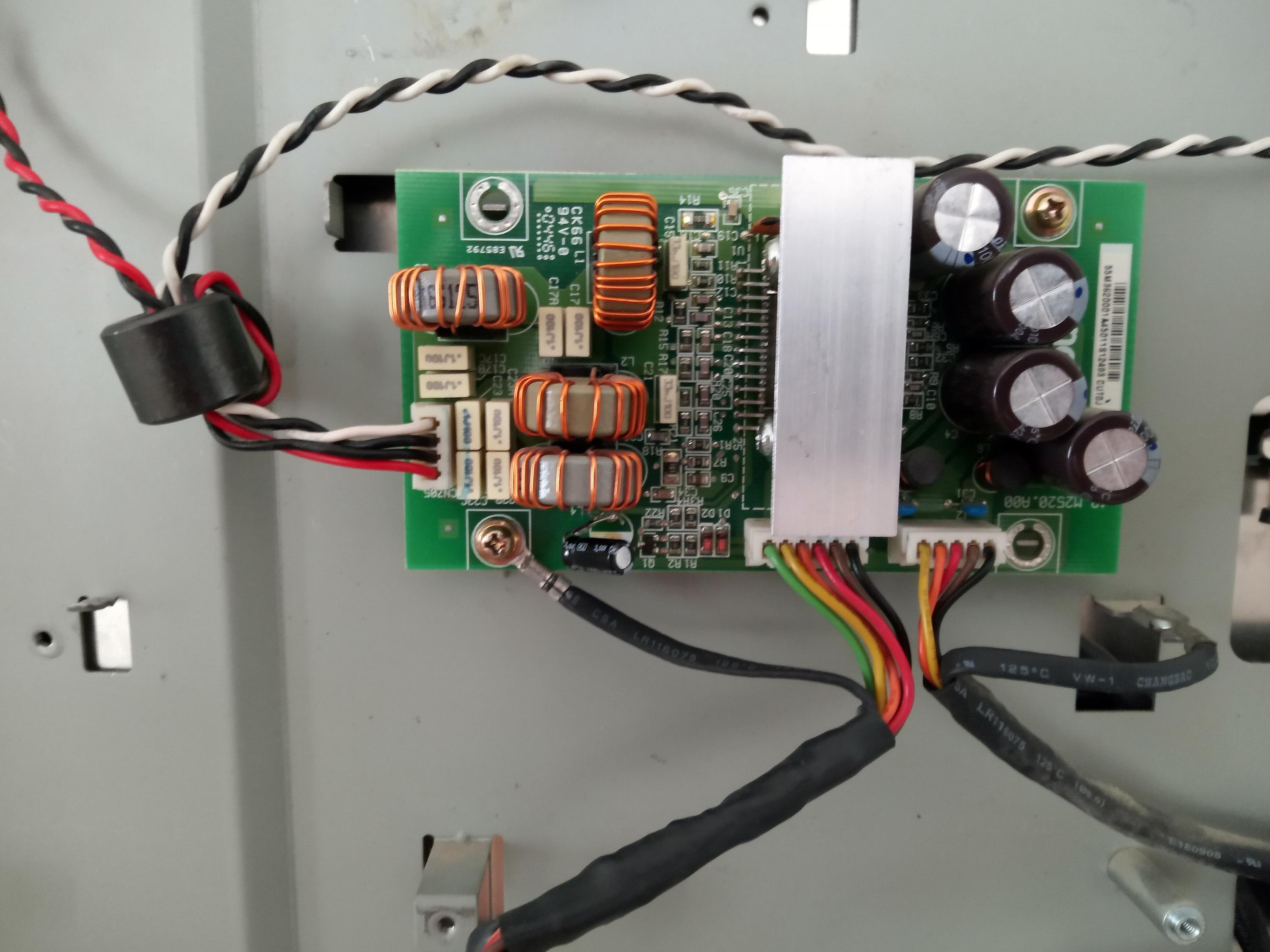

      Re: THOMSON 32lb120s4 no sound
      thanks for taking time to help .sadly this version you posted is different to mine the version i have has a TDA7490L for its sound o/p stage ,pin 6 of which is mute/on off .
      now when you press mute the osg shows on screen.
      the transistor q1 is used to switch mute on off
      there are 2 supplies -16v and +16v both present
                    So you need 4-5vdc on pin 6 to make active. 0 to 2.5vdc to mute and standby.
                      finally found cct .page 17 is audio o/p ,
                      strange theres no 5v supply shown on cct
                      it seems that the chip works without ?
                      please have a look
                      the cct is same even though the model number is 125 not 120
                          please have a look
                          The +5V and -5V are internally generated by the TDA7490L and available on pin 12 (+5V) and pin 16 (-5V).
                          The +5V (+VA5) then goes off to supply Q1 which controls the ON/OFF and Mute function.
                            so that explaines where the 5v comes from .
                            its not clear from the cct .
                            i now understand its from within the ic
                              the voltage is .05v ,so ill try to get replacement ic thanks
                                You may have a faulty Q1 or the +5V from the TDA7490L may be missing or either the ON/OFF or MUTE signal may be stuck at +5V.
