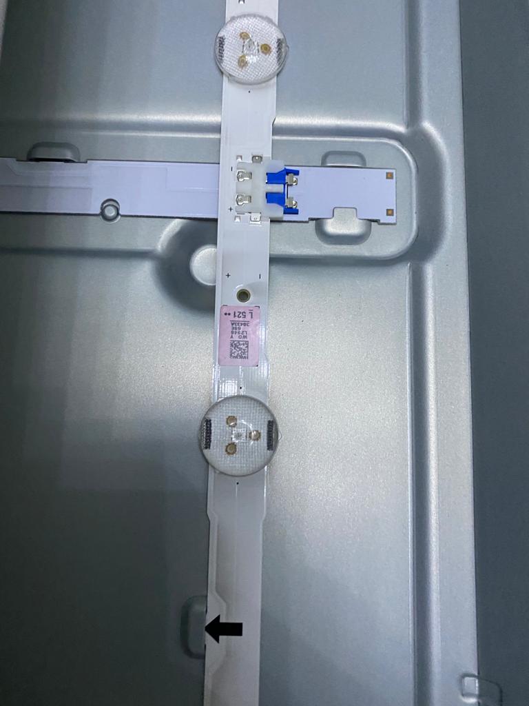

    Hi guys,
    I have a Samsung UE60H6240AK with backing light problem.
    Does any of you know where can i get a full set of backing lights ?
    I couldn't find any on ebay.

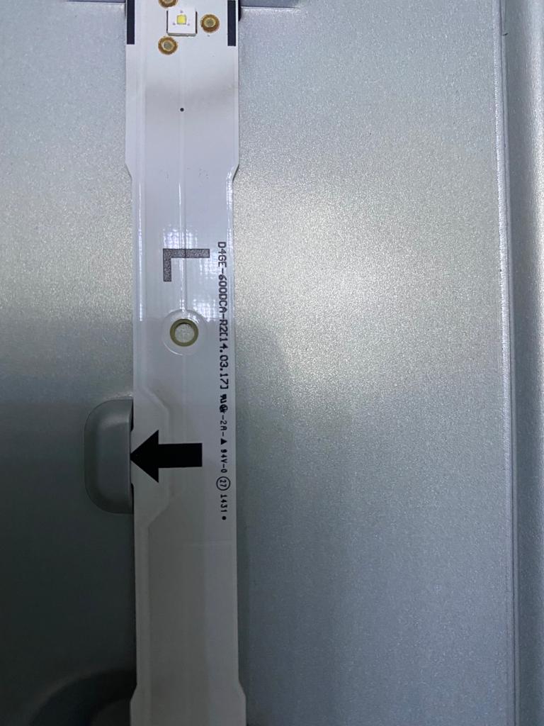

    I've atached some pictures with the LED strips. There model is: D4GE-600DCA

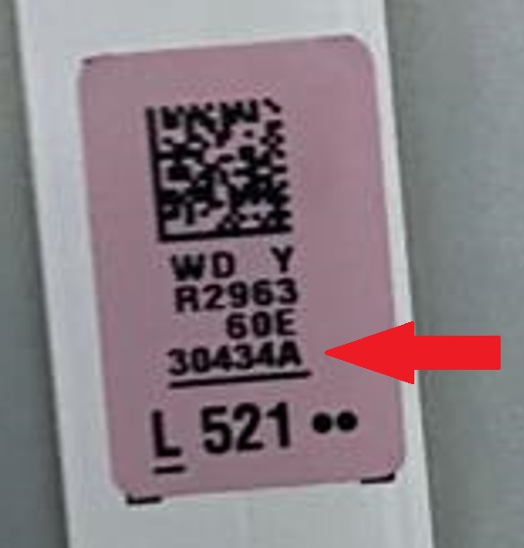

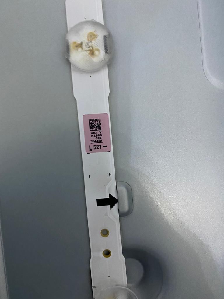

    Re: Samsung UE60H6240AK
    Search for BN96-30433A and BN96-30434A. The numbers are on the pink label. Add BN96- in front and you have the correct numbers.

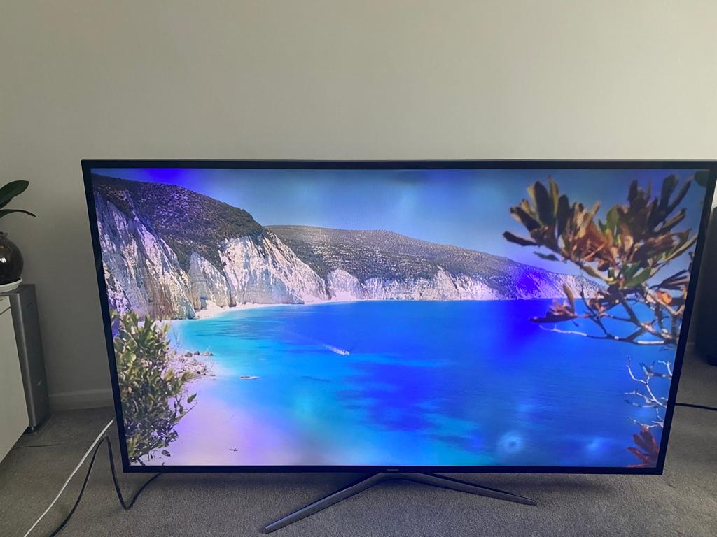

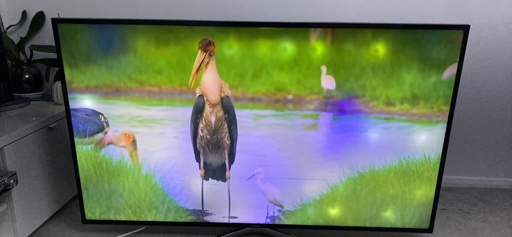

        Ok.. this is the story:
        Have an old Samsung LED 3D TV (UE55F6475). First it started to lose light on the lower 40% of the screen now and then. Like for 10-60 mins and then it would work again. Then a bit later it just got stuck in that position. The lower 40% of the screen is dark, and it gets progressively darker the lower u go so it's obviously that LED strips where not working. I also looked for similar errors online and saw an exact copy and on that one it was faulty LED strips.
        This is kinda how it looked, just that mine were at the bottom of the screen:
