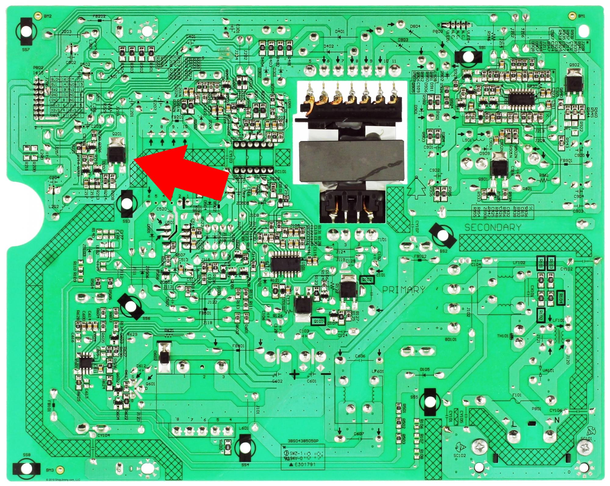

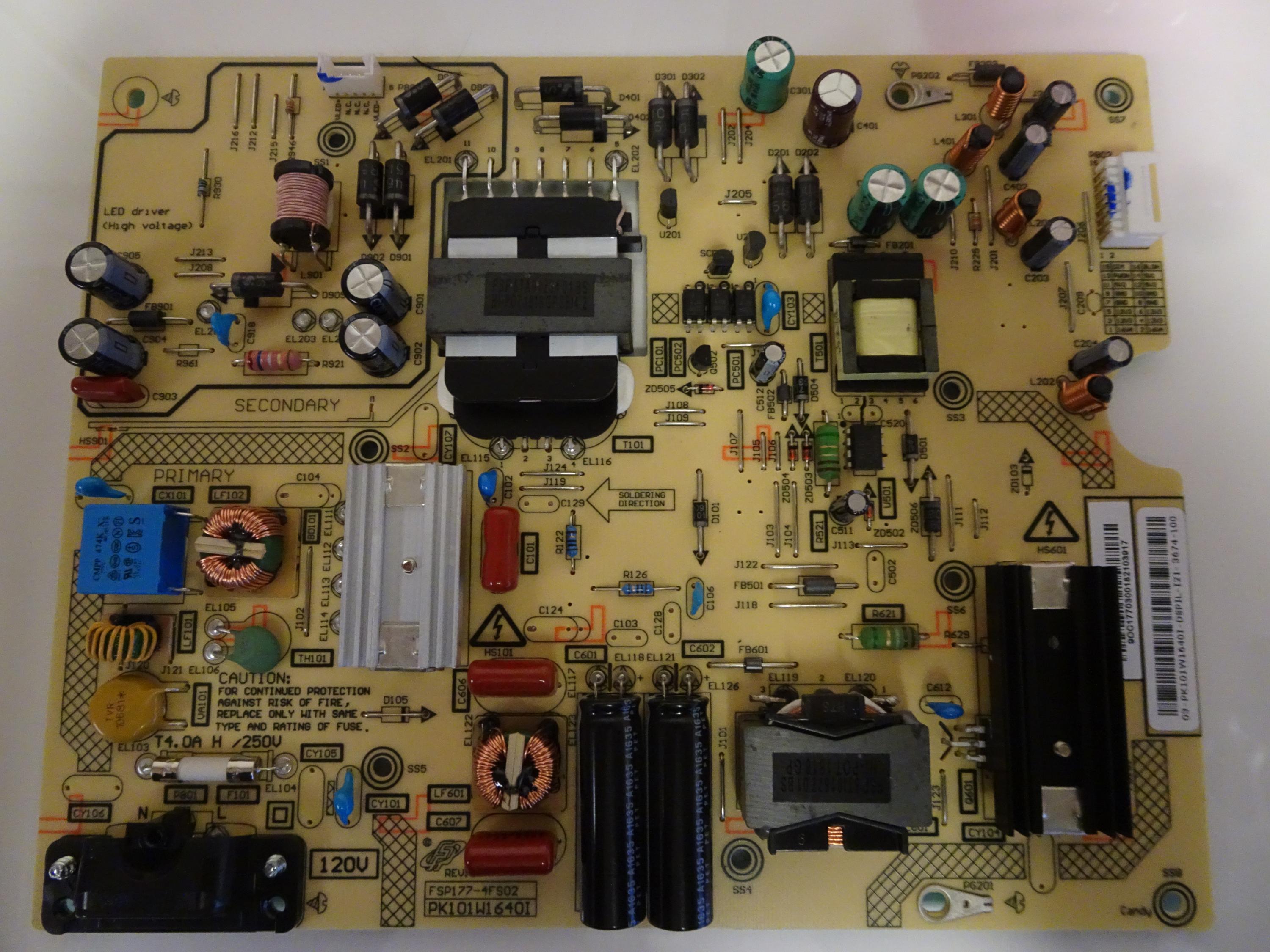

    Toshiba 55LF711U20 PSU Q201 part number please?
    Transistor Q201 is missing from the PK101W1640I (FSP177-4FS02) Power Supply am working on. The attach photo is from the internet for reference. Can anyone help me with the correct part number please. Thanks
  • R_J
    • Jun 2012
    • 9625
    Re: Toshiba 55LF711U20 PSU Q201 part number please?
    I don't have the exact schematic, but a similar one uses a AP72T02GH mosfet for Q201
