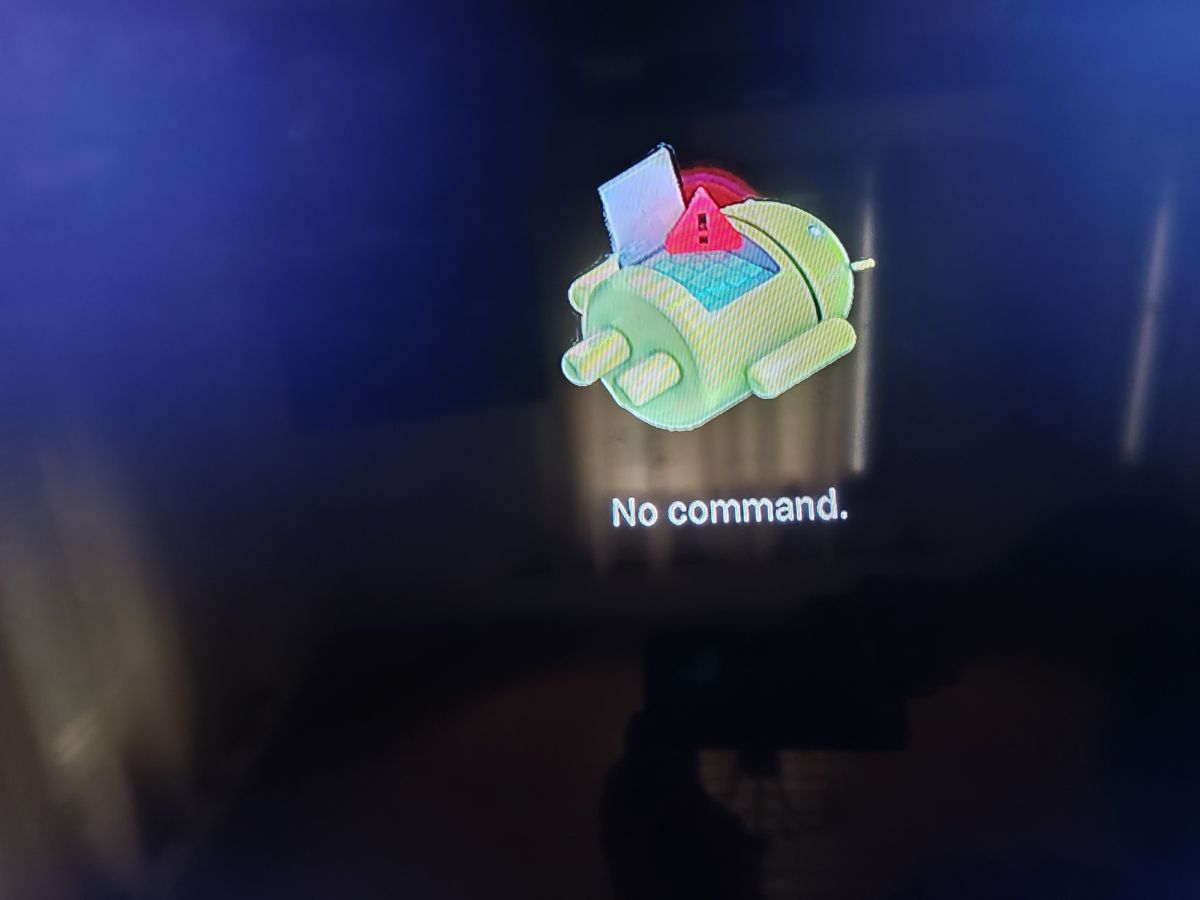

    This device tries to boot, but the android system fails.
    Will anyone know if there is any way to recover?

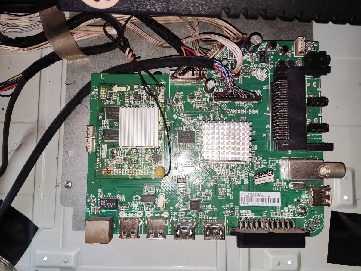

    I was able to confirm that the problem is with SPI flash 25Q32.
    I programmed with the dump of CV9202H-BSM-Gestone-42-Full HD and it now boots, but with color problem and the original command doesn't work.
    I attach the original dump so that a colleague can repair it.
    Mitashi MiDE040v01 FS TV
    Chassis: CV9202H-BSM
    Panel: CX400DLEDM
    Thanks in advance.
