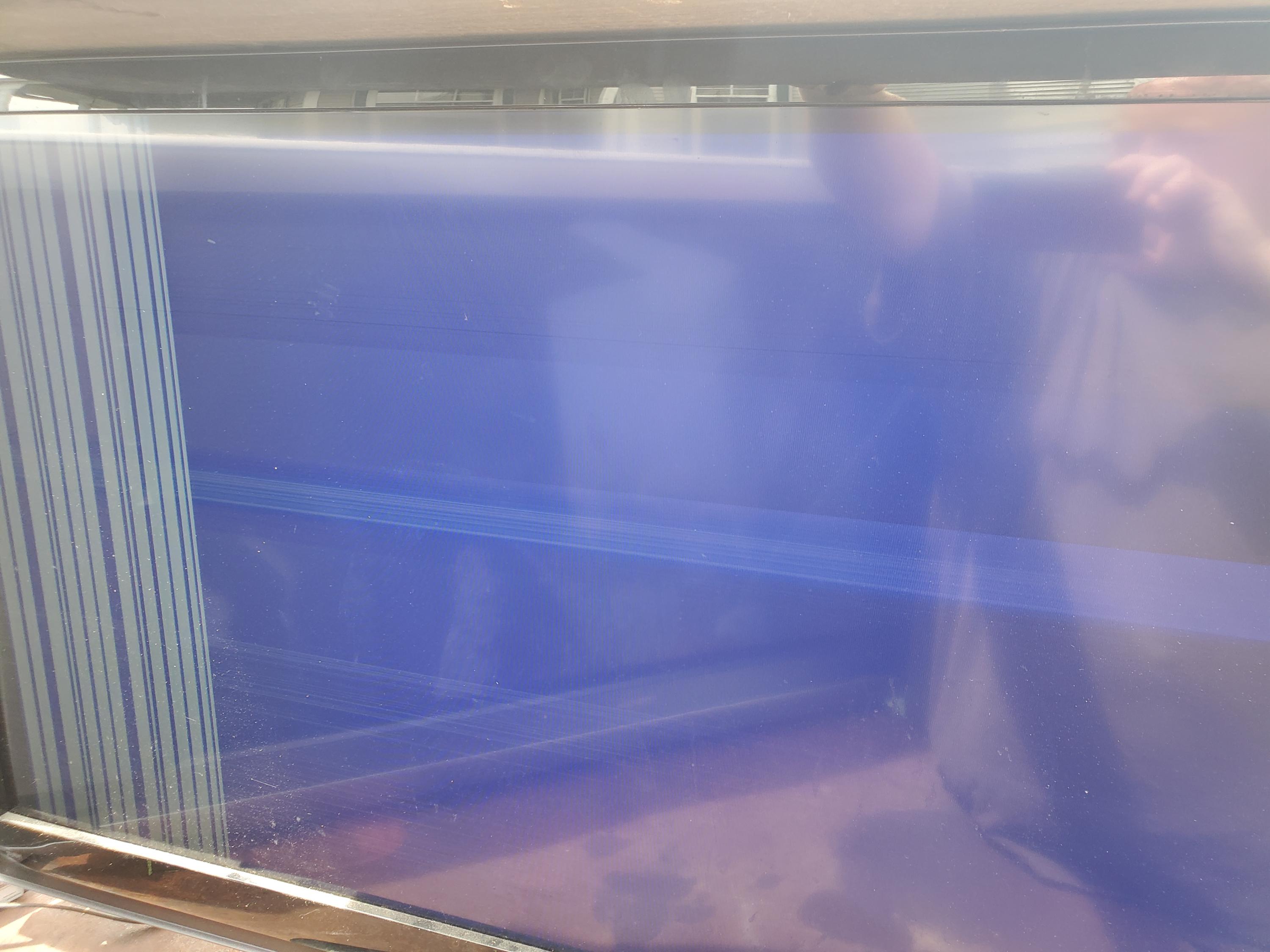

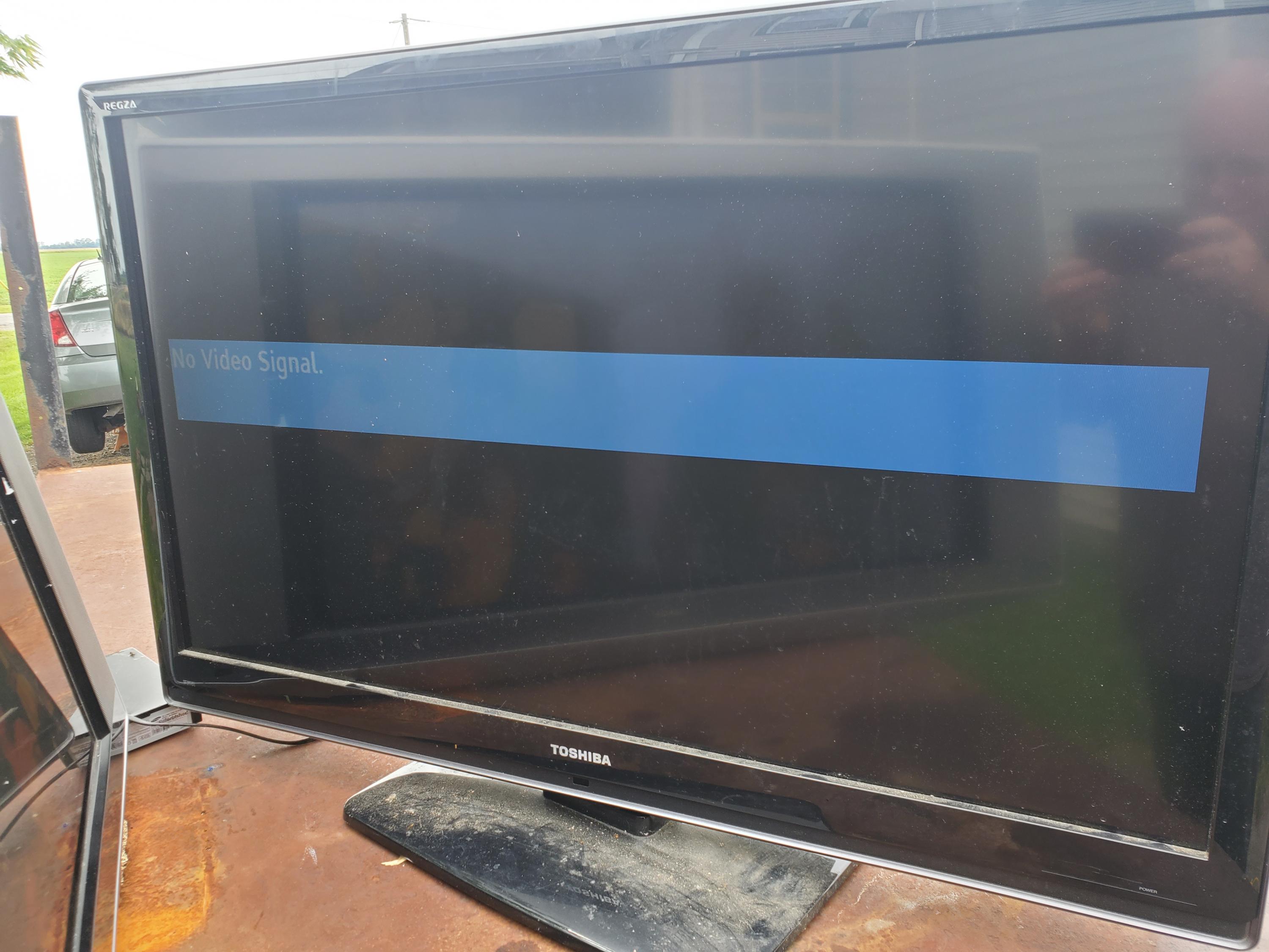

    So I pulled it out of the garage and put it on my test stand and upon plugging it in and powering on I experience what I take as a delayed start. Meaning when I pushed the power button it took a while to get any kind of screen. I am basically outside in this image as the garage door is opened and letting a lot of light in the garage...a lot of light...it was bright and sunny.
    As I am not familiar with the TV I left it be and after 5-10 seconds I saw this unusual screen (vertical lines etc).
    So I left it be ran and did some errands in town and returned to the second screen (normal). I was gone at least a hour and half.

    The unit was unplugged and it sat over night. I plugged it in today and I received the first screen (vertical lines) again. I did not get the delayed power on as I did before so I am thinking that may have been my mistake.
    I am currently letting it sit on as I did before but as of now there has not been a change...its been about 40 minutes...I will let you all know if it changes.
    Not much on BadCaps forum about this TV but I have read online there is commonly a problem with the cables attaching the panel screen to the TCON board.
    Any ideas of suggestions?

    Tab bonds is my guess. Grab and squeeze the bezel on top and bottom of the affected area. To fix it for a while, shim the affected tab bond.

      I need to open this thing up to get a better look at its interior...I have had it in "TEST" mode to see if I could recreate yesterdays experience today. I can not recreate after leaving the unit plugged in and on for almost 10 hours straight.
      I probably will not get back to this unit till either tomorrow or possibly mid next week unfortunately as my schedule has me traveling for work.
      I see online (Ebay etc) that this unit utilizes TCON Flex Cables.
      Is that what you are referring?
      Or are you thinking bonding tape...I am not sure if this unit utilizes bonding tape to the panel or not?

        It wouldn’t hurt to clean the tcon ribbon cables too. I was referring to the tab bonds directly on the lcd panel. Look at the tab bonds closely where they attach to the circuit board. My next guess is, some “washed” the LCD screen too hard and the water ran down.

          I will take a look at the TAB bonds, clean the TCON Cables, and let you know what I find.
