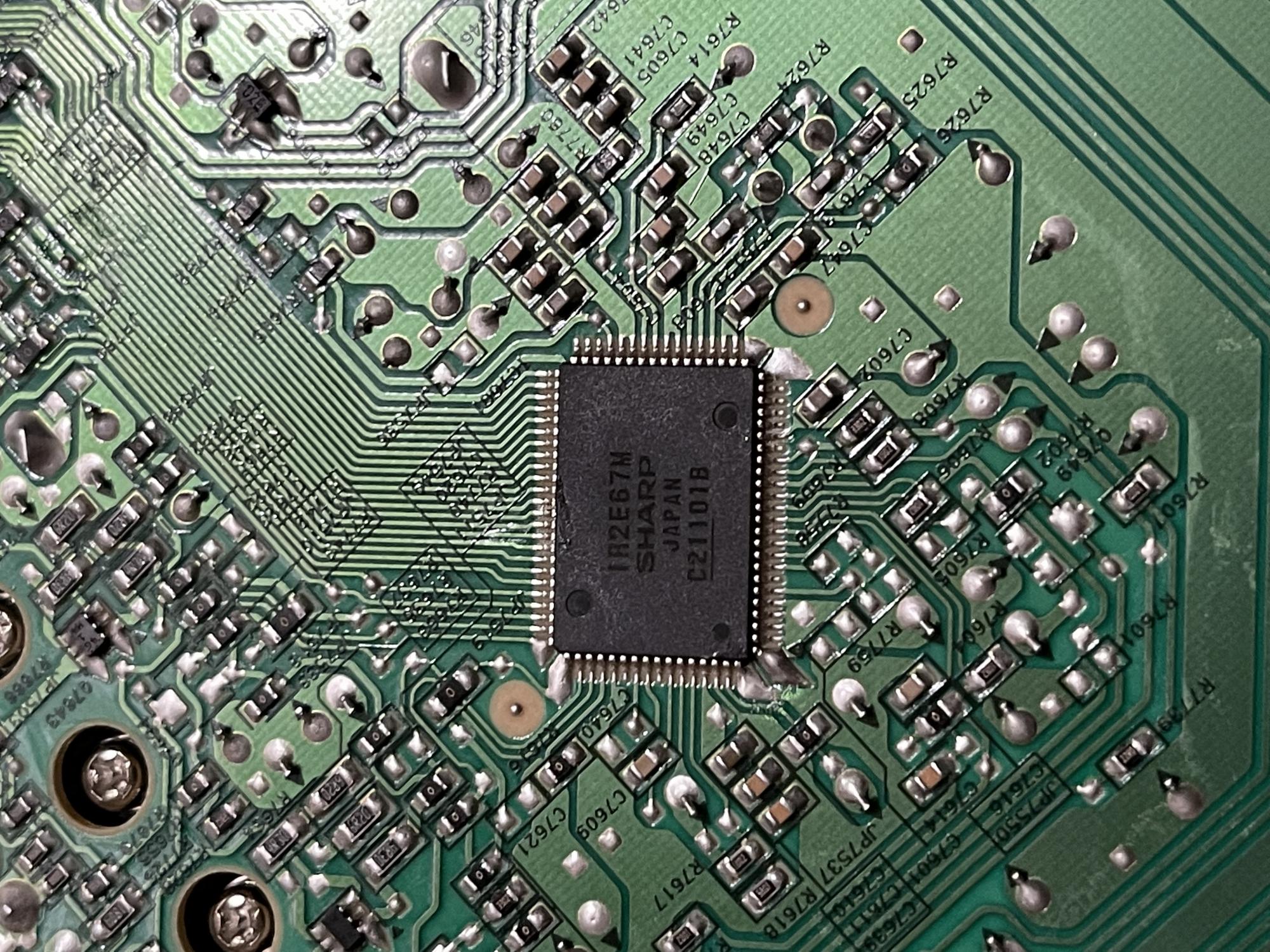

      Yup. Holding the input and volume down key longer does the same thing. It looks like going to boot and display the k but it shutdown after backlight flashed.
      Also took a pic of the ic underneath the power supply. Are you referring to this one?
        #43
        Re: Sharp LC-90LE745U 3 slow and 1 fast Blink
        I was thinking of the entire bottom of the Power Supply, but it's pretty much a dead end trying to find any meaningful information on that LED controller so the additional picture is not going to help much for now.
        Nice picture though with some really good detail.
