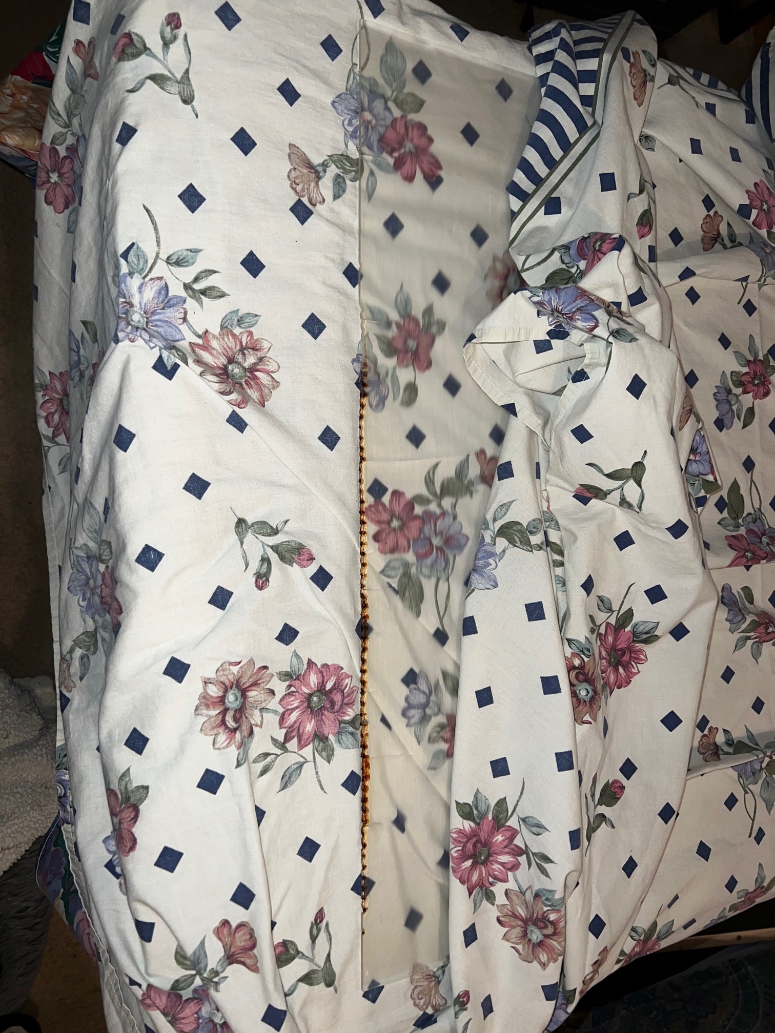

                #47

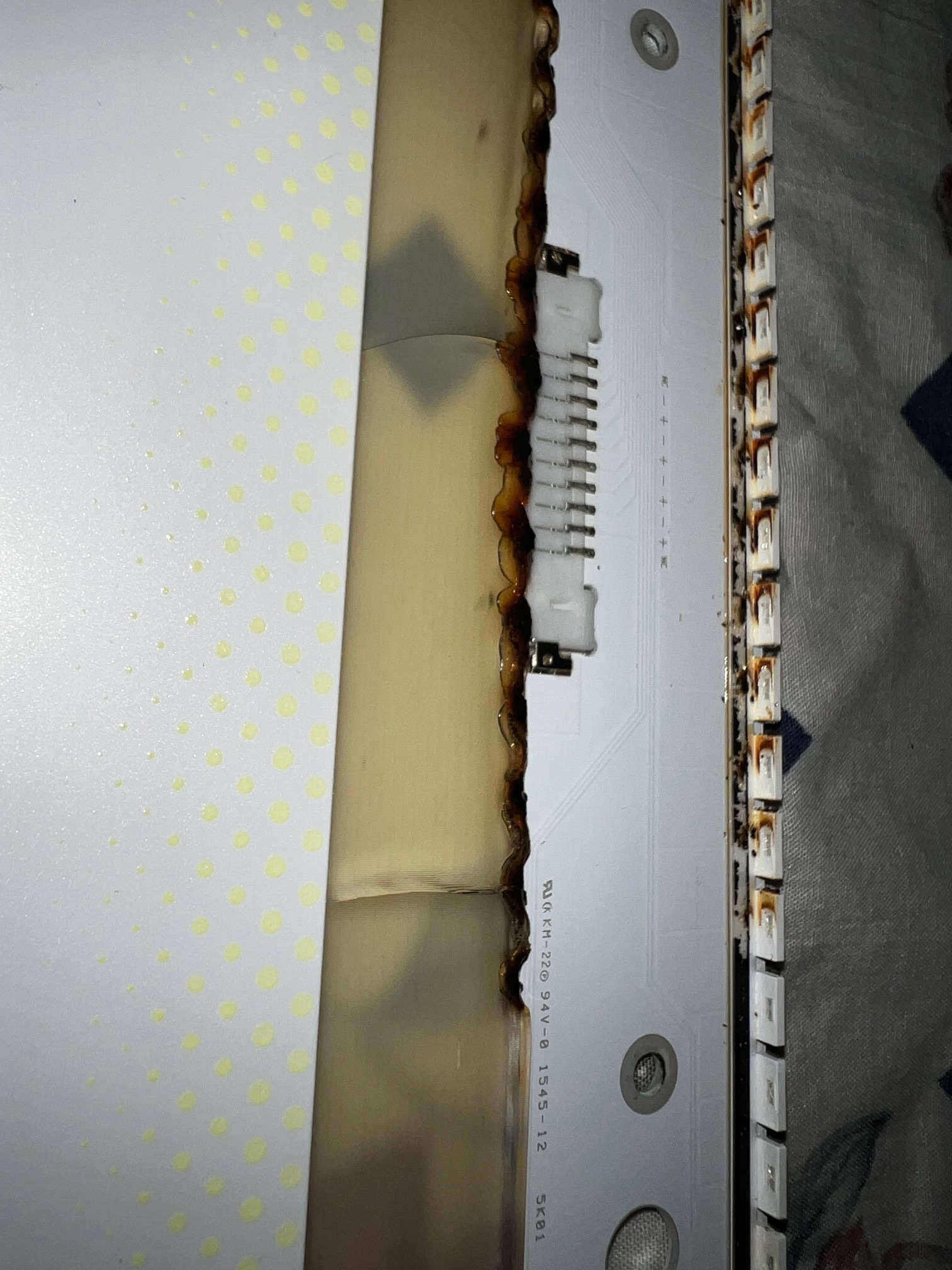

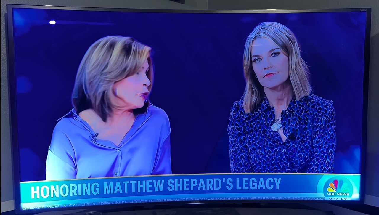

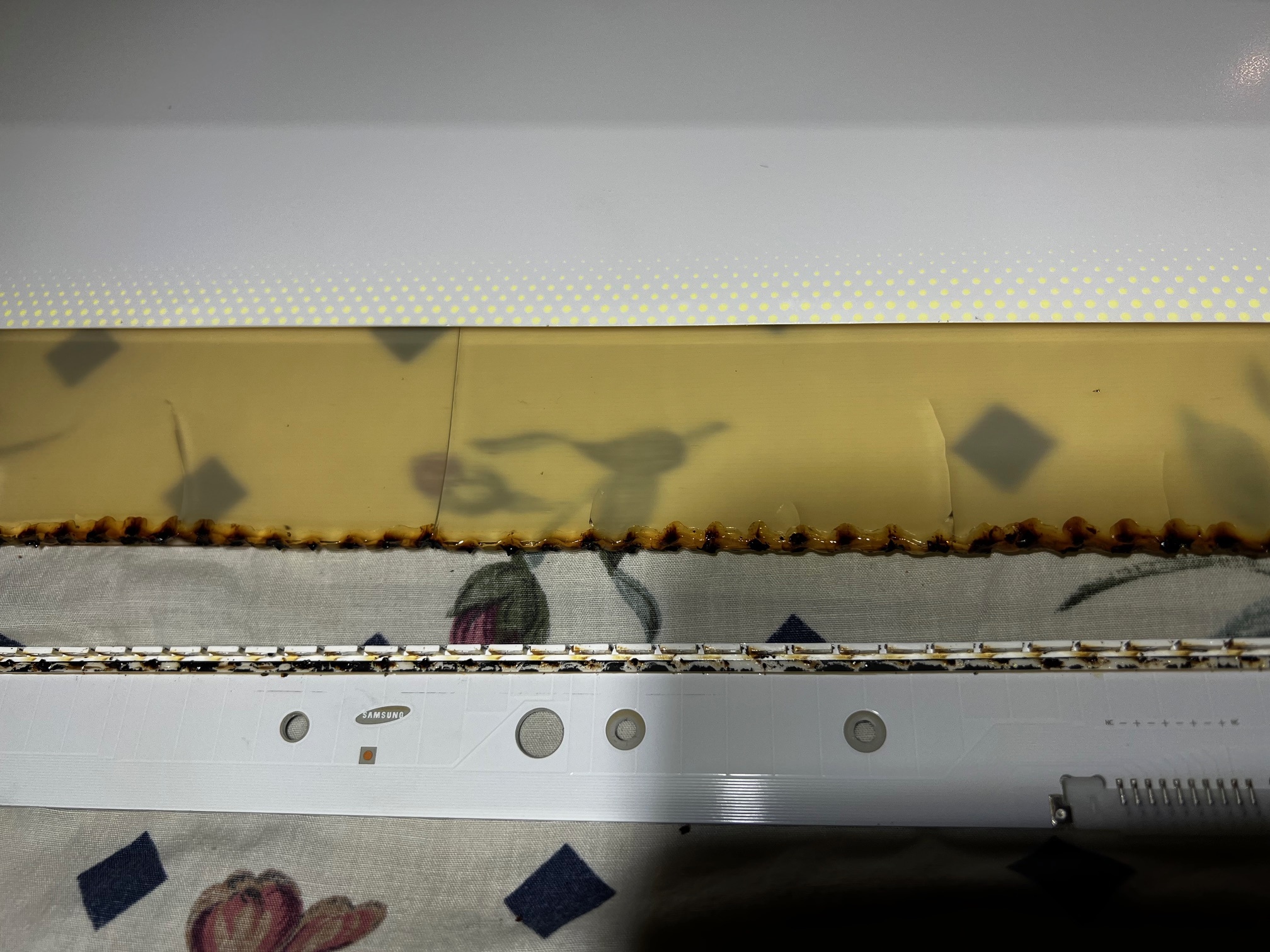

                I was a recent victim to the burnt Samsung backlight LED's and LGP melt down.
                TV Model is UN55JS9000
                I had started noticing some image degradation for quite some time but it wasn't until most recently where about 75-80% of the screen was really dim. This led me to start looking online and noticed this was a common issue with these and similar models of Samsung TV's.
                In the attached pictures you can see several examples showing bright spots on the TV, dark edges where the LED's had burnt out, and several pictures showing the burnt+cracked LGP along with the burnt LED strips.
                This TV model is edge lit so there is an LED strip along each side of the TV. Both sides were affected in the same manner but I have only posted pictures for one side.
                It's a shame the quality that Samsung delivered on these TV's and what's even worse is the technical support (or lack of) that they provide.

                  This one sucks in particular because it’s edgelit from the sides and really hard to come across another diffuser for this model. The bottom edgelit are much easier to source.

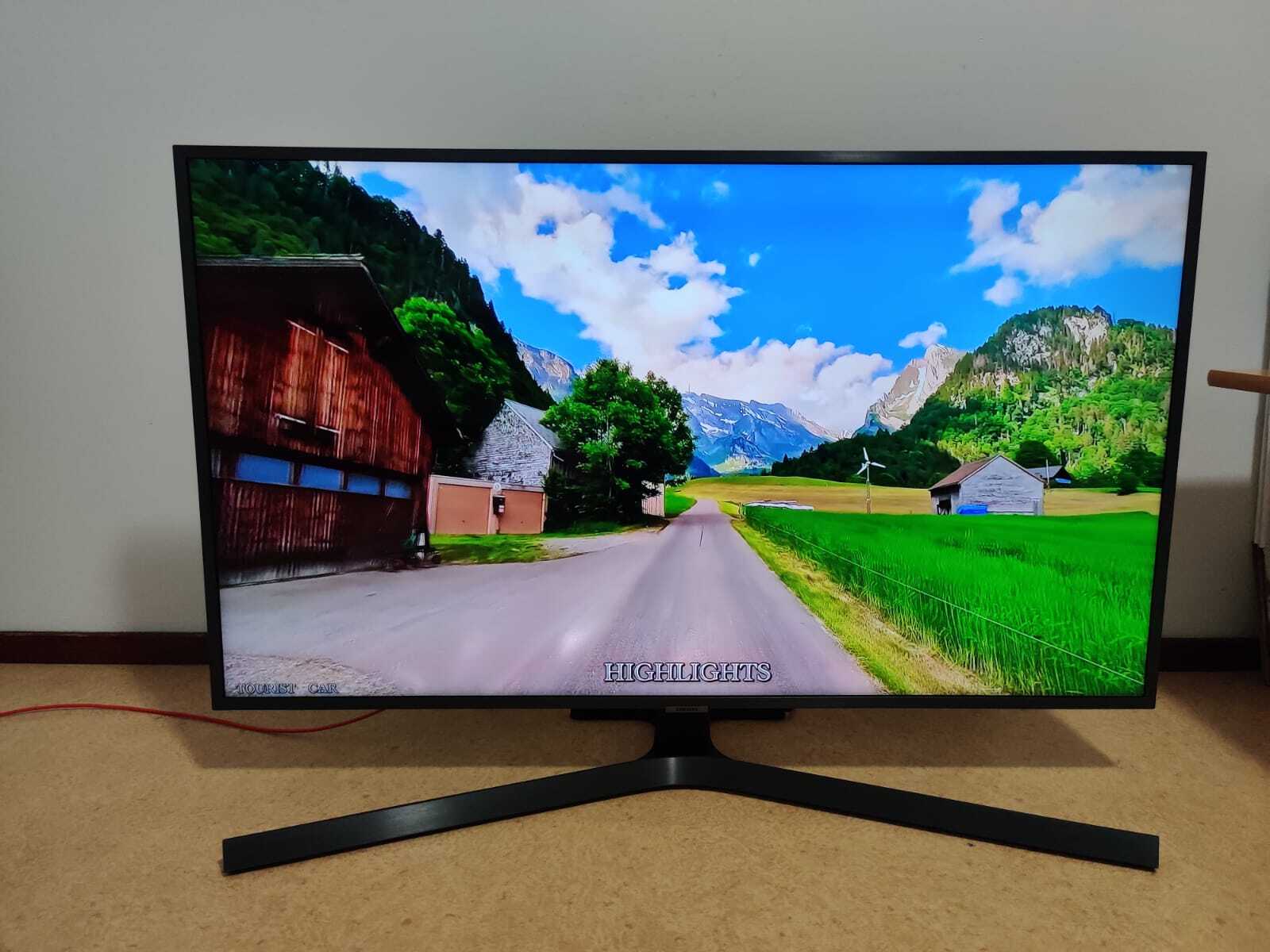

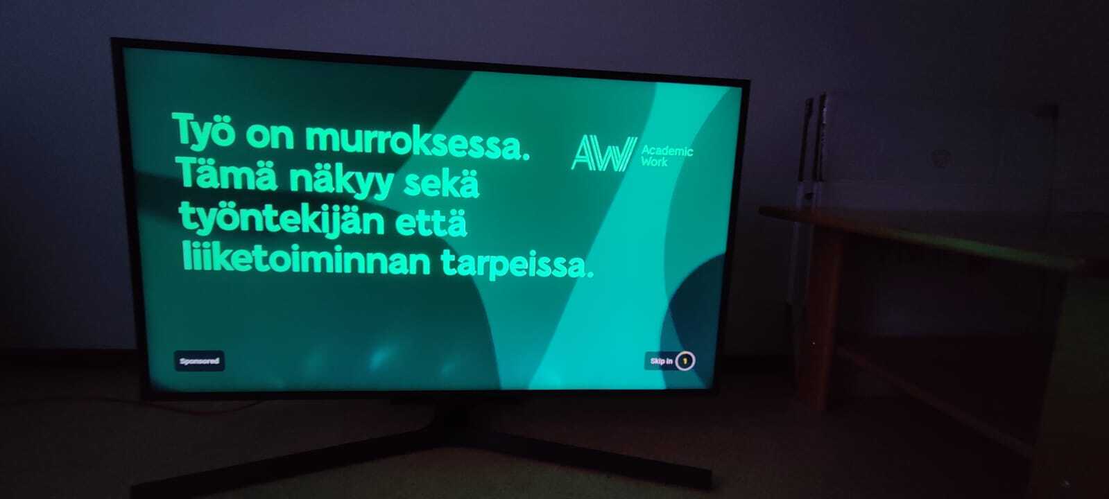

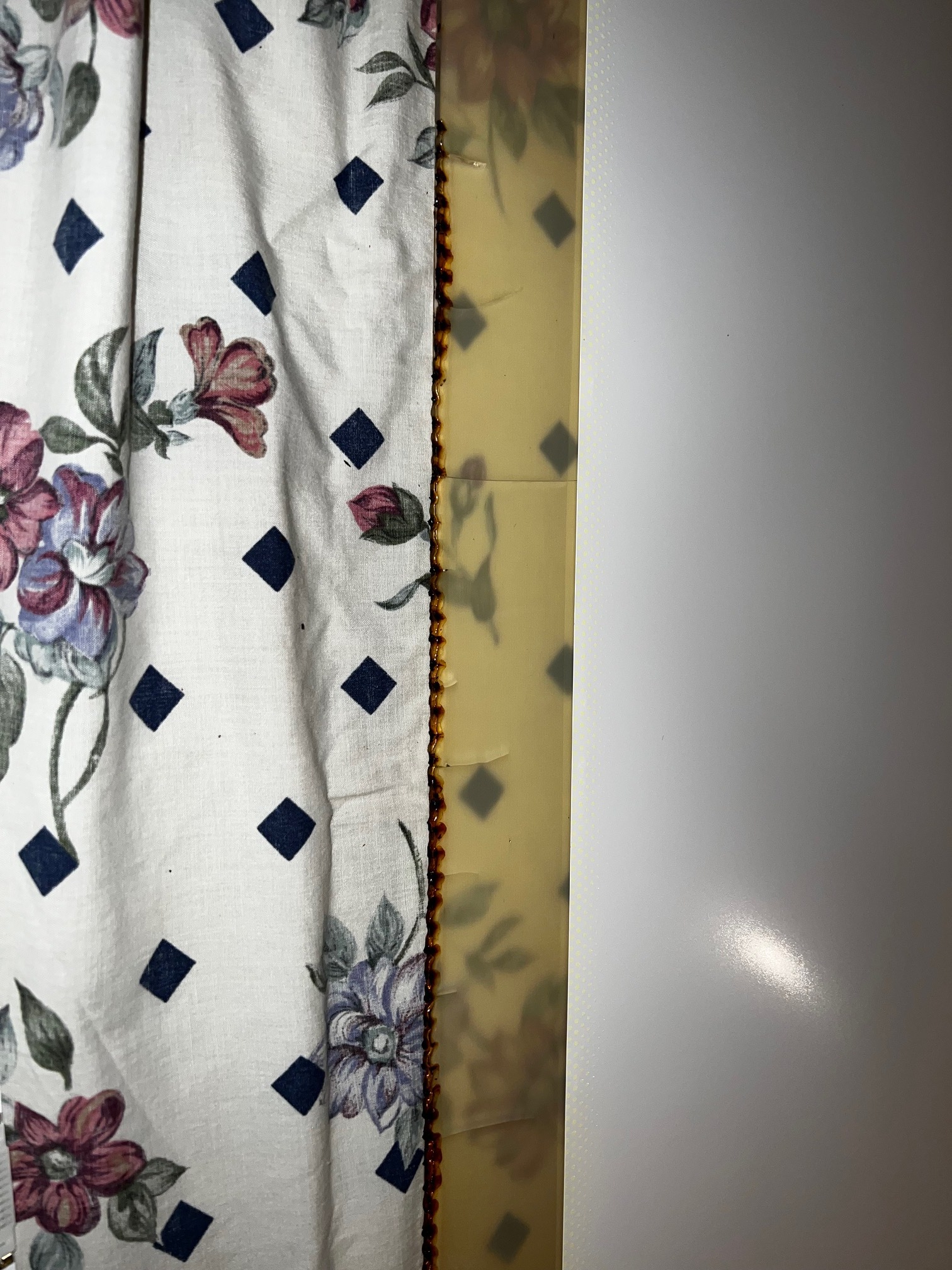

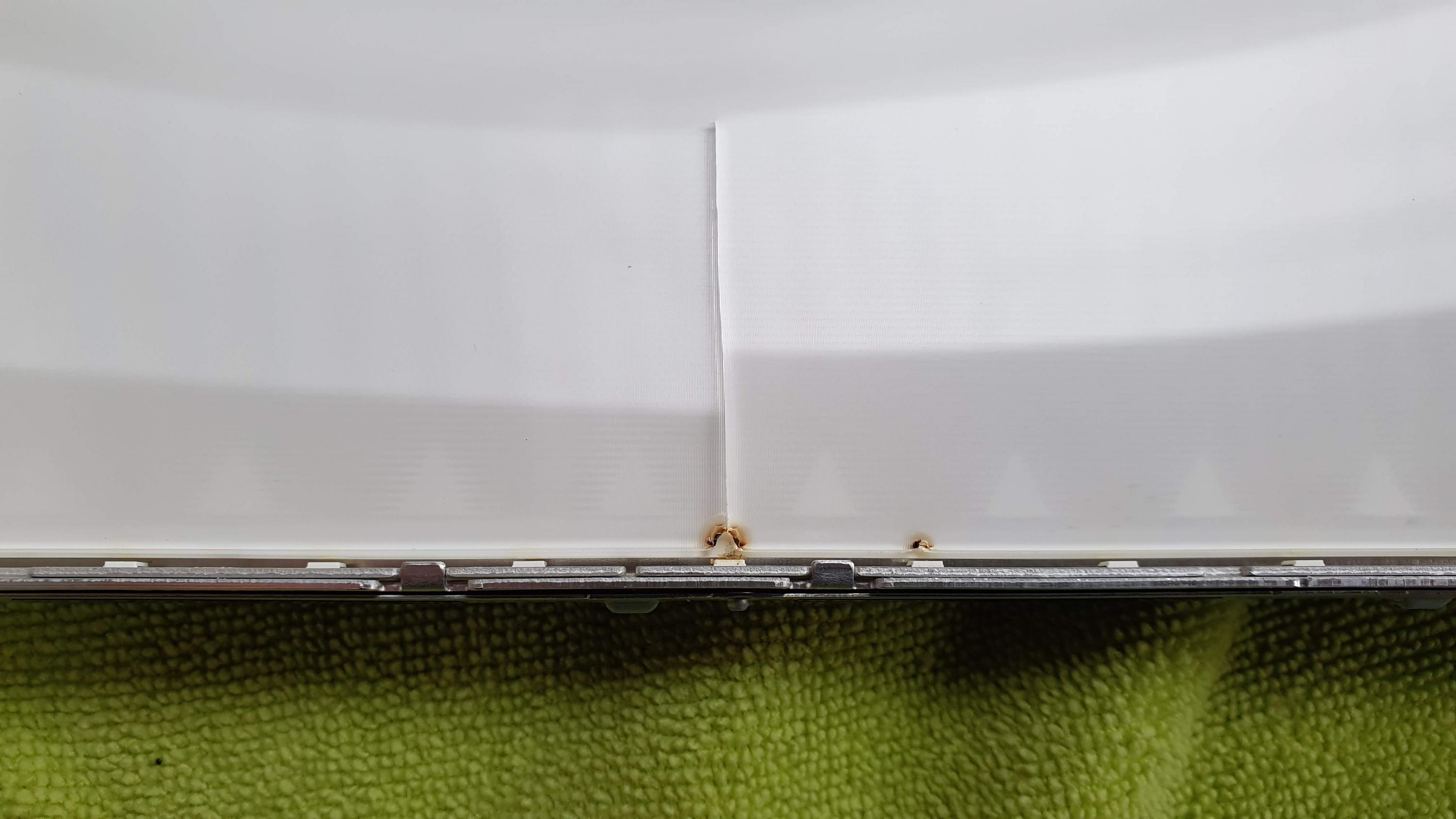

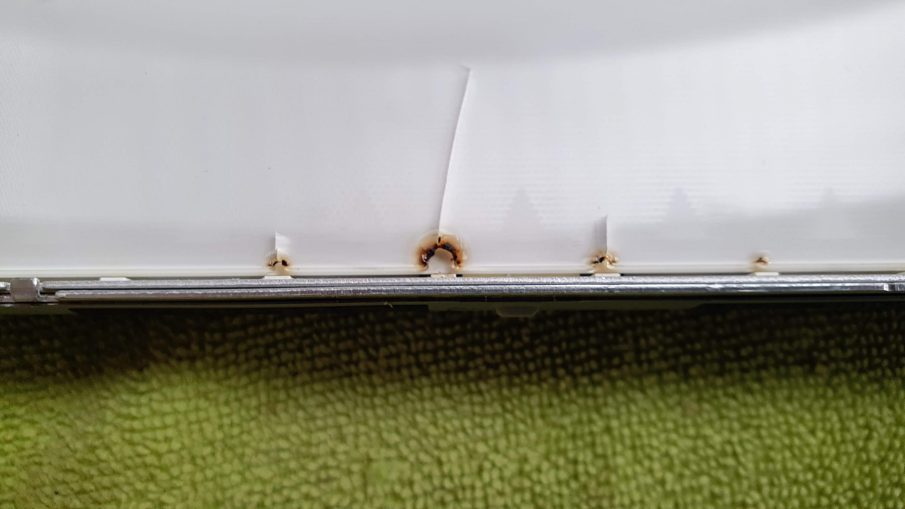

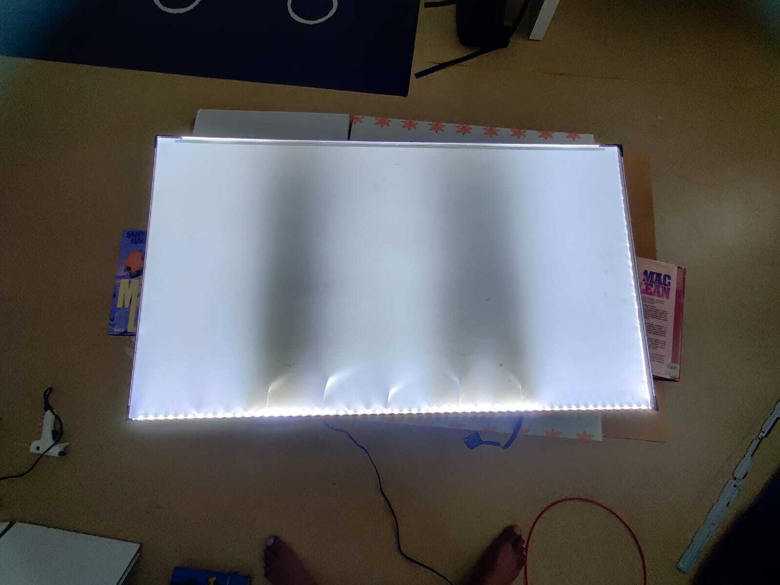

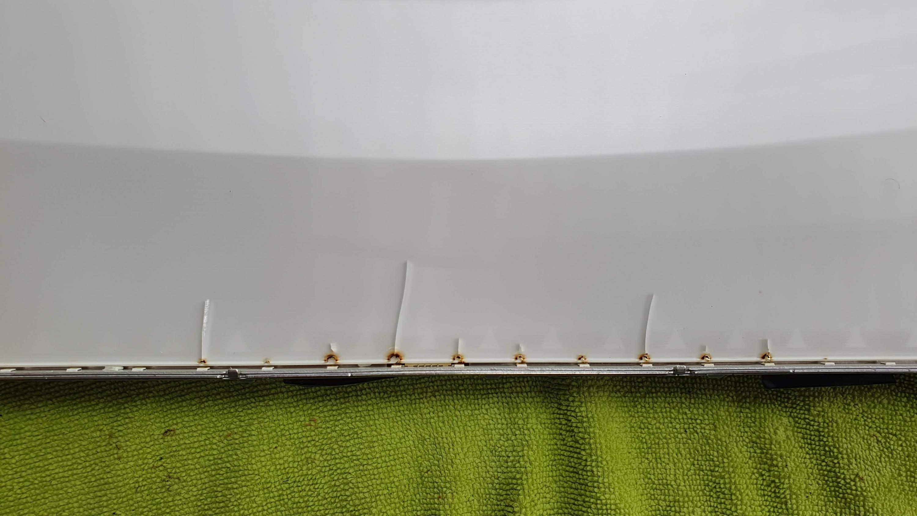

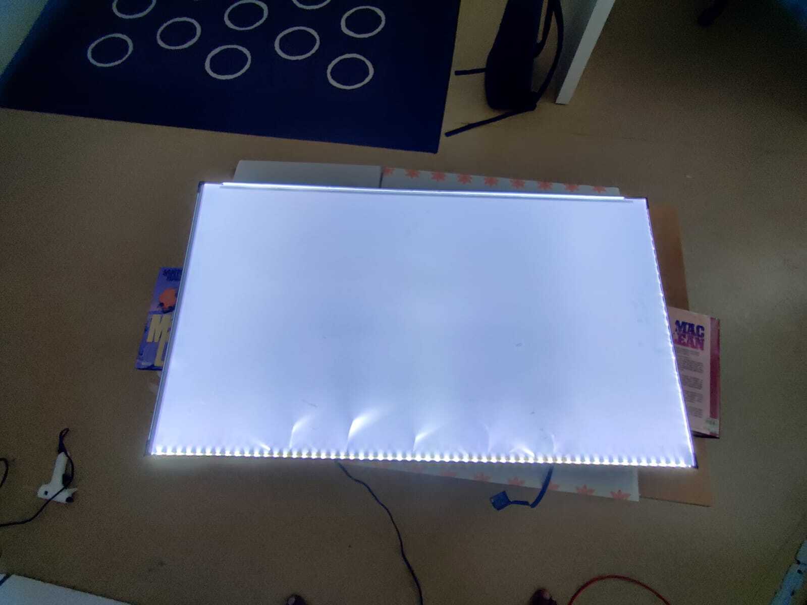

                    #49
                    Originally posted by Biruslapio
                    Re: Post your Samsung NU model series backlight failures and diffuser melt-downs here
                    This thread will never die, the crap that samsung made lives on burning and cracking diffusers forever.
                    I took a NU 55 inch for repair, but warned the owner that it would not come back 100% because the cost of a new diffuser here is absurd + the shipping for something that big, and no 55 NU or similar TVs with cracked screen for sale around here.
                    The cracks were already visible, half of the screen was dark, so one of the LED strips died.
                    Upon opening this hellish screwless design and having almost a heart attack to take the panel off without damaging it, I was met with a big meltdown on the left side(from the front) and some cracks on the acrylic.
                    I just replaced the leds and inverted the diffuser thinking it would produce a good picture, bad mistake since it was horrible, all bright on the bottom and very dark in middle to top.

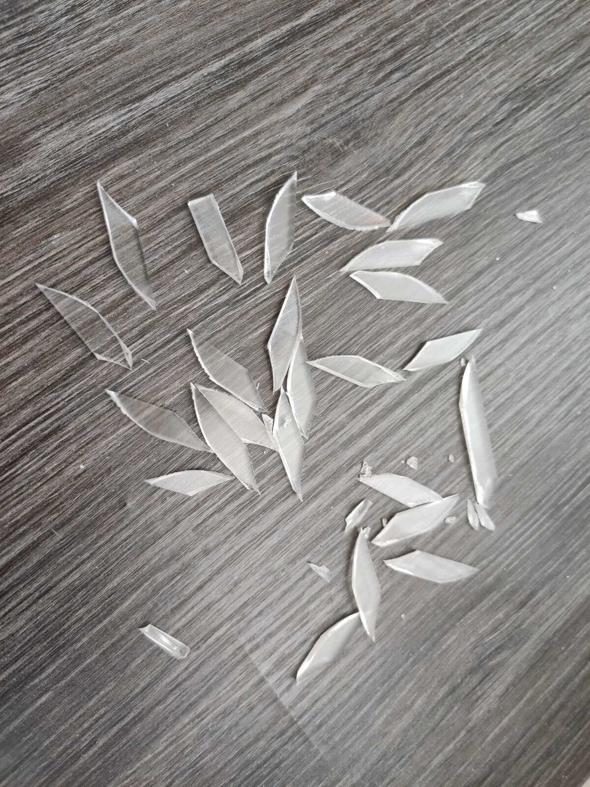

                    Dismantled the TV again and found out that sliding the diffuser to the non burnt bottom parts made it much better, so I took a plier and for 40 minutes painstankingly clipped around 1.2cm of the left side of the diffuser, that did it, only the small cracks were visible, but the lighting was very uniform, the LED strips at bottom of the TV heat up a lot.
                    I enabled energy saving to low and kept backlight at 40 for all inputs, and told the owner to not raise it or it would happen again and be even worse to repair.
                    PS: the third picture is before clipping, and the last is the final result.
                    Thank you for this suggestion. this is by far the best solution i found.
                    Also this is my first TV repair. I have attached before and after pictures. before removing nearly a 1cm from the right side, first I marked the line with a pencil and used a kitchen knife to mark the line "like a glass cutter". I did it several times in both sides and then using a plier to remove it piece by piece. you can see the removed parts in the picture. Before assembling I did shift the diffuser from left to right to find the sweet spot and use dot of hot glue in both the upper corner of the diffuser so it will stay in the right place.
                    I would say this is a good result as an amateur
                    Thank you!

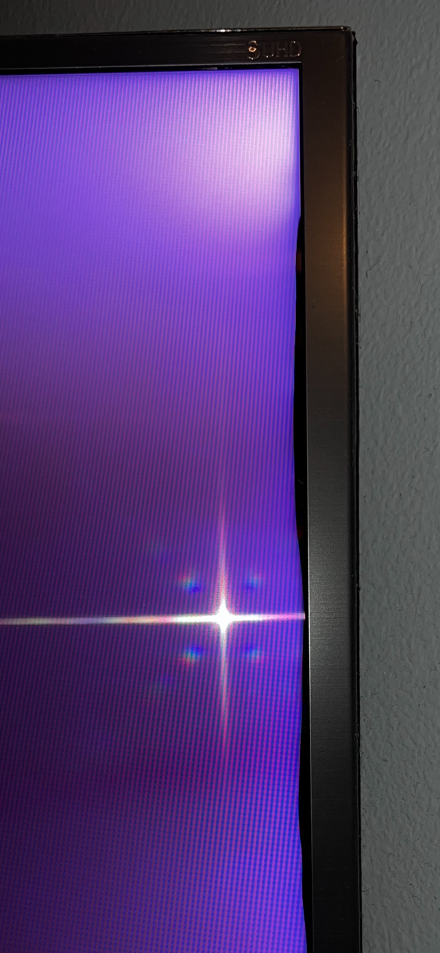

                      #50
                      Hey all!
                      just want a small advice. I recently had my backlight cooked, but managed to stop the tv in time before it could do any greater damage to my Samsung.
                      im going to order new led bars for it, but when I disassembled the tv I either caused a crack or it was there before in the diffuser lpg. Do you think the diffuser will still work, or does it need to be replaced?
                      the crack is about 5cm line in the center of the plate.
                      thanks!
