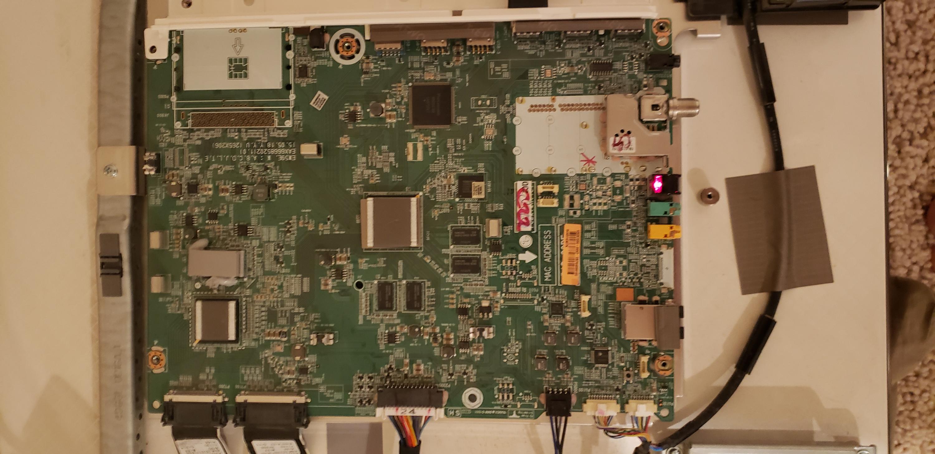

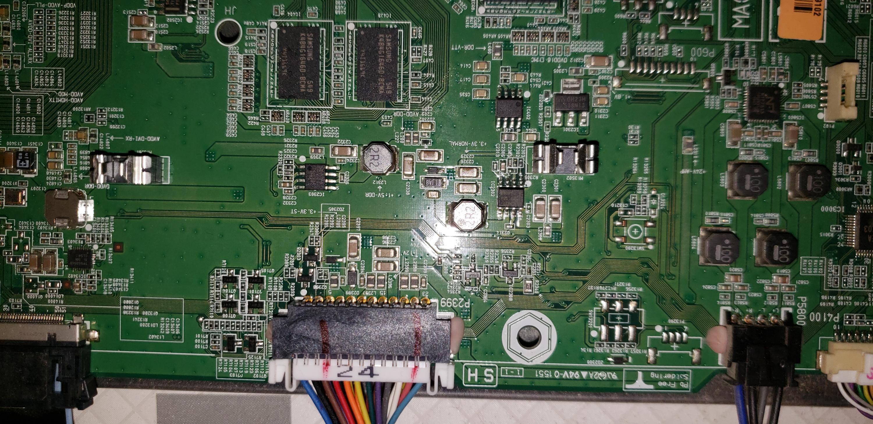

      Re: LG OLED 65EG9600 no picture
      Originally posted by Diah
      if you read all your posts starting from first one you stated 24V, and when it stand alone 24V too. and now as last test you write 22V.
      I think the difference is IN_STOP mode.
      When NOT in IN_STOP mode (initial testing):
      - get power, red light on optical out, sound (tv input static noise), and 24v on P203.
      - Also get 24v on P203 when in standalone (3-jumpered config - no main board connected).
      - Can get back to this state by issuing P_ONLY, exit, Power, and then turning the TV on.
      When in IN_STOP mode:
      - get power, red light on optical out, no sound, and 22v on P203.
      - Also get 22v on P203 when 24v cable is disconnected from T-con.
      - Also get 22v on P203 when DRV_ON jumpered to 3.5V (rest of signals on P201 cable are connected via the normal cable connections to main board).
      - NOTED, get 24v on P203 when in standalone (3-jumpered config - no main board connected, so IN_STOP mode not relevant here, but going back to non-jumpered config returns to 22v)
      put every things in place as original. dont send any instop or p only. just plug in wall and show me your mainboards to see howmany red led turning on
      Whether in IN_STOP mode or not in IN_STOP mode, there is only the 1 red light on the main board coming from the optical out.

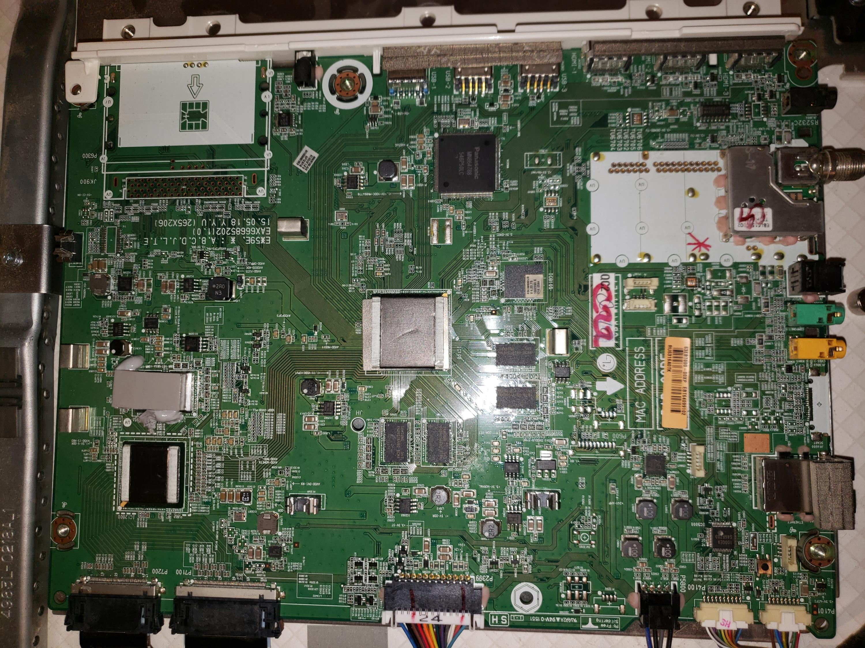

            IN_STOP will need about 40 seconds not sure if you were giving to the set enough time for booting.
            Yes, it did take a while for the optical out LED to turn on. I waited some time after that. Still no picture.
            yours mainboards should have another 2 small red LED to turn on one for LVDS signal and other at the middle left side.
            I did not see any other LEDs near the LVDS cables or in the middle of the left side of the board. Can you point them out? I tried to take a better pic of the main board, I will attach it here.
            we can focus on the last things you did before 6 months
            I literally set the TV down in my garage, plugged it in, turned it on, saw the screen turn on with 1/2 screen distortion, watched it for ~30 seconds, turned it off, unplugged the TV.
            Then it sat there for 6 months.
            Then I picked it up, carried it into my house, set it down, turned it on...no picture.
            You should have 2 micro switch for reset... try pressing the one you have long press 10 second
            I only have SWI3000, my board does not have SWI3200.
            I held SWI3000 (I tried this in both IN_STOP and normal modes), heard relay click off, wait 10s, release SWI3000, set turns back on. No change (still no picture).
            contact the OP to have his mainboards and t-con
            Yes, let me know if you think we've done all we can to troubleshoot and if so, I will try to buy those boards from OP.
            Thanks again for your help!

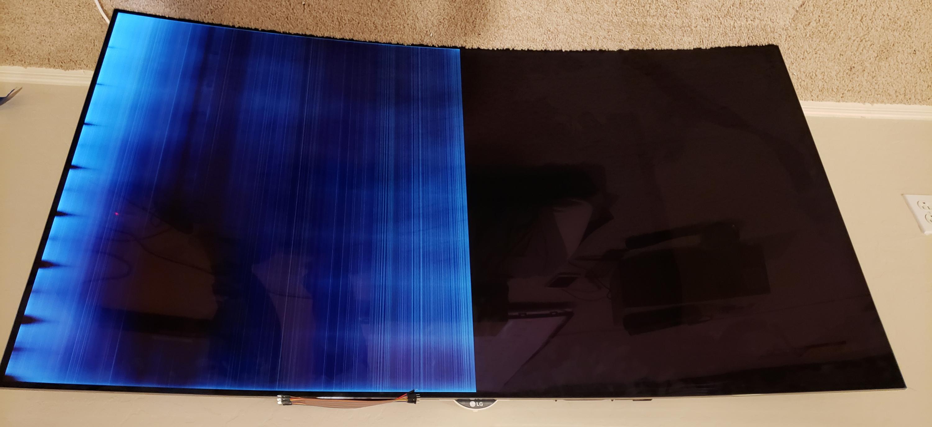

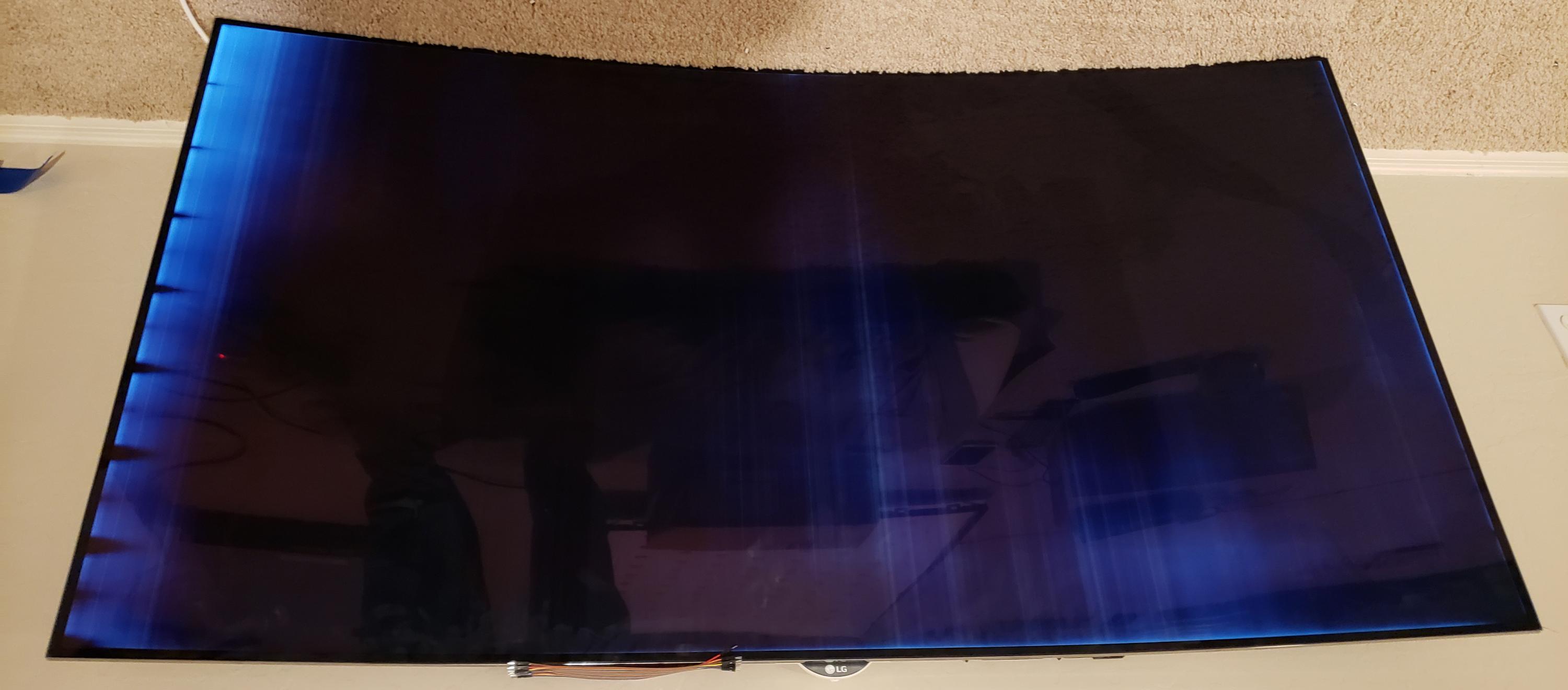

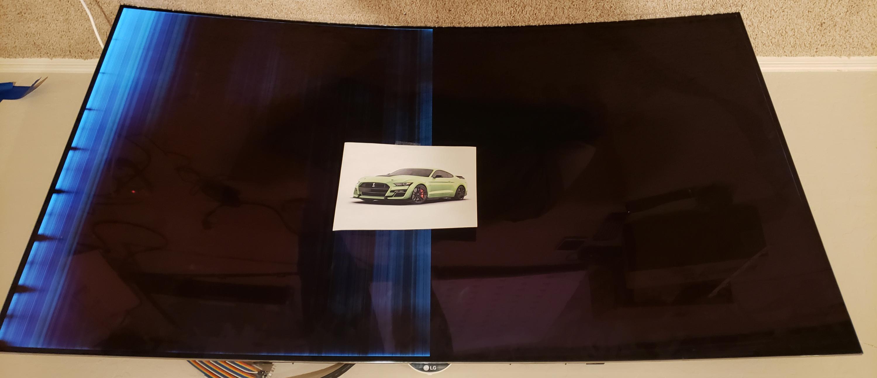

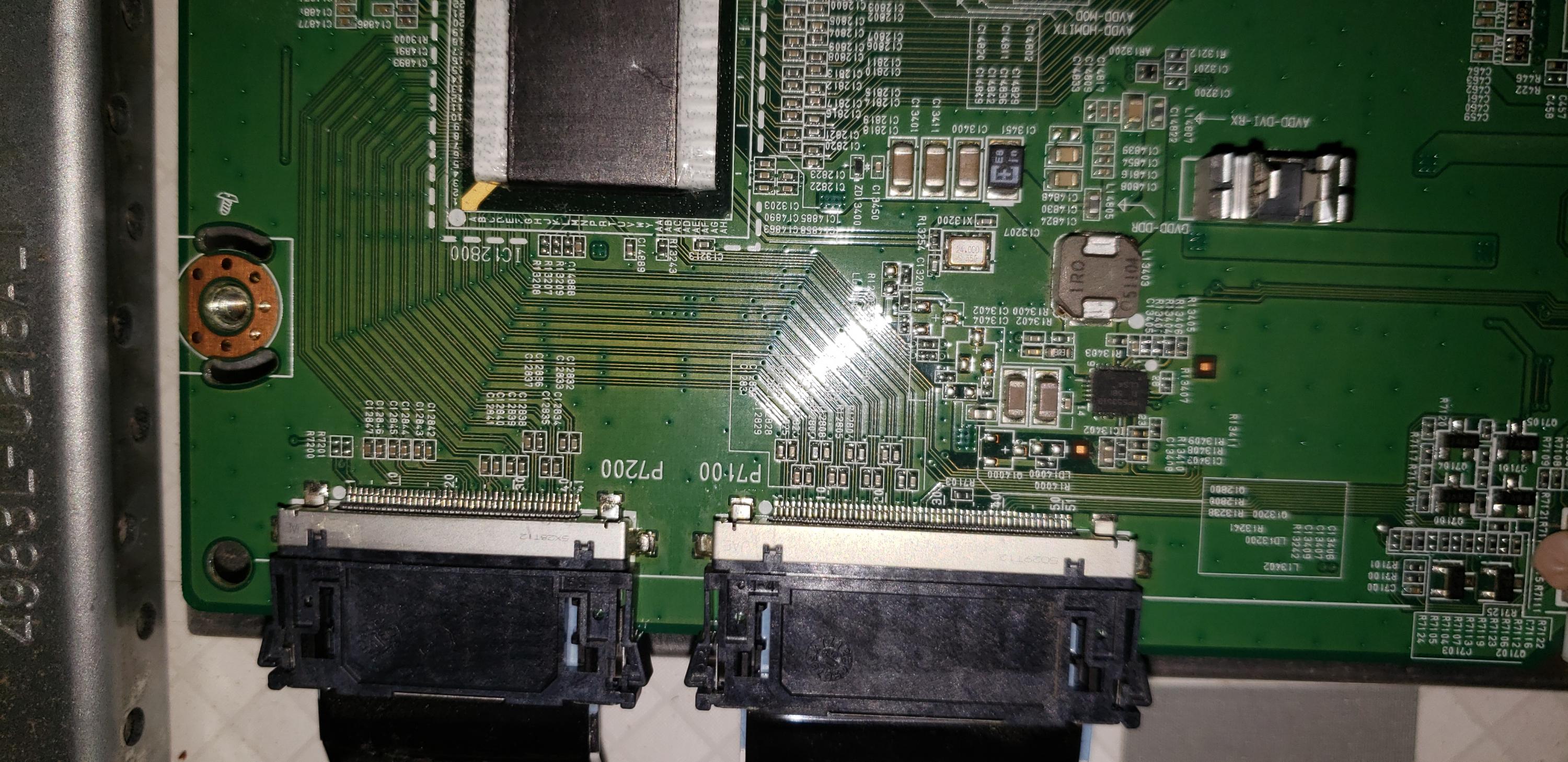

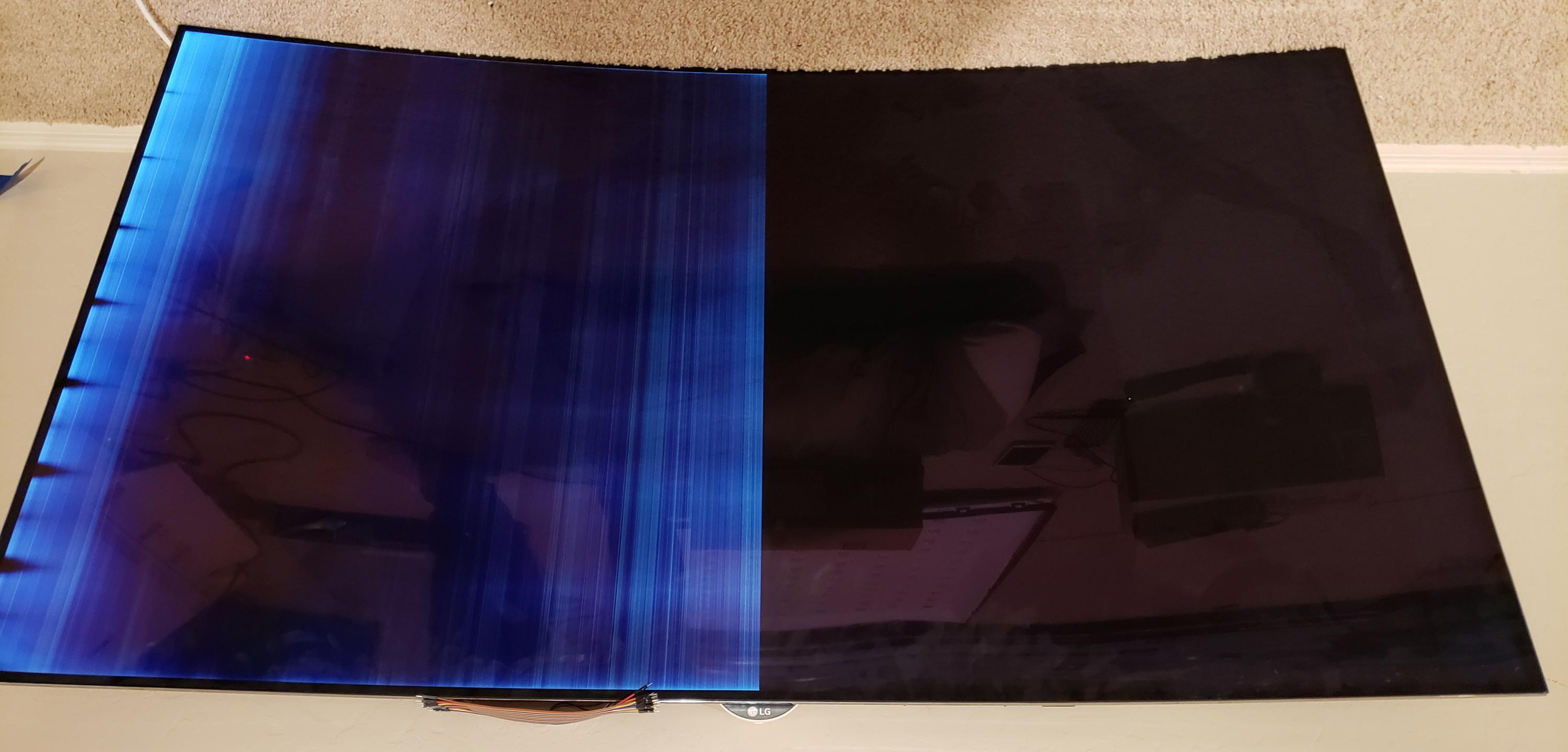

                • Daveleone
                  • Apr 2016
                  • 267

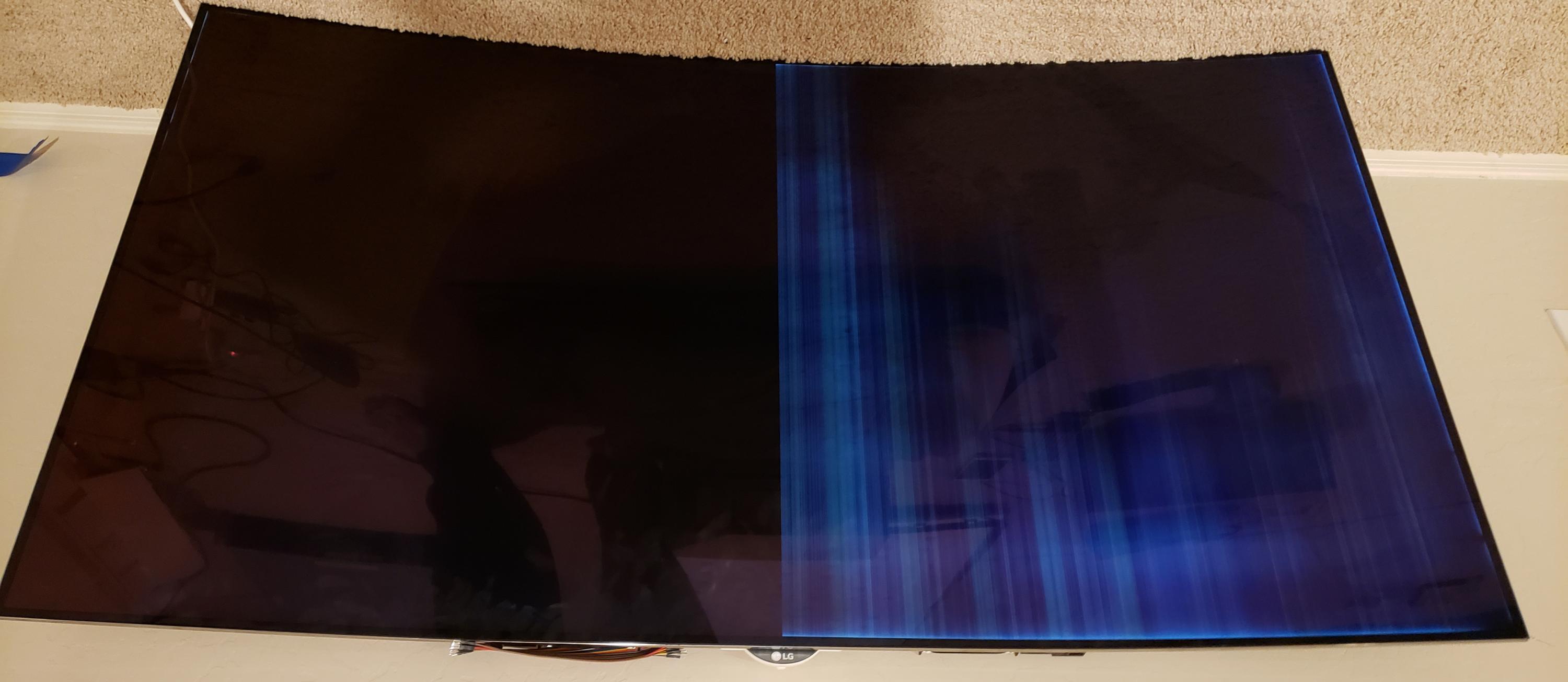

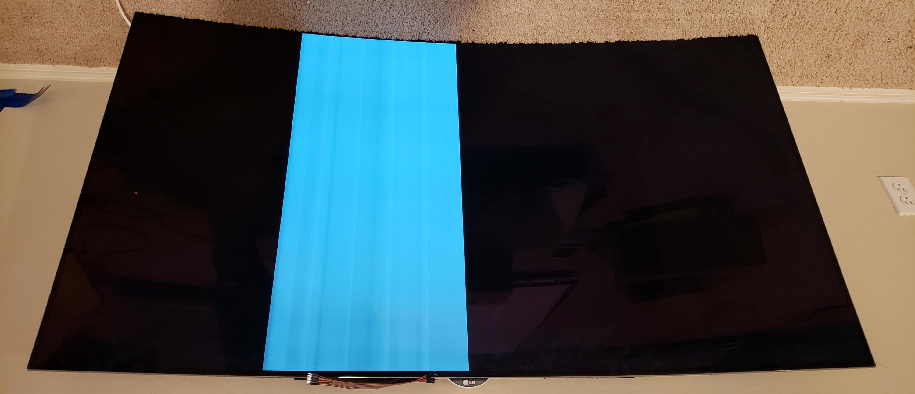

                  micro led will be remarked with LD
                  Ok, I did find a label for LDI3200 near the LVDS cables. Is that it? If you look at the closeup photo of the LVDS connectors in post #25, you will see a box printed on the PCB to the right of the right LVDS cable that shows LDI3200 in it. If you follow the area that box points to, you will notice ... there is no LED in that location LOL Seems like I have a cheap model main board
                  test stand alone so this time you run the stand alone test but with disconnect the 2 ribbon cable of the 1/2 screen with distortion let see if the panel show any things
                  Ok, I tried this and I did get some illumination on the screen (btw, the red dot you see in the pictures is not coming from the screen. It is a reflection from my power strip). The photos are named to indicate which ribbon cables were connected at the time the photo was taken.
                  example:
                  [BACK OF TV]
                  Ribbon1 Ribbon2 Ribbon3 Ribbon4
                  ON OFF ON ON
                  Also, as a test, I disconnected Ribbon1 (the left-most ribbon when looking at the back of the TV) and powered on the TV. Relay clicked, and for a brief moment the screen glowed. Then the relay clicked off. I didn't run any more tests like this because I didn't want to risk sending the main board into protect mode.
                    did you did this while the mainboards connected?????
                    • Diah
                      • Feb 2013
                      • 6501
                      #30
                      any way. please never disconnect ribbon test while mainboards in place..
                      so with this crazy stand alone test the t-con wake up, but i think you didn't give enough time to let the t-con play another color pattern so remain to sky blue.
                      when yours t-con wake up keep working with stand alone test... but let all ribbon in place, hope you will upload photo with label ON_ON_ON_ON and your screen lighting complete LOL

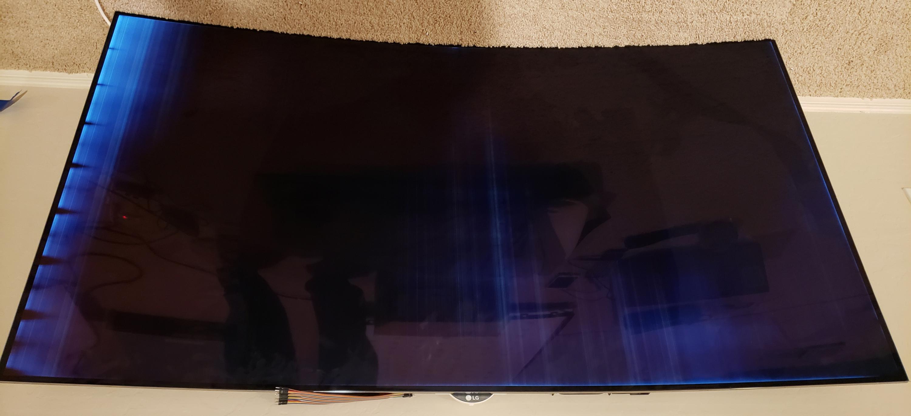

                      • Daveleone
                        • Apr 2016
                        • 267
                        #31
                        i think you didn't give enough time to let the t-con play another color pattern ... let all ribbon in place ON_ON_ON_ON
                        With all ribbon cables connected, in standalone configuration, plug in, I do see a quick flash of light for a moment and then the screen goes black.
                        With the other configurations, the image you see in the pictures stays on the screen.
                        I will try disconnecting Ribbon1 & Ribbon2 and leave the TV on for some time and will report back.

                              • Daveleone
                                • Apr 2016
                                • 267
                                #35
                                so only do this please as stand alone..... leave all ribbon in place and run the test.. if you got black screen ( T-CON back to sleep) however i dont think so... do one ribbon disconnect to wake it up... then turn off and put back the ribbon and run the test with all 4 ribbon in. ON ON ON ON lol
                                With Ribbon1 disconnected, I get the image I posted. Even if I leave it on for 5-10 minutes, I still get the same image (no color pattern).
                                If I power off, plug ribbon back in, power on. I get brief flash of light on the screen and then black, as before.
                                BTW, 24v and 12v read correctly at F1 and F3 the whole time.
                                You think it's bad panel? or bad t-con?
                                I am thinking it is NOT bad main board because main board power, optical LED, sound, and even network all work fine. Agree?
