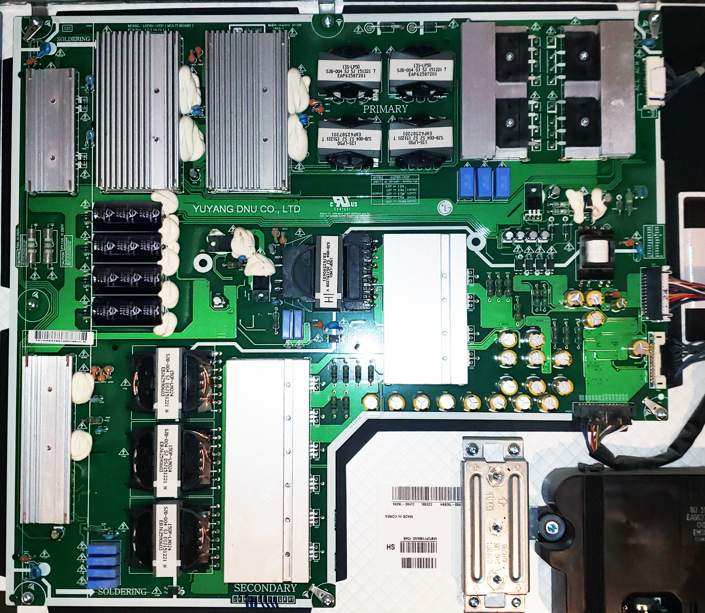

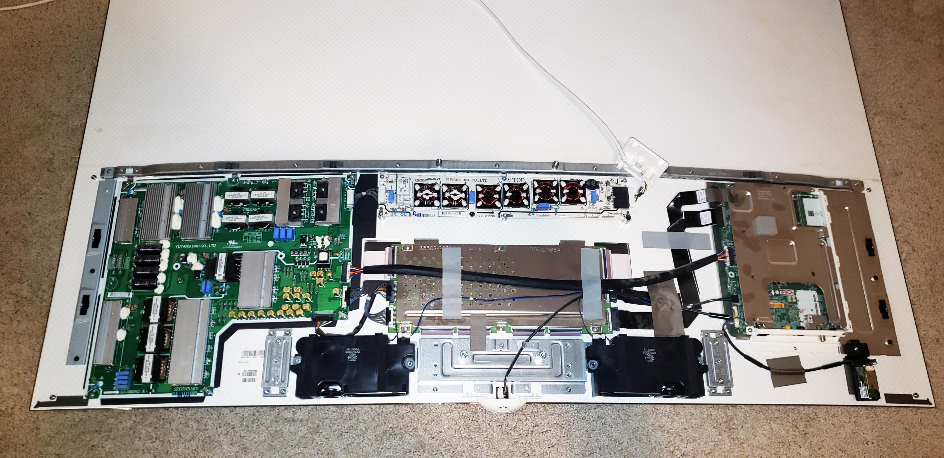

    Someone gave me a 65EG9600. When I received it, the set would power on and provide a picture, but on the right half of the screen approx every 1/2 second the picture would flicker with a horizontal distortion. I put the TV in my garage to work on when I had time, where it sat for about 6 months. I recently brought it inside to begin working on it, and now the TV will turn on, but no picture.
    I DO get:
    - red light on the optical output.
    - sound (static on TV input).
    - ethernet (plugged in a network cable and confirmed that the TV got DHCP from my router, and I could even successfully ping the TV's IP address).
    - correct voltages on P201, P202, P203 (see below), when the set is powered on, I think (not sure about ACD and DRV_ON?).

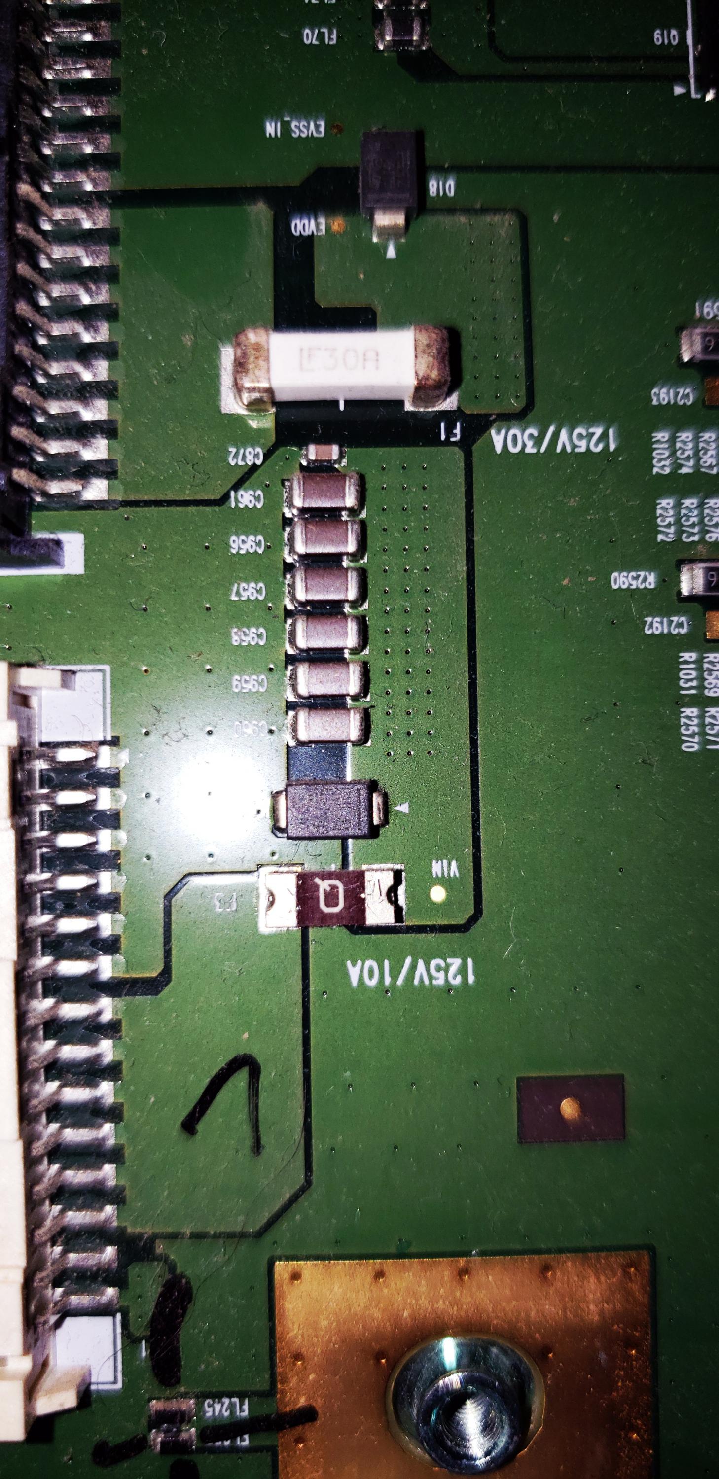

    - correct voltages on both sides of F1 (24v) & F3 (12v).
    And I hear the T-con making some noises when the TV is powered on. I would suspect T-Con failure based on half of the screen having a problem before, and based on the fact that all of the correct voltages exist and the main board sound, ethernet, power-on circuits all working properly. BUT, I've read several other posts on this site where people had similar half screen problems and the problem still ended up being the main board.
    1) Are ACD and DRV_ON voltages as expected?
    2) Is there an F2 I'm missing somewhere on the T-Con?

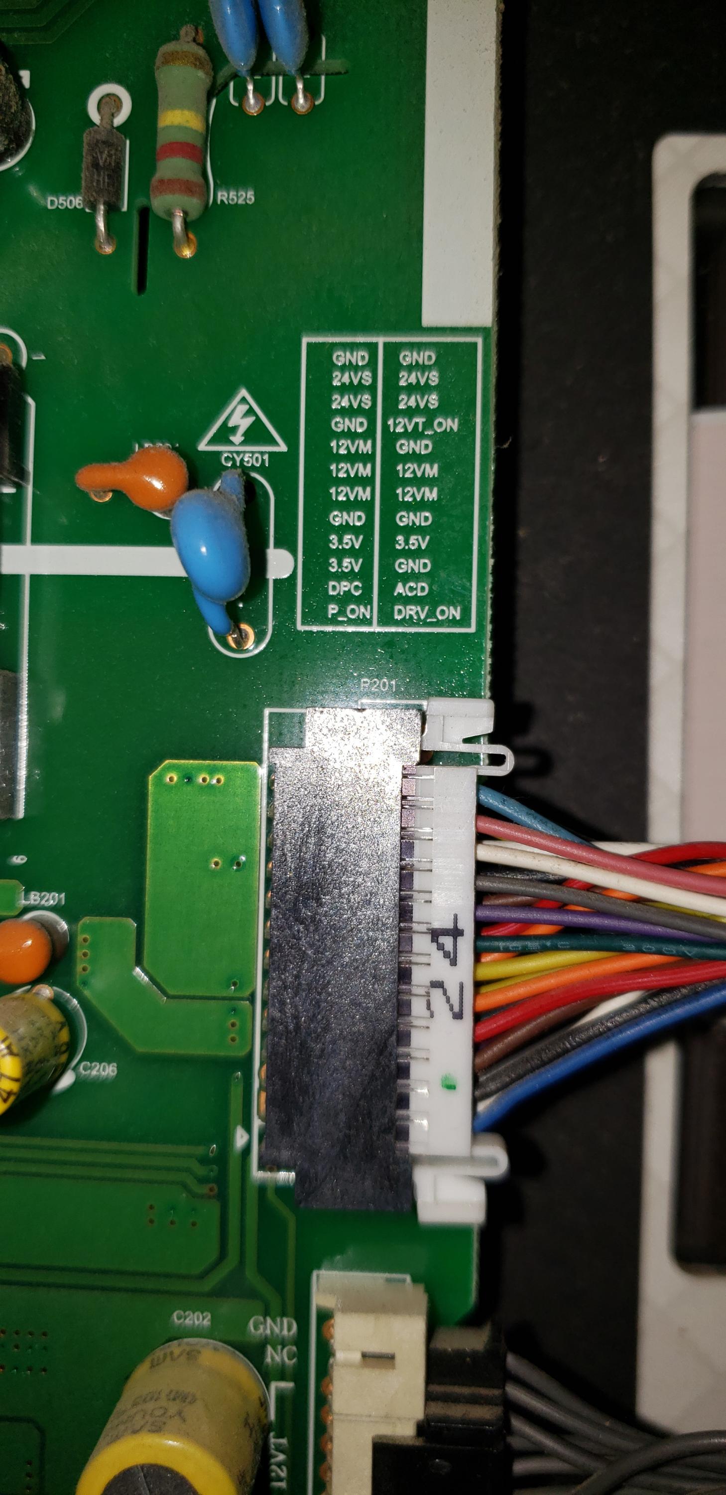

    Measurements
    P201
    GND 0 | GND 0
    24VS 24v | 24VS 24v
    24VS 24v | 24VS 24v
    GND 0 | 12VT_ON 3.5v
    12VM 12v | GND 0
    12VM 12v | 12VM 12v
    12VM 12v | 12VM 12v
    GND 0 | GND 0
    3.5V 3.5v | 3.5V 3.5v
    3.5V 3.5v | GND 0
    DPC 0 | ACD 3.3v
    P_ON 3.3v | DRV_ON 3.0v

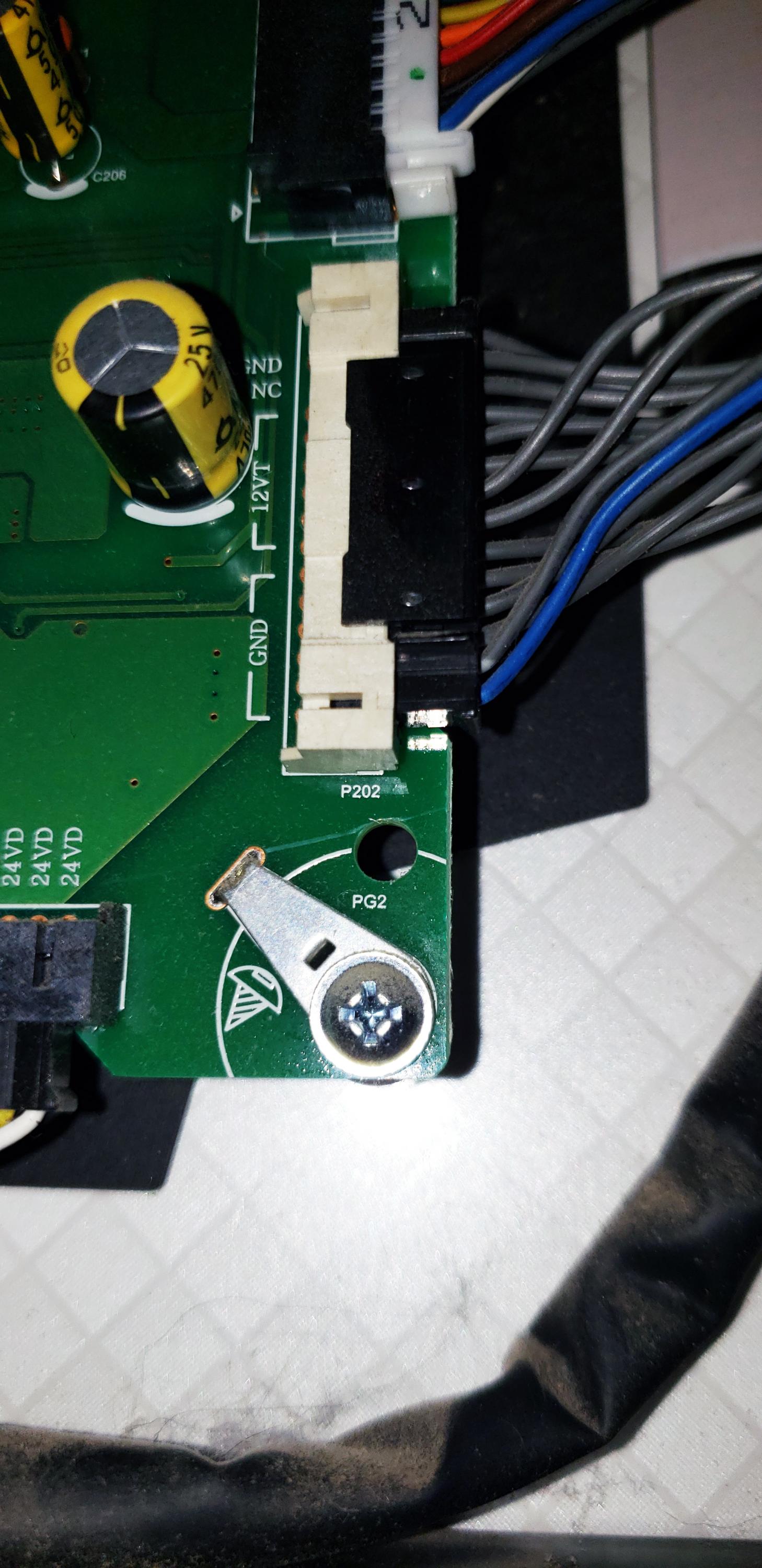

    P202
    1 (GND): 0
    2 (N/C): N/C
    3-8 (12VT): 12v
    9-14 (GND): 0

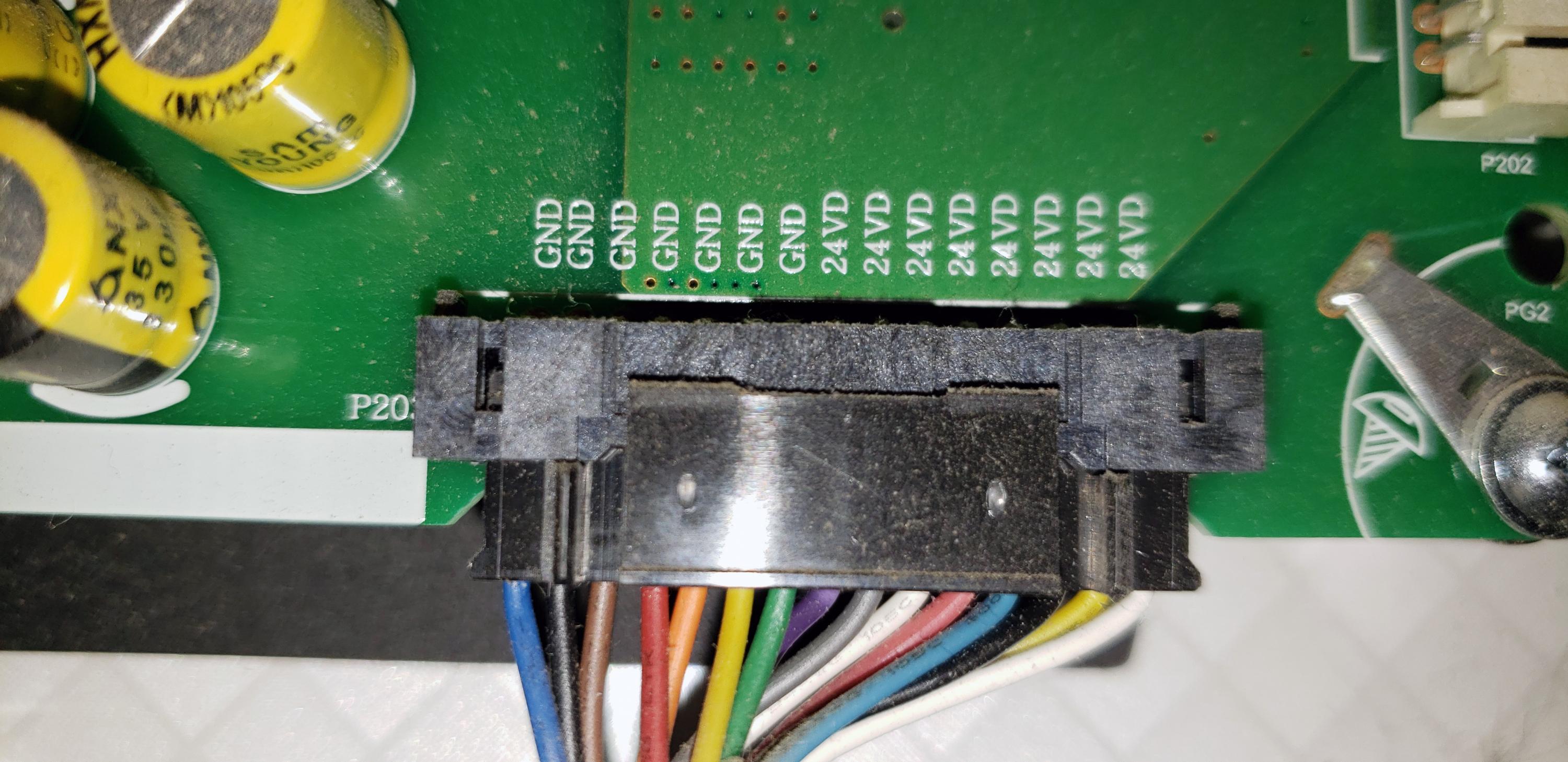

    P203
    1-7 (GND): 0
    8-15 (24VD): 24v
    F1: 24v
    F3: 12v

    Re: LG OLED 65EG9600 no picture
    all voltage are fine. yours mainboards fine too from yours description of the signs you have on it.
    do the following exactly one after other.
    1- disconnect the mainboards totally from powerboards ( plug out the socket 201 from mainboards side) and the 2 LVDS which goes to T-CON ( plug them from T-CON side )
    2- you have ribbon cable jumper connected at the T-CON from left to right side.. get it out and inspect the pins contact clean them and put it back )
    3- same way inspect & clean the 4 ribbon cable between T-CON and panel module
    4- on the socket 201 at the powerboards you need to make 3 jumpers ( testing the T-CON and panel module as stand alone) all three must remain in place at the test.
    A- 3.5V --- P_ON ( you will have at the same socket 12 & 24V )
    B- 3.5V --- 12VT_ON ( you will have 12V at P202 & T-CON 12V )
    C- 3.5V --- DRV_ON ( you will have 24V at P203 & T-CON 24V )
    plug the set in wall socket and watch what you will have on the screen show me over here.... give it time to remark any change could happened on the screen.

      1 & 4)
      - Disconnected main board from socket 201 on powerboard and both LVDS cables from T-CON.
      - Jumpered P_ON, 12VT_ON, and DRV_ON to 3.5V. Confirmed jumpers good using continuity test from pin to pin on the power board.
      - Plugged the TV in.
      - Heard relay click on.
      - Tested voltage and confirmed that there is 12v & 24v at P201, 12v at P202, and 24v at P203.
      - Still no picture. (and obviously, no sound, since the mainboard is disconnected)

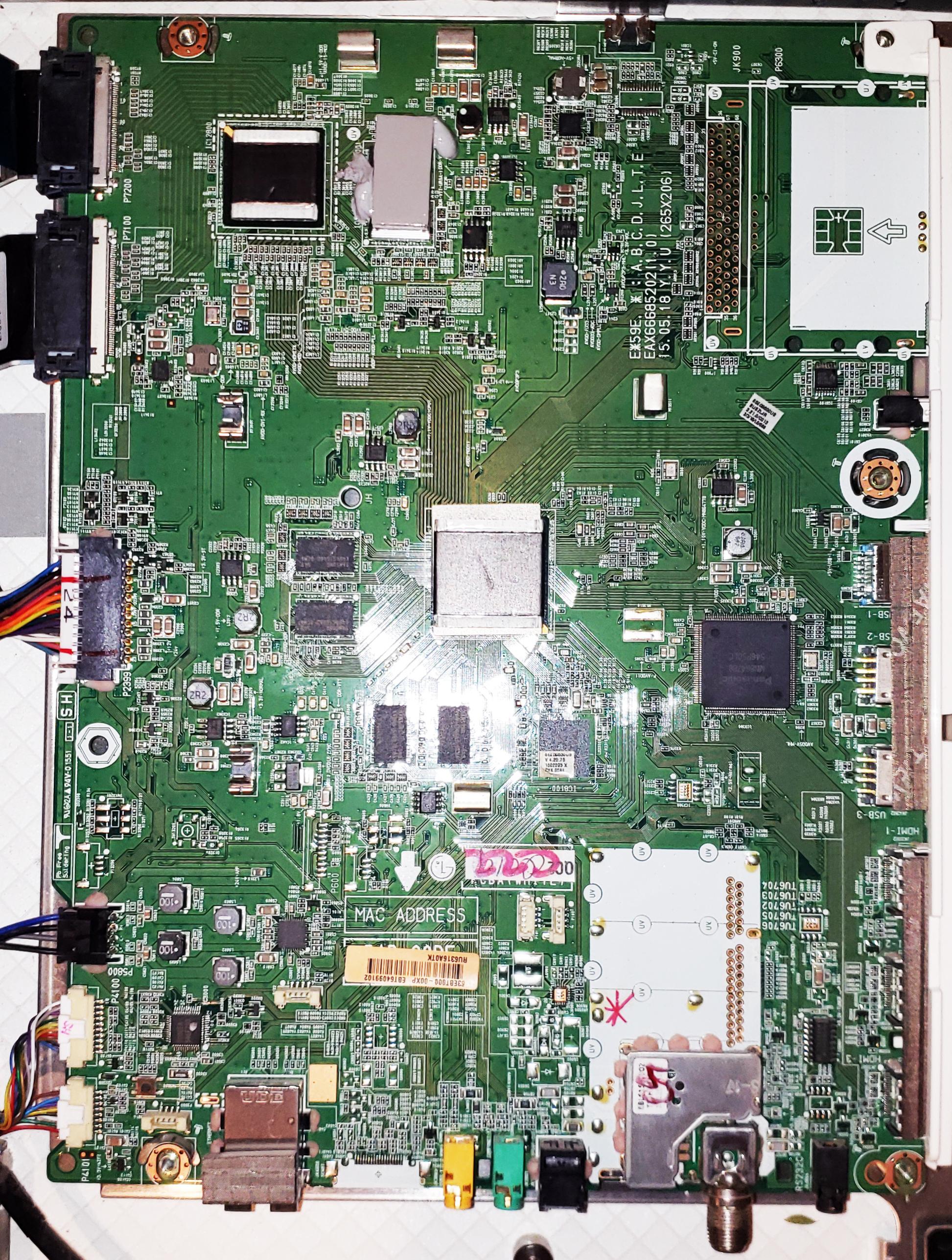

        yours T-CON at sleeping.. its firmware didn't start at all. so you need to wake it up via:
        1- we let the mainboards waked up the t-con up by after you bring all sockets and cable as original in place ( No more jumpers )
        a- insert air mouse or usb 2 mouse at any usb ports and another usb stick with media content suyh movie with mpeg format ( put all then turn on the set.. remove the mouse left and right or clicking the right ot left bottom of the mouse check the screen. if didn't waked up with this... try again once more if not. then do ( b )
        b- while the set on need to send IN_STOP command followed with 4 digital code 0 4 1 3 then set will go to stand by then plug it from wall socket leave it out from wall for more than 10 minutes then plug it in.. it should start with first install screen
        In_STOP can be send with LG Service remote control or diy one i did explain it at this threat and this threat too

                              - NOTED that we have 12v at F3, but only 22v at F1 (and at P203).

                              - NOTED that we once again have 12v at F3, and 24v at F1 (and at P203).

                                    NOTED that even though 24v is unplugged from T-Con, still showing 22v on P203. Is this expected?

                                    24V read as low 22V this tell us that the panel over loaded to drop the 24 to 22V
                                    If panel overload is pulling down 24v to 22v, then
                                    1) why do we still get 22v on P203 when not connected to T-con (& panel)?
                                    2) why do we get 24v when main board is not connected (panel+tcon test) but 22v when main board is connected? Maybe T-con is still not waking up in the panel+tcon test?
                                    Anything else to try?

                                      remember at yours first post you wrote that DRV_ON= 3.0V but when we do stand alone test after feeding DRV_ON 3.5V it turn to be 24V. this why we can now trick it in this way..
                                      after you send INSTOP, and plug the set out from wall socket and waiting time of 10 minutes then
                                      slide out the cable of DRV_ON which come from mainboards on the powerboards sockets P201
                                      make ONE jumper Only between 3.5V and DRV_ON ( so the 24V will go high after you plug the set back to wall and turn it on with RC normal power incase it didn't start after plugging it back to wall
                                      your eyes always on the screen to remark any change
                                      • Daveleone
                                        • Apr 2016
                                        • 267
                                        Originally posted by Diah
                                        slide out the cable of DRV_ON which come from mainboards on the powerboards sockets P201 make ONE jumper Only between 3.5V and DRV_ON
                                        No change. Still no picture.
                                        DRV_ON = 3.5v
                                        P_ON = 3.3v
                                        P203 still reads 22v.
