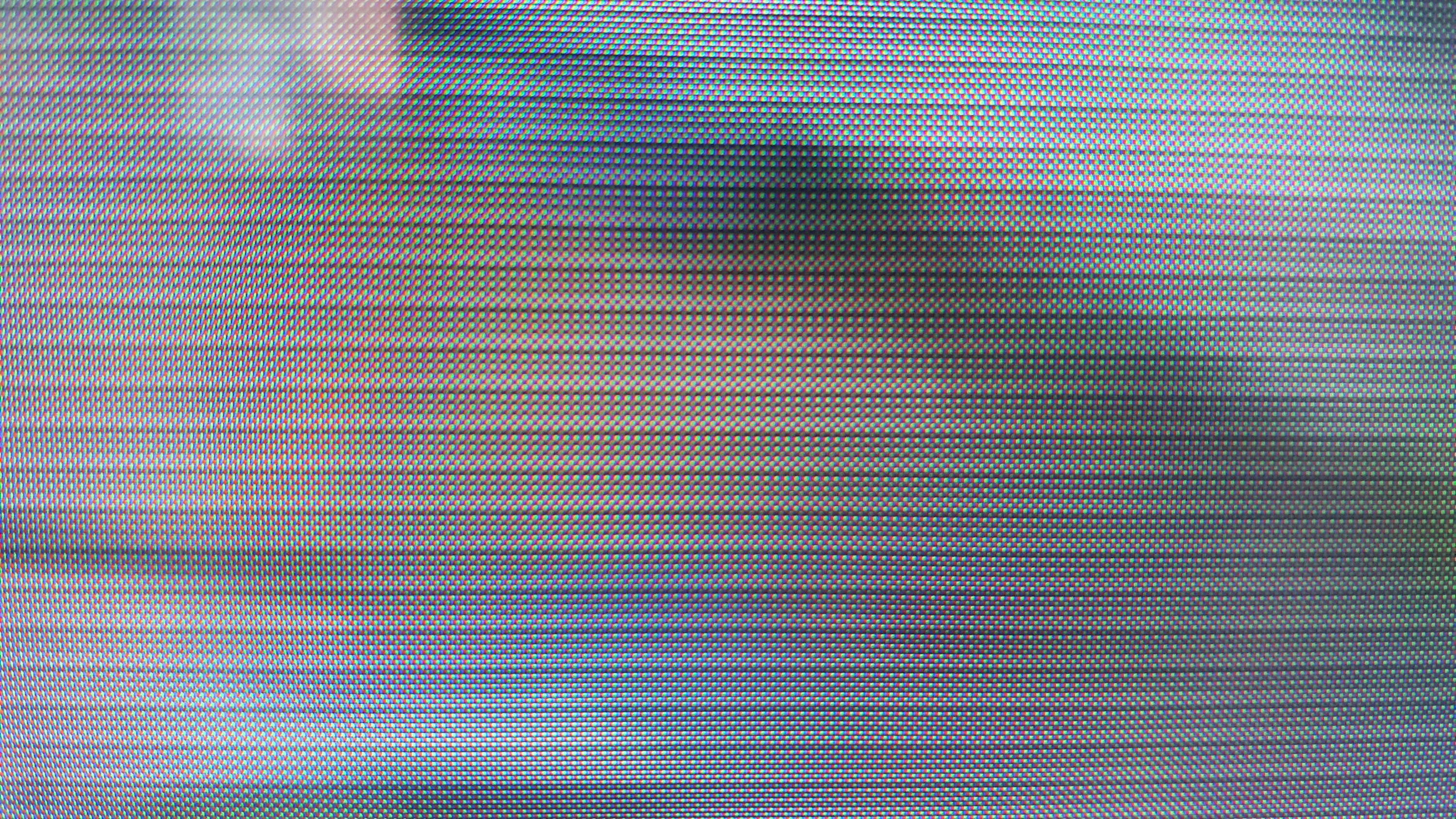

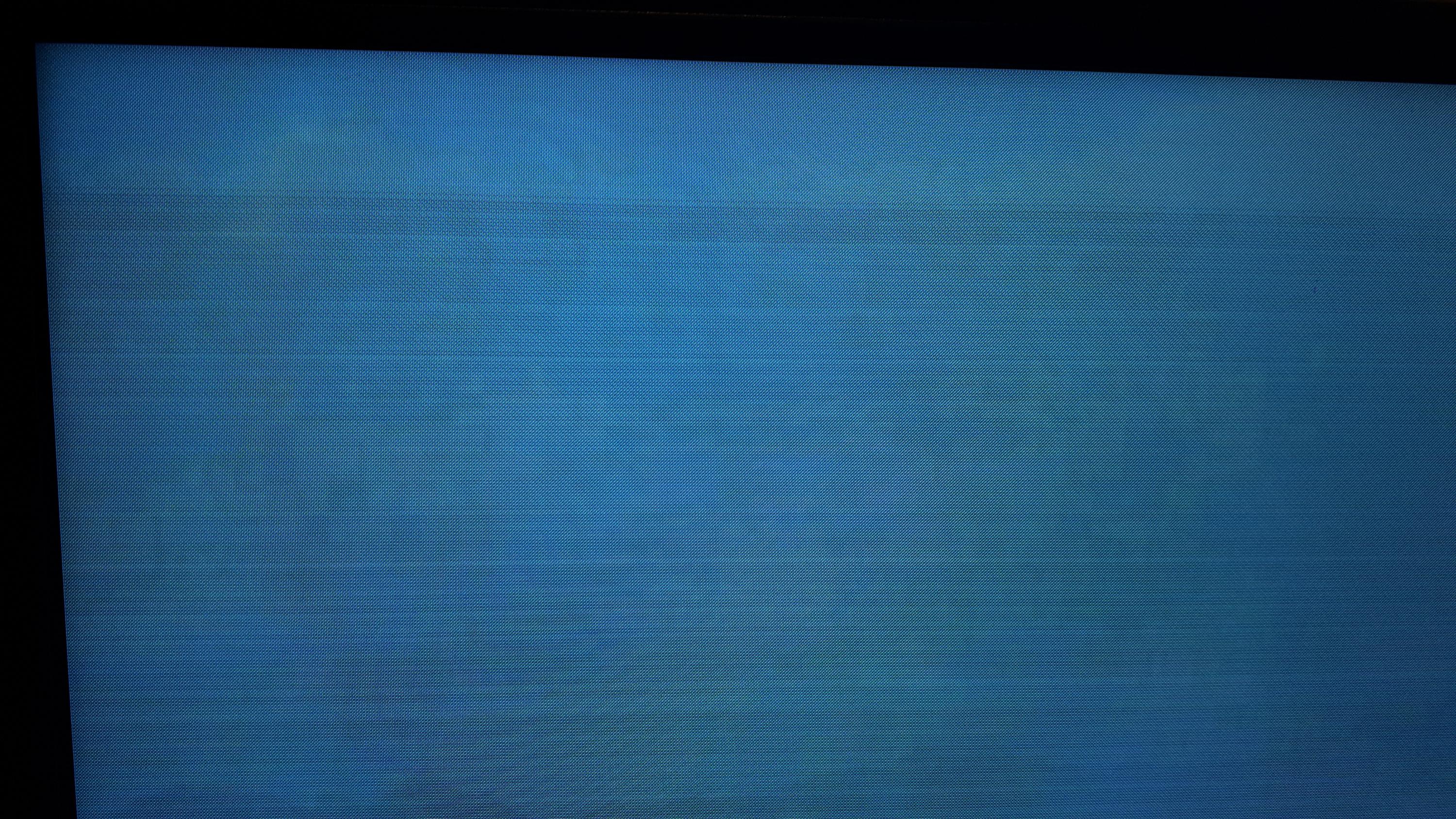

      Blocking all 8 pins with tape prevents the whole image from jumping, however it creates black horizontal lines that quickly move around. This new issue doesn't really show up when I record it, so I photographed it instead and attached the image below. It's not super noticeable when seen from afar, but it's noticeable if I'm sitting on my couch and quite annoying. Obviously, it's better than having a broken TV, but I'll like to get a better result before giving up!

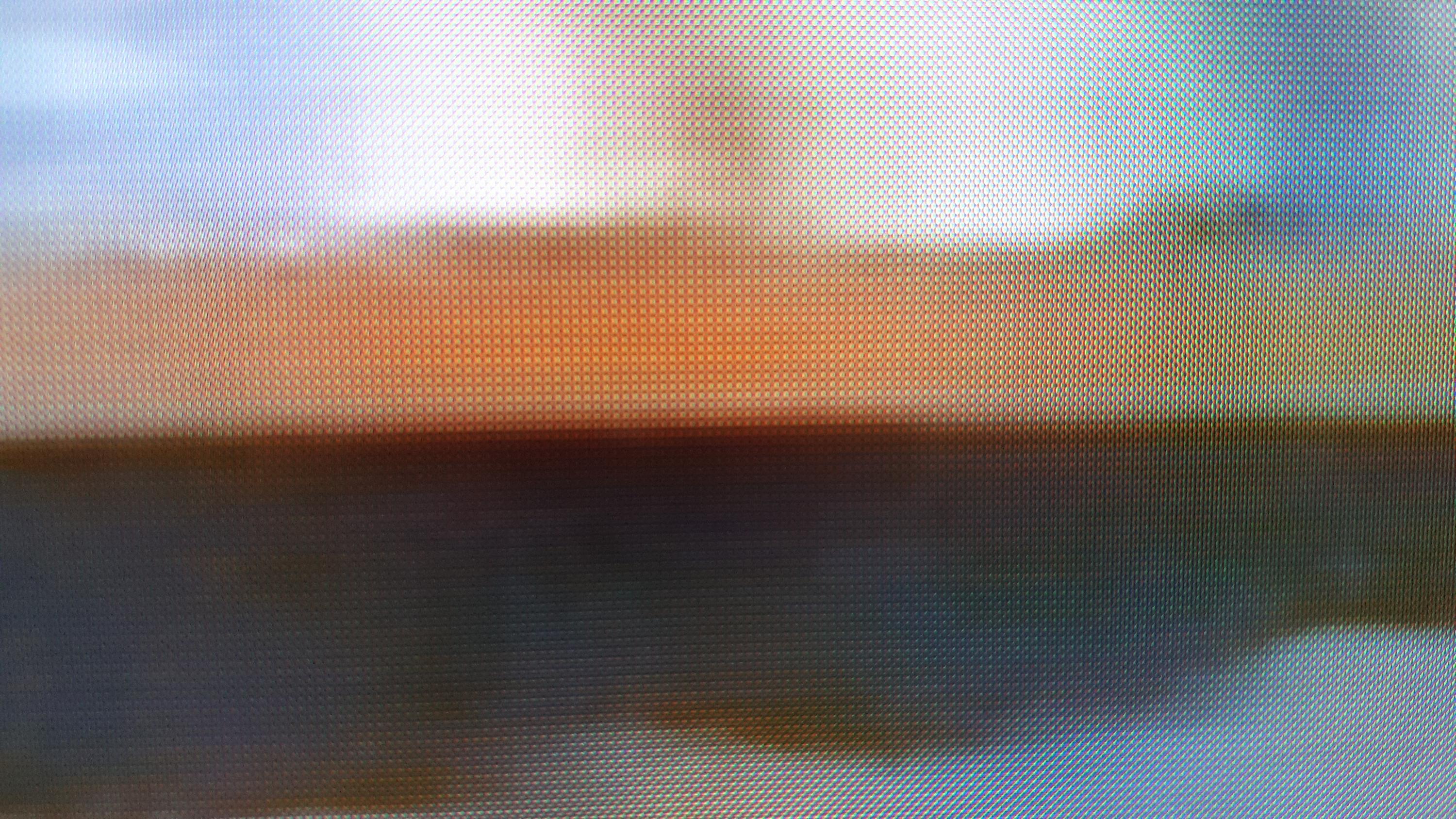

        However, it creates black horizontal lines every two seconds, which slightly darkens the screen at the same time. The issue is also more prominent on the left side (the same side with the faulty ribbon cable), while it's barely visible on the right side. You can see two pictures below. The first one is on the right side of the screen and the second is on the left side. Both images were taken when the black lines were showing up.

            Yep, I mentioned it in post #21 then after just seeing your pictures in post #23, was pretty sure it was bad tcon, just had that same deal with an old Sanyo. So when they say horizontal lines are never the tcon...do not believe them. Nice save.
