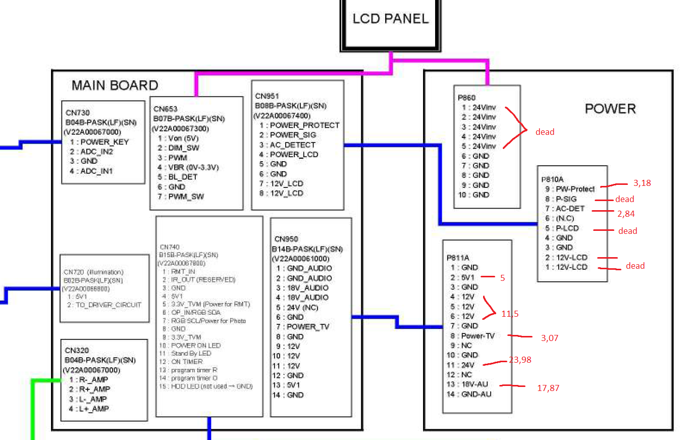

    Hello guys!
    TV: Toshiba 37RV633D
    MAINBOARD: V28A000938A1 PE0719
    PSU: SRV2169WW
    The TV when plugged in turns on by itself - the power led shines green for a few seconds, then turns red and it stays that way (standby?). I noticed that CPU on the mainboard gets hot, so I replaced it with the same model from 32 inch TV. The situation changed - the led on the front panel shines green all the time, but the screen is black. I meassured voltages on PSU, P-SIG and P-LCD shows 0. Is this bad PSU?

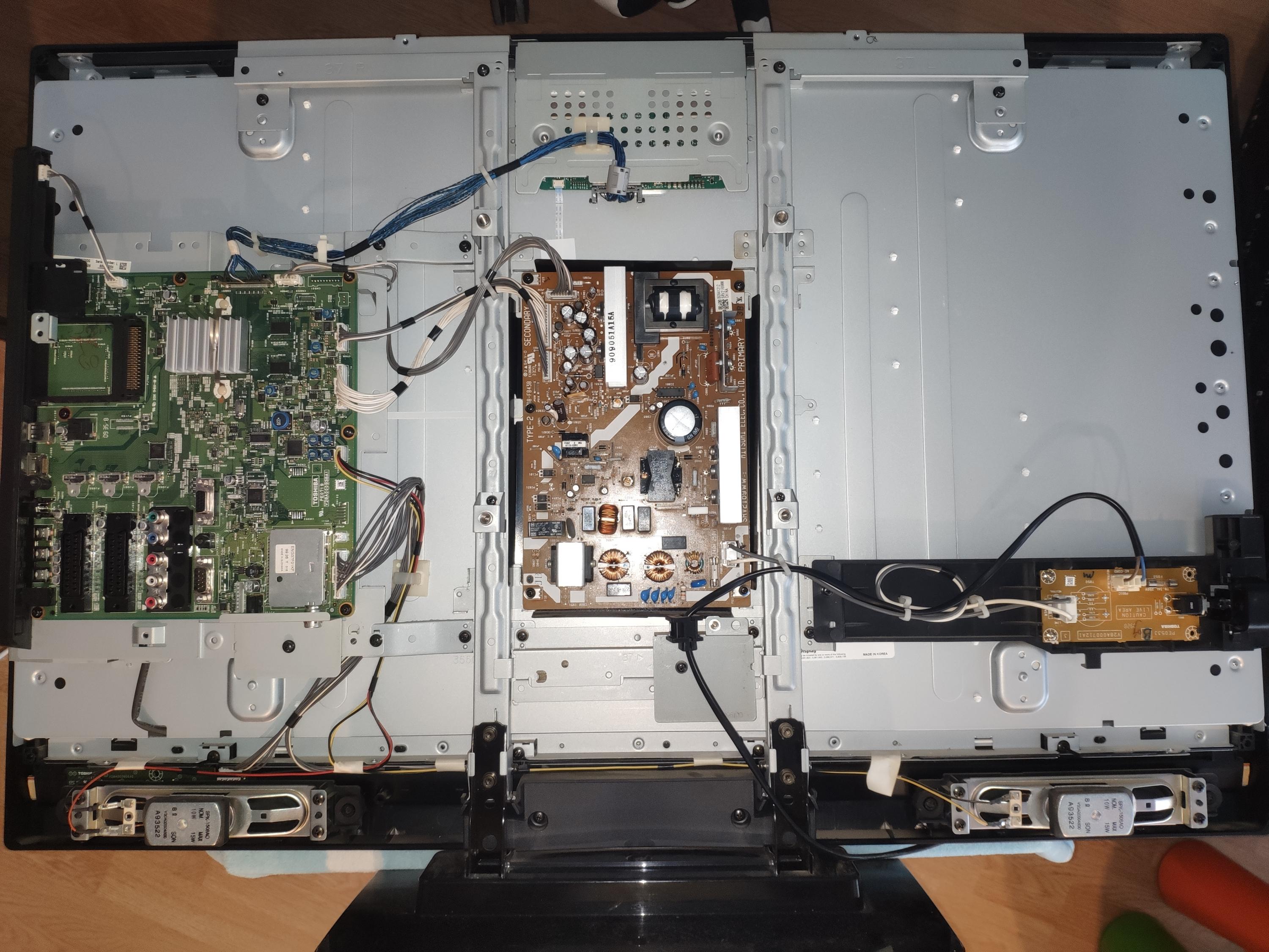

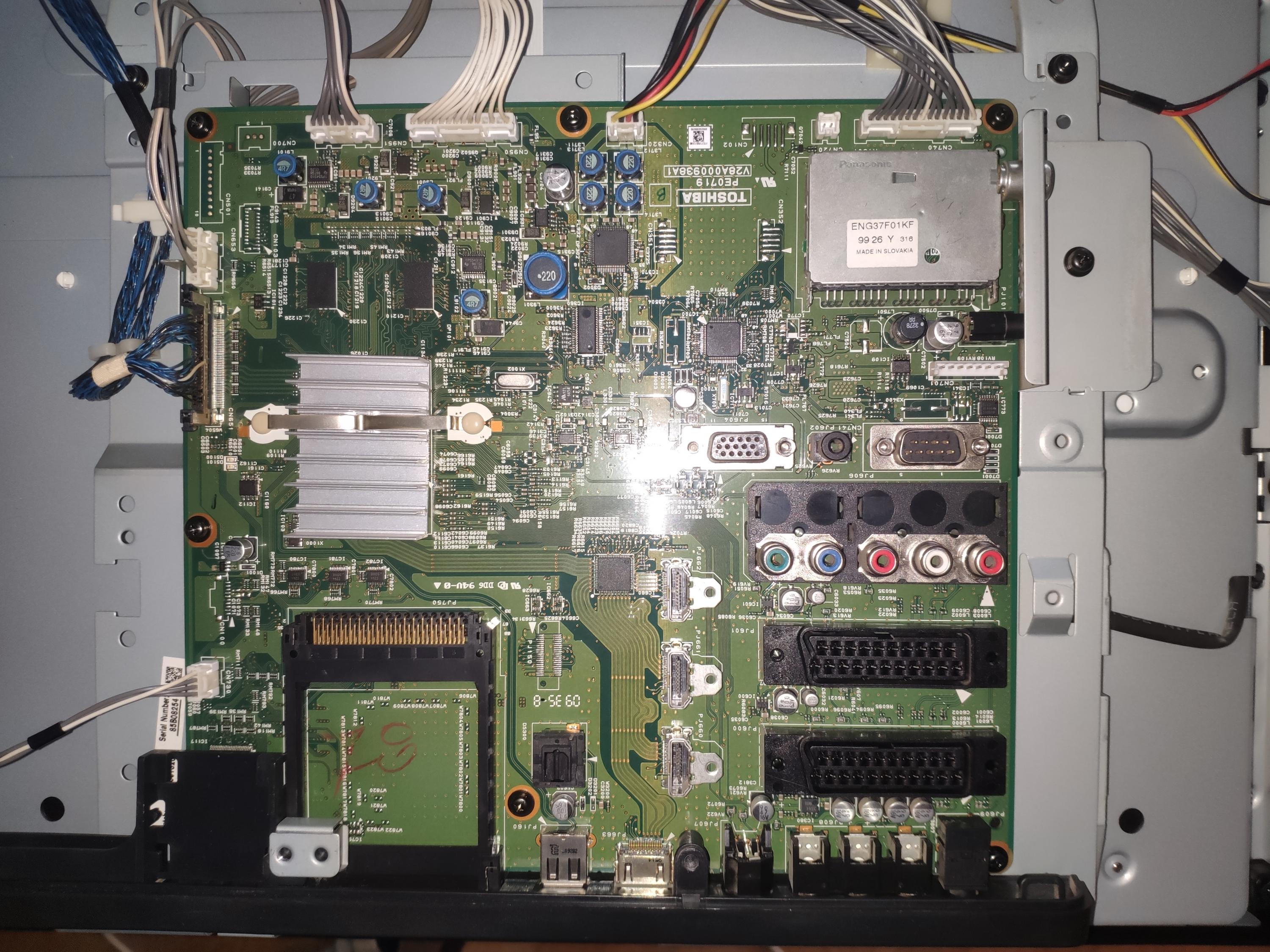

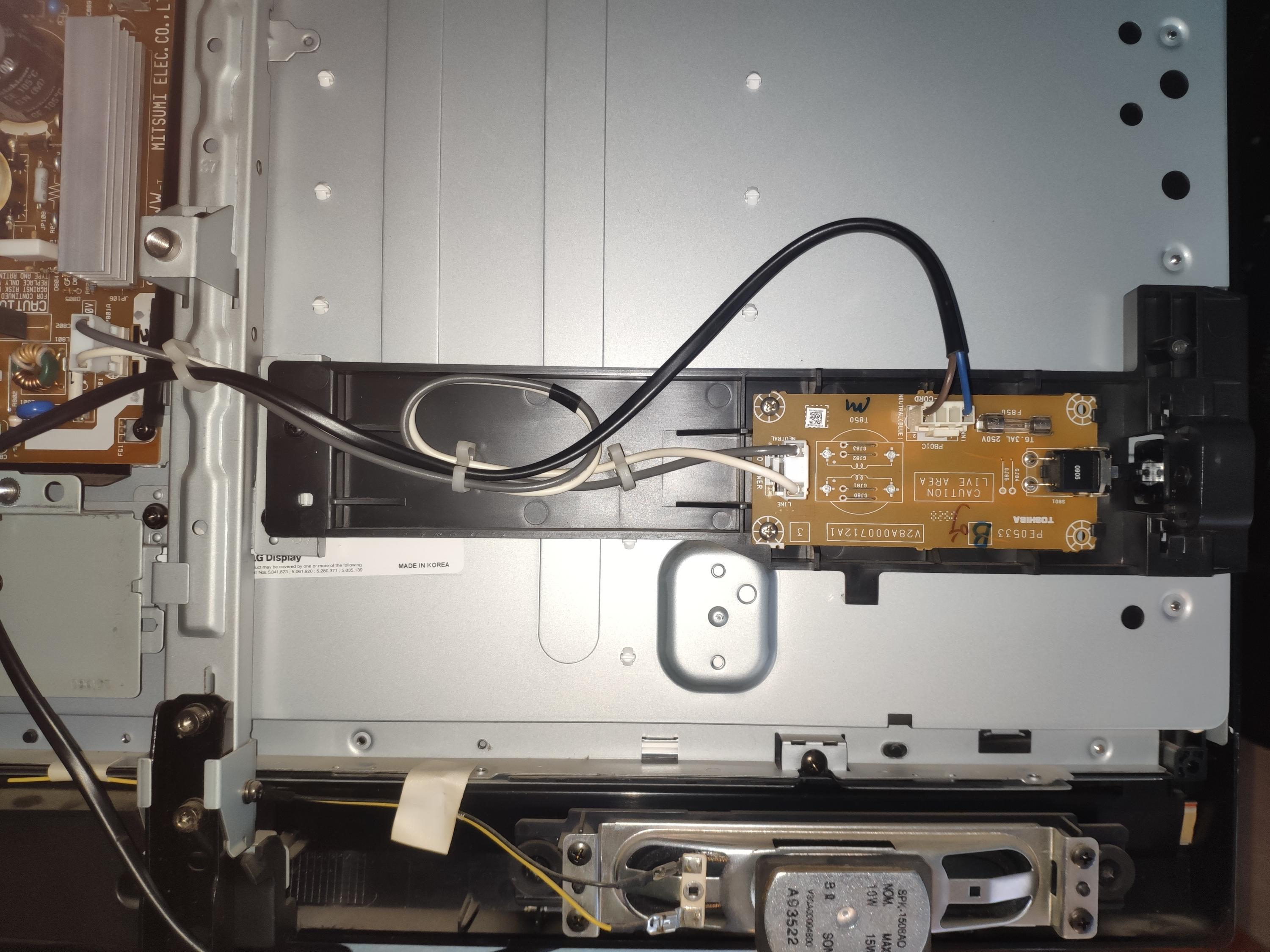

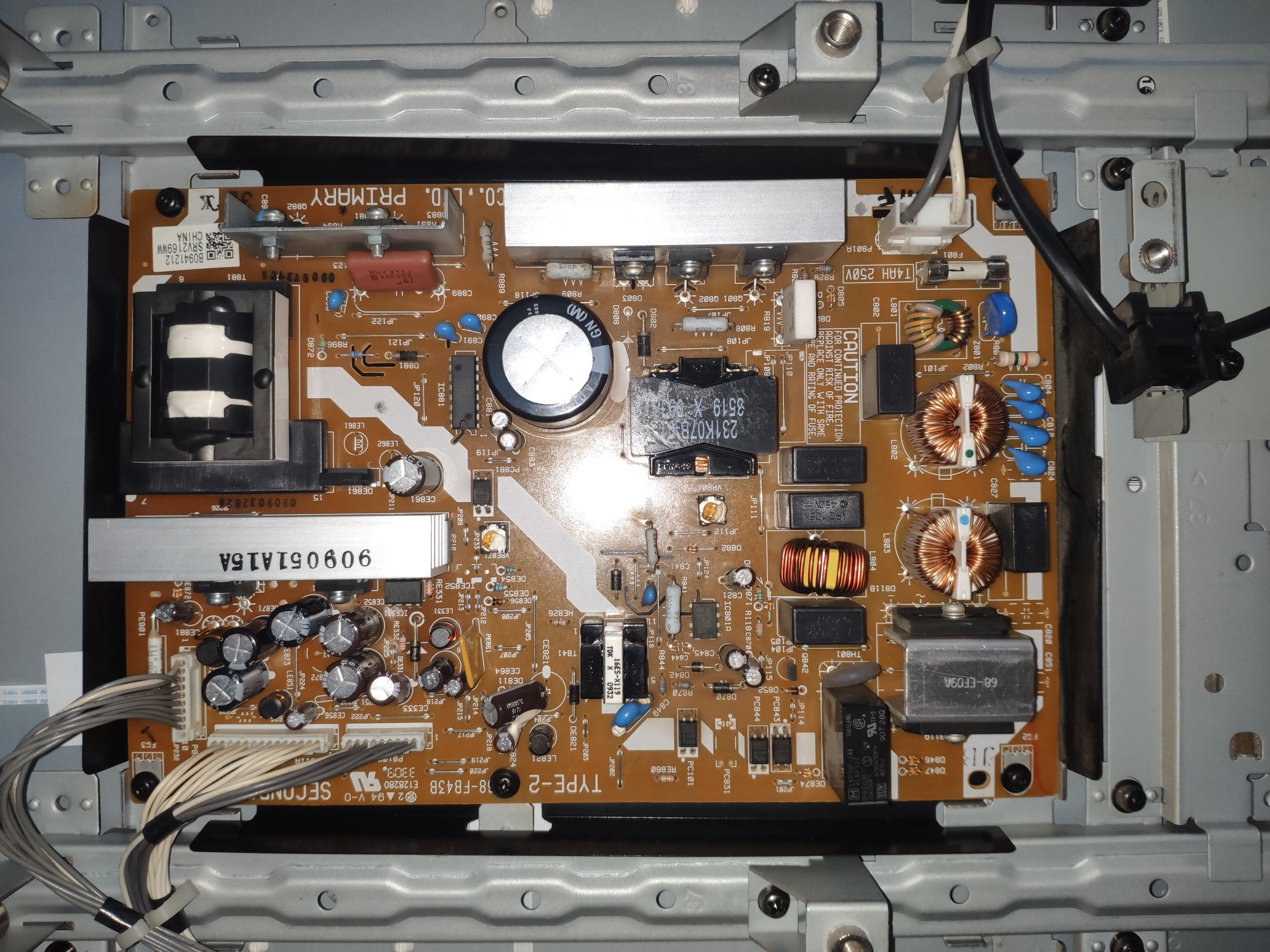

      Re: Toshiba 37RV633D
      Please attach pictures using 'GO ADVANCED' of the whole backside of the TV showing all the boards so we can see what we are dealing with.
      • kozakk
        • Nov 2020
        • 4
        • Poland
        Greetings!
        Thank you for the response. Here are the pictures you asked for.
