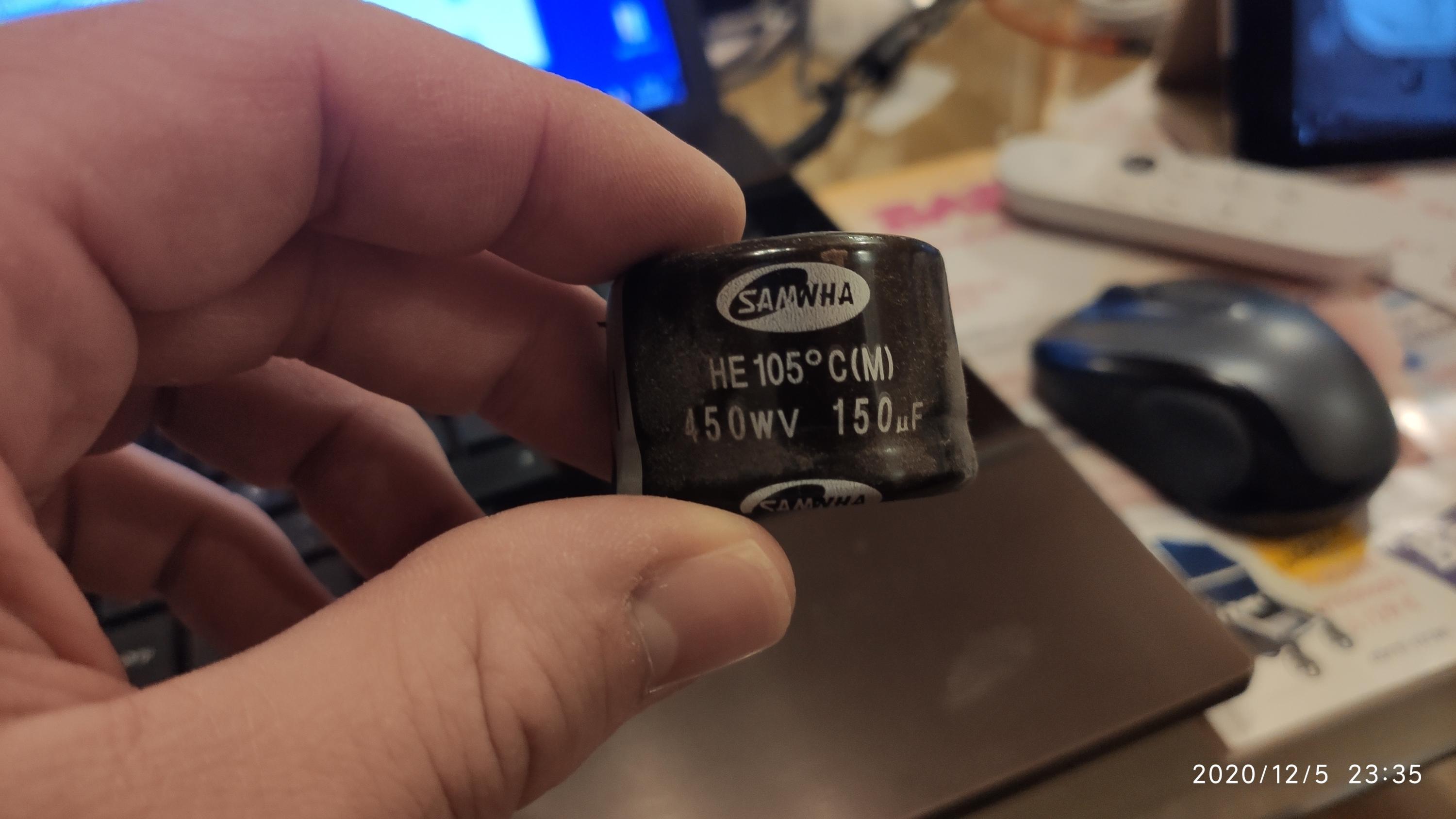

    Hello. I have owned Samsung TV for several years.
    Now, however, the kr has a problem of its own accord.
    When I connect the TV to the mains, the TV switches on and off automatically and on again, then switches off again and on again ... constantly.
    there is a kind of buzzing behind the TV
    When the picture appears for a few seconds, the buzzing decreases. Then when the TV resets itself, the buzzing sounds again.
    I'm also sending you a video below
    I ask for any help.

    Take the back of the tv off and post pictures of all tbe boards. Look for a few round top capacitors.

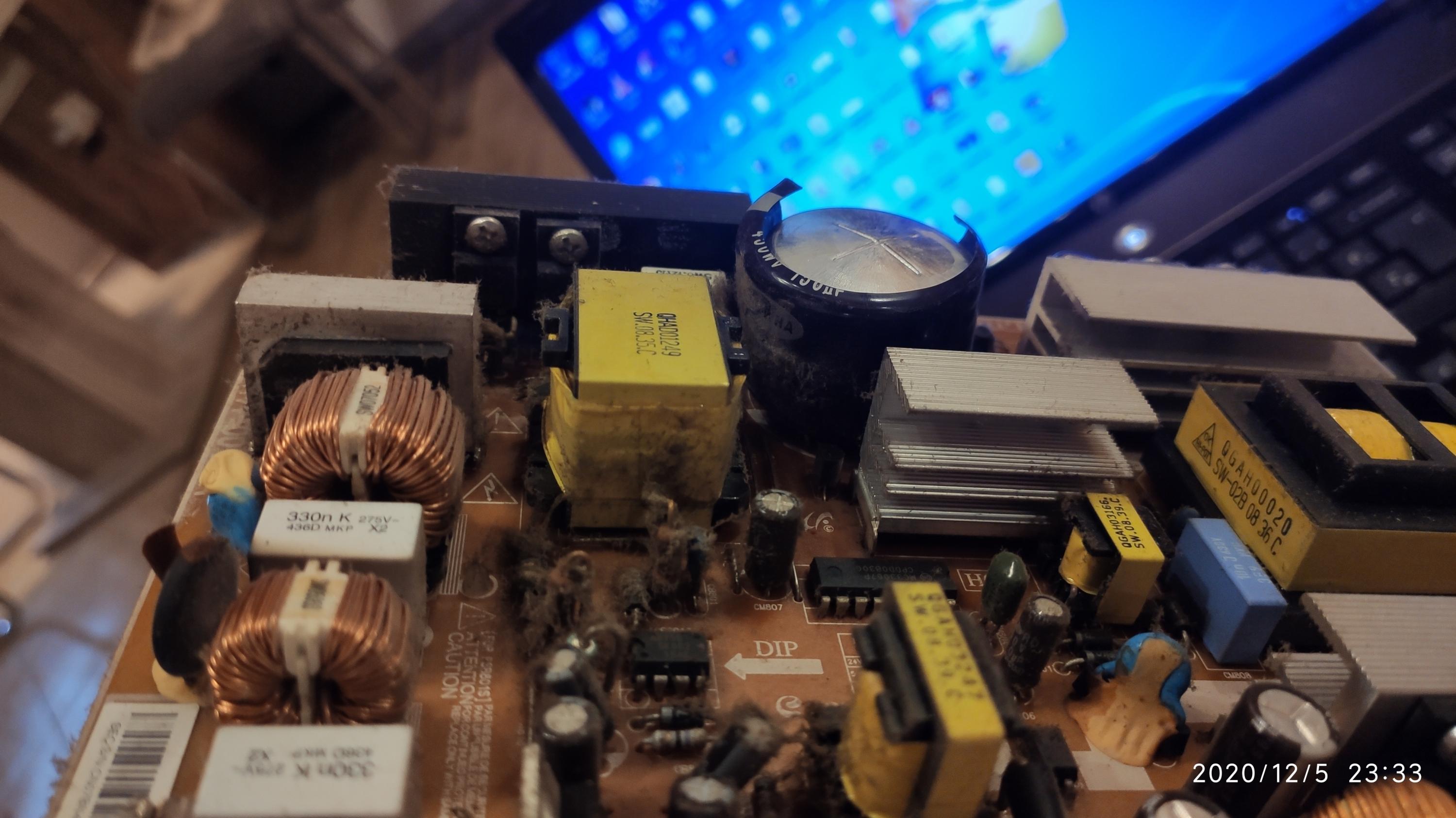

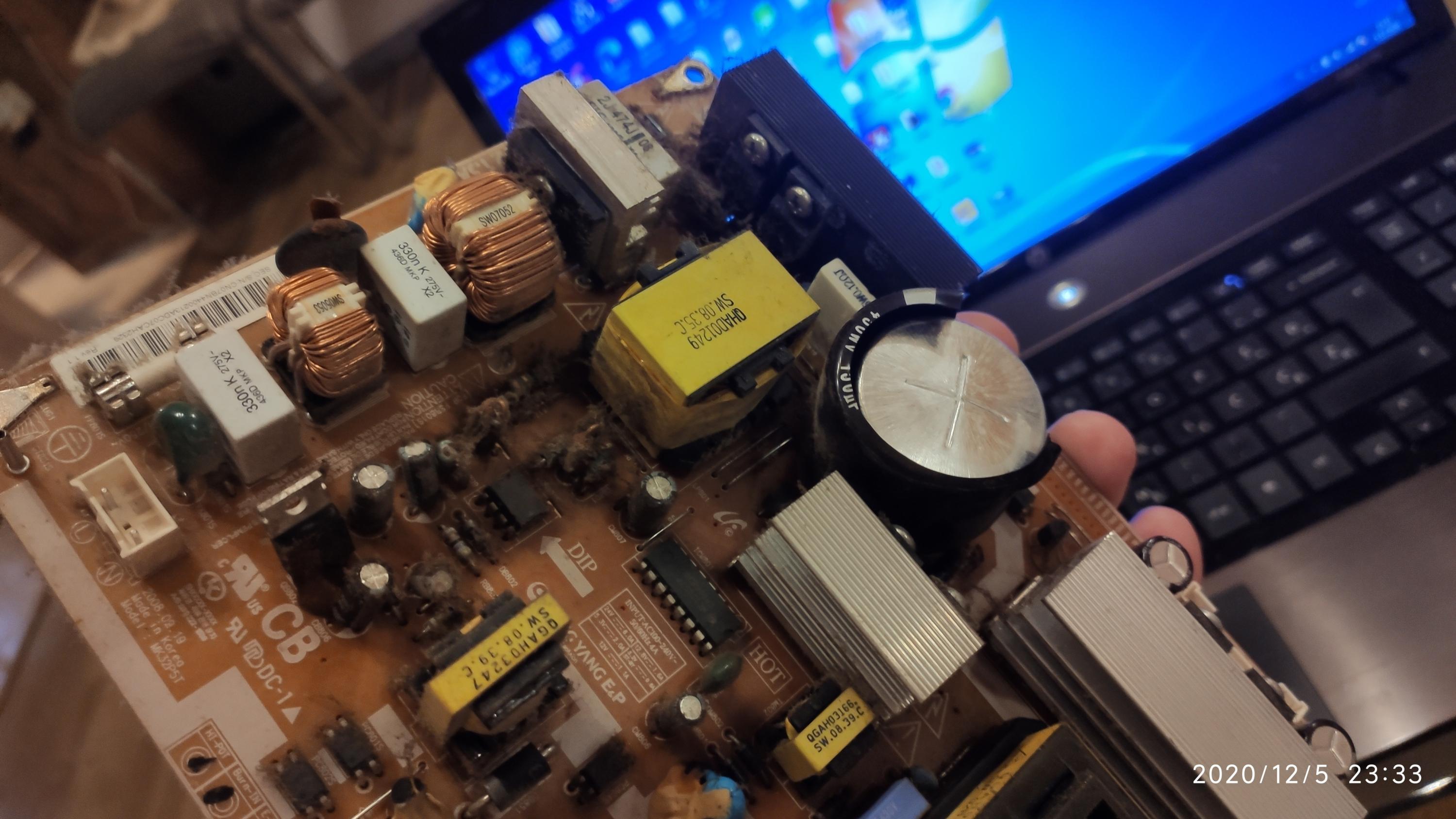

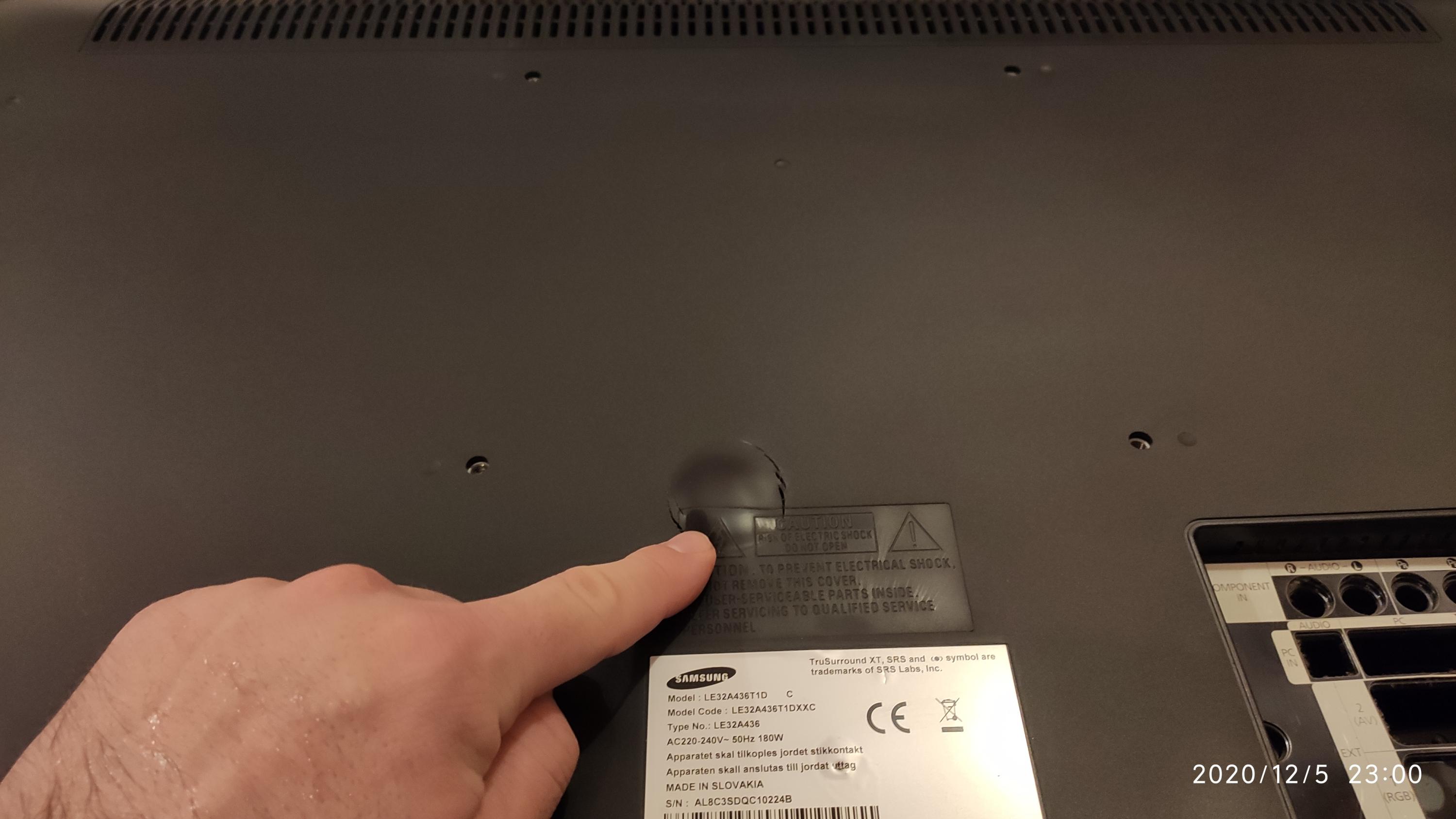

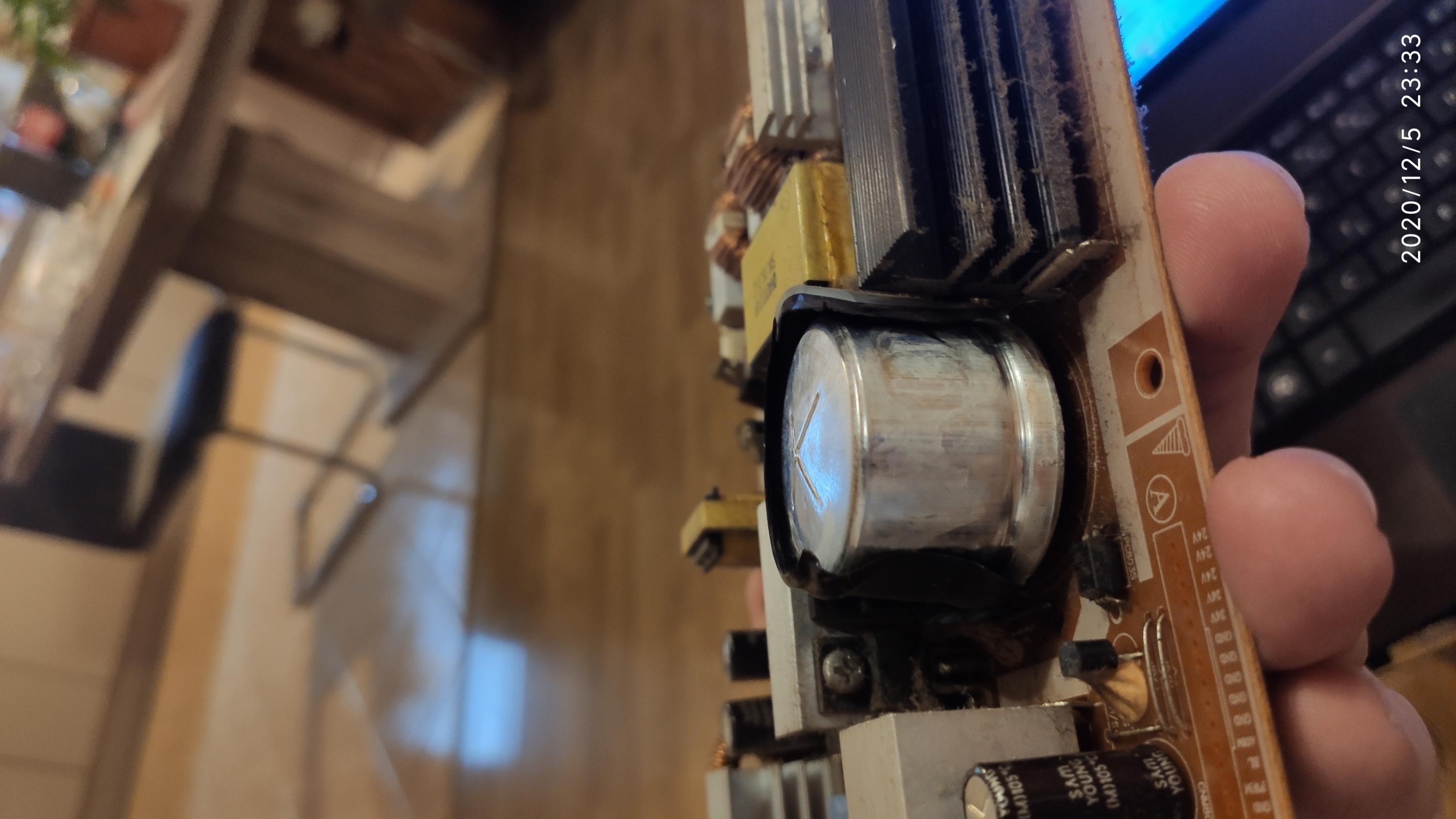

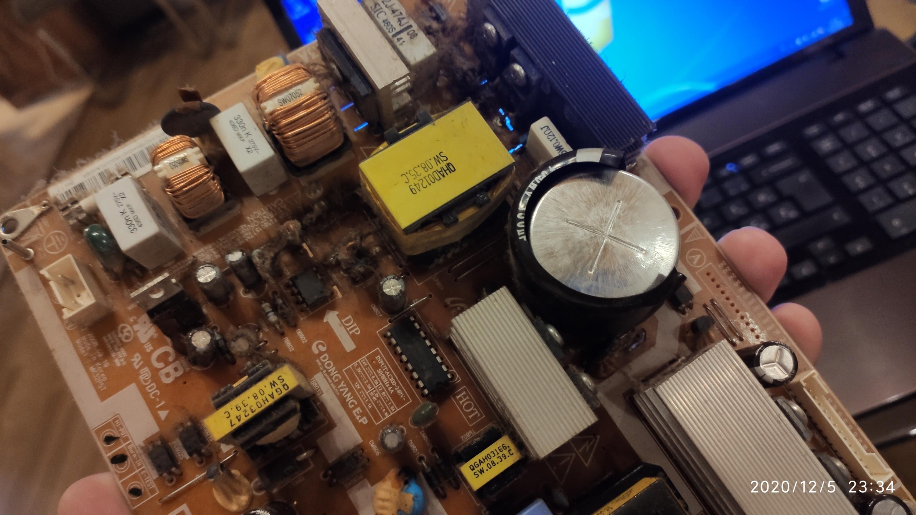

      Re: Samsung LE32A436T Help!
      Here's a picture .. You can also see on the TV case that it burned somewhere
      So the problem is safe in this capacitor?
      Look the picture
      • tvtimmy
        • Mar 2015
        • 1160
        • usa
        Replace that capacitor, it's blowing out of the bottom and lifting itself off the board.
          You also have bad brown glue that is conductive and corrosive and must be removed.

            I solved the problem.
            I bought a new capacitor and the thing is working normally.
            Yeah I also cleaned the plate of course

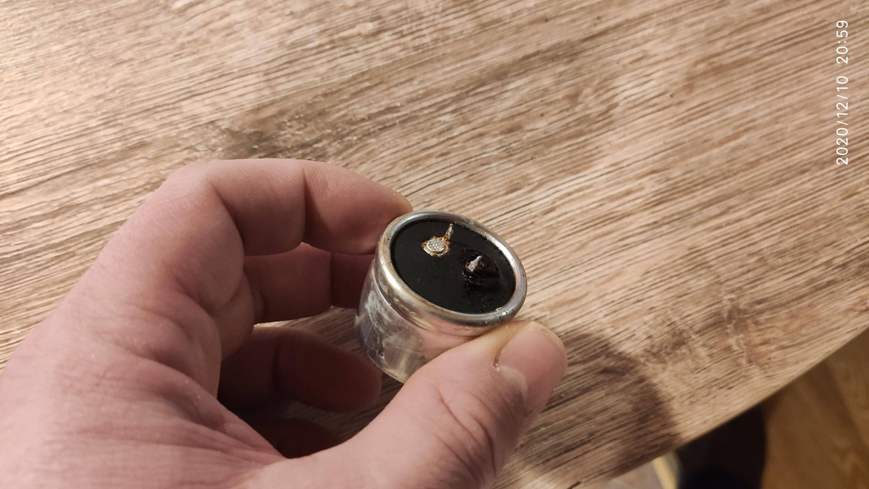

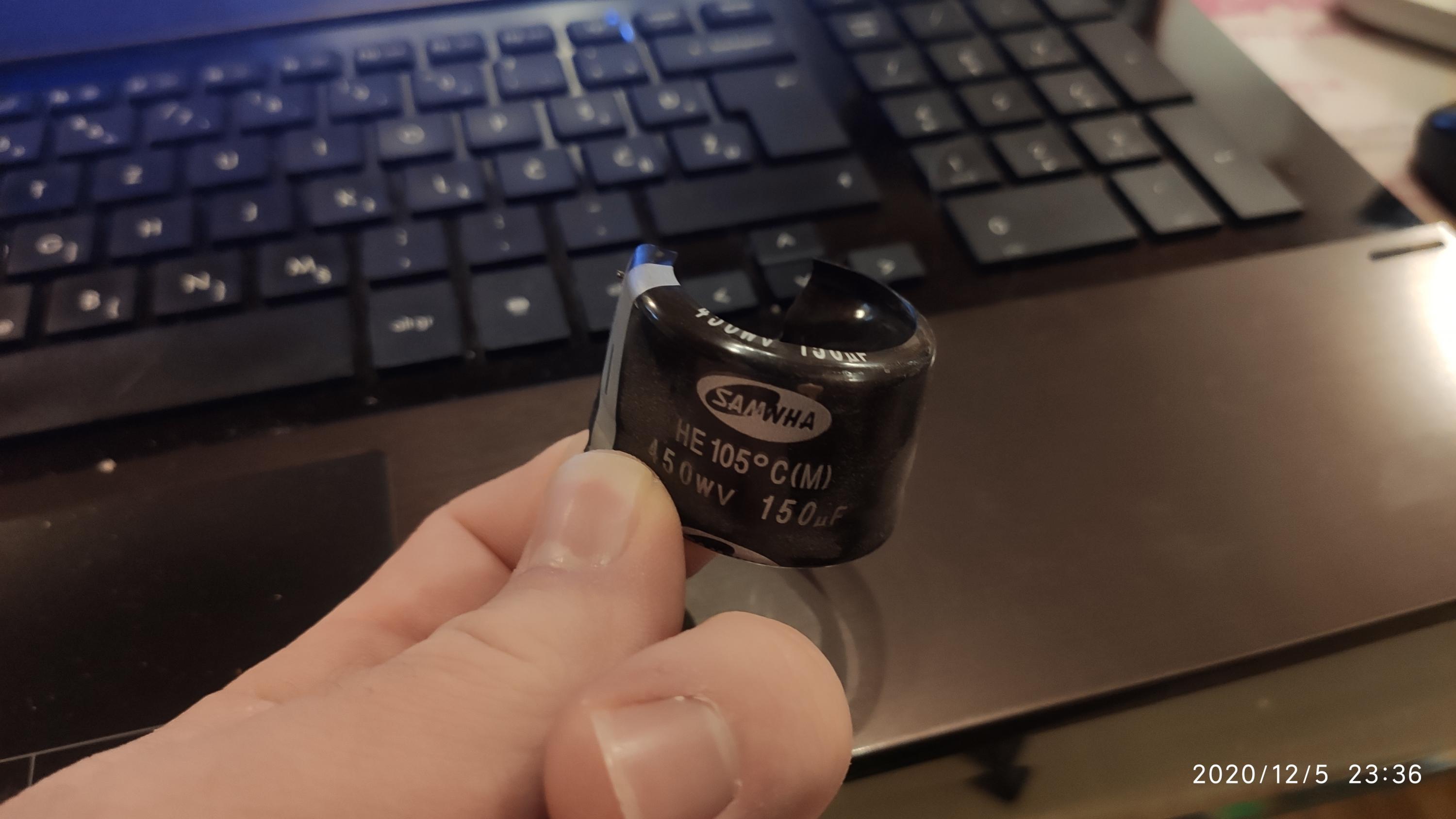

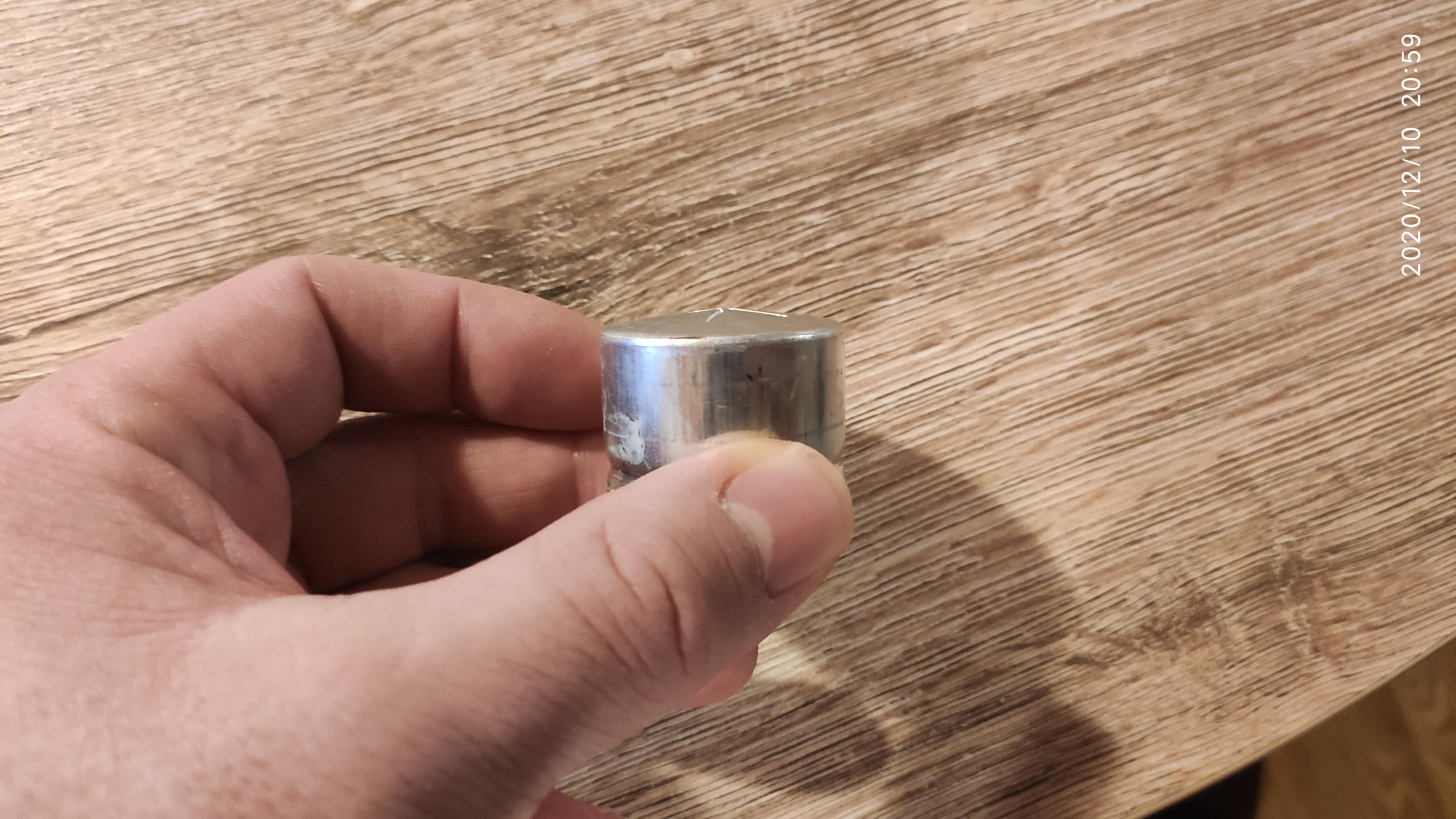

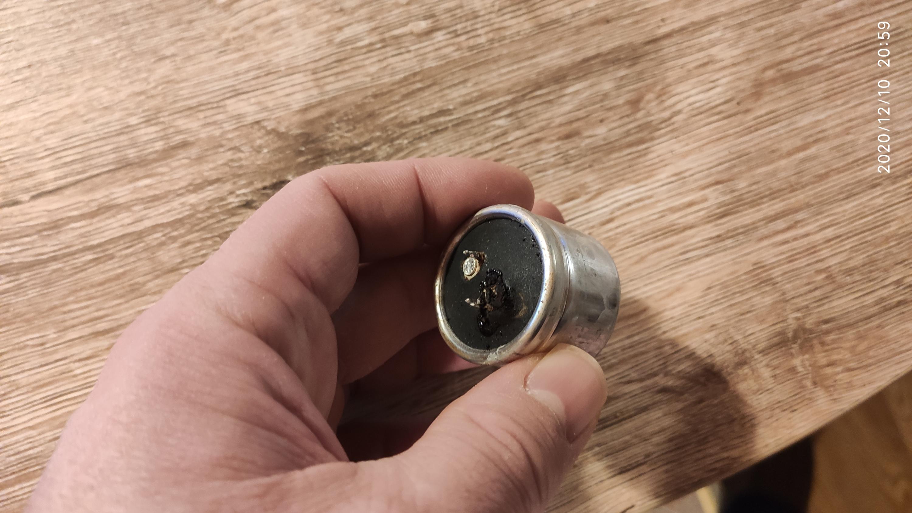

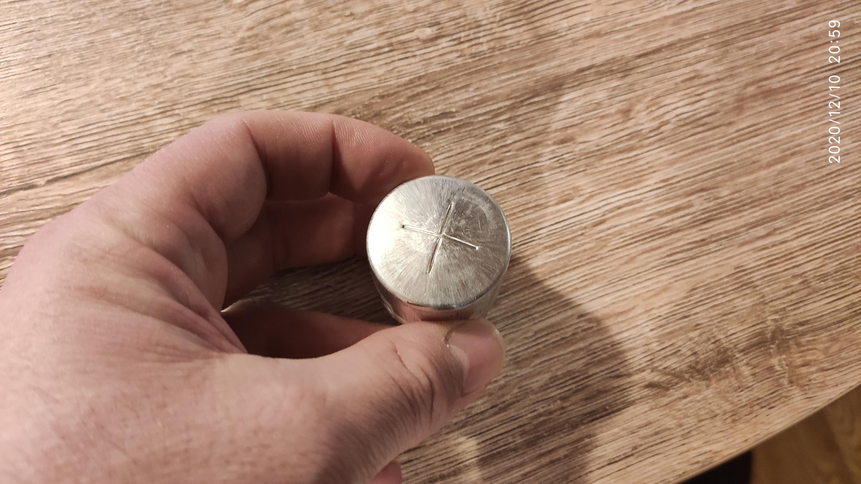

              Post a photo of the bad capacitor. It looks like one of the bloated capacitors of shame.
              • markolino
                • Mar 2020
                • 109
                • Slovenia
                here are 4 pictures
                • tvtimmy
                  • Mar 2015
                  • 1160
                  • usa
                  That one is bad, but check out the hall of shame on this site. Good fix!
