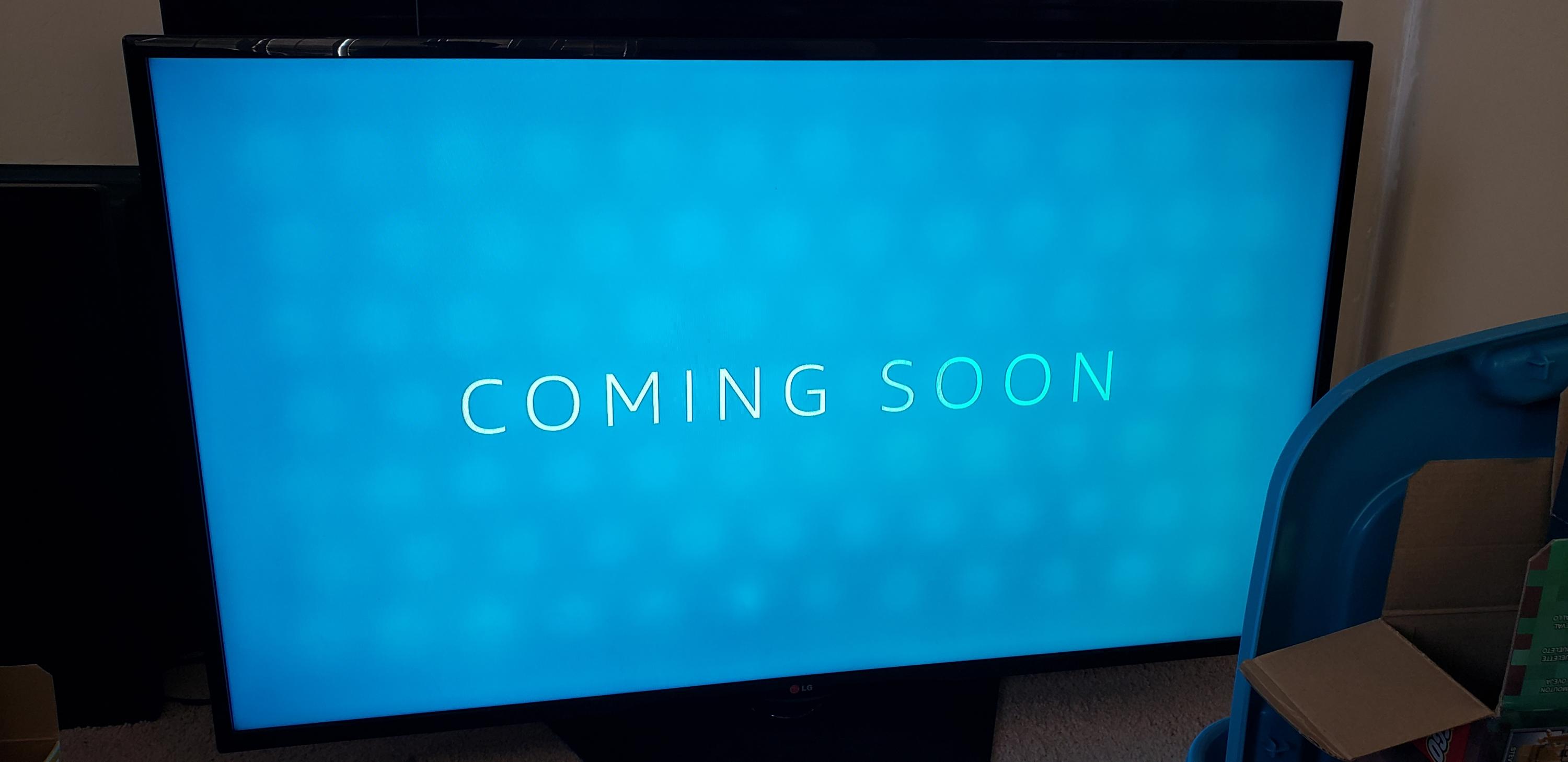

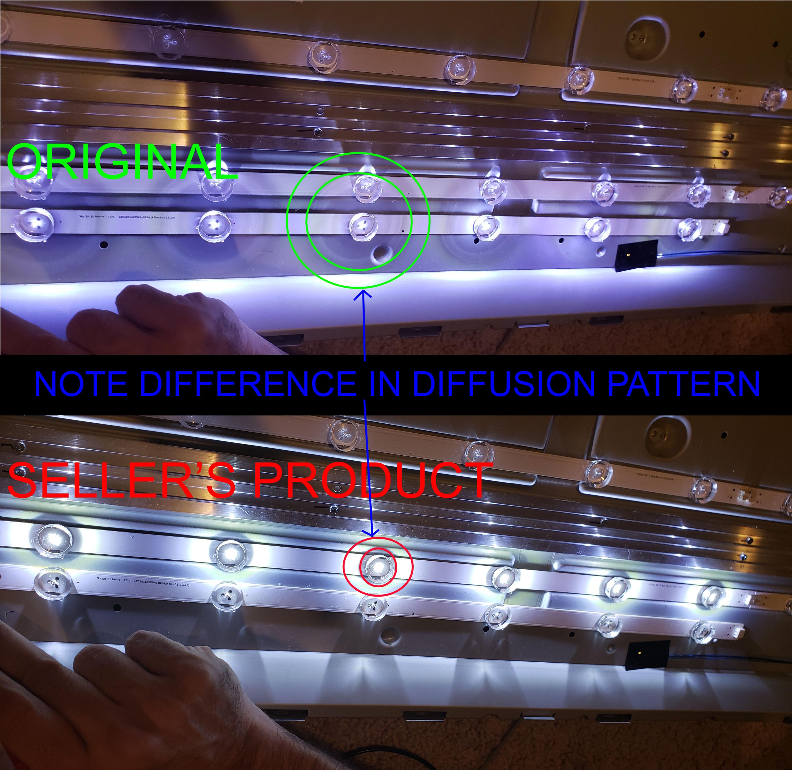

                    Hi Diah, just a follow up on this. I ordered a complete set of strips from AliExpress. They arrived recently and I installed them in the TV, but they create a bright spot at every LED. (see attached photos). It seems like the diffusers on these strips do not create the same diffusion pattern as those on my original strips.
                    Do you know if POLA2.0 LED strips (the ones I bought) are supposed to be compatible replacements for LZ5501LGEPWA-DL84 strips (the original strips I'm replacing)? I'm wondering if 1) I bought incompatible strips, and I can sell these and they will work ok for someone else, or 2) the strips I got from the seller are defective and I should throw them away.
                    Let me know what you think. Thanks!

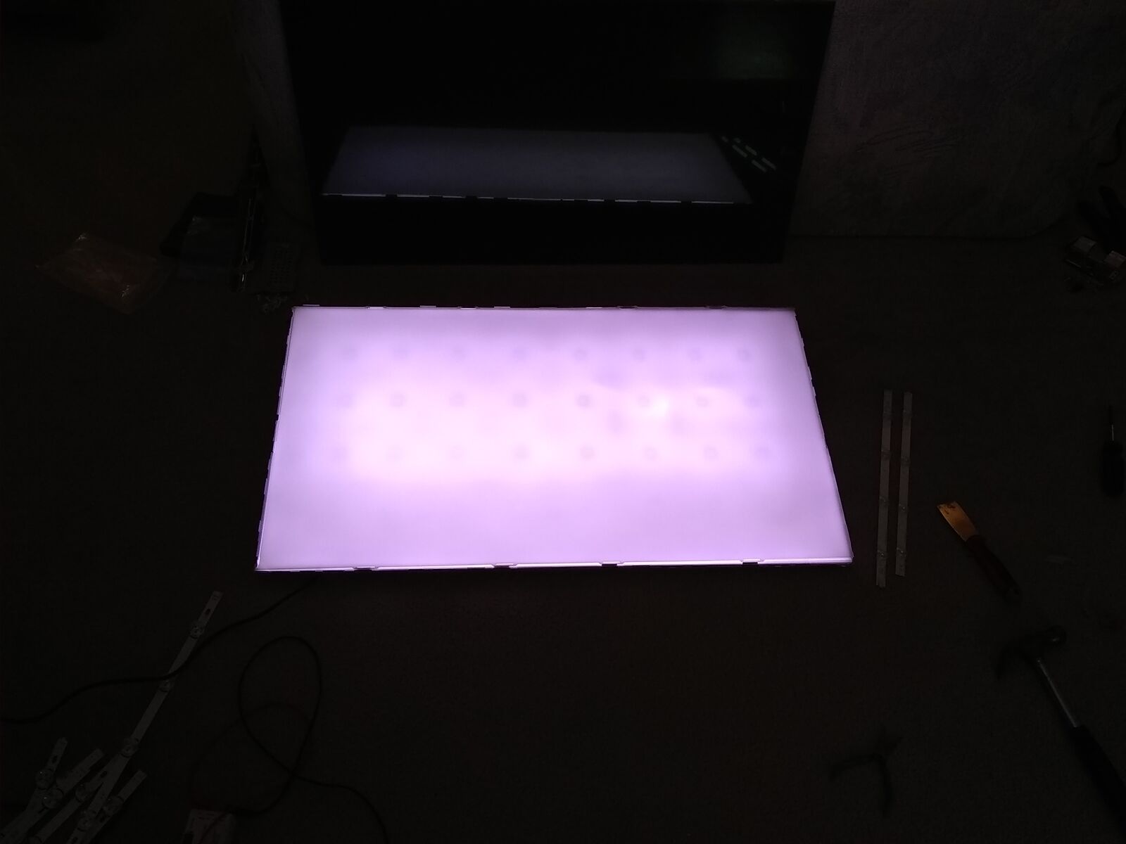

                        I've had issues with these thick LB style strips with some Chinese vendors. Had shadowing on a 42LB series (substitutes with the square lens style - have used this style before no issues for 32LB) and had them replaced with the original style. They were better but still not as even as the originals. Enclosed pics with bottom row original strips.
                        The POLA2.0 strips have a slightly smaller lens and for a Heesung panel. I am still looking for reasonably priced 50" strips for a 50LN5310 not realizing there were two different thick lens styles.
                        Lesson for the these thick lens strips is to try to find originals or use trusted vendors. I would show the vendor your pics and ask for a refund.
                            I actually assumed these strips were defective/poor quality and already went back & forth with the vendor and showed them the photos. They claimed the LED strips were working fine. I escalated to AliExpress, showed them tons of pics, explained what happened, and AliExpress closed the case and refunded me only ~$2. *sigh*
                            I took a close look at them and it looks like the lenses are mounted a few mm higher off the strip than the originals, which could be the manufacturing defect. If you think these strips are defective and wouldn't work right for someone trying to replace their original POLA2.0 strips, I'll just harvest the LEDs off them and throw the strips away.

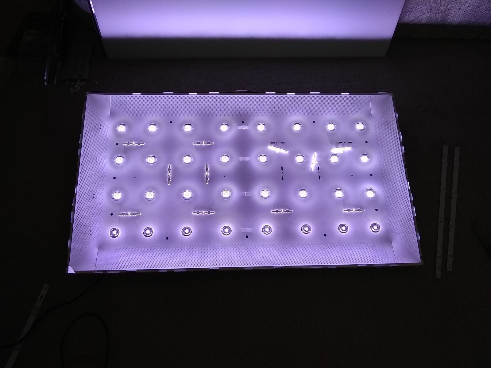

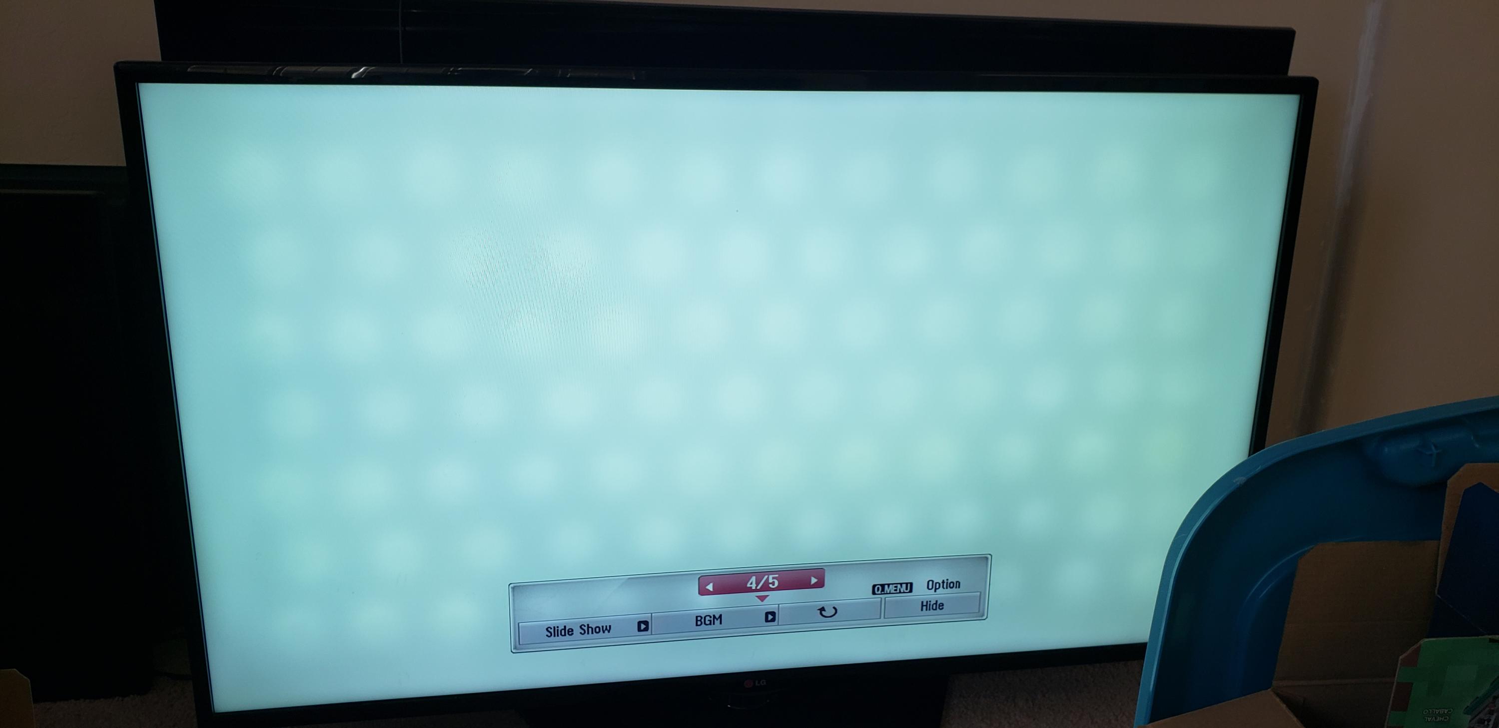

                              Just to be sure, last night I tested all 3 sheets in every possible combination and no combination resolved the issue. The original way that I had them oriented was definitely the correct way.
                              I also noticed that in the replacement strips the lenses appear to be mounted a few mm higher off the strip than the lenses on the originals. This would account for the strange/different diffusion pattern.
                              I'm still not sure if 1) The tighter/brighter diffusion pattern is normal for POLA2.0 strips, and TVs originally designed to use POLA2.0 strips have the right diffusion sheets above it to compensate for this (i.e. they're actually not compatible replacements for LZ5501LGEPWA-DL84, but would work fine for someone replacing POLA2.0 and I can safely sell them as such), or 2) these strips are defective and I should scrap them.

                                POLA2.0 just label had nothing to do with TV brand. its duplicated manufacturing so it should hold different label to avoid any legal issue.
                                they consider at this duplicated process the amount of LEDs and the distance between each LED beside the working V. and wiring of the string for matching. the issue you may face not at lenses as any other thinking about.. but the LED module had double or 1/2 more Lumen than the one build in. and this related not as dummy from supplier, but the LEDs manufacturing later days became more efficient with Lumen as they was 4-5 years ago.
                                i am certain sure even if you are going to take out LED unit from yours new strings to replace it with defect one at the ORG string will have same effect even with OLD ORG Lens.
                                Lumen on LED could be controlled by VA and Freq. i am not sure if you are willing to change your Power Boards LED section design.

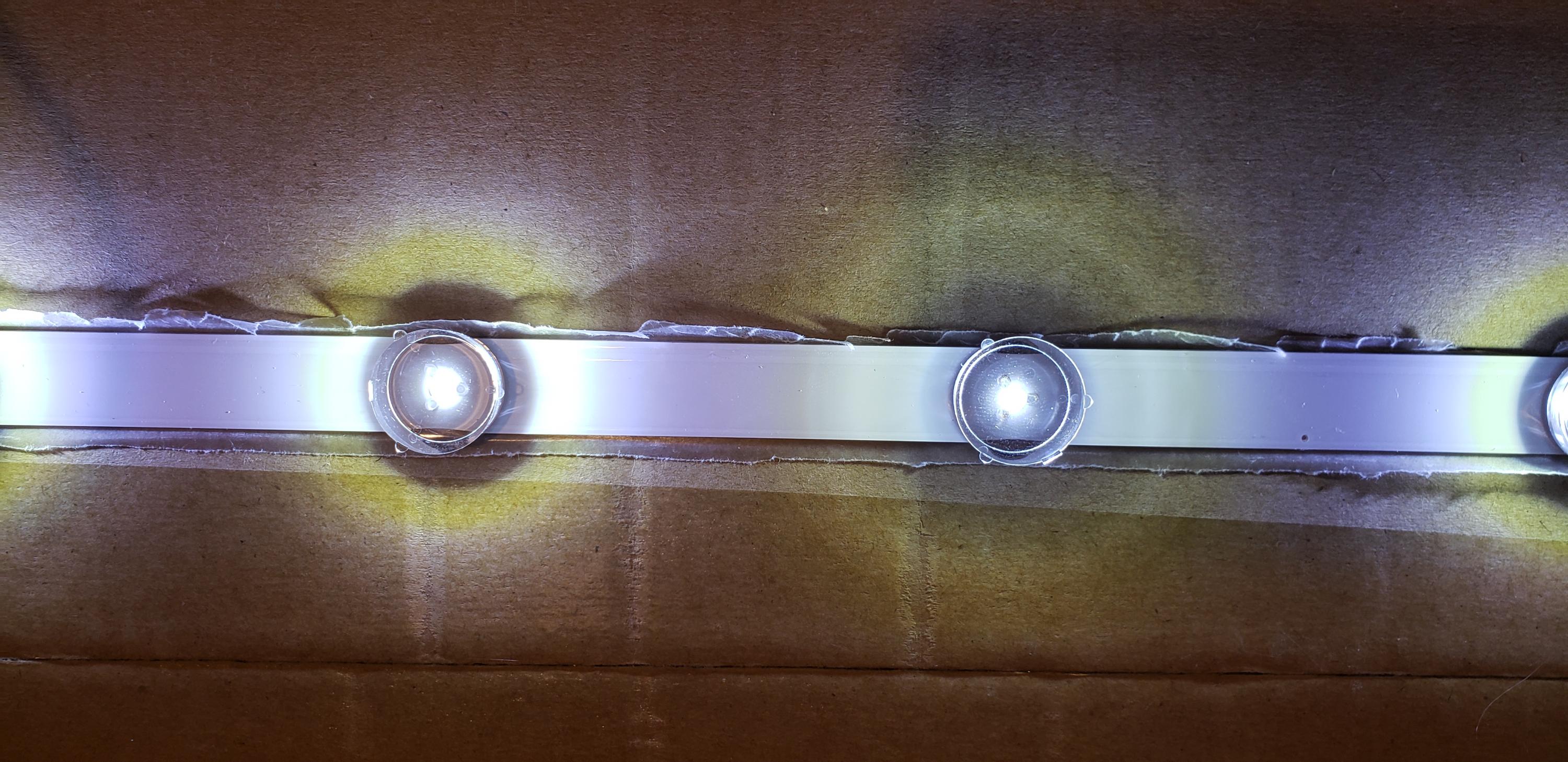

                                  As a test, I decided to pry one of the lenses off of one of the new strips, turn it slightly sideways (so that it would sit a few mm lower) and power the strip. It made no difference. So, the distance of the lens from the strip was not the problem. Then, I took a lens from one of the old strips and put it over the new strip. I've attached a photo (new lens on the left, old lens on the right). The diffusion pattern of the old lens is quite different from that of the new lenses. (One other thing to note is that these LEDs cast a yellow ring whereas the original LEDs cast a white ring. I don't think this will affect the functionality/usability, but it is a notable difference)
                                  In the end, this is a problem with the LENSES. I'm not sure if POLA2.0 lenses are just designed differently and this is normal for POLA2.0 strips (and they are not suitable replacements for 55LN5400), or if the lenses used by this seller are just defective. **What do you think?**
                                  I'll try using the old lenses with the new strips. I think that will work. I will update you when it's done. Thanks again for the help!
