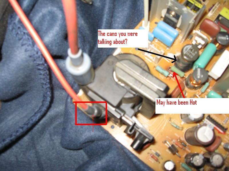

              The condition of solder LOOKS good but it is bad. This little jumper wire is around one of inductor coil (looks like a can) near a edge. That's left of the convergence ampifiers.
              For this reason I *resolder* whole signal board and easier for me to instruct that to anyone. The pair of fuses is brown square cross section type and are near edge up front hidden from view because of capacitor forest on the deflection/power supply board. That is why I wanted you to pull BOTH boards out and on the bench under good light.

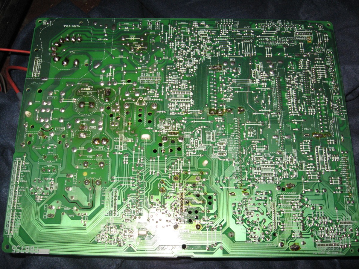

                    I took a couple photo's my net connection is very bad since the storm hasnt been fixed if you need better pics let me know this board is to the right of my convergence chips if you are behind the TV , I noticed some solder points apparently from the repair from the local guy they seem to have some flux around them also i cant get the red wire out of top so i had to take the pic on a blanket the one i cant get out has a arrow drawn to it on the pic's and runs over to the color and focus board on the right side front of the TV ,
                    If this isnt the part of the board you needed let me know ill upload different pics,
                    Thanks in advance

                      Since the picture above i have went over and resoldered almost everything on that board put it back in and still a no go actually it seems to be worse as if a resistor wasnt makeing a good connection before and now it is. Meaning by makeing it get a better connection it doesnt it kicks as soon as i connect the power cord and doesnt come on at all unless the power supply to the IC's is disconnected,
