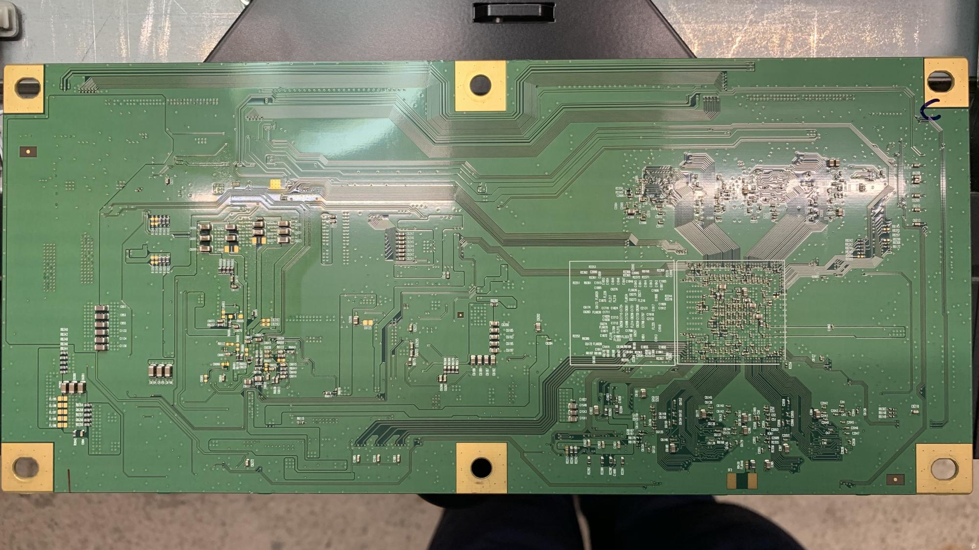

                thanks for the SM upload. this clear your test statement above. T-CON still have other 12V feed via LVDS (XP33) which operate the T-CON FW. which we want to run as stand alone.
                i am not sure how its look your T-CON boards.. thought the photos you uploaded before give not much info if the XP33 12V pins direction TO or FROM MB , if they are from MB then...
                the test you did it before of 12 & 24V was okay.. but need other 12V to replace the feed of xp33 to T-CON. so the same 12V of PSU to T-CON can be bridged and used of course.

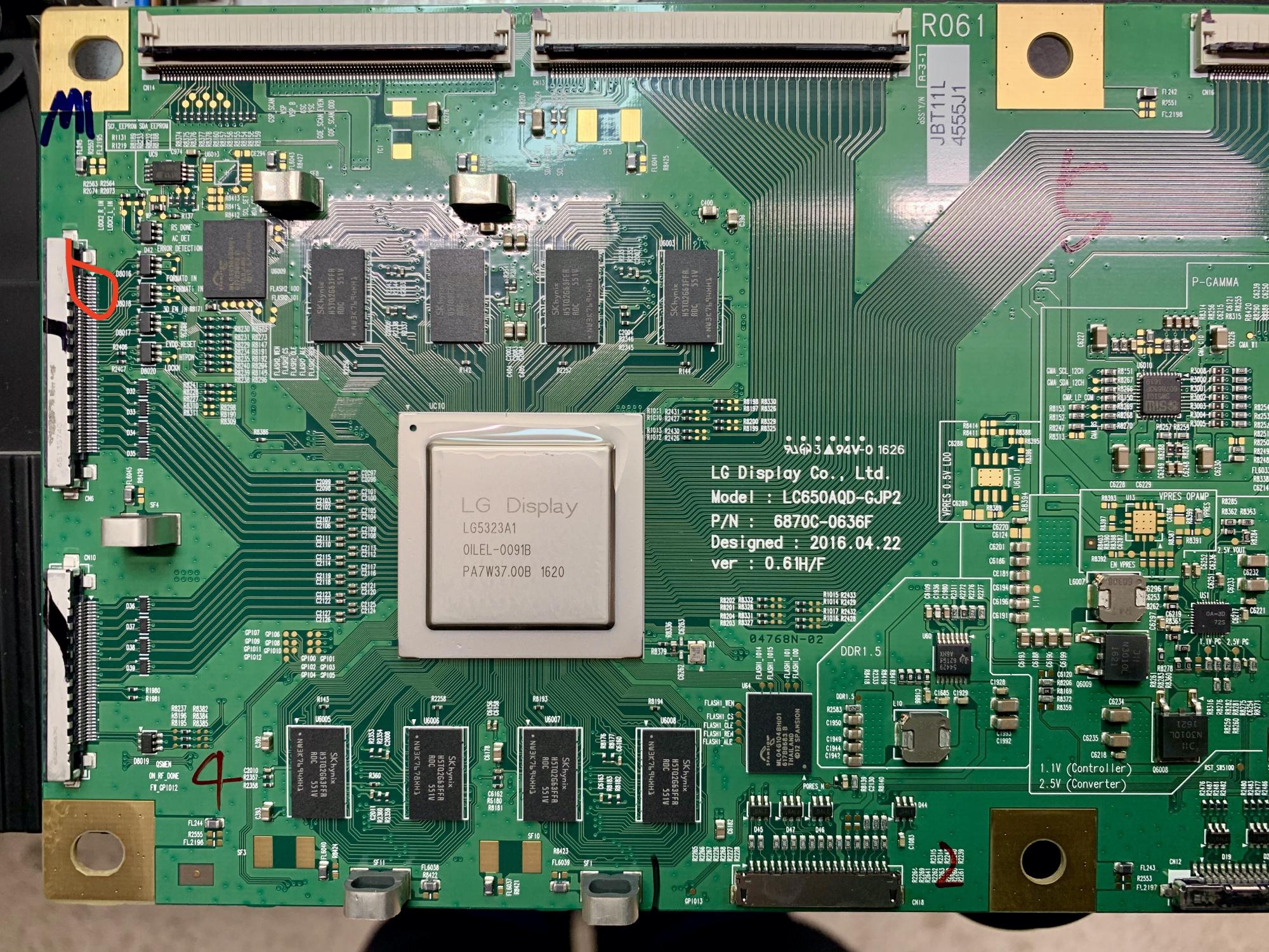

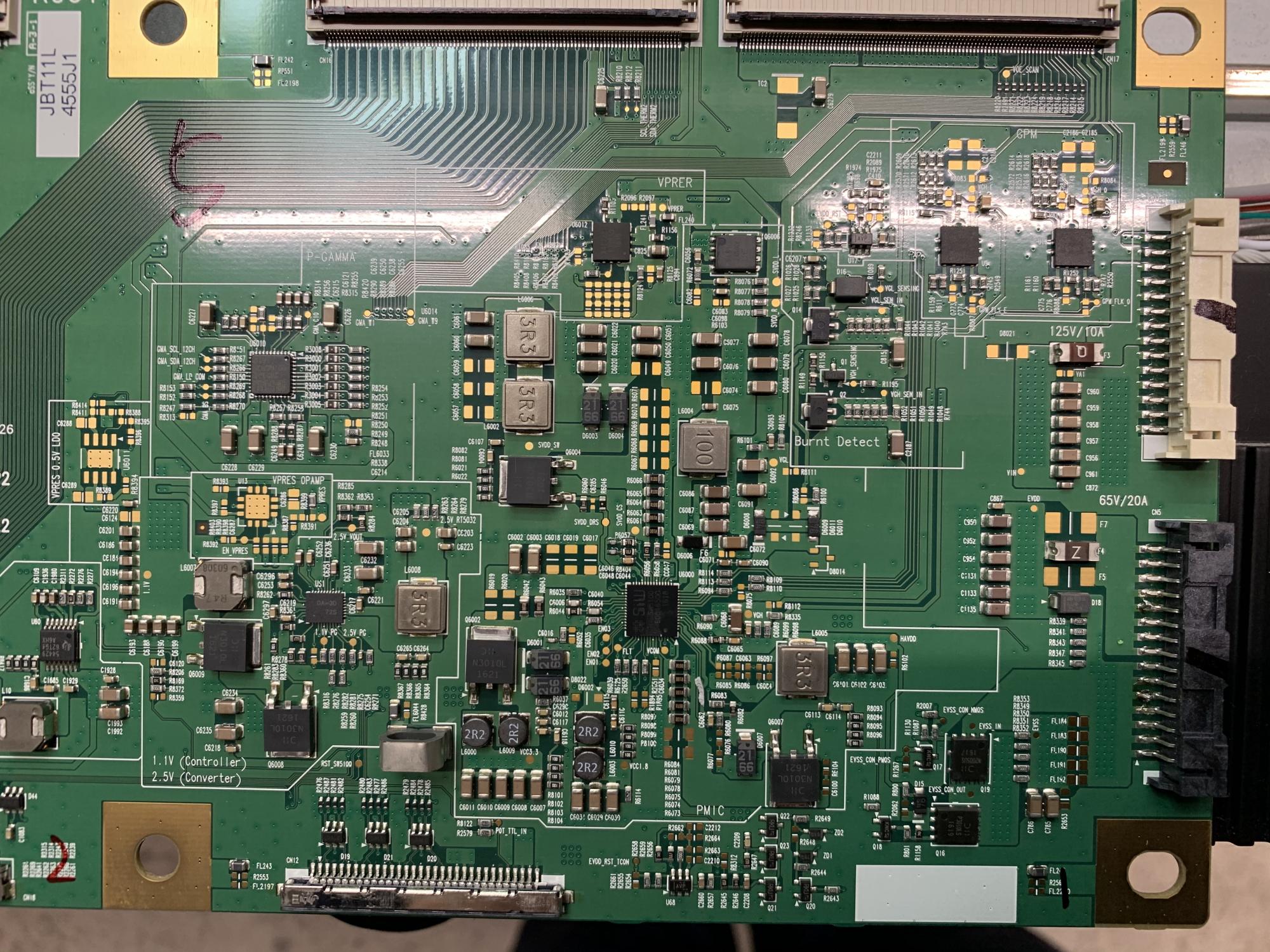

                            So, the T-con in high resolution.
                            The red circled area is that point of the connector what has to receive 12V according to service manual.

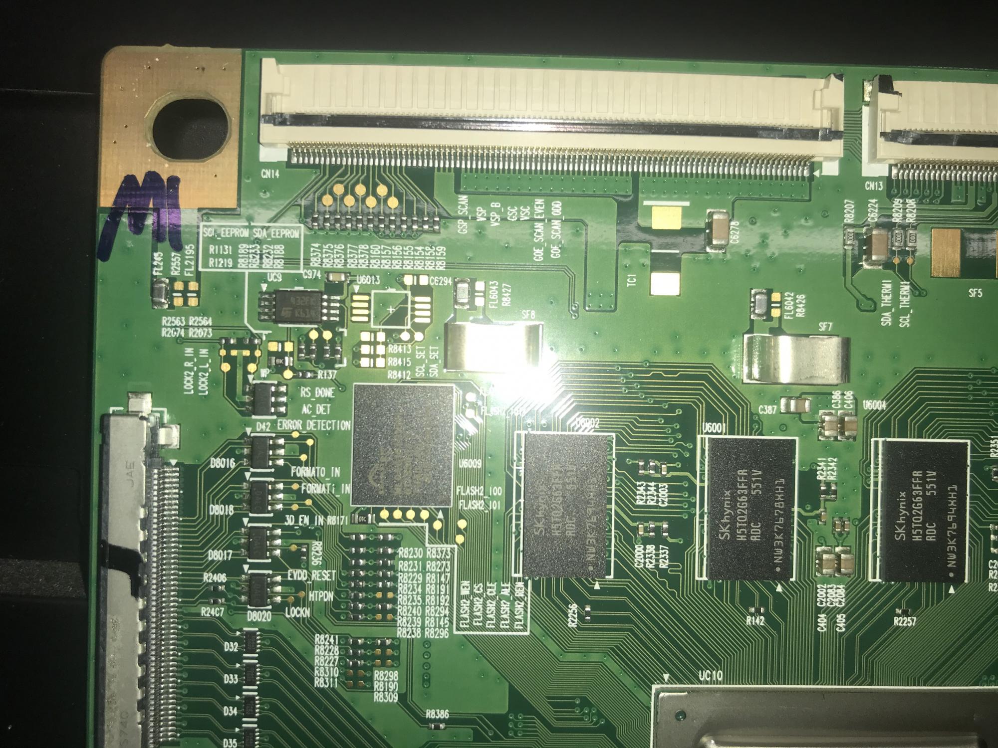

                              i think all 12v pins are out of the circuit.. you can test them with ohm against GND of boards
                              could you read the eeprom ic No ?
                              • Beeldbuisje
                                • Jul 2020
                                • 57
                                • Belgium
                                #35
                                Re: Burn in on OLED screens, is it (partially) solvable
                                Indeed, those 12V pins are “open loop” to GND.
                                What do you mean with “read” eeprom? The part number, or read it out with software?
                                • Diah
                                  • Feb 2013
                                  • 6355
                                  #36
                                  no, just want to know the chip IC the no. printed on it.
