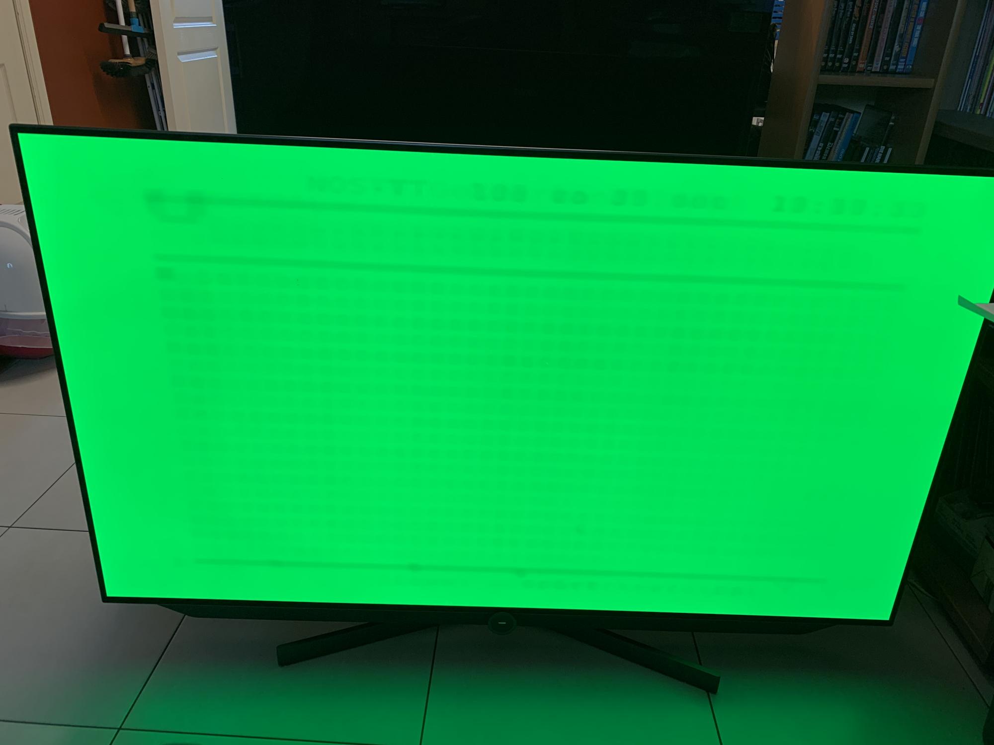

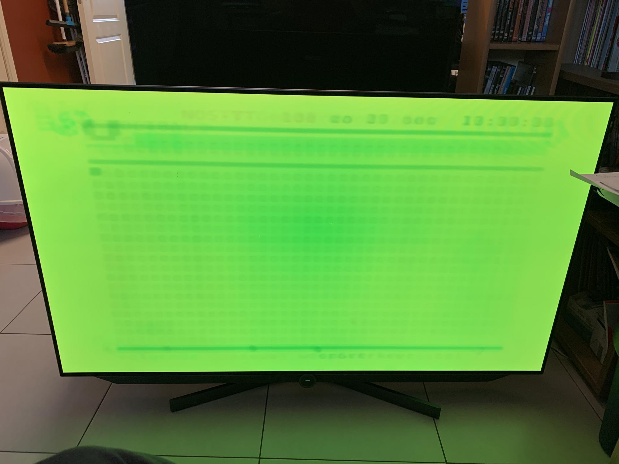

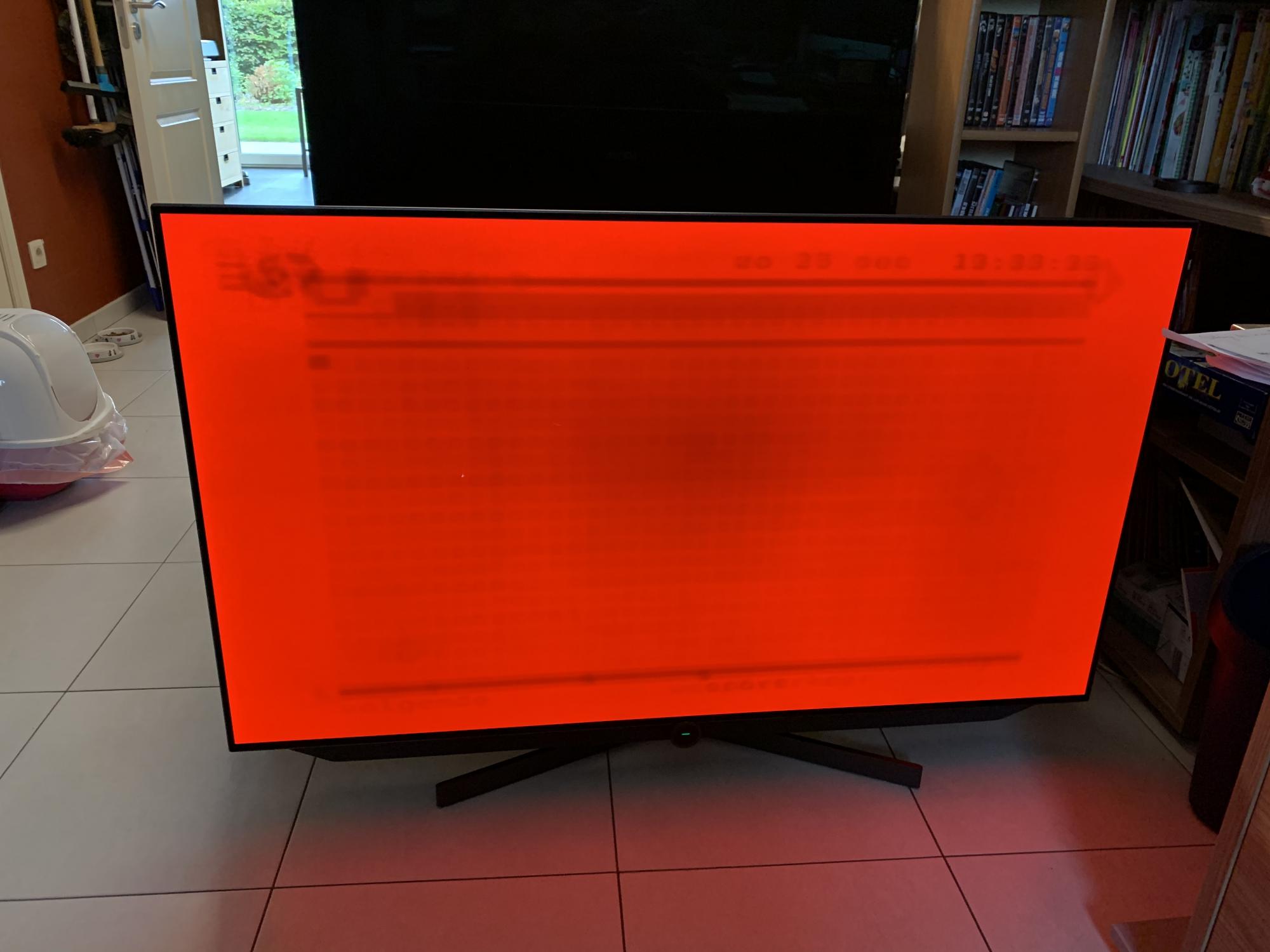

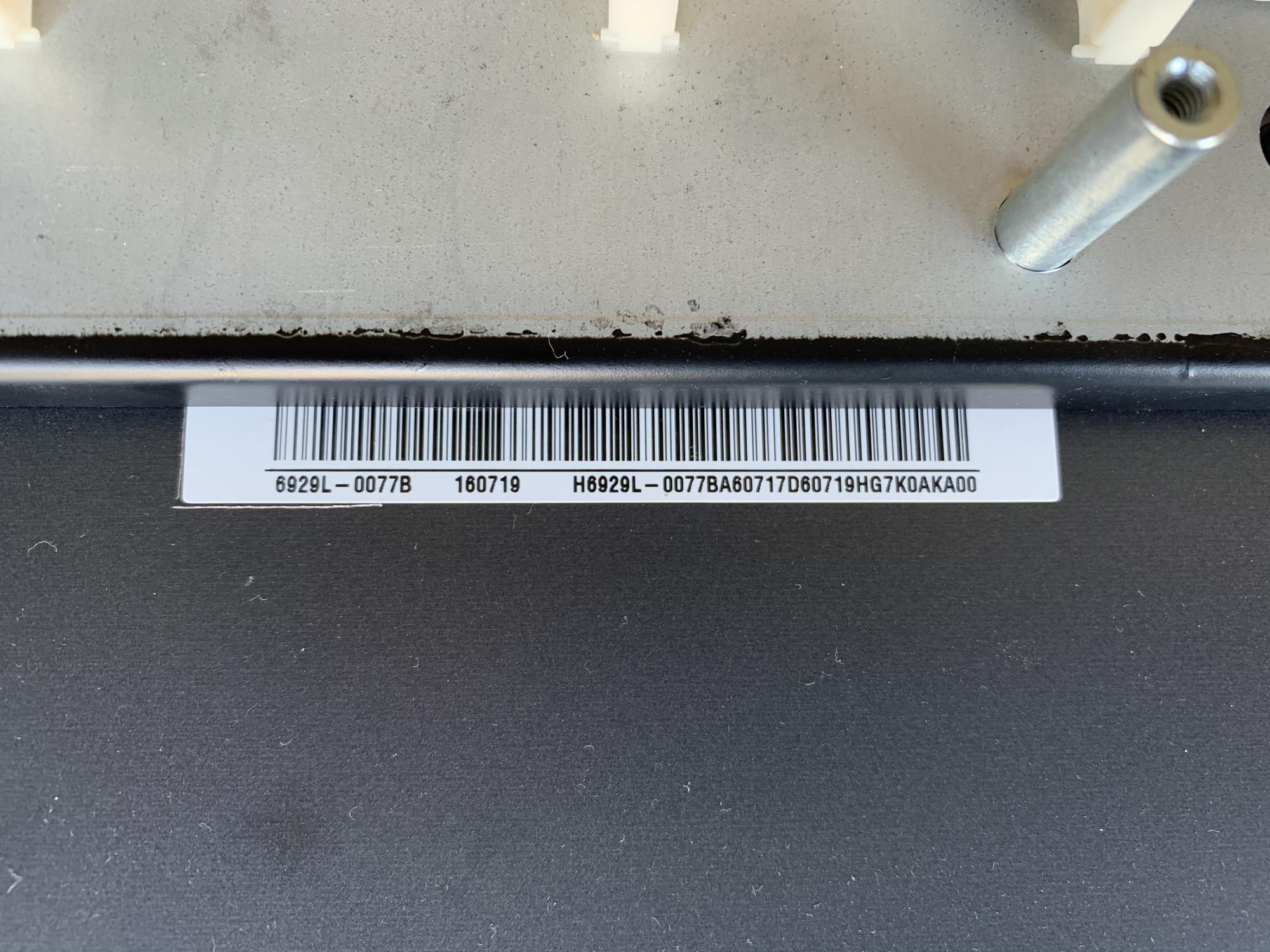

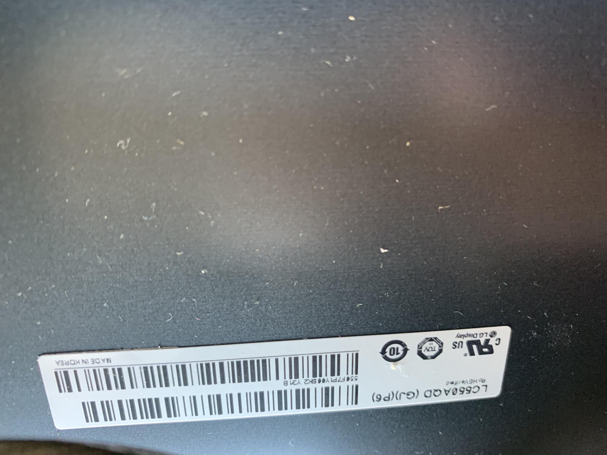

    A few days ago I picked up a Loewe Bild 7.55 OLED tv with a heavily burnt in screen. The owner watched every day several hours on Teletext.
    Because I own a newly bought Bild 5.65, the Bild 7 could be useful for spare-parts, but I also like to create some new experience with OLED.
    If the RS & JB compensation cycle doesn't solve anything, are there still possibilities to remove this "ghost" pictures?

    could you show us the T-CON driver boards with out the metal shield and which brand of OLED module .
    most of cases the T-CON driver boards didn't refresh and reset the module. on LG we did solve it by T-CON firmware downgrade and upgrade again..

        Re: Burn in on OLED screens, is it (partially) solvable
        https://www.badcaps.net/forum/images...attach/jpg.gif

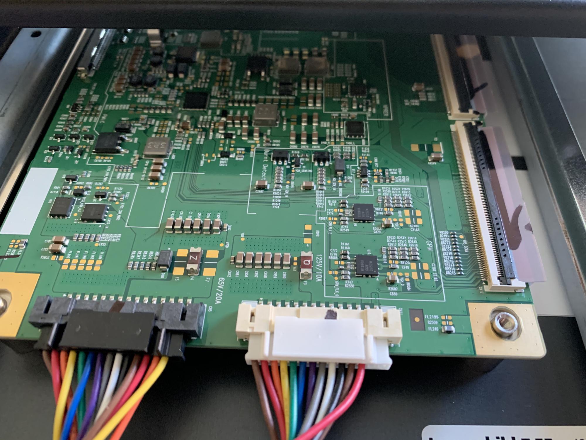

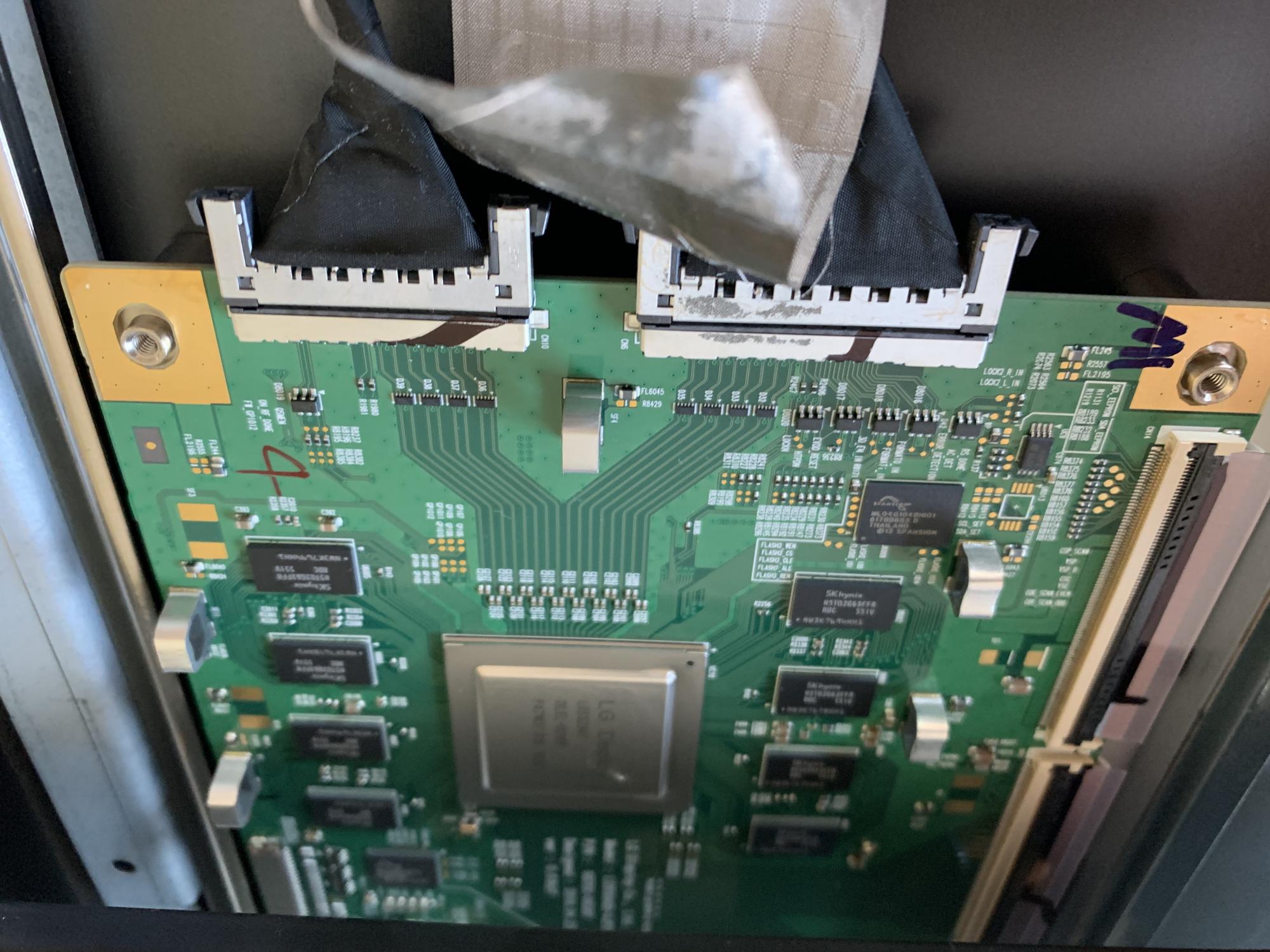

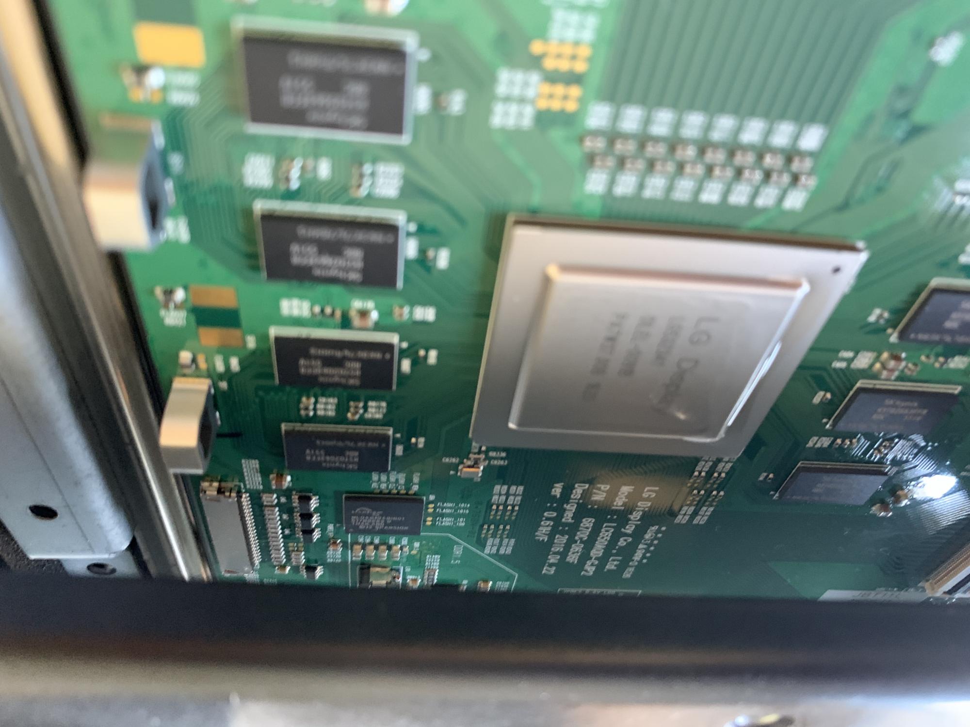

        So, I provided the requested data.
        I had do made several photos of the T-Con, because Loewe decided to add a lift mechanism on the screen.
        It should be possible to see what kind of T-Con is used.
        If zoomed, the part numbers are also visible.

          so the module and the t-con driver from LG
          look at my post over here ( ribbon cable photo )... and please compare one end of ribbon cable if they have 2 wide pins from left and right.
          if you disconnected the white socket ( 12 volts feed ) from T-CON driver and power boards... the set will remain working and at every start there will be horizontal line show on screen moving from top to down... ( scan and refresh pixel ) if you do it just keep the set on for 5 minute... then unplug it from wall socket... leave it 5 minute out from wall socket ( discharging ) and repeat to plug it in wall socket with out feed 12 volts to t-con.
          do it for 3 time are enough. and please don't use the remote control at all... just plug in and out from wall socket..... after the third time.. leave it discharge and plug in back the white socket and test your picture.
