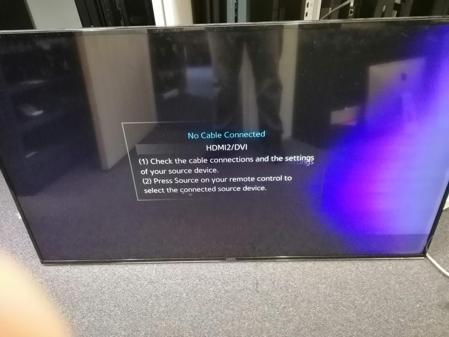

    I have a Samsung UA55HU7000. Part of the screen becomes distorted after few minutes of turning on (see attached image). Will this be solved by replacing the T-Con. We have already ordered one from China. T-Con cables were cleaned using an eraser.

    Looks like a damaged panel. Tcon won't fix it. You can try ripping off the side tabs on the bad side if it has them. Nothing to loose.

      Panel issue, I also see double images of 'setting'.

        good luck with the new t-con... lets us know please
