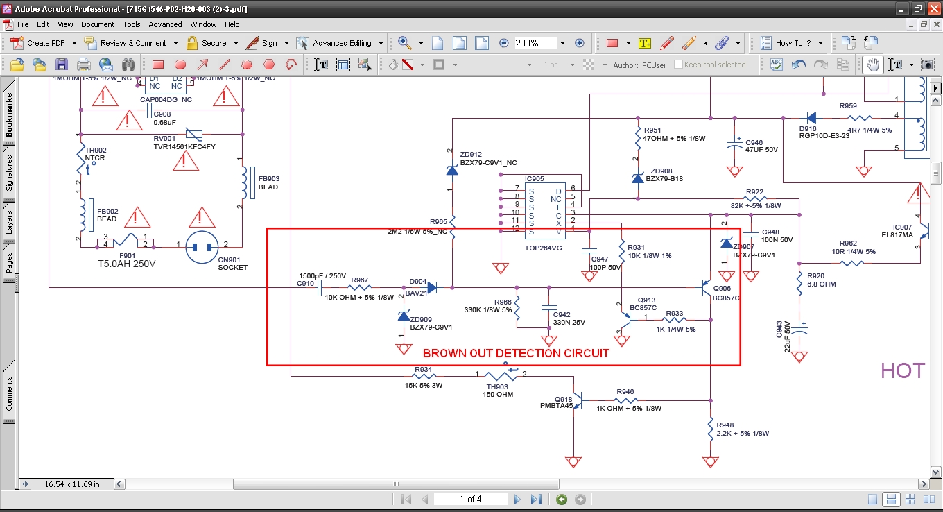

Re: Philips 47PFL4606 No Power Fuse Keeps Blowing
With 20K resistor, it went up to 382V which is good enough for testing but I do not see why it drops off as if the circuit is turned off after that, It should have stay up. 19K will probably bring it up to 395V.
I think it is related to 9.9V power supply.
