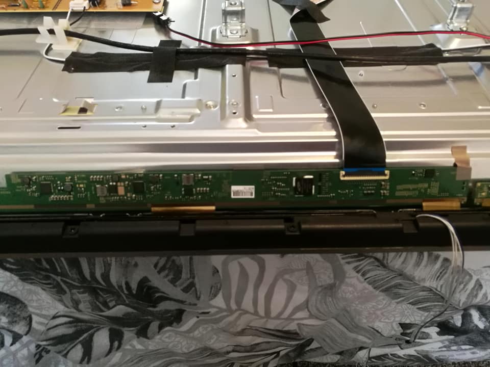

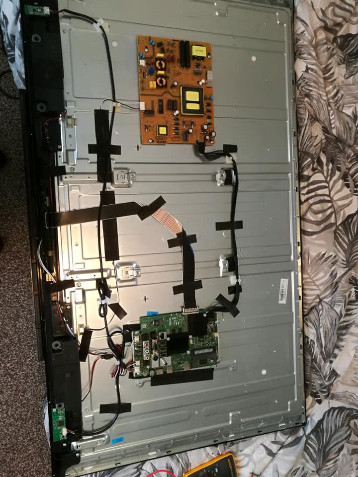

    6 month old faulty already i got this this tv second hand its shown no picture bud sound the back lights works perfect, all lit up just no immage on screen done some checks on on panel .12v and 3.3 there , previus owner was told to sent it back at cost £80 quid was told its common fault ,i have no intention doing that rather hopfully fix it

    You'll need to check for 12v on each side of the built in tcon board.

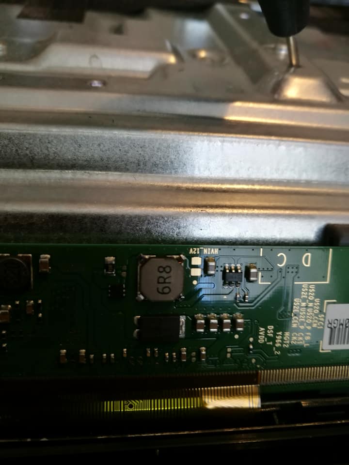

      Take better photos of that board.
      Look for avdd test point should be around 15v

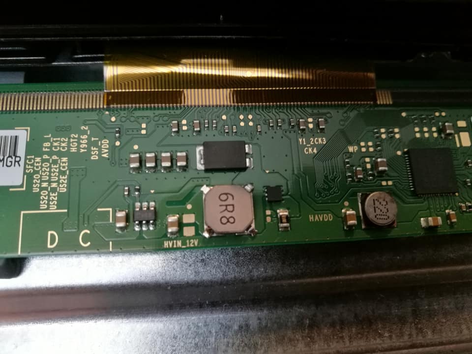

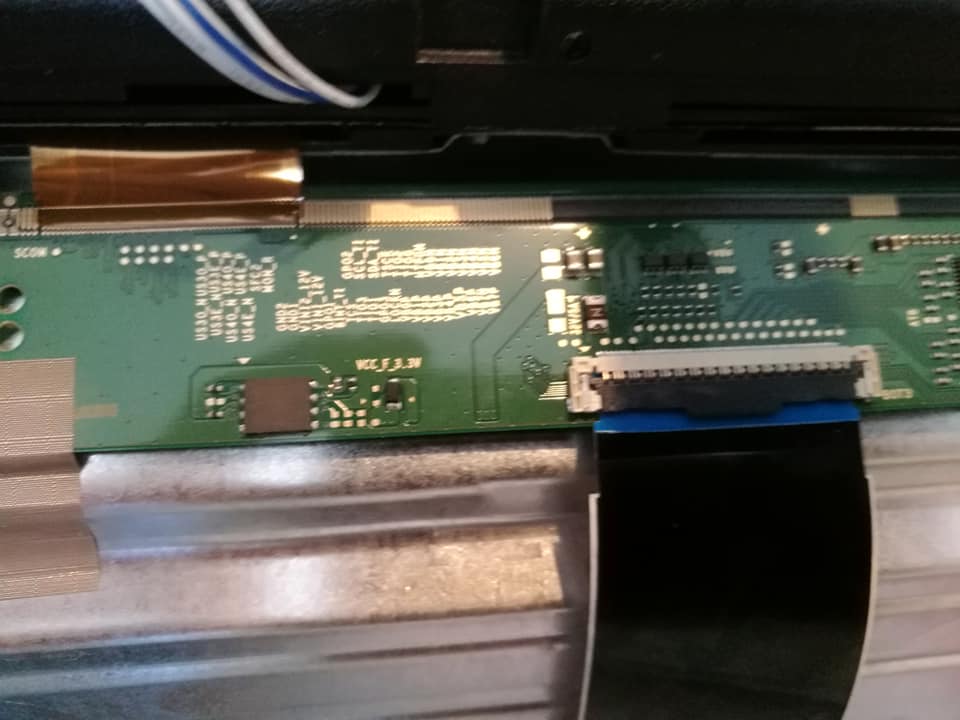

          more photos ,ok i am getting 1.8v at avdd
            Re: toshiba 49ul5a63db 6month old
            So are you getting 12V at the HVIN_12V test point?
            Only 1.8V at AVDD is bad for sure.

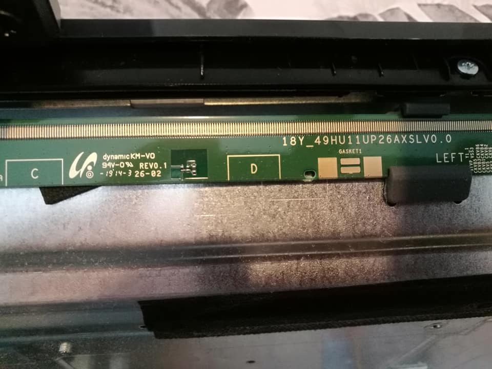

              such crap set i take it the tcon is built into panel ? dont quick check for shorts all seems ok, i have noticed the samsung ic is getting hot not sure if thats correct,

                Yet again a possible set with a shorted ceramic cap on the integrated Tcon/panel board.

                  Do as Mr Barton says; check and double check every ceramic cap.

                            So are you getting 12V to the T-CON? iN YOU POST #1 it shows "done some checks on on panel .12v and 3.3 there" Is that 0.12V or 12V?
                            Also are you sure you are making good contact with t he cap's end when checking resistance of the cap? I just want to make it is not like this thread with false readings until OP got new meter with better probes and then found the bad cap: https://www.badcaps.net/forum/showth...131#post970131
