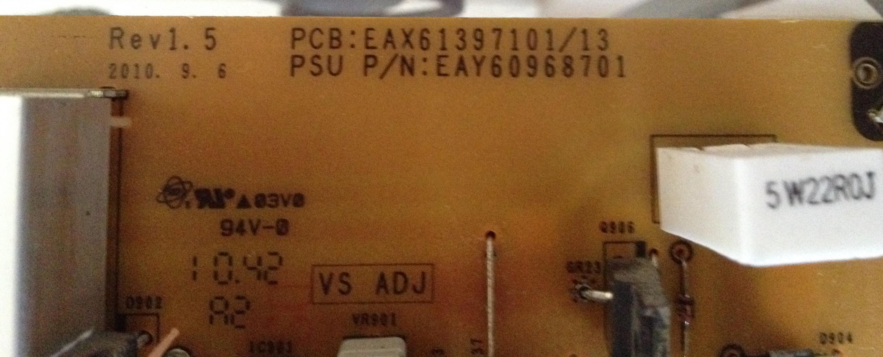

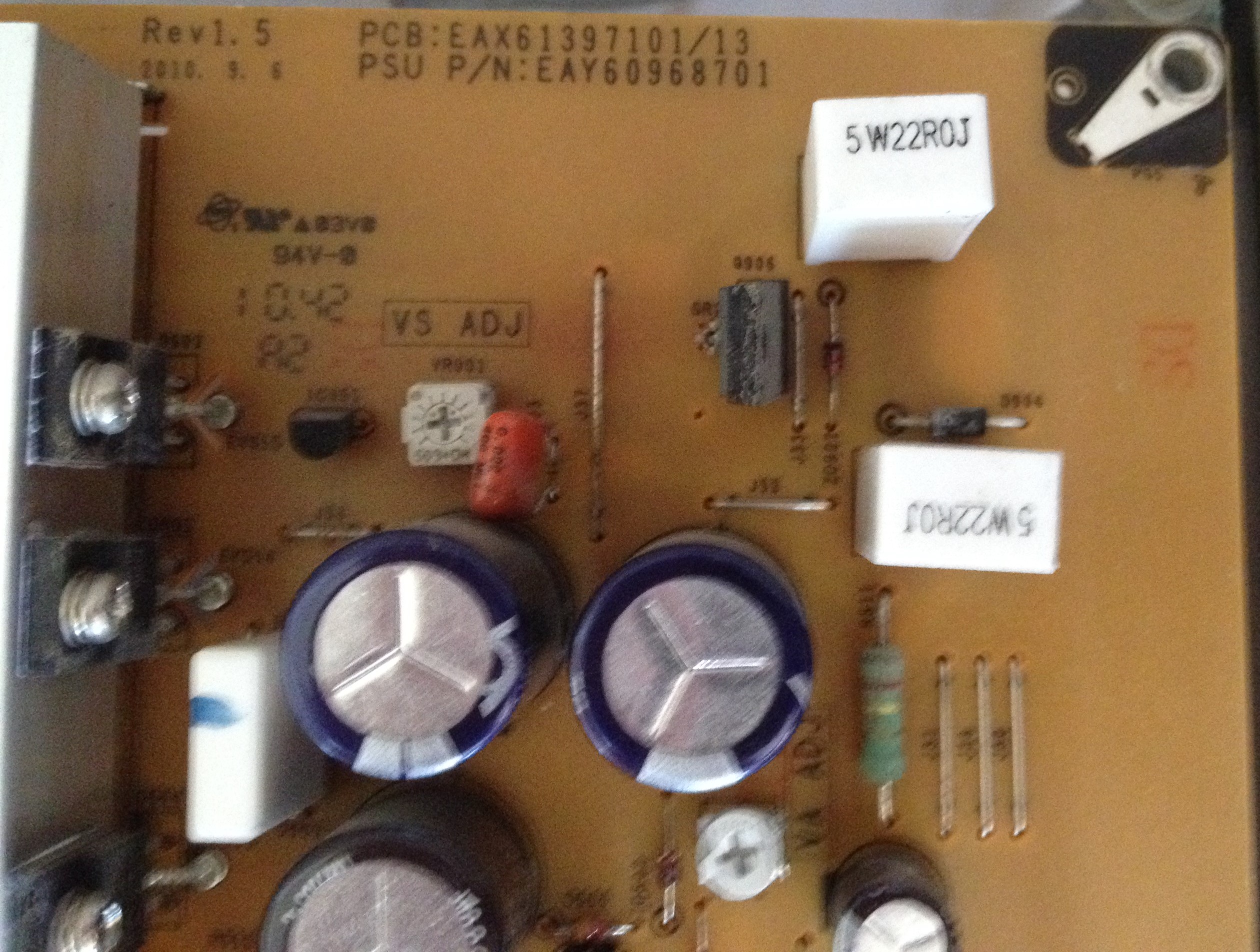

          Post a picture of your power supply. These tvs are prone to the 10 ohm 5 watt resistors going open. Some have 3 and others have 2.
          • Tycoon
            • Jun 2020
            • 5
            Re: LG 50PJ550 clicking/not staying on
            Thanks for the suggestions. I will post a picture of the power supply board shortly. It is the one with the 2 resistors in the upper right (5W22ROJ, Resistors R927 and R929). I tested them and they appear to be fine (22Ohms). I was doing some testing last night and may have a short on the ZSUS board if that makes sense for the symptoms I am having.

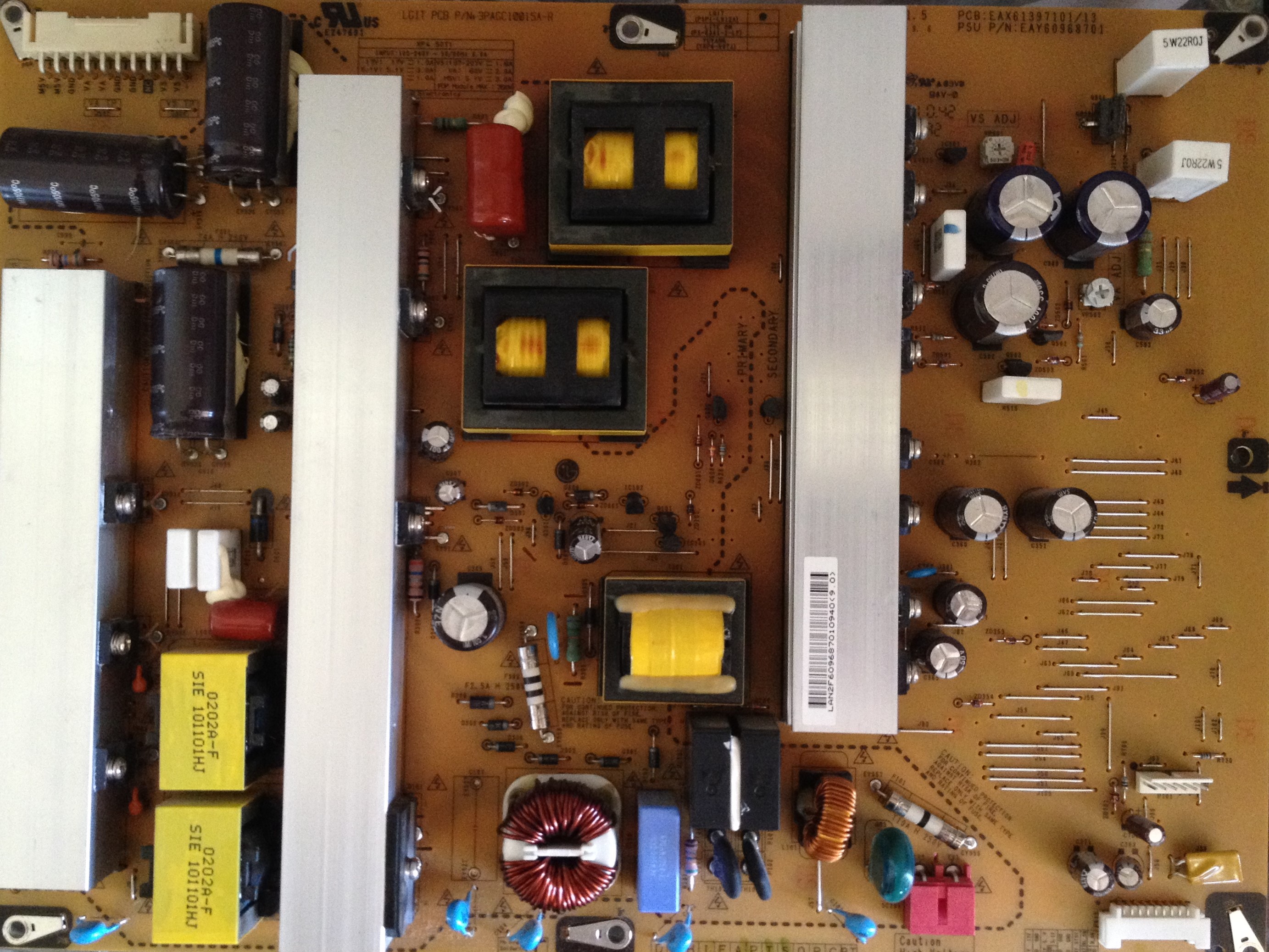

              It is a common problem with this power supply. There are many components which may fail or go faulty that can cause this issue. However its easy to test this power supply because with all connectors removed accept the power connector it should start up with all voltages being present so a good power board with just the power connector connected should when powered up click once with all voltages present. Obviously if tested this way and power supply clicks on closely followed by a futher click which is the power supply switching back off a fault on your power board will be the issue. If tested this way and your power board starts with just the one click it will be a short on either Ysus or the Xsus thats the cause of your power supply to shut down when connected.
              I would say however that in my experience the Xsus rarely fails far more often the Ysus being at fault.

                Sorry it ended up being a busy weekend and I didn't get a chance to work on it. I tested the power supply as mentioned (disconnecting cables) and it stays powered on without the YSUS/ZSUS boards connected and the voltages match the service manual. I am testing the YSUS/ZSUS boards now. Thank you for the suggestion on the YSUS board failing more often. It does look like I have a short on the ZSUS with Q20 going to ground. I have attached images of the Power Supply and will update on the ZSUS as soon as I get replacement parts. Thanks!
