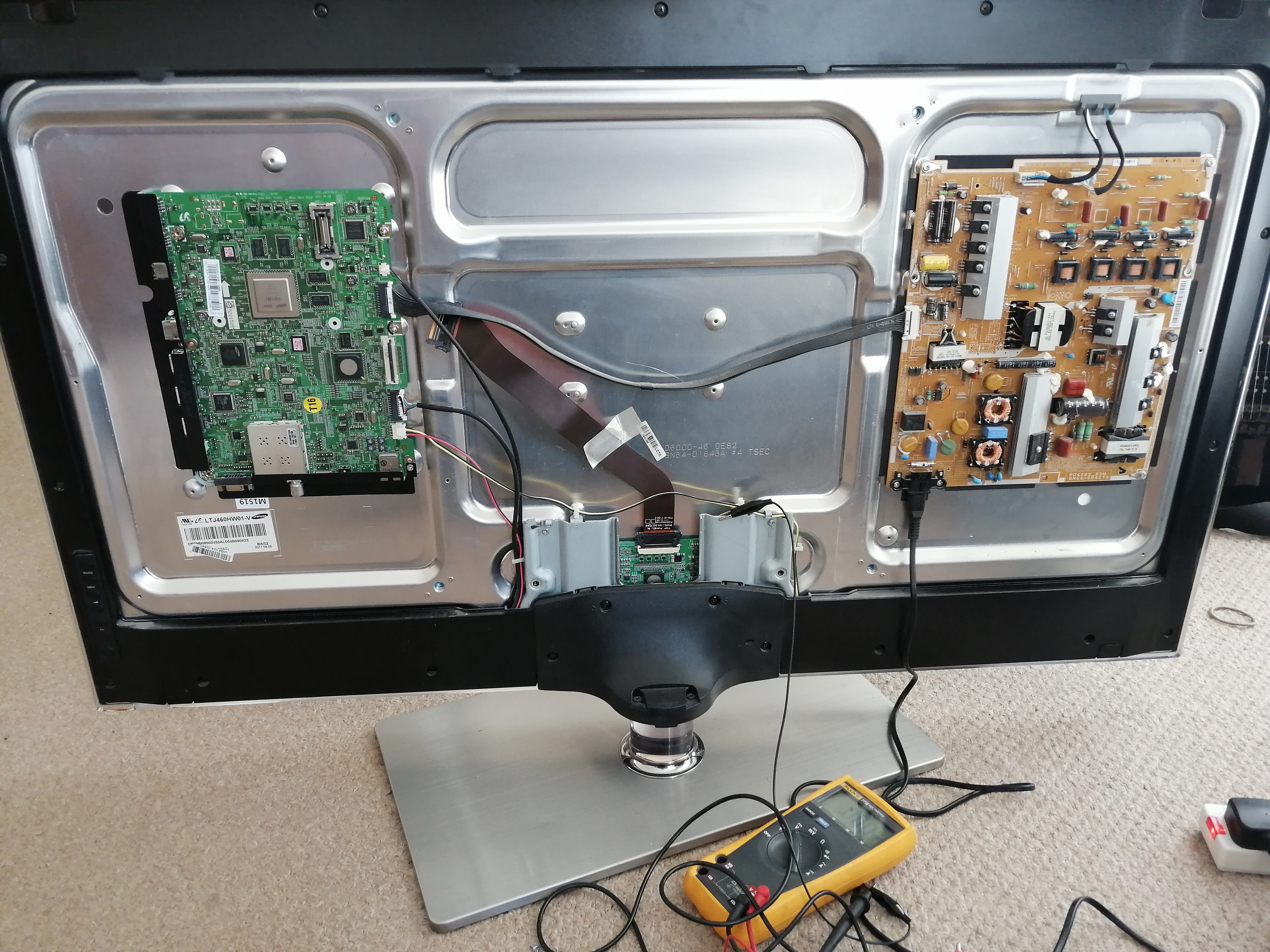

    I have been given a Samsung UE46D6530 TV to have a look at.

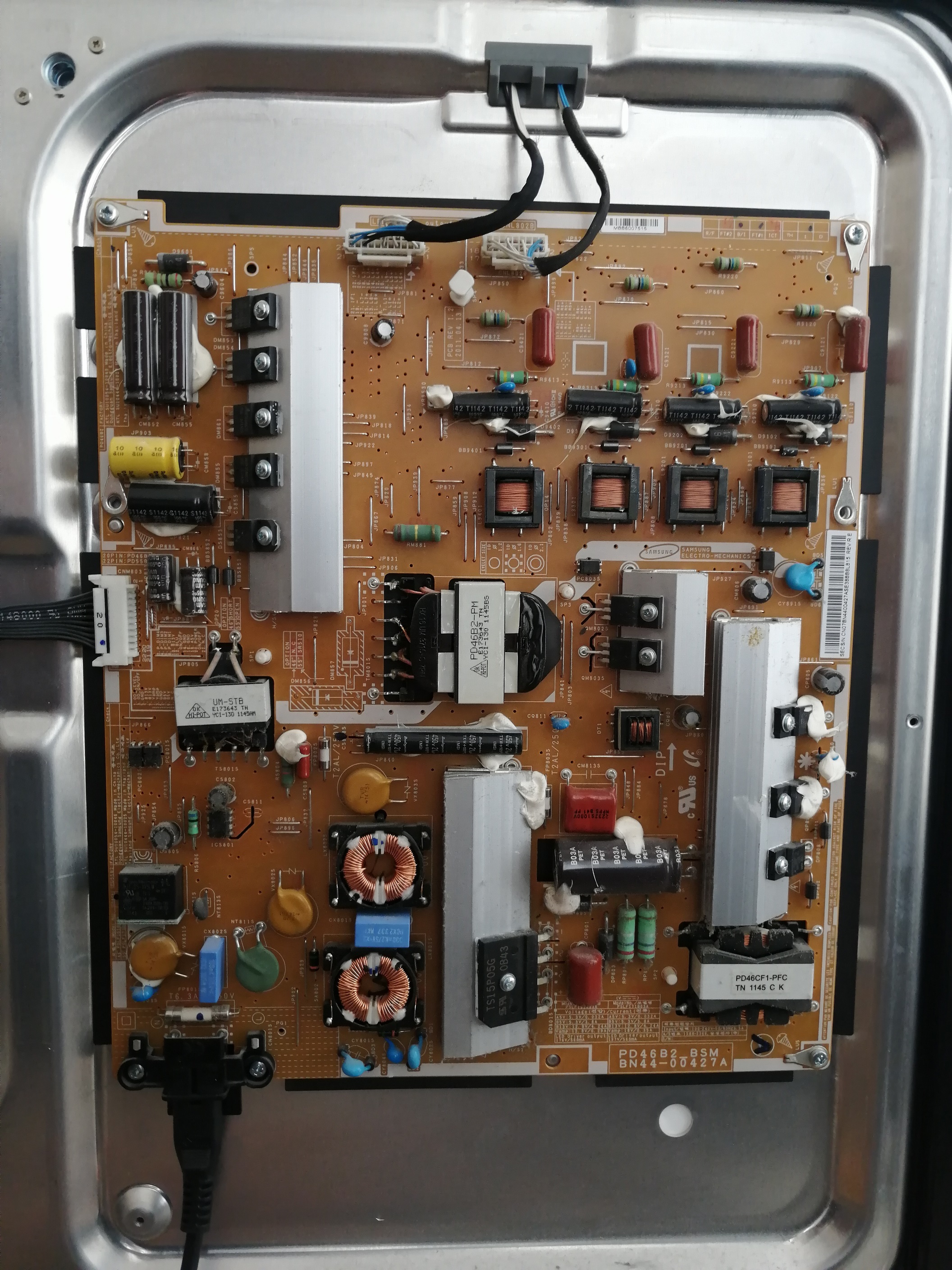

    If I press standby, power-board relay clicks, power led flashes then it switches off and attempts to power on again over and over (relay clicking)
    No backlight, no picture, no sound..
    If I unplug the 20 pin power cable to the main board back light works.

    Pin 20, when probed with the test meter turns the power supply on.
    Unplugging the T-con board makes no change.

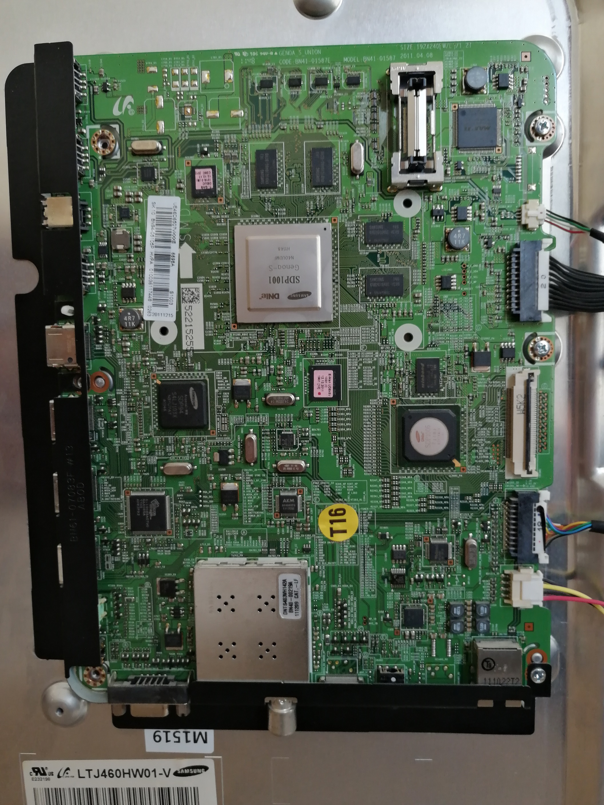

    Any ideas where I could be looking, I'm thinking main board but wonder if there's anything else I can try first ?

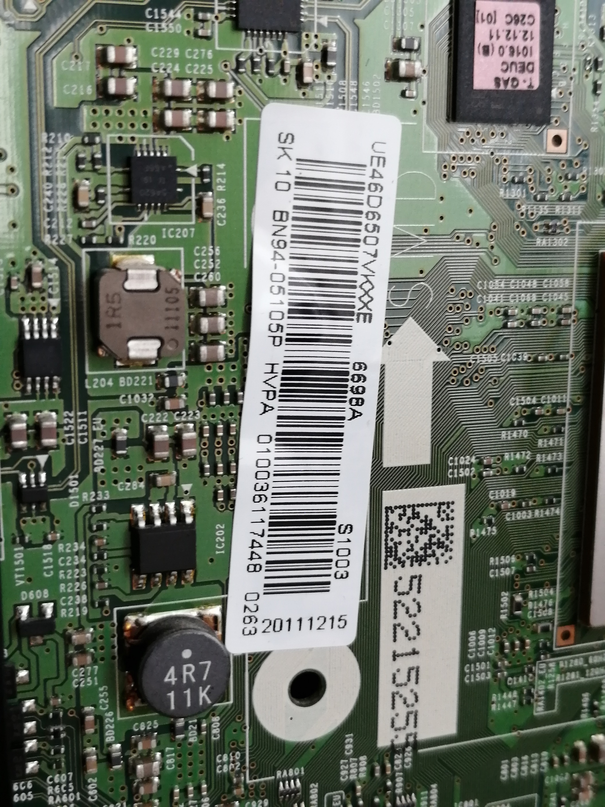

    P.s. This tv was repaired some years back, and possible a different model mainboard was used as I can't seem to match it to any other relevant UE46D6530... I could be wrong, so don' quote me on that

          Take the cable from powerboard to mainboard off, look it over see if you have any discoloration or burn looking marks around the terminals of cable, the plastic and such.

              Maybe try with one ribbon connected at a time between the tcon and the panel, see if you get a display of any kind, always have tv unplugged from power when removing or connecting ribbon cables, don't want to get any stray surges or anything, separate test see what tv does with lvds cable from mainboard to tcon unplugged.

                  Re: Samsung UE46D6530
                  You proved the backlights and powerboard by unplugging cable and getting backlights on steady, so the problem can be mainboard, tcon or panel or a connection or bad cable. The tests are to see if there's a change in function, I'd disconnect ribbon cables from tcon to panel, plug power cord in see if change, no change then unplug lvds from mainboard to tcon, check for change, same rule applies(always do disconnect and reconnect with tv unplugged from power)
