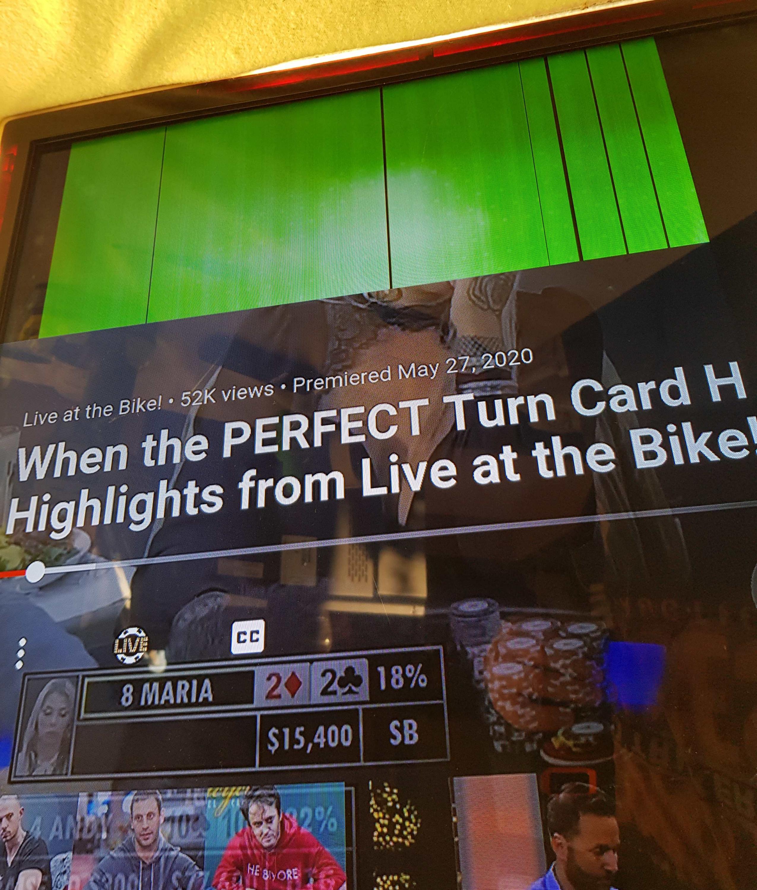

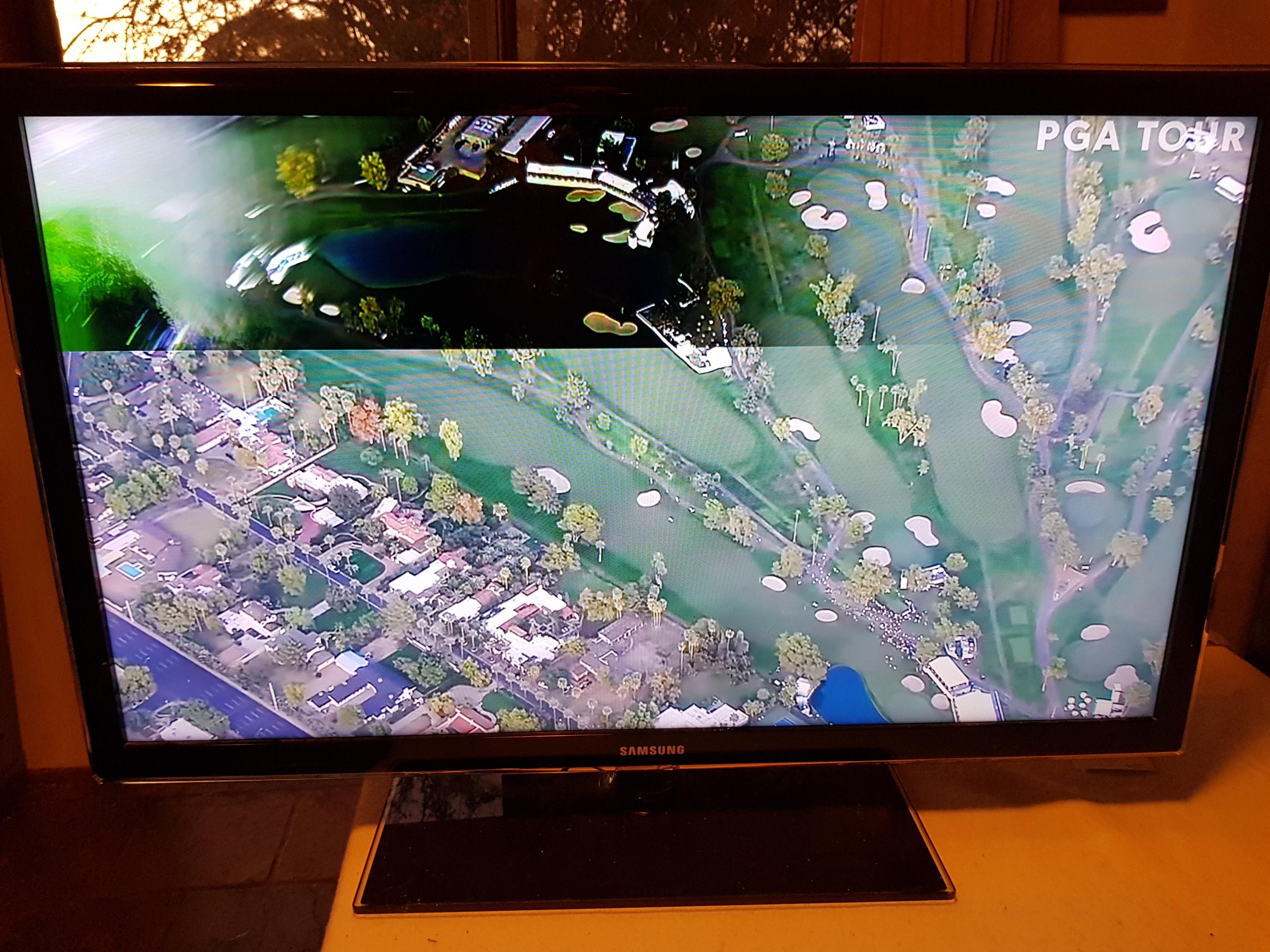

    Hi Guys
    I have a Samsung UA40D5500 that is showing the top third of the screen is darker, but still shows the picture (there is a definite line where it starts) and a bit ghostly.

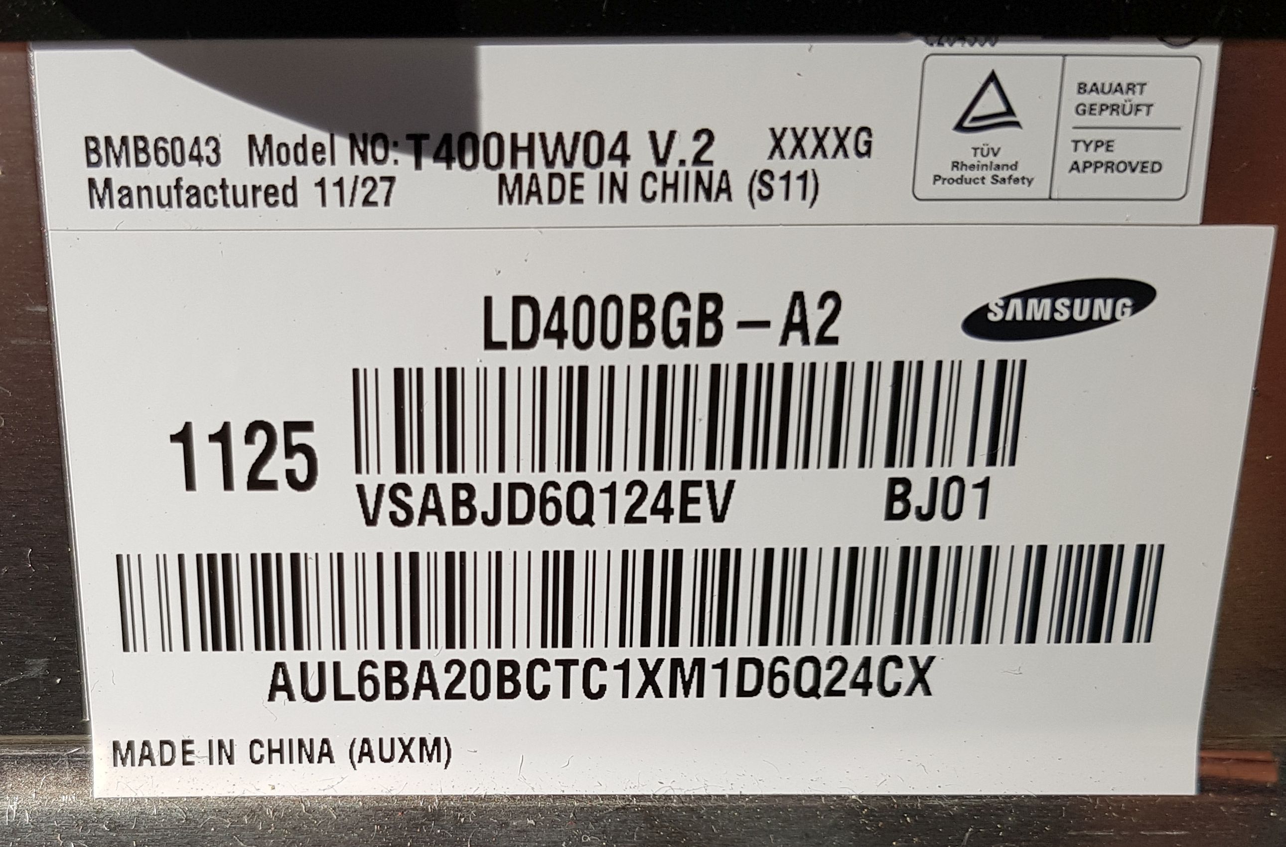

    It uses a samsung panel (ld400bgb-a2)

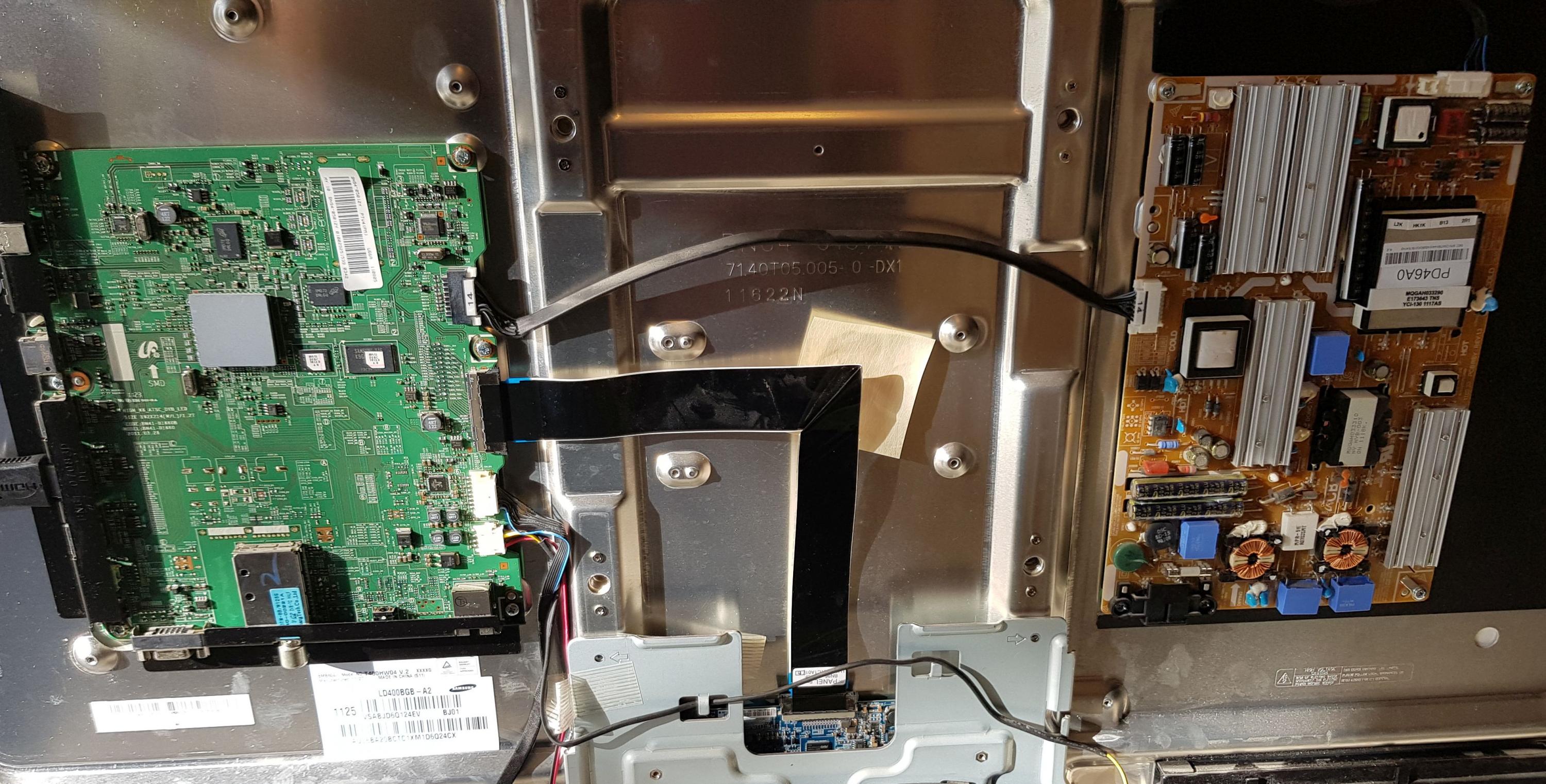

    I have attached some photos to attempt to show the issue etc and the back of the tv and the panel info.
    Sorry the quality of the pics isnt that great and no, the tv isnt really that red lol.
    I have searched for a solution and have seen a few posts about pulling off the tabs on the outer edges of the panel to fix a similar problem, but am wondering a few things:
    Would this fix my issue?
    would I need to remove the tabs at the top bottom or sides?
    If sides, how would I know which side?
    I dont think it is bad led's as the line is so definite and I can see they light up through the holes in the back of the unit (with the back cover off).
    Is it a matter of touching the tabs with the tv on to find the one that is causing the issue?
    Im being really cautious not to damage the screen before I find out what is wrong with it.

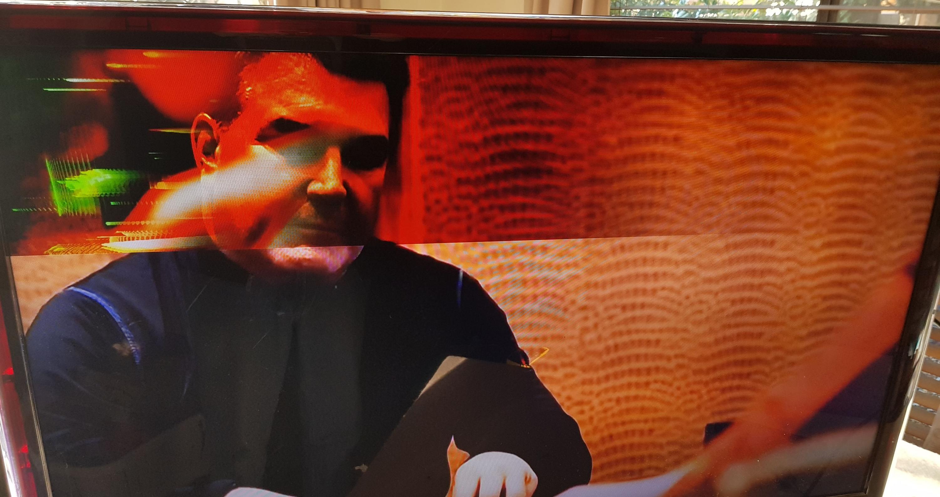

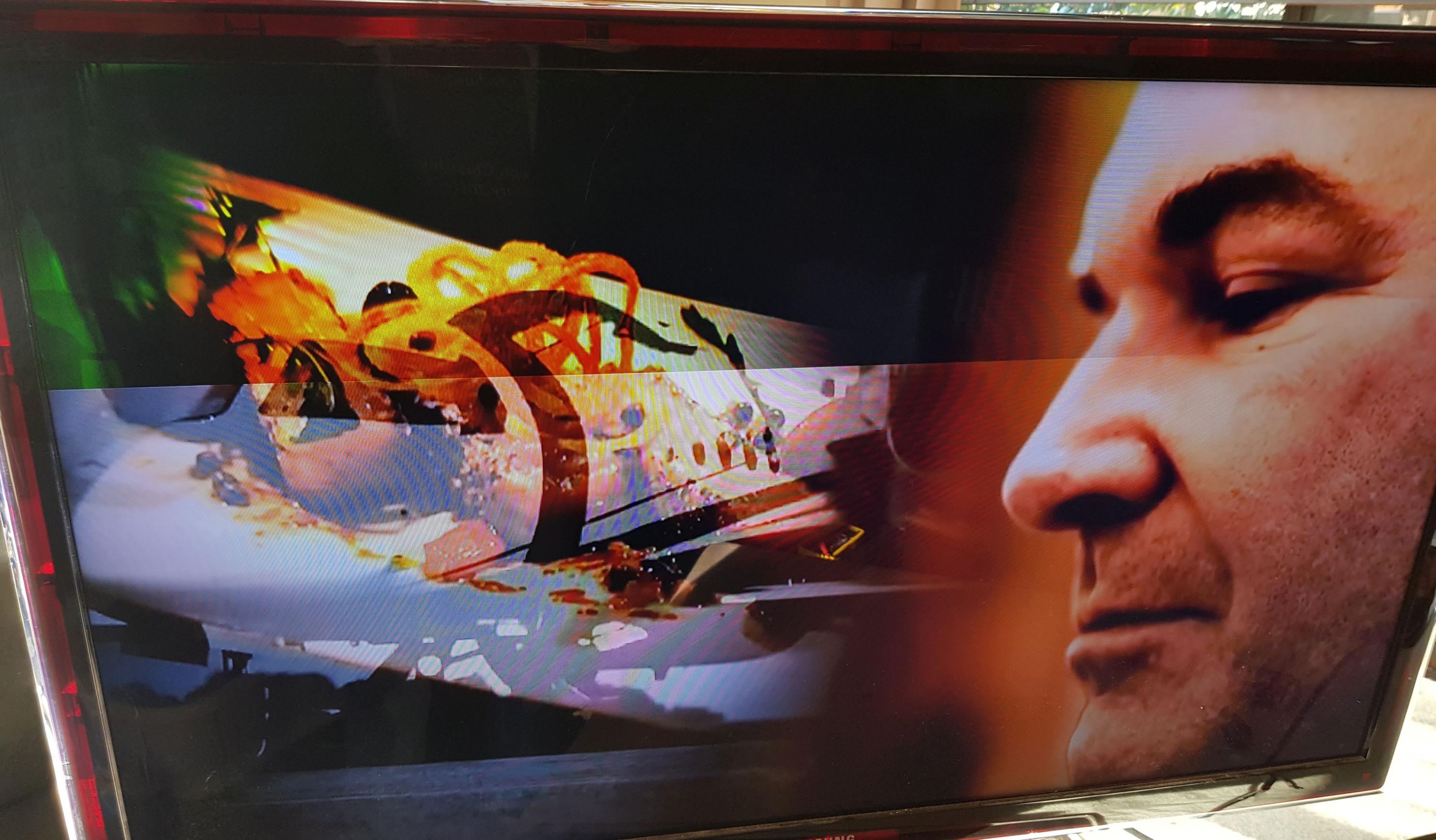

          I have tried the tv on with one or the other tcon connector cable.
          When I took the left hand side off the picture was ok except for the darkening line still at the top.
          When I took the right hand side off it looked like the photo attached. Not sure if the cable was in properly or not? I thought it was.
          As my issue is the top 3rd of the screen is darker than the rest I assume playing with the TCon connectors isnt going to help me?
          I did notice that the line seems to fade out on the right hand side, so I guess the bad tab(s) I would have to remove would be on the left hand side?

            I have taken the plastic shroud off the tv and just by running my finger down the side of the panel metal shroud I can get the picture to go normal, if only for a second or two them it goes back to dark area with line.
            Unfortunately, unlike a video I watched on doing this, the metal shroud around the panel is one piece so if I want to take it off one side I have to take it off all of it. Scary stuff
            Im assuming there are 3 tabs down the side of this panel and the top one is the bad one?
            I had to pack it up for today but this is what it looks like at the moment (pic attached)

              Re: Samsung UA40D5500 top 1/3 dark and ghostly
              This is looking like loose/bad tab bonds, which are usually "fixed" with call them shims, thinking tab removal probably won't work in this one.
