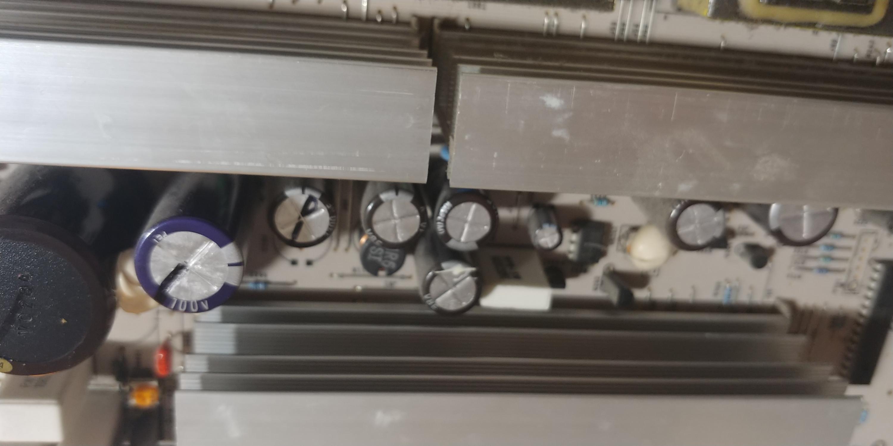

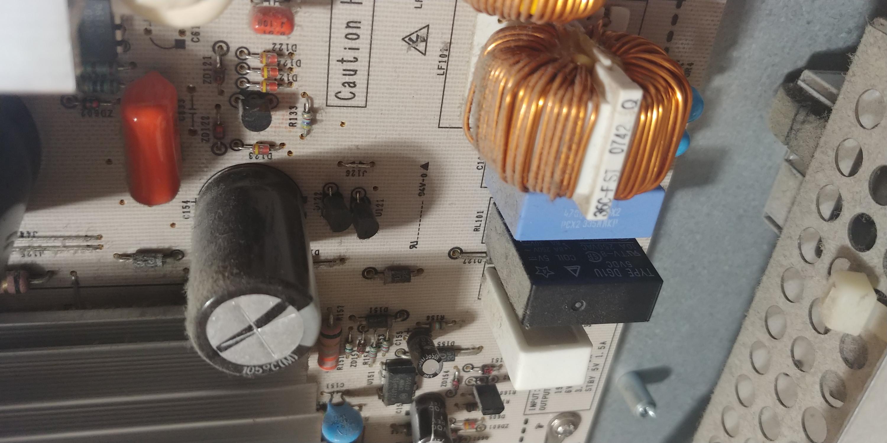

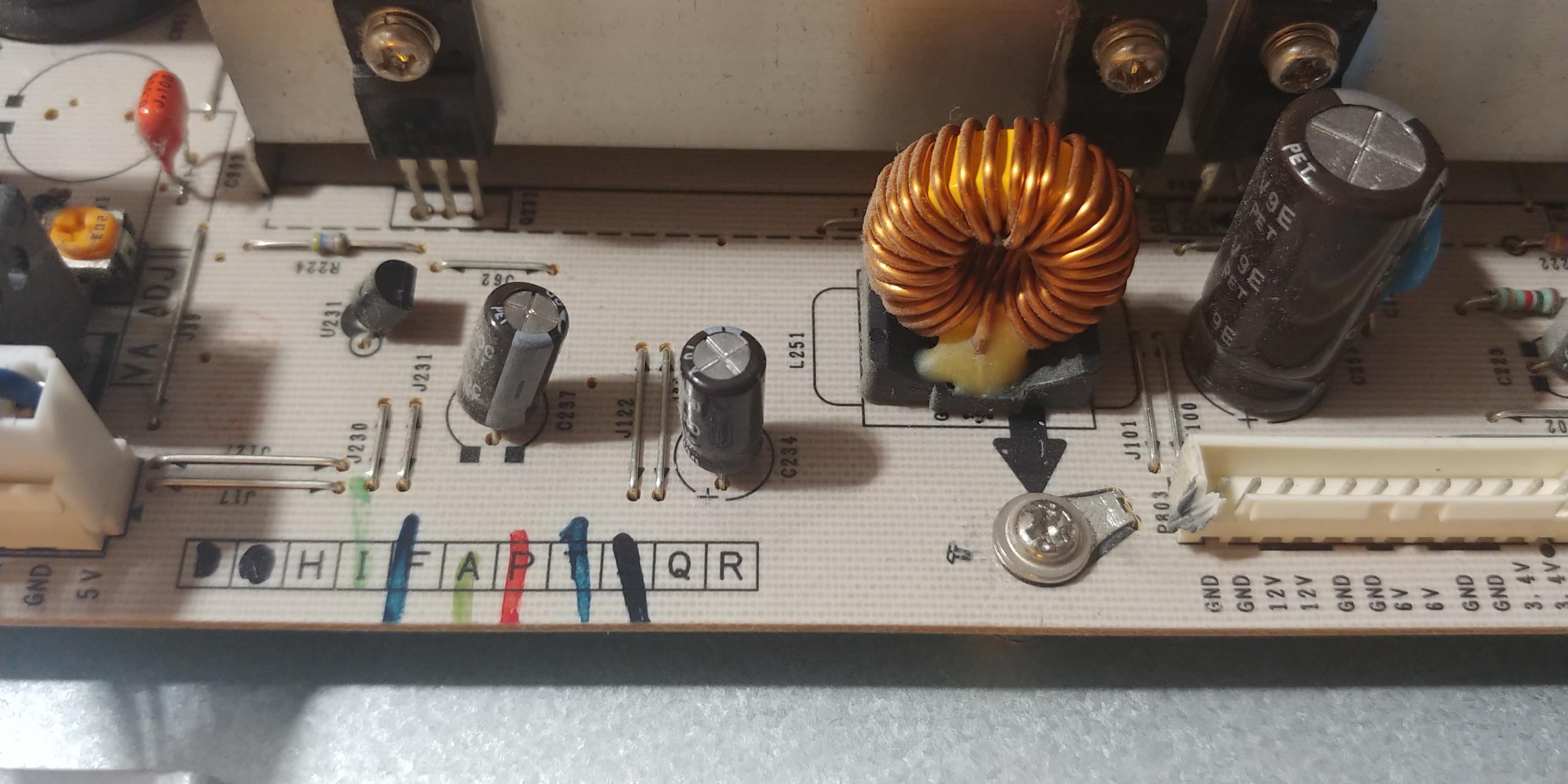

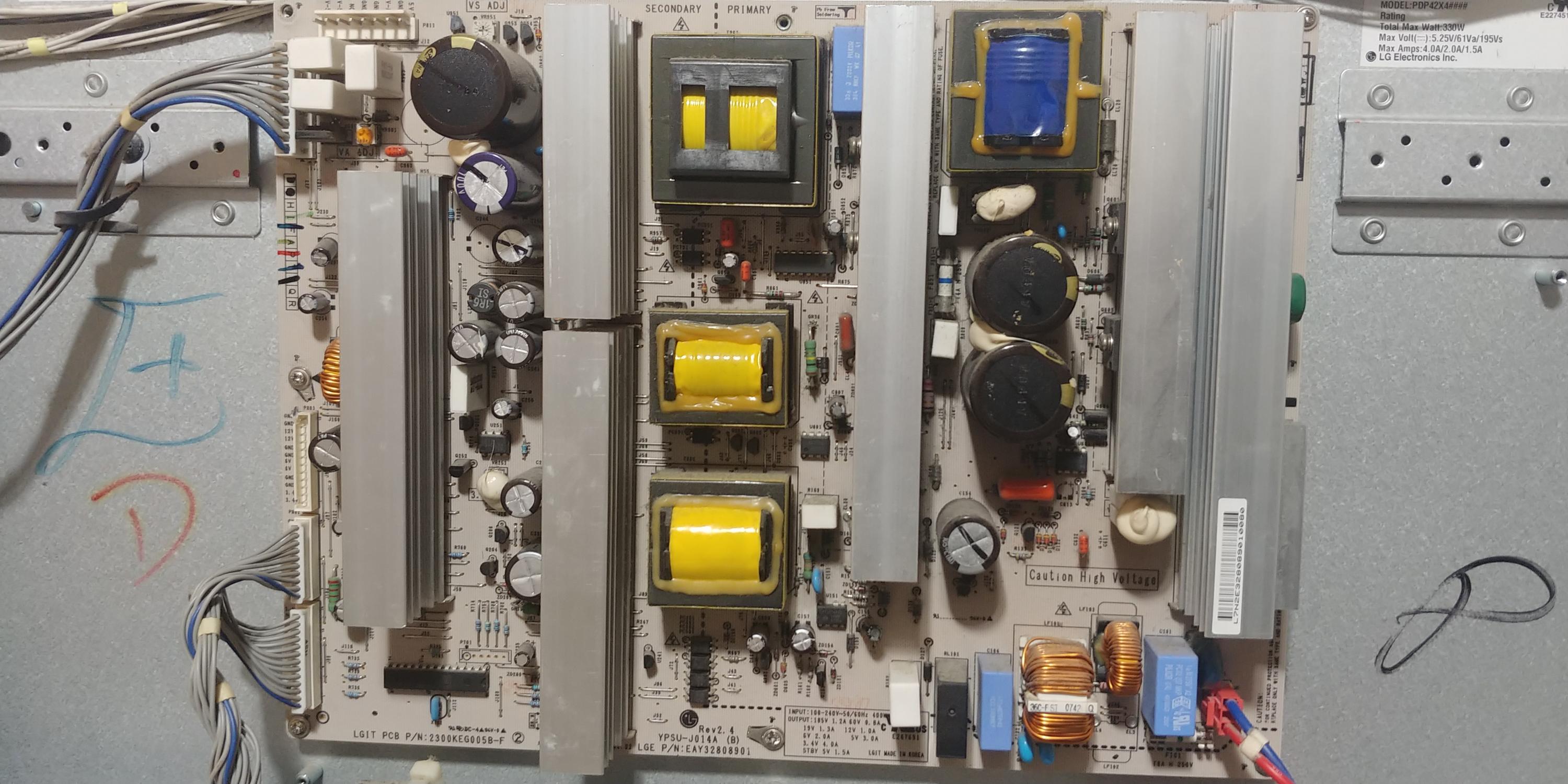

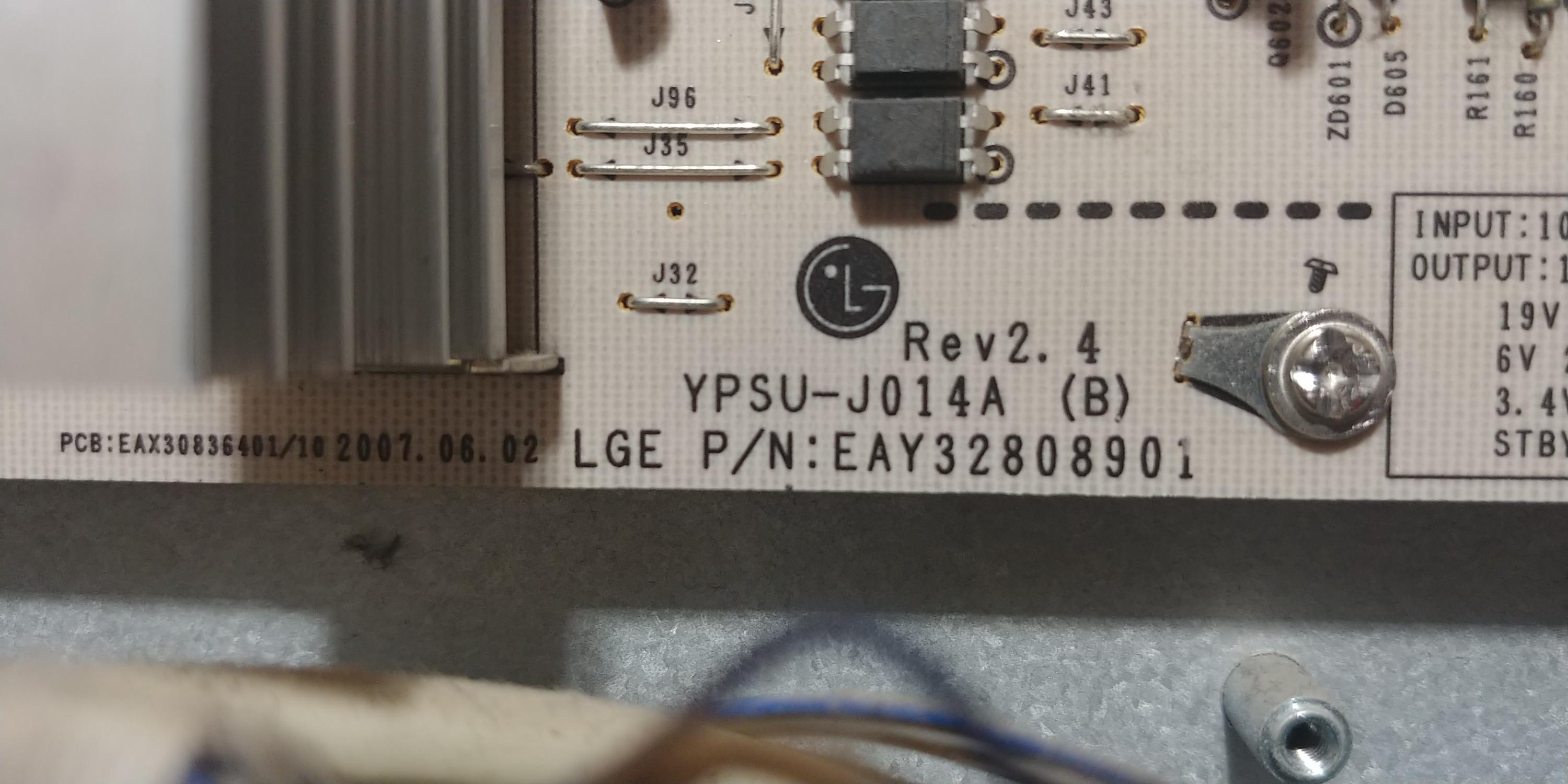

    It always help and is a good starter if you can post clear and well focused picture of your circuit boards along with any voltage testing you may have carried out on the power supply. Many reader will be unfamiliar with the set but knowing the circuit board part numbers along with any information gleamed from testing goes a long way towards a successful diagnosis.
    • tvtimmy
      • Mar 2015
      • 1160
      • usa
      Re: LG 42PC5D green light flashes three times and TV turns off.
      Probably bad capacitors on the power supply. Post clear pictures.
        Photos

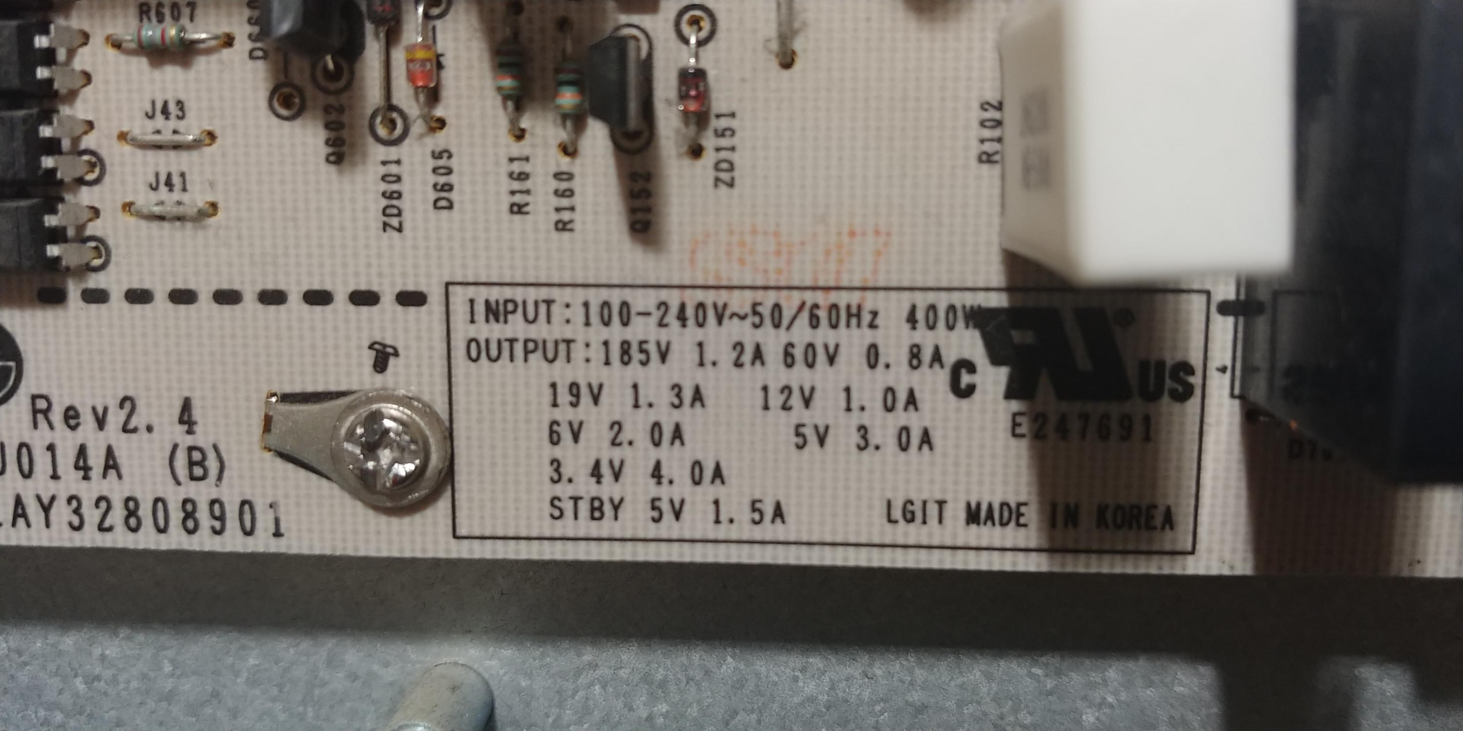

          Follow the guide as given in this thread
          https://www.badcaps.net/forum/showth...ghlight=42PC5D
          You could also check the power supply voltages are all there.
          Vs = 185V
          Va = 60V
          and the following
          19V, 12V, 6V, 5V, 3.4V, Stby 5V

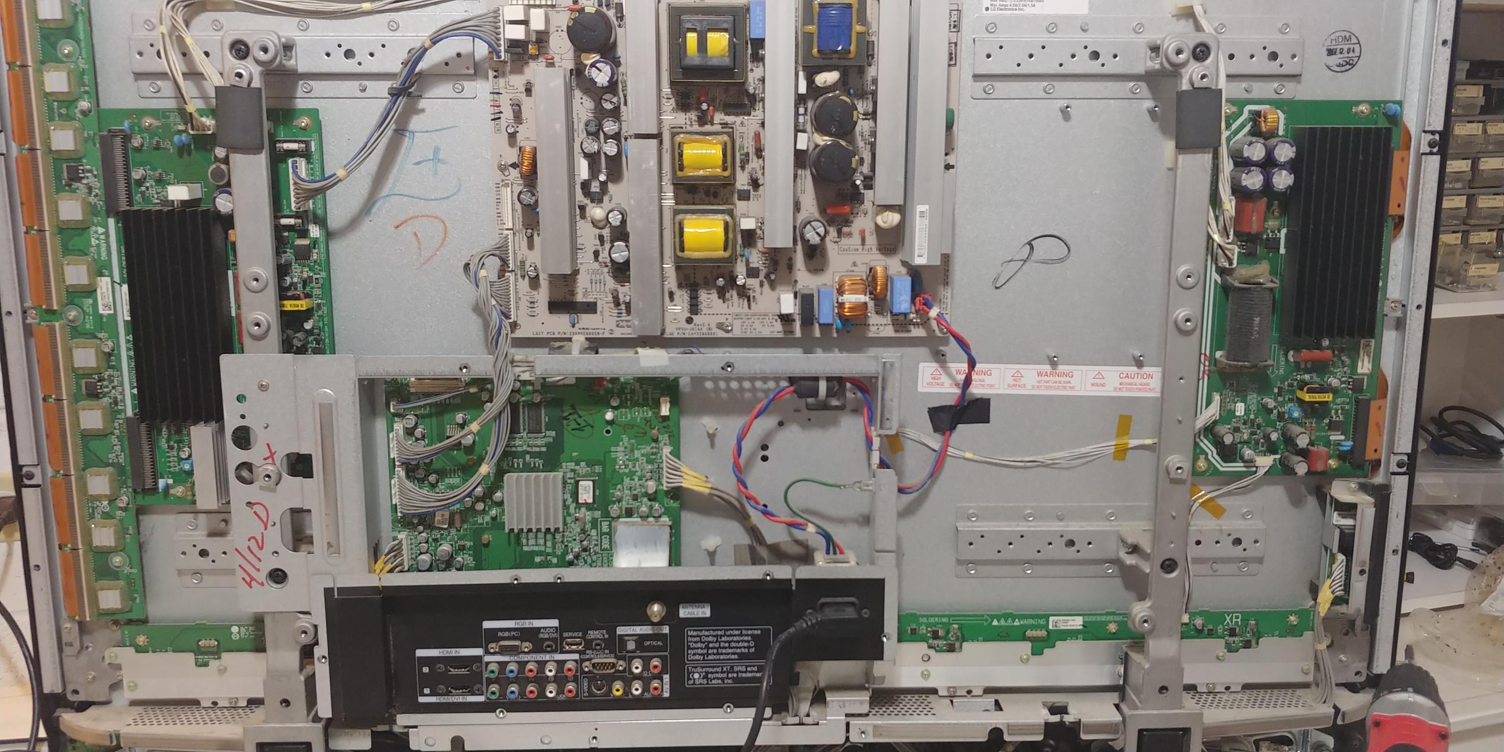

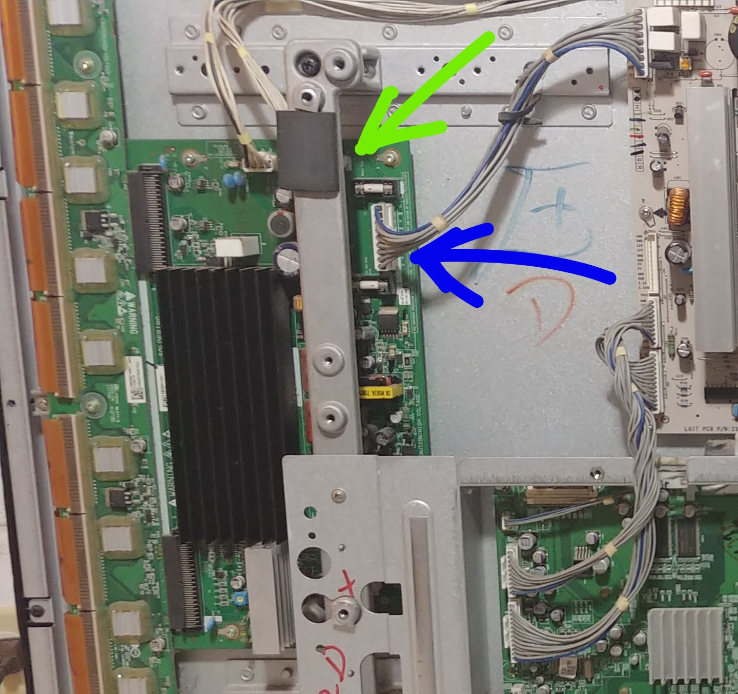

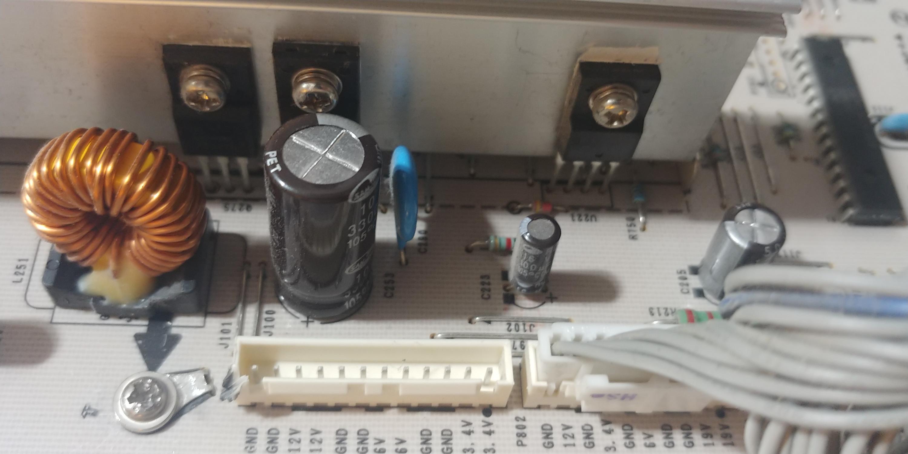

                Okay I may have measured wrong before.
                The connector identified by the blue arrow connects the y-board to the power supply board.
                The connector identified by the yellow arrow connects the y-board to the z-board.
                The measurements were taken from the pins at the blue arrow, with the wires unplugged.
                However when I unplug both blue and yellow connectors, I instead get:
                1. Vs <-> Gnd: ∞Ω
                2. Va <-> Gnd: No continuity
