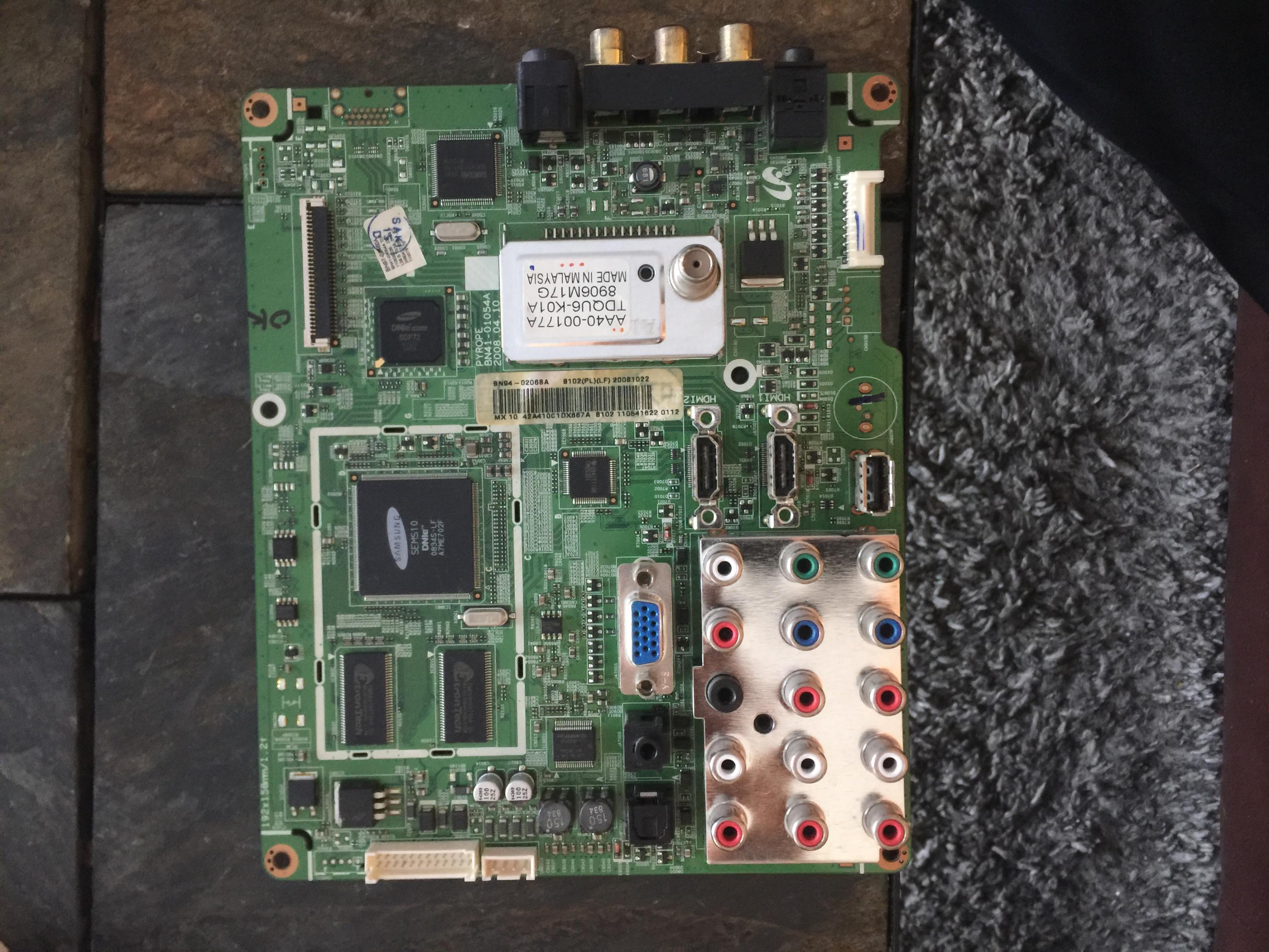

Samsung PN50A450P1DXZC Mainboard
  • dcapper
    • Dec 2013
    • 496

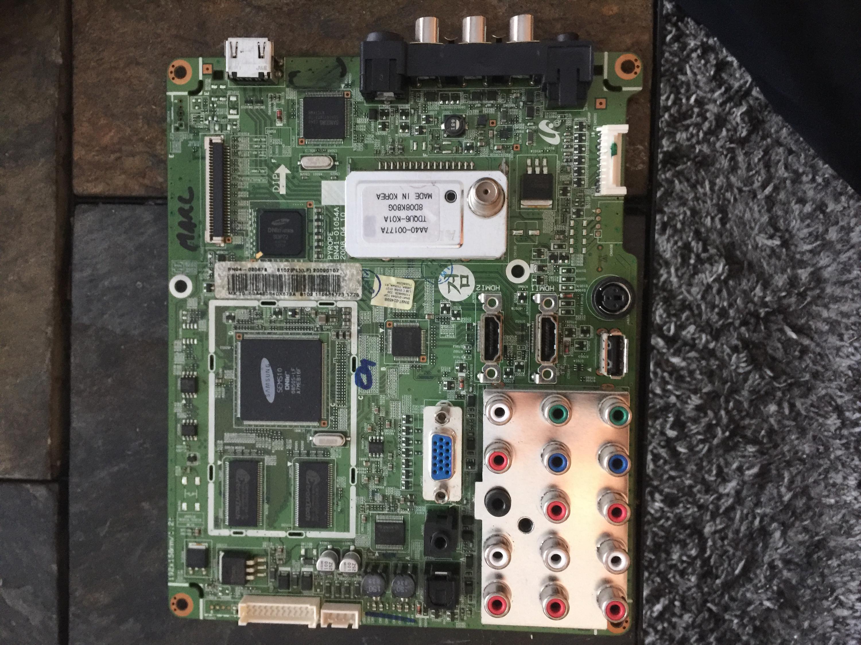

    My friend asked me to fix his tv. I confirmed his mainboard is dead. I have the exact same mainboard from a PN42A450P1DZXC. I put it in temporarily and the unit powered up and of course it wasn't a full screen. Can I pull the eeprom from my board and put it on his to get it to work? Or there is more that just that?
  • R_J
    • Jun 2012
    • 9588
    Re: Samsung PN50A450P1DXZC Mainboard
    You might be able to change the Option Type and Model in the service menu, and also check under PDP Option: Panel Version, Panel Inch and Panel Type
    • dcapper
      • Dec 2013
      • 496
      Would I need to swap the eeprom or just go into the service menu?
      • R_J
        • Jun 2012
        • 9588
        I would try the service menu first, it might be that easy. I am looking at a service manual for the PN50C450
        With power OFF, press: MUTE -> 1 -> 8 -> 2 -> POWER ON
        • dcapper
          • Dec 2013
          • 496
          You are amazing! I'm just out for dinner. When I get home I'm going to try it! Thank you.
          • R_J
            • Jun 2012
            • 9588
            Lets see what happens first.
            • tvtimmy
              • Mar 2015
              • 1160
              • usa
              That set is prone to the bad C102 capacitor on the back side of the mainboard.
              • dcapper
                • Dec 2013
                • 496
                Great! I’ll check that when I get home.
                • dcapper
                  • Dec 2013
                  • 496
                  I can't find C102 on the board but I went into the service menu and changed the board to P450 and 50" and viola! Working tv. Thanks for the help!
