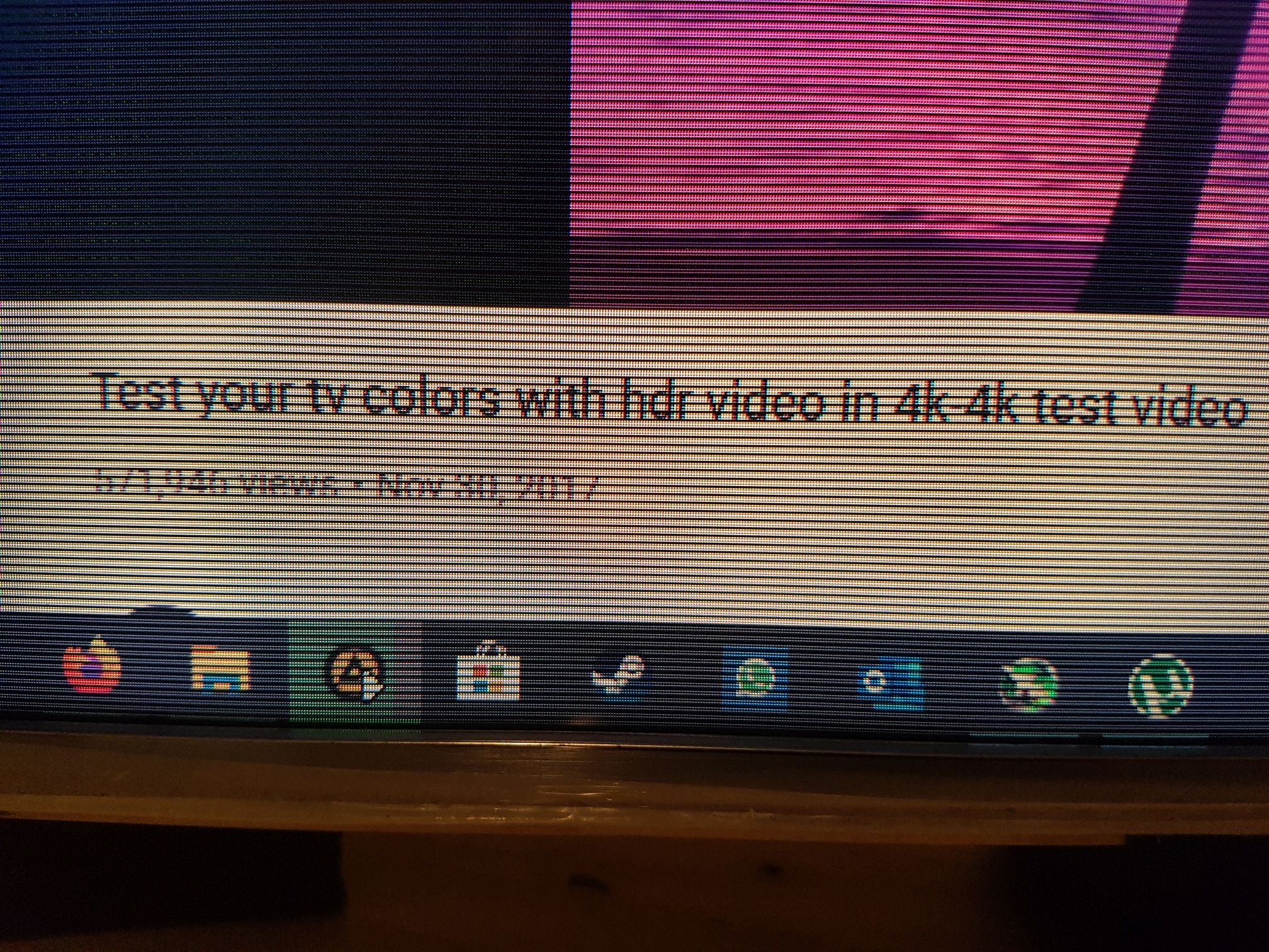

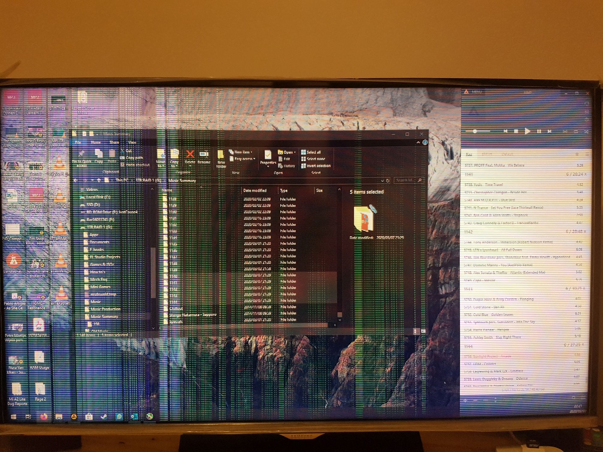

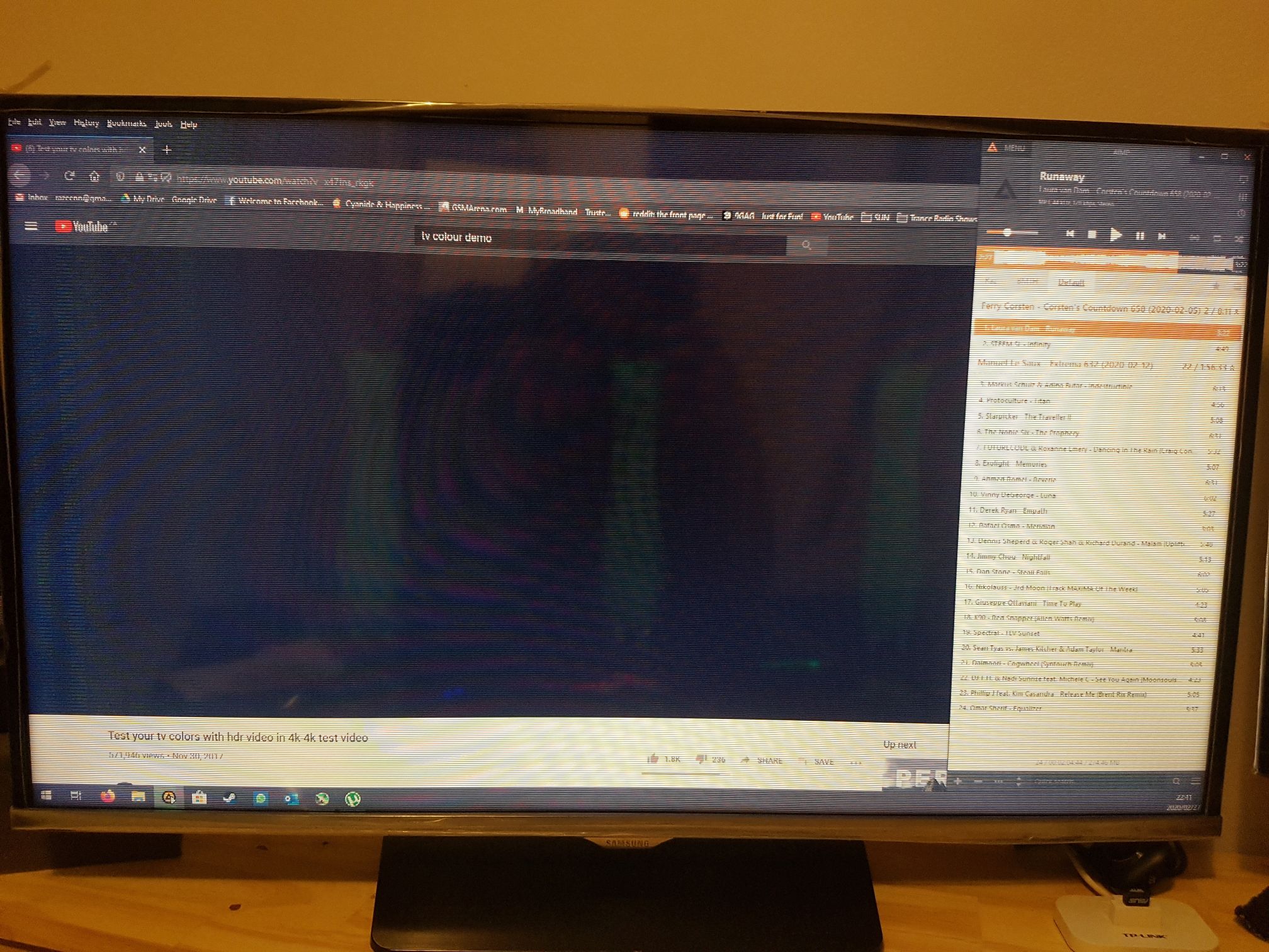

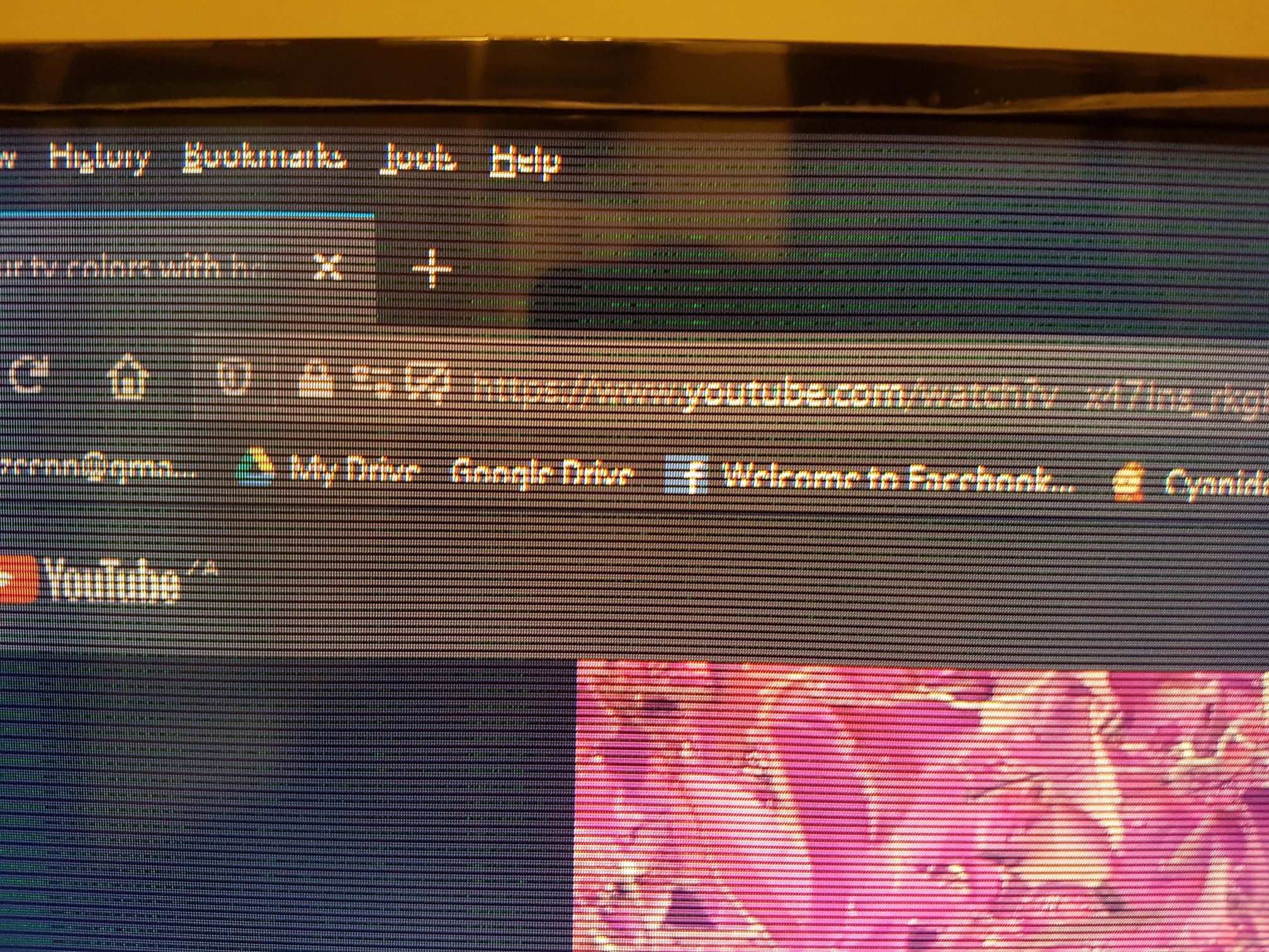

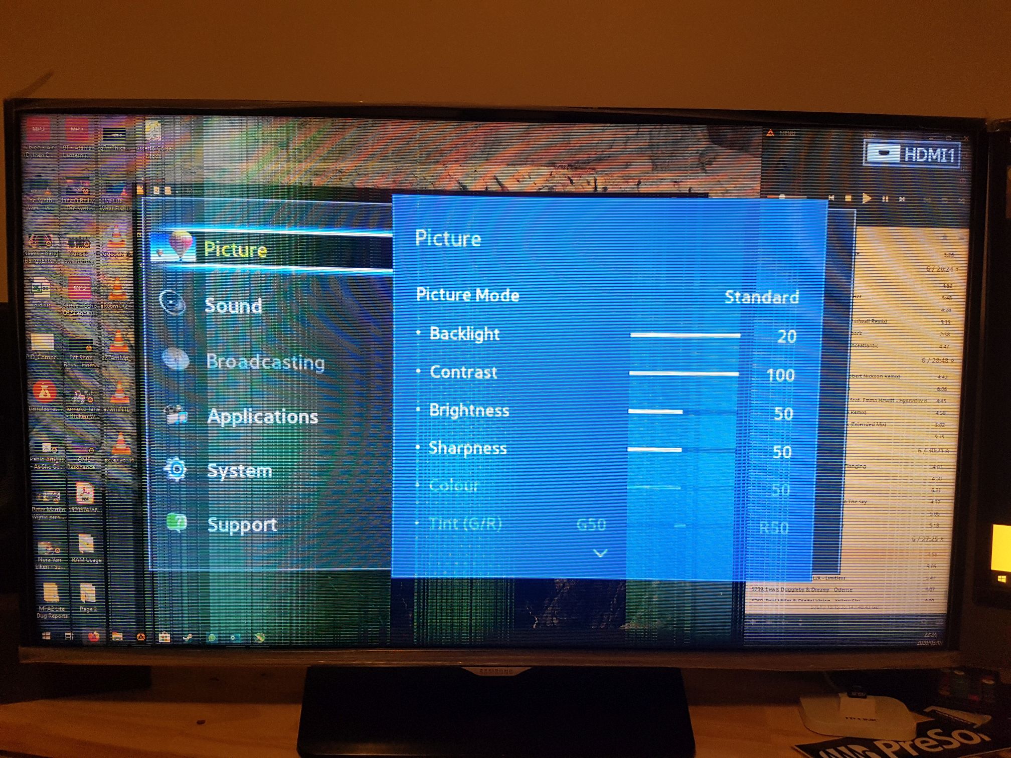

    Hi guys. Sorry if this issue has been addressed in a previous thread.
    Two weeks ago, my TV (which I use as a 2nd monitor for my PC) started displaying some weird lines.
    Basically it's black horizontal lines that makes it look interlaced and some green lines. Check the pics for more info. It seems to also be related to temperature, because if the TV has been off for a while and I switch it on, there's no problem, but eventually it goes bad. Regardless of input and even on the OSD it shows up.
    I did some research to see if I could diagnose it and thought it could be the tcon board, but a seller of tcon boards on Ebay mentioned in the description of a tcon board that horizontal lines are almost never caused by the tcon board. Now I am not sure if it is the panel or tcon.
    Considering the price of a 27" monitor, I don't want to spend too much trying to repair it. So I am wondering if the community here can help diagnose the issue and give me some advise on whether it is worth repairing?
    TV Model: Samsung UA32H5100AK 32" FHD TV
