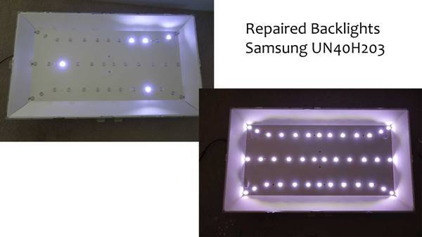

These are likely your strips. https://ebay.us/mJY3Cw You need to take apart the panel and confirm the part number. For $30 USD, not sure how much money you want to save.
I typically see 50 to 90% of LEDs dead on this model and always do a full replacement. The open circuit saved the remaining ones but they all have wear and are likely to fail.
Here is a pic of UN40H5203 bad backlights.
