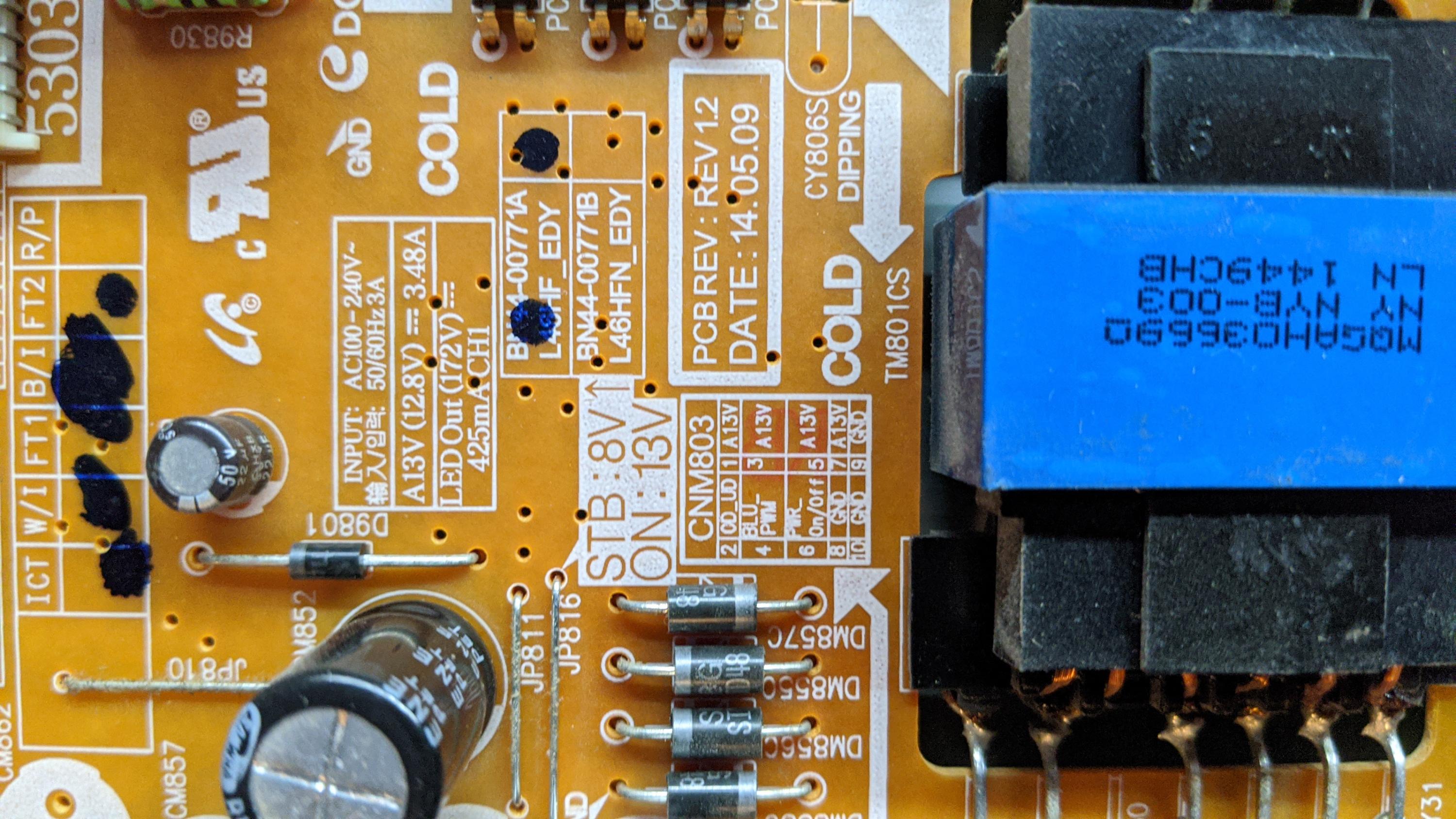

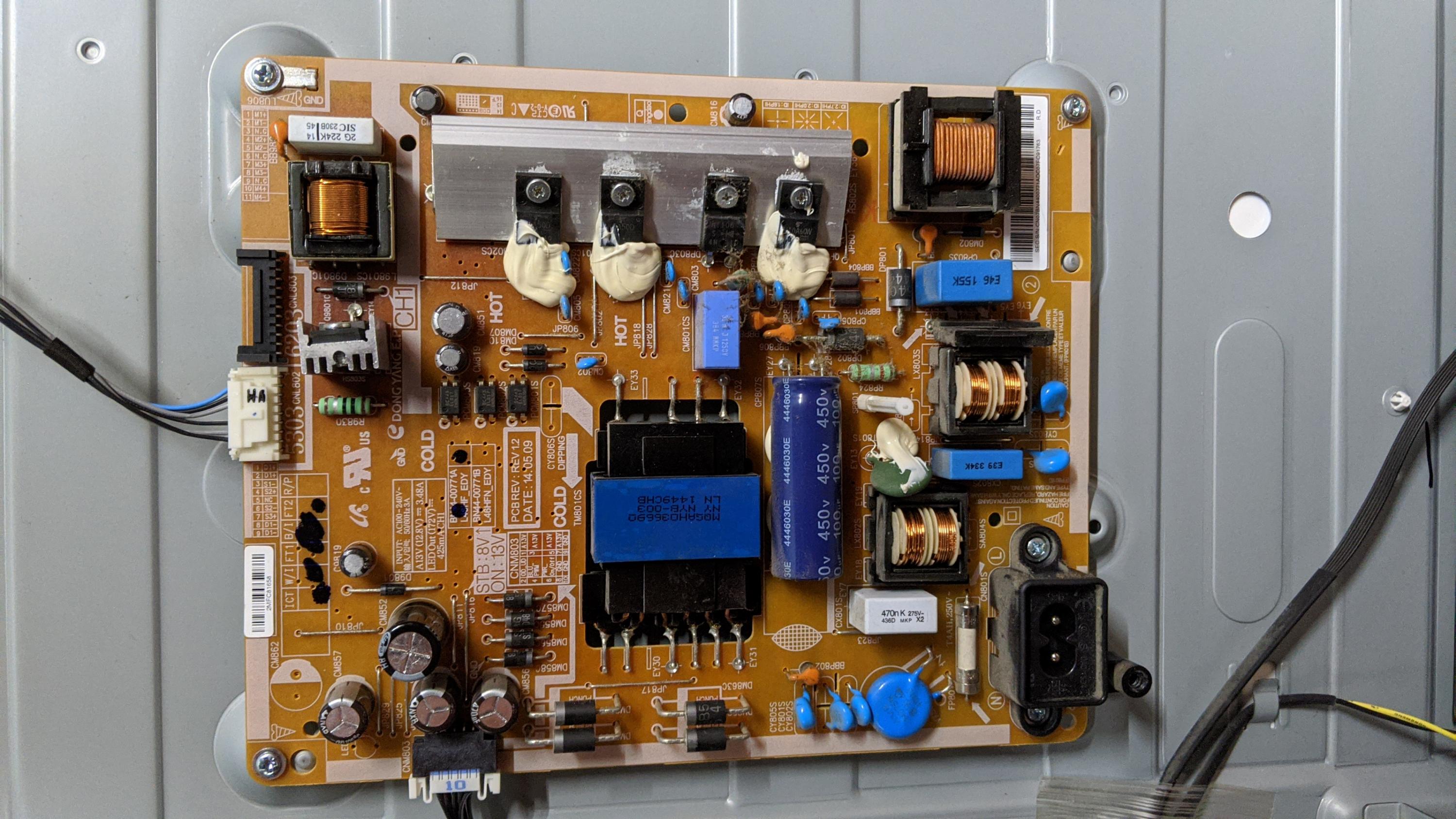

    Hey guys,
    I need some help trying to troubleshoot this set.
    I have tested the LED Backlights with the Shopjimmy LED backlight tester and I could see through the back of the panel the LEDs lighting up.
    Flashing a flashlight into the panel I could see the image.
    I have taken voltage measurements here they are...

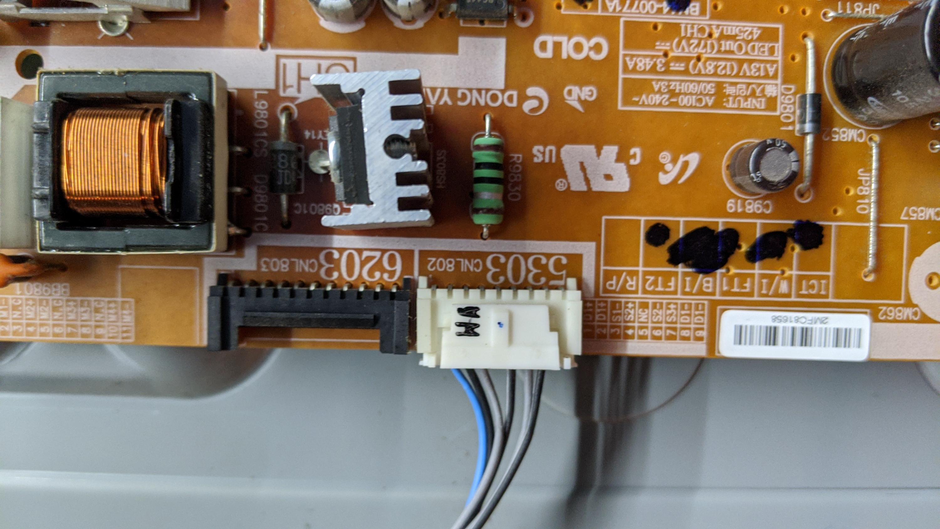

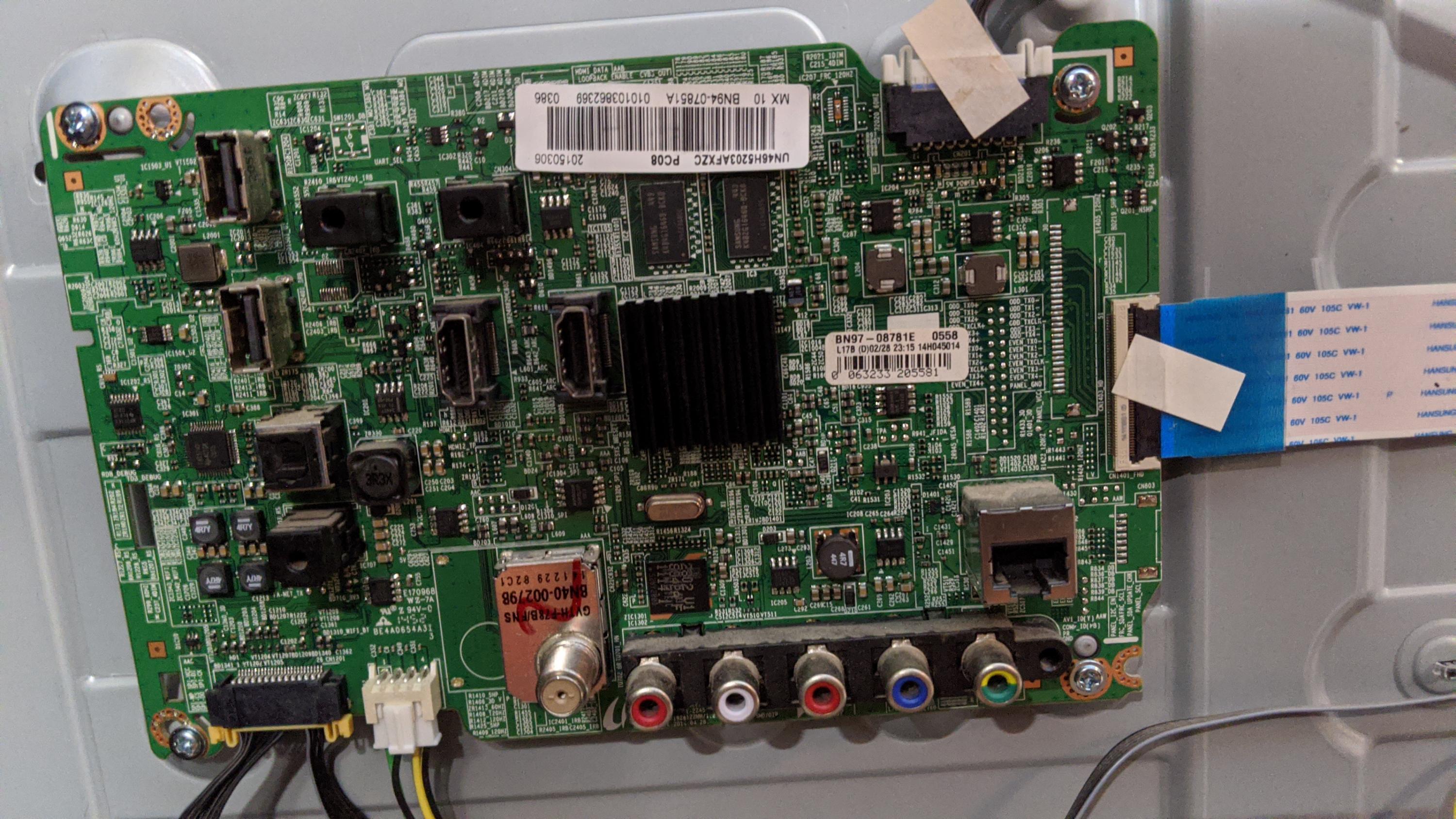

    I have attached pictures showing the PSU and the Main and also close-ups of the pin legends. I also have the service manual for this set, but it's not really informative. Another thing I find odd that I should mention is that the standby voltage on this set is supposed to be 8v according to what's printed on the PSU meanwhile on standby it's running 11.95v, not sure if that's an issue, but it's worth noting.

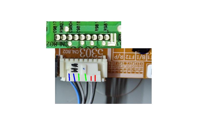

    The connector has pin label for each pin so you should put the name of each pin on the connectors that you report so we can easily see what each pin is for.
    Also recheck the way you count the pin and the pin name as listed in the chart, I.E, the CNM803 connector has odd and even column pins, the odd pins can be access from the top side of the board the even number pins has to access from the wire entrance side of the connector.
    Your report for
    CNM803 CONNECTOR ON PSU
    Pin 1 - 13v
    Pin 2 - 13v
    Pin 3 - 13v
    Pin 4 - 13v
    Pin 5 - 0v
    Pin 6 - 3.297v
    Pin 7 - 1.578v
    Pin 8 - 3.328v
    Look at your pin number and the report, you will see that they do not match the chart (the connector has 10 pins), as you can see fro example the pin 8 is GND so how can you have 3.328V, that is why you need to put down the name then you can easily see the errors you made.
    Please redo you measurement again.

      My bad, I'm sorry for my mistake here are new measurements.
      ON STATE
      CNM803 on PSU from Main
      Pin 1 A13v - 12.94v
      Pin 2 OD_UD - 3.297v
      Pin 3 A13v - 12.94v
      Pin 4 BLU_PWM - 1.574v
      Pin 5 A13v - 12.94v
      Pin 6 PWR_On/Off - 3.328v
      Pin 7 A13v - 12.94v
      Pin 8 GND - 0v
      Pin 9 GND - 0v
      Pin 10 GND - 0v
      STANDBY STATE
      Pin 1 A13v - 11.90v
      Pin 2 OD_UD - 0v
      Pin 3 A13v - 11.91v
      Pin 4 BLU_PWM - 0v
      Pin 5 A13v - 11.93v
      Pin 6 PWR_On/Off - 0.126v
      Pin 7 A13v - 11.94v
      Pin 8 GND - 0v
      Pin 9 GND - 0v
      Pin 10 GND - 0v

        CNL802 CONNECTOR ON PSU TO LED's
        ON STATE
        Pin 1 D1+ - 310v
        Pin 2 D1+ - 308v
        Pin 3 S1- - 260v
        Pin 4 S2+ - 262v
        Pin 5 NC - 0v
        Pin 6 S2- - 235v
        Pin 7 S3+ - 233v
        Pin 8 D1- - 0v
        Pin 9 D1- - 0v
        STANDBY STATE
        Pin 1 D1+ - 208v
        Pin 2 D1+ - 208v
        Pin 3 S1- - 159v
        Pin 4 S2+ - 159v
        Pin 5 NC - 0v
        Pin 6 S2- - 134v
        Pin 7 S3+ - 134v
        Pin 8 D1- - 0v
        Pin 9 D1- - 0v

          Tried running the TV without the cable that connects the main to the PSU to see if I get backlights, but I didn't get anything (Not sure if this unit has pull up resistors in the power supply)
          Shopjimmy sells a new IC1304 for this set
          https://www.shopjimmy.com/samsung-bn...eprom-only.htm
          Not sure if that would fix my problem.

                          The pin numbers are wrong, Pins 1&2 are the same connection, pin 5 is not used, pins 8&9 are connected together.
                          Disconnect the plug and check the 3 strings:
                          Between pins 2&3, 4&6, 7&8
                          • sfernandes
                            • Oct 2013
                            • 229
                            Re: Samsung LED UN46H5203 No Backlights
                            Ok here are the correct pin readouts...
                            Pins 2 & 3 - 55.1v ( Panel lights up)
                            Pins 4 & 6 - 29.9v (Panel lights up)
                            Pins 7 & 8 - 313v (panel doesn't light up)
                            What does this mean?

                              You have open circuit on the LED string connected to pin 7 (Anode of #3 LED string) and 8 (Cathode of the #3 LED string which is the Cathide return of the series connected LED strings).
                              • R_J
                                • Jun 2012
                                • 9581
                                It looks like the string between 7&8 is open.
