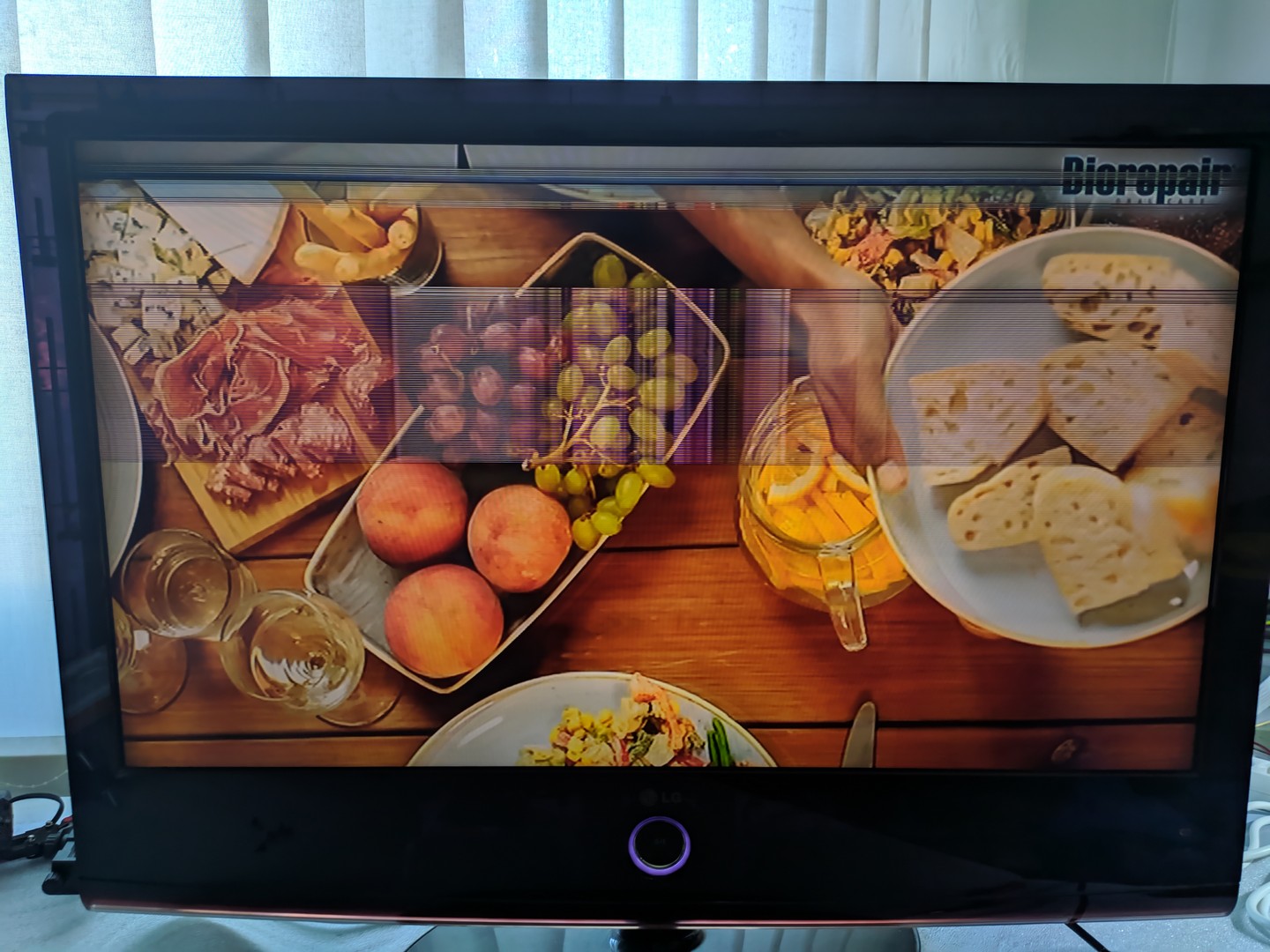

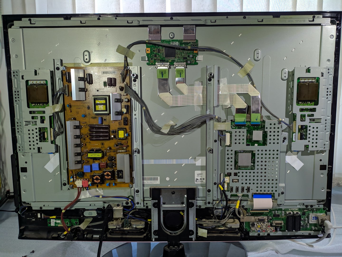

Tv works but had line od display . After about 20 min lines has gone and picture is OK. Any idea?
LG LCD 37LH7000 lines on display
Re: LG LCD 37LH7000 lines on display
Unplug the TV from the AC outlet then let it cool down, then heat up the main board with hair dryer for 2 ~ 3 minutes then power up the TV and see if the picture is OK or not.Never stop learning
