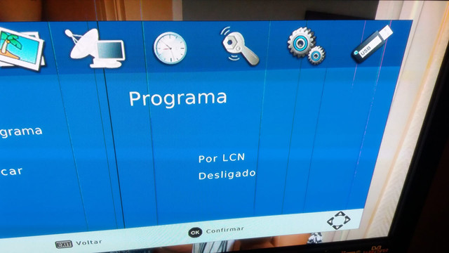

Vertical Lines Panasonic Plasma Th-37PX80
  • lupinIII
    • Jan 2020
    • 2
    • Portugal
    Vertical Lines Panasonic Plasma Th-37PX80
    Hello everyone, I've been browsing this forum but I didn't find similar vertical lines like this on Panasonic Plasmas
    So they are not all over the screen but there's lines on both halves of the screen. The lines are also present with no signal, at least some of them but I can't distinguish all of them with no input. With no input the vertical lines on the right side are definitely more visible.
    It started with one line half a year ago, then two and has been increasing the number of lines.
    Where or what could be the problem? What steps should I take? What possible fixes should I try? Thanks in advance
    Last edited by lupinIII; 01-12-2020, 08:23 PM.
  • Stanley1843
    by Stanley1843
    06-29-2024, 11:54 AM
  • pni
    LG 49uf695v vertical coloured lines
    by pni
    Hi guys…I need your help. My cousin ask me to fix her tv. The tv when I went to pick up showed 3 horizontal black line. So I know it was a bad panel issue but I could try to fix with the tape method so I said her I could fix easy. When I come back to home, I turned on the tv and now the tv show vertical line colored….and the problem is that I unplug the ldvs cable, first the right side then the left side I still have the lines. The lines never disappear. When the right side is plug in I don’t have nothing on the screen only this vertical lines, when the right side is unplugged I have picture...
    11-14-2025, 03:15 AM
  • afex
    Samsung Plasma TV with vertical lines (model PN50B430P2D)
    by afex
    This is my 2nd broken TV I'm trying to fix and haven't been able to figure out... currently going without any working TVs so am hoping to be able to fix one..
    This Samsung PN50B430P2D Plasma has this big block of vertical lines which will fade in shortly after turning the TV on. The lines will sometimes flicker a bit or fade in/out and sometimes it just stays present. The length of time it takes them to appear varies, sometimes its a few minutes and other times it appears immediately after powering on.
    I have attached an image of the TV with these bars displaying....
    11-08-2021, 09:23 PM
  • Falki
    Colorful LCD Vertical Lines on Samsung ue55es8090
    by Falki
    Hello there, ive recently found an older 55inch Samsung SmartTV.
    Sadly it has vertical lines at the left and one line in the middle-right.
    I have already tested out the connections and have looked at the soldered ribbons of the LCD panel to see if some contacts got loose by pushing them a bit but with no success.
    I have factory resetted the TV as well but also with no luck.
    I am afraid that it is indeed a LCD Panel issue but there are NO scratches or any impact-marks..
    A similar issue has been posted as well but also with no actual response ...
    08-12-2025, 04:19 AM
  • visionbluedemon
    Help. Sony kd-65x85dj vertical lines
    by visionbluedemon
    First. it has no picture at all. i solved it by covering the ckv lines using tape to to block the connections
    Second. now has picture but with vertical lines that follow the image. tcon board ic overheating
    tried blocking LC lines too, but same results
    is it lcd panel issue or tcon board issue?...
    07-25-2025, 04:56 AM
