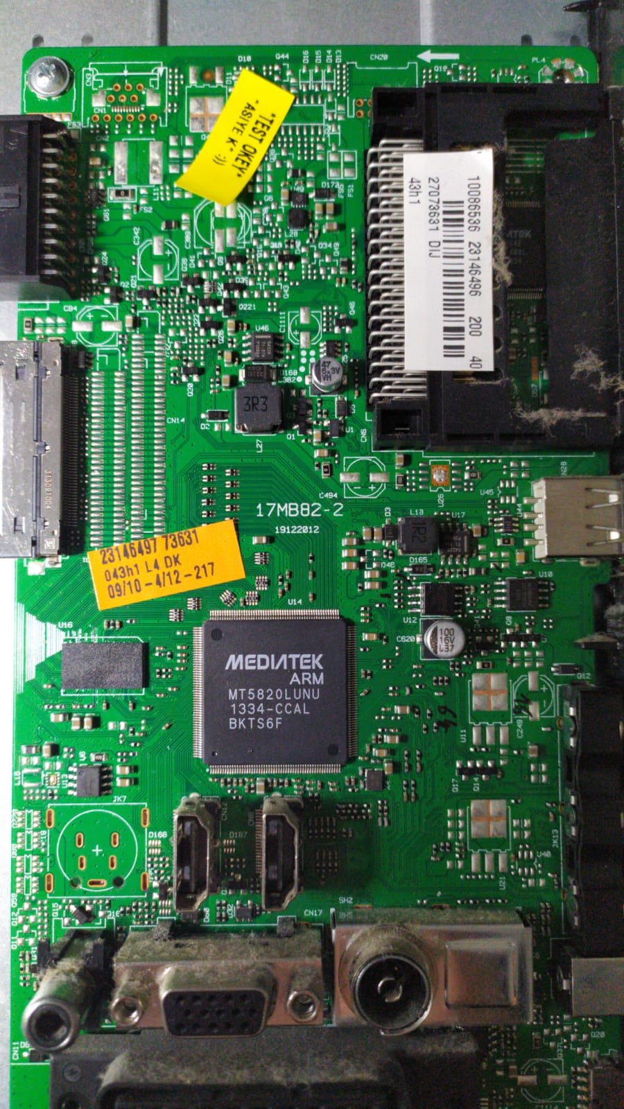

    Hello colleagues, I have a TV System TD model K40DLViF that stays the flashing led, I have tested tensions and they are all correct and I see that these TVs usually have eprom problems but I do not find this model, I have found some of the Telefunken brand but Not of this brand.
    The brand of the board is Vestel 17MB82-2 I upload the board with some number that I suppose are references to find the firmware.
    This board has 2 bios one of winbond25q16 and another of 64

    Non-panel usb firmware ; https://yadi.sk/d/AxHWVbZWmH1MQQ

      thank you partner, I'll try to see, I've also found some bios to see if they go, I'll comment something later.

        Unfortunately it has not worked, it remains the same, after programming the bios now if it flashes 7 times but does not turn on.
