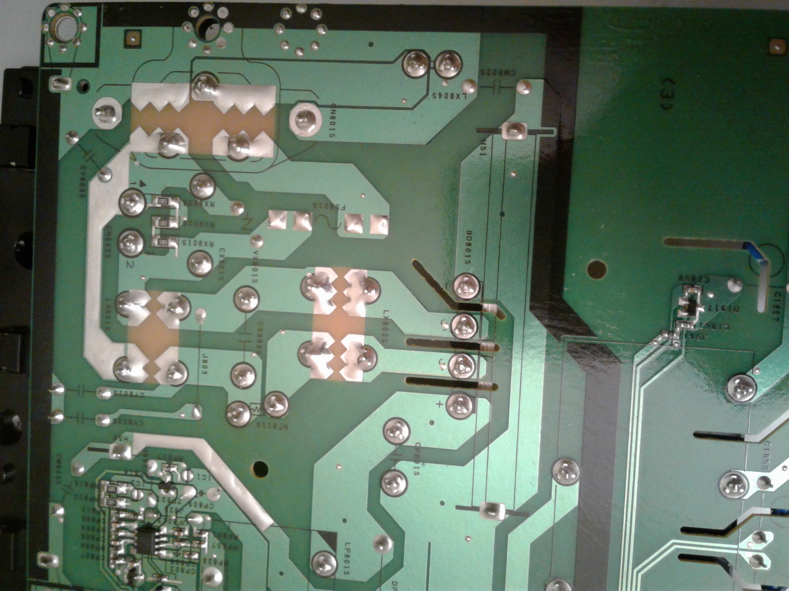

    I get No standby light on tv, and backlight does Not come on with logic board term CN802 disconnected. Im get voltage readings but None at all on CN802 terminal pins.
    My component level knowledge is basic, so this will be a lession for me. I id the transistor pins G D S from schematic but got diff readings reversing polarity, idk which polarity is relavant so i took both directions.
    Any advice on which direction i should research into first based on the symptom issues is appreciated, i don't know where to start. I also included a closeup img on part of the pcb, idk if what im seeing is just part of a coating on the boatd or liquid damage? Would like your opionion as i have no knowledge reference.
    Fuses are ok 0.3 ohm
    Resistance reading with Fuse FM802S removed suggested in this thread. Tho my symptom is different i checked anyway but dont know what its supposed to read.

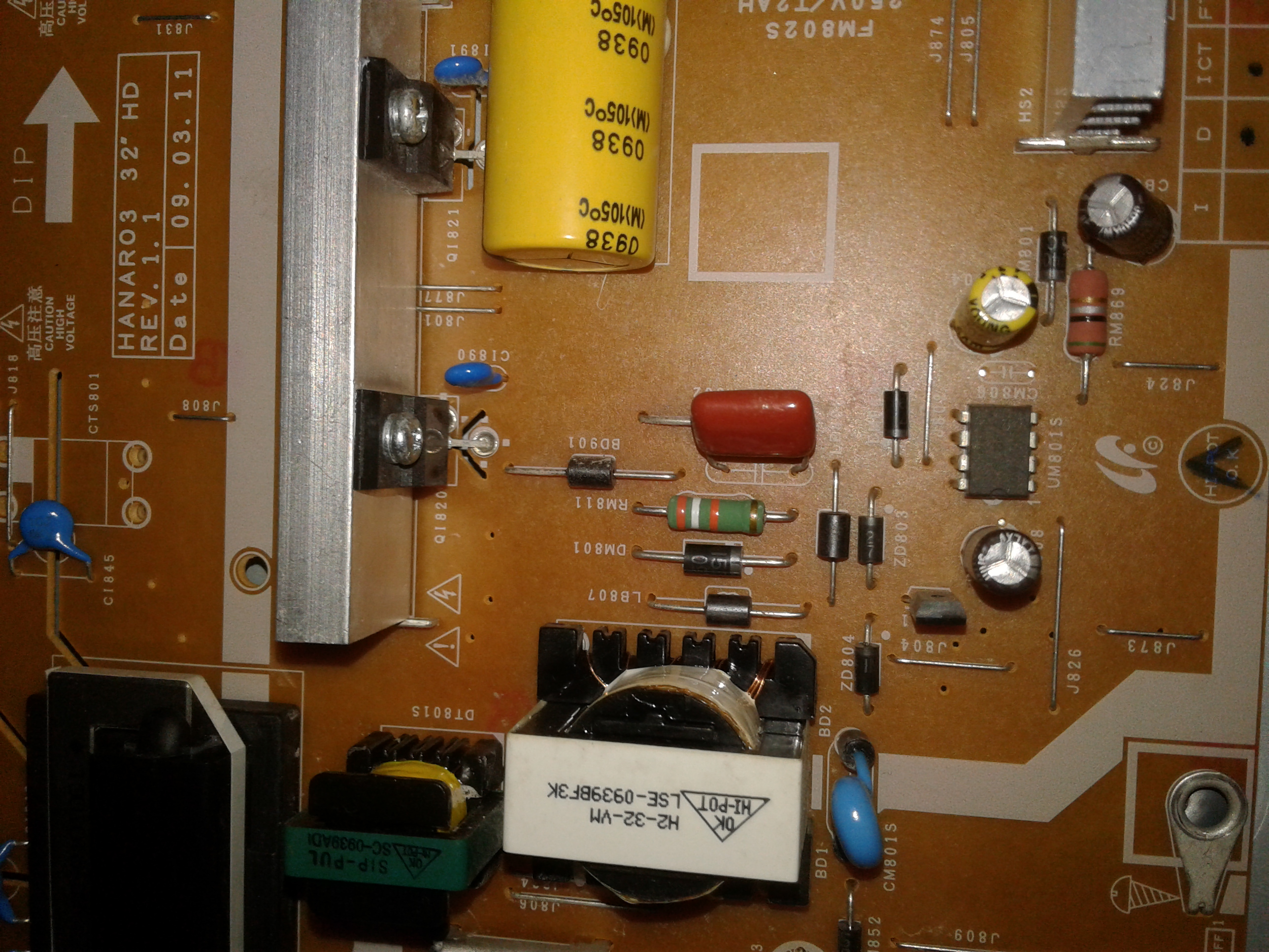

    UM801s is the standby ic, It needs to operate before anything else, Have you checked or replaced CM804 and Cm808?
    If that ic is working it should give you around +6v on CM852. You need the +5.3v standby voltage before you can turn on the rest of the power supply and pfc circuit.
    You also need to check DM851 and DM857

      Thanks, and no i didn't replace anything yet. I don't know where or what to order yet, but notice caps and diodes are cheap so not sure if i should just replace them all? cause shipping may cost more than the parts? I dont usually do this so i dont have spare parts, and i dont have experience to know the likelyhood if caps or diodes would fix the symptom.
      Recommendations on where to order from also since im not ordering large bulks is also appreciated.
      CM852 had no exposed pins on top so i used center Pin of DM851 to > S-GND which read 0.0v , everything on the cold side read 0.0v
      I only have a multimeter to check the caps, all there resistance climbs to infinit some quicker than others, except CB804 stops at 600 ohm , but does that mean anything cause they're in circuit?

        The 13.5v is the VCC on UM801s, this is created by the internal startup cell. The reason CM804 has no voltage is because: either the ic is not operating due to being defective, or the feed back/run voltage is missing, so check RM890, dm802 and check that the transformer winding between pins 5 & 6 is not open, it should read less than 1Ω
        NOrmally the ic's drain pin will pulse the primary of the transformer, this will induce a voltage in the secondary windings, this induced voltage in winding (pin5) will be rectified by DM802 and charge CM804 to about 27 volts, this voltage is applied through DM803,RM805 and will charge CM808 to about 24v of VCC to turn UB802 on fully

              ZM804 won't be the problem, it is in series with a 1.5K so even if it was bad it would not kill the standby.
              ZD804 would also not kill the standby from working, I would check the resistance of UM801S, pin1 to ground, just to make sure CM802 is'nt shorted.
              It could be that UM801S is bad, You would need a scope to check if it is outputing any pulses.
              It's not a very complicated circuit and only a few components are required for it to work.

                I would check the resistance of UM801S, pin1 to ground, to make sure CM802 is'nt shorted.
                It could be that UM801S is bad.
                UM801S
                pin1 > P-GND = O/L
                P-GND > pin1 = 600 ohm | 740 ohm on diode setting

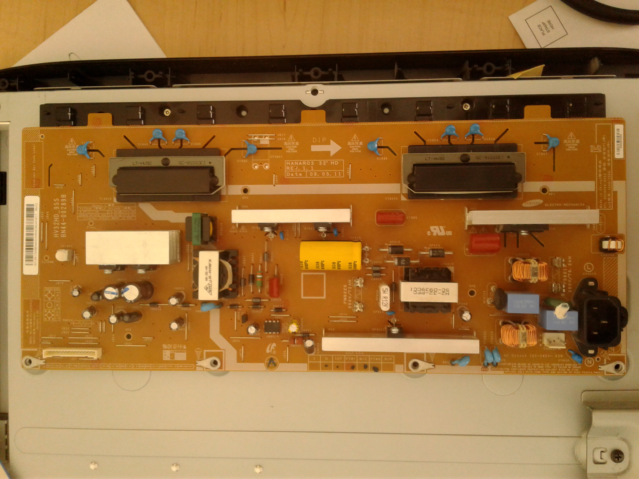

                  New here and having some trouble with my LCD TV
                  Summary: The TV is not switching ON but the red light is blinking
                  Brand: Samsung
                  Model: LN32B360C5DXZA
                  Power Board: BN44 00289B

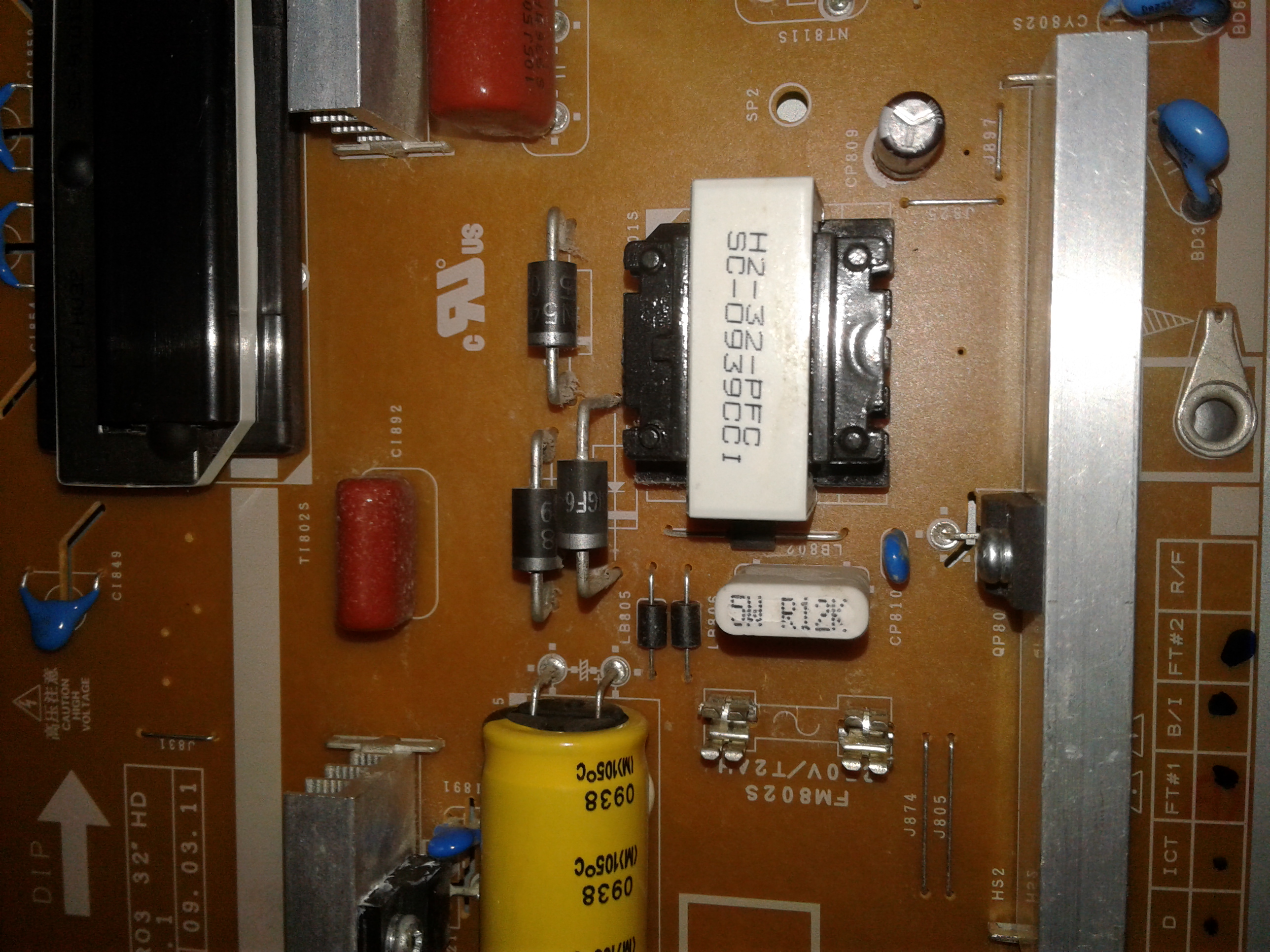

                  From google, I was able to get the wiring diagram and a suggestion that the blinking Light is a Power Board Issue.
                  I have opened up the television and disconnected the power board. These are the readings I am getting.
                  Harness CN802
                  PINS ------ MEASURED VALUES
                  PWR ON/OFF ----- 0.783V
                  STBY5.3V ------ 5.3V

                  Looking at the board I am seeing some burn marks but no swollen caps.
                  Using my multimeter, I got a few CAPS reading "OL"
                  The Largest CAP CP815 measured a voltage of 378Vdc when plugged in.
                  The CAPS showing "OL" (These have no visual swelling)
                  CM876
                  CM867
                  C1801
                  CB804
                  Also I got a Zener diode
                  ZM804 giving continuity.
                  I saw some burn marks around UM801S
                  UM801S - Getting continuity between GND and CS(Current Sense) Pin
                  My question is why is the DET_5V reading 0V? Is the 12.88V sufficient or too low? Could these issues identified be the problem?

                        12.88v is fine, you don't have DET_5V likely due to a fault in the inverter section, (ie bad transformer) or even a bad ccfl in the panel. UI801 pin 17 is FAIL output that is turning on QI807, connecting the collector to ground.
                        Each transformer has two secondary windings, Check and compare the resistance of each winding, Should be around 1KΩ. Also check for poor solder connections on QI820 & QI821
                        This is the PFC ic and based on "CP815 measured a voltage of 378Vdc" it is working, The CS pin has RP820 (0.12Ω) to hot ground.

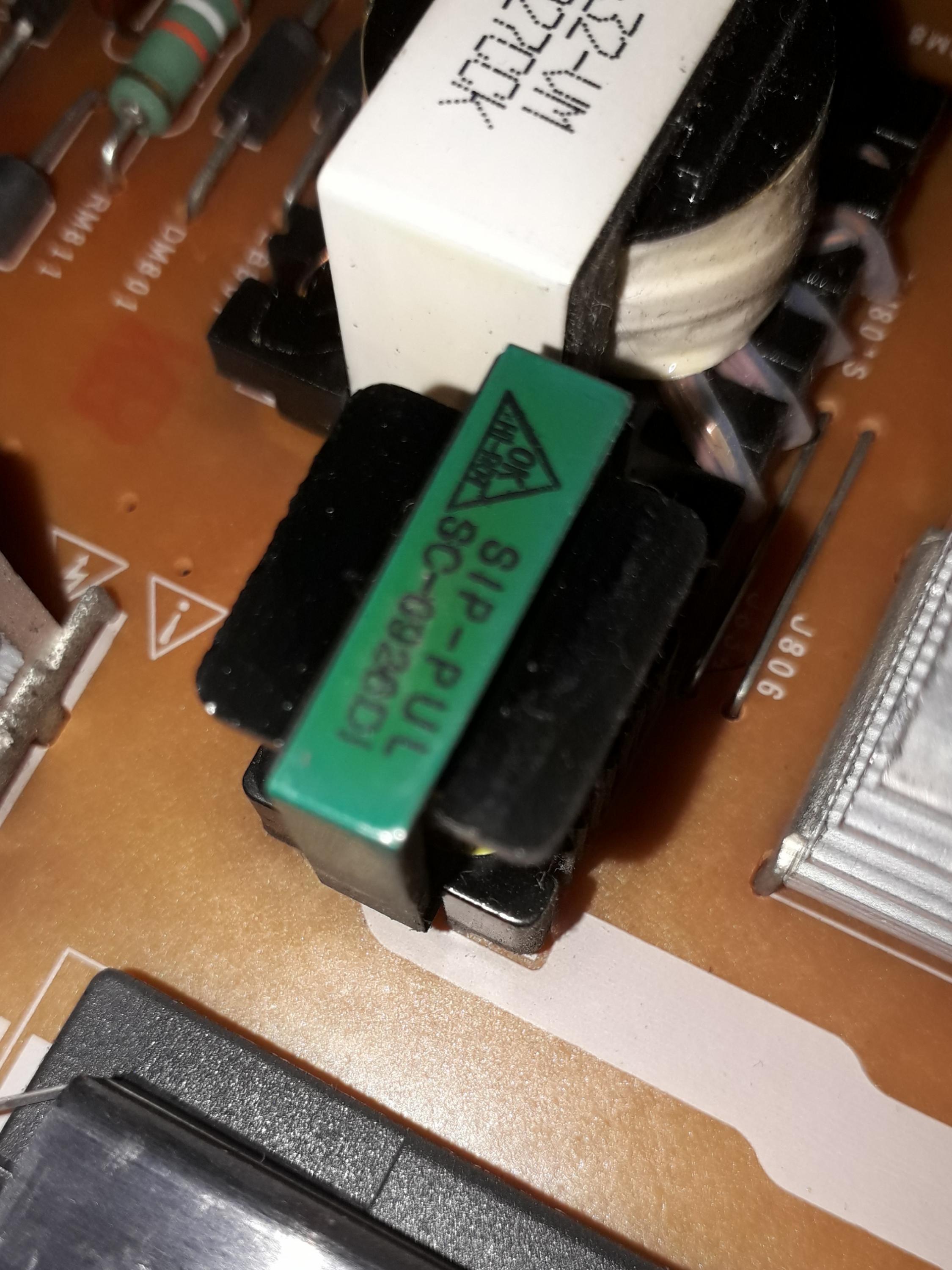

                          Thanks for the response. So I did some more troubleshooting today. The QI820 & QI821 are good.
                          However, I am not getting any output on the DT801S. I am getting a 12V to ground on each incoming line to the transformer. So maybe this could be the issue that is causing the no DET5V?
                          Do you by chance know where I can source a transformer like this.
                          The output coils on the transformer are reading 2Ohms.

                            The fault is not the transformer. Transformers operate with AC not DC, To check the output of the transformer you need a scope. That transformer is just the drive for QI820/821. You need to check the secondaries of TI801S and TI802S

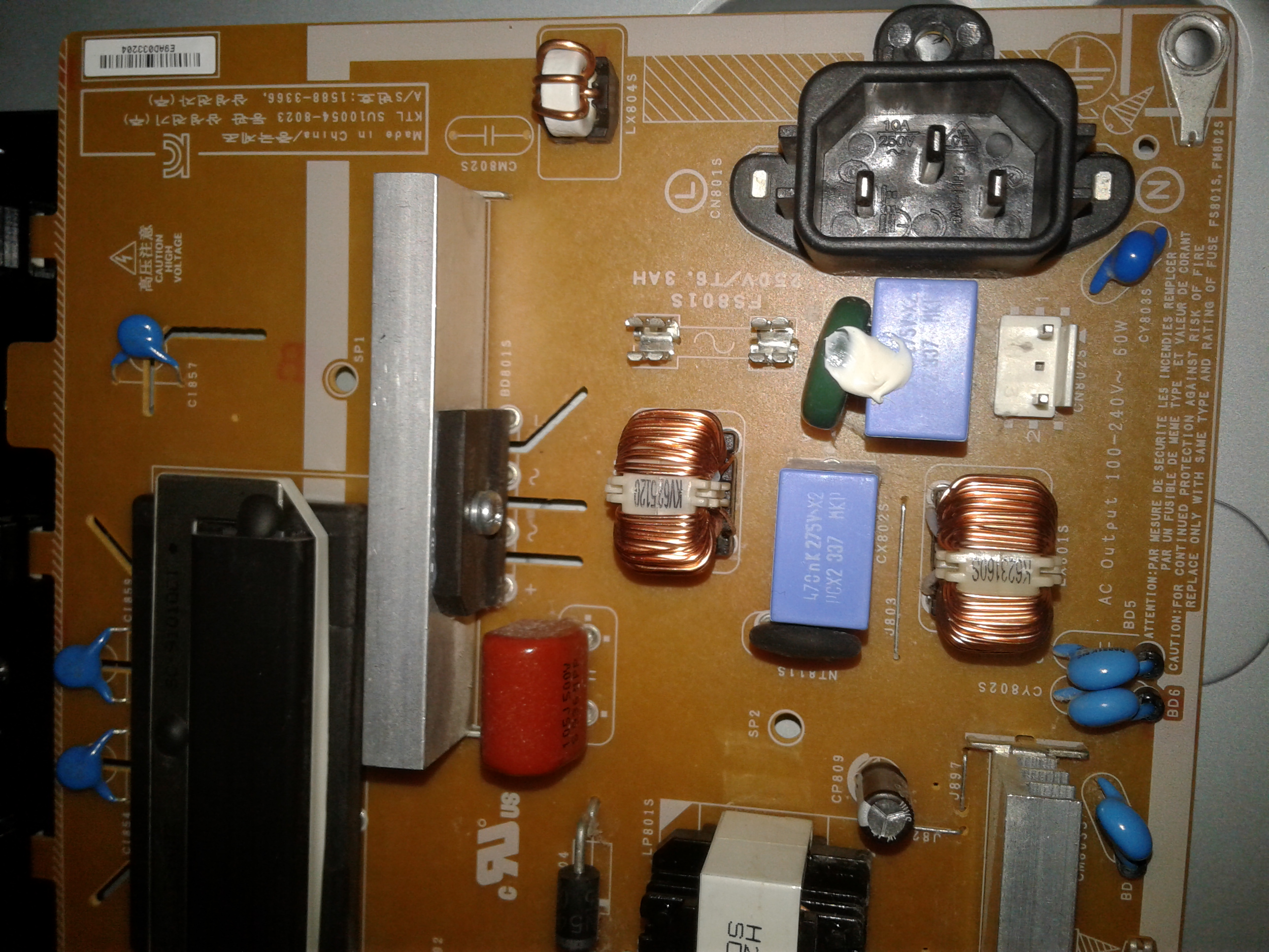

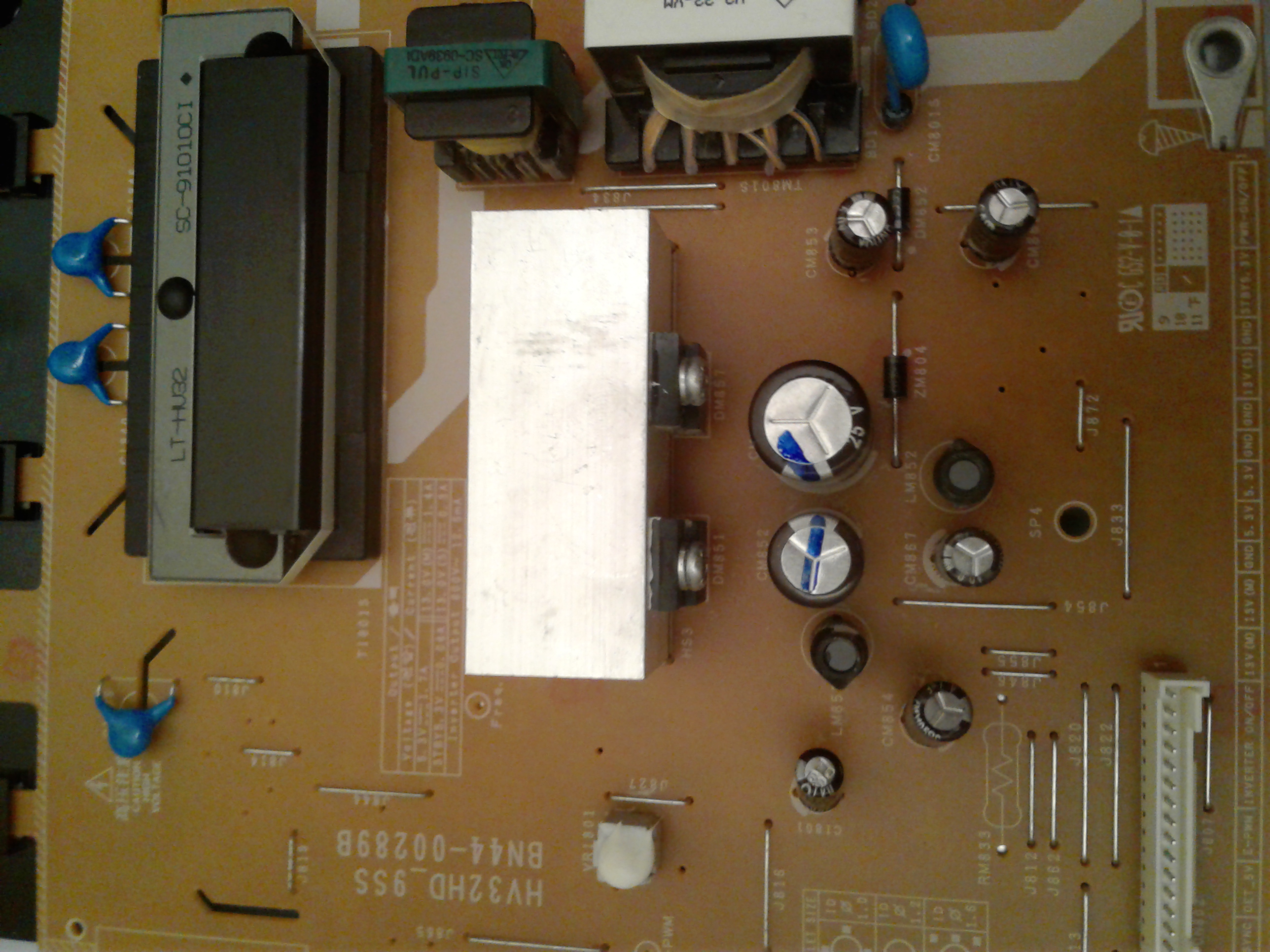

                              Ah Ok. Understand. I replaced the suspect components today and checked through the secondary's of that circuit but nothing showing out of the ordinary. Still having same issue.
                              However I came across the PFC line from after the second fuse reads 380Vdc but when it passes over the BD901 , the voltage drops out to 2Vdc. Any idea what can be causing this?

                                Well BD901 is open. On some other samsung power supplies they use a .1Ω resistor or a fuse in this position, this acts like a fuse when QI820 & QI821 short.
                                I have no idea what "suspect components" you replaced, so it must be other components that are bad

                                    I looked at a picture of the board and BD901 should be basically just a wire with a ferrite bead over it, Check if it is indeed open.
                                    Capacitors reading OL with what? ohm meter? You can't check a capacitor like that, you need a capacitor checker or an esr meter.

                                        BD901 is basically an inductor, I don't think I have ever seen one of these go open. Replace it with a 1Ω 1/2w or maybe a 2~3 amp fuse for testing
