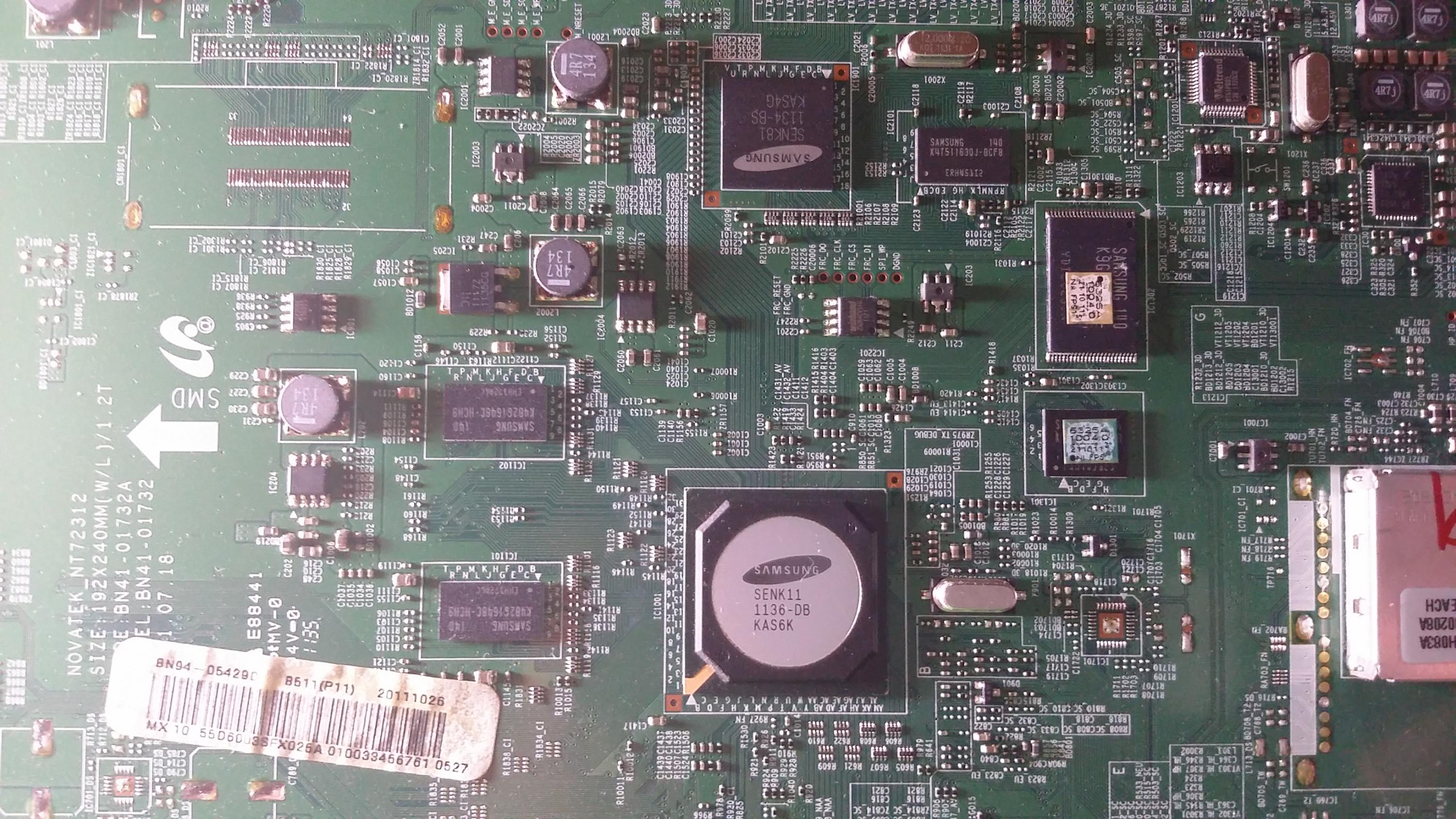

            Is there an easy way to tell which IC is the eprom? I haven't tried that yet.
            I tried to attach pic of IC's.

              Re: Samsung un55d6003sfxza LCD TV issues
              Ok, this one uses NAND FLASH.
                I think it's IC1302, try freezing it with freeze spray or upside down duster spray, see if tv comes on or tries to.
                  IC301 also.
                    I tried freezing both ICs. No change in how the unit acts.
