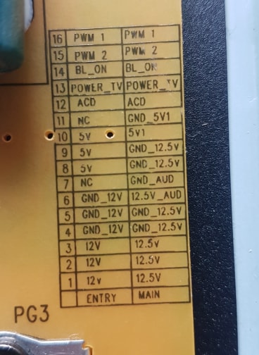

    Hi, im hoping someone can help me.
    When first plugged into the mains (220v) the Tv powers onto the "TOSHIBA" logo screen for approx 5 seconds, the tosh logo disappears ready to transition to the on screen menu but nothing & stays blank.
    No onboard controls or remote control work & no sound. The Back light is still illuminated but that's the extent of it.
    If i pwr cycle the TV again from the mains, i get the exact same fault occur every time.
    I have pulled the main board to check the the voltages to the AvBoard, however im not sure which 2 pins to short to pwr the main board.
    Im happy to simply replace the entire board, but im unsure which, as it could be either the AVboard or PSU imo
    Any help at all will be appreciated.

    Re: Toshiba 40L7355D
    Test connector from mainboard to powerboard on powerboard side with all boards hooked up, test with tv plugged in but off then hit power, report both conditions here, give pin number, pin description/name and condition on and off.
      Your backlights are on. Sounds like a firmware issue to me.
