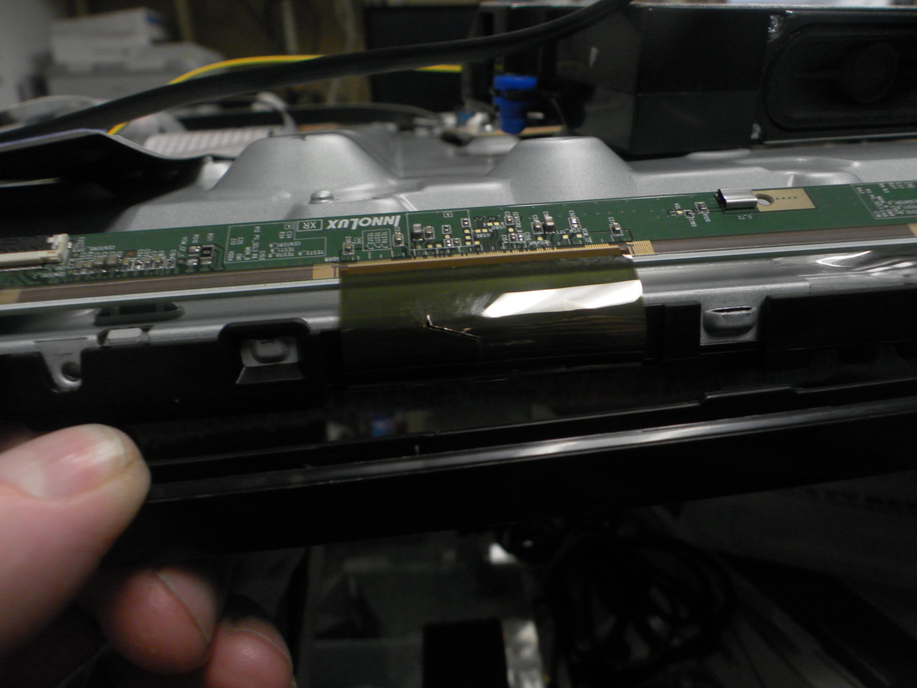

    This one has a burned tab and I was wondering if I could just remove the defective tab to fix the issue. Any suggestions would be appreciated.
    Re: Samsung UN50MU6300 burnt tab bond
    Nothing you can do, as I'm fairly sure that's a column driver so removing it will mean you get a big black bar down the panel.
      Thanks for the reply. Think I will keep the tv in hopes of getting one in with a good panel.
